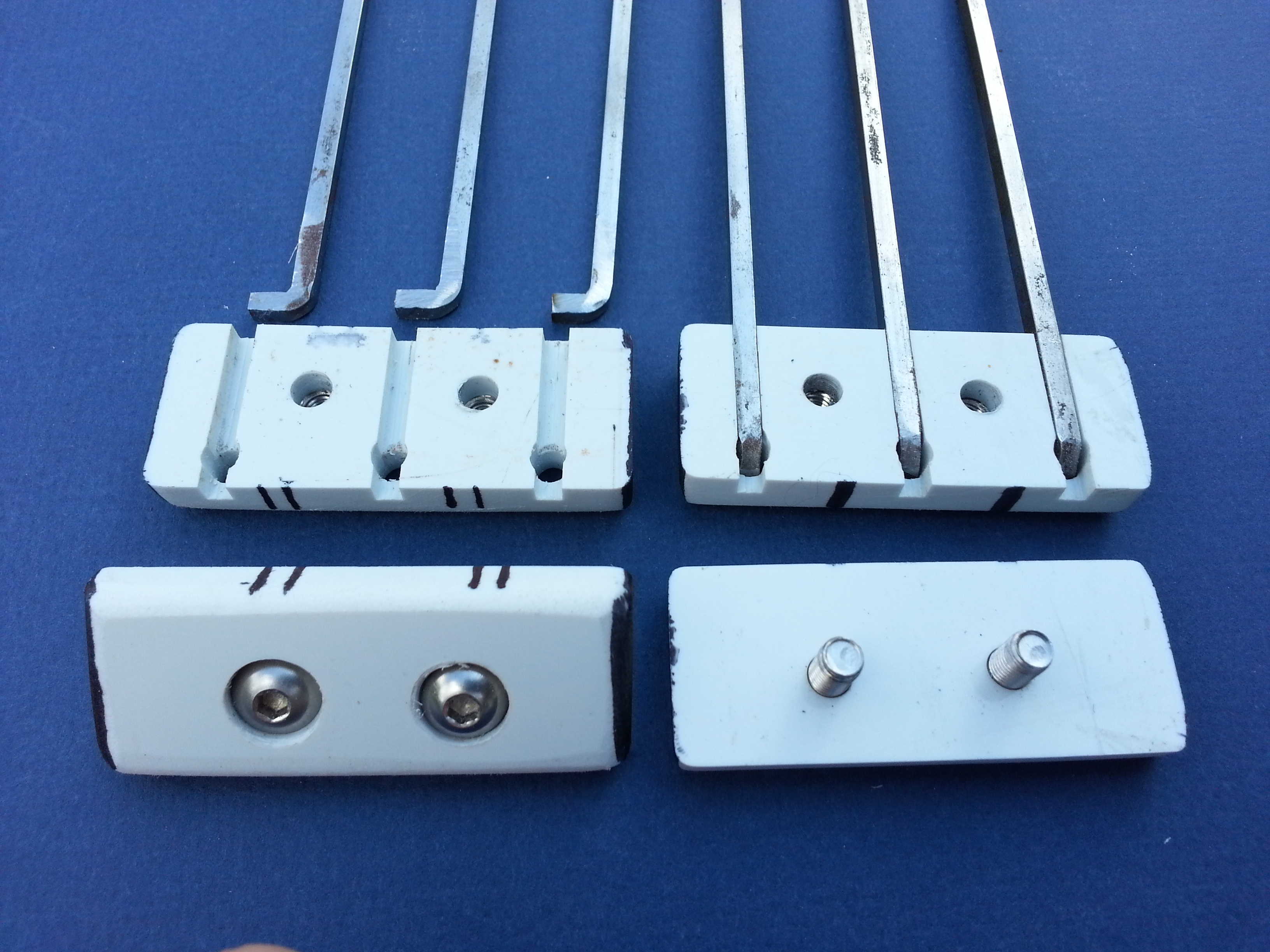

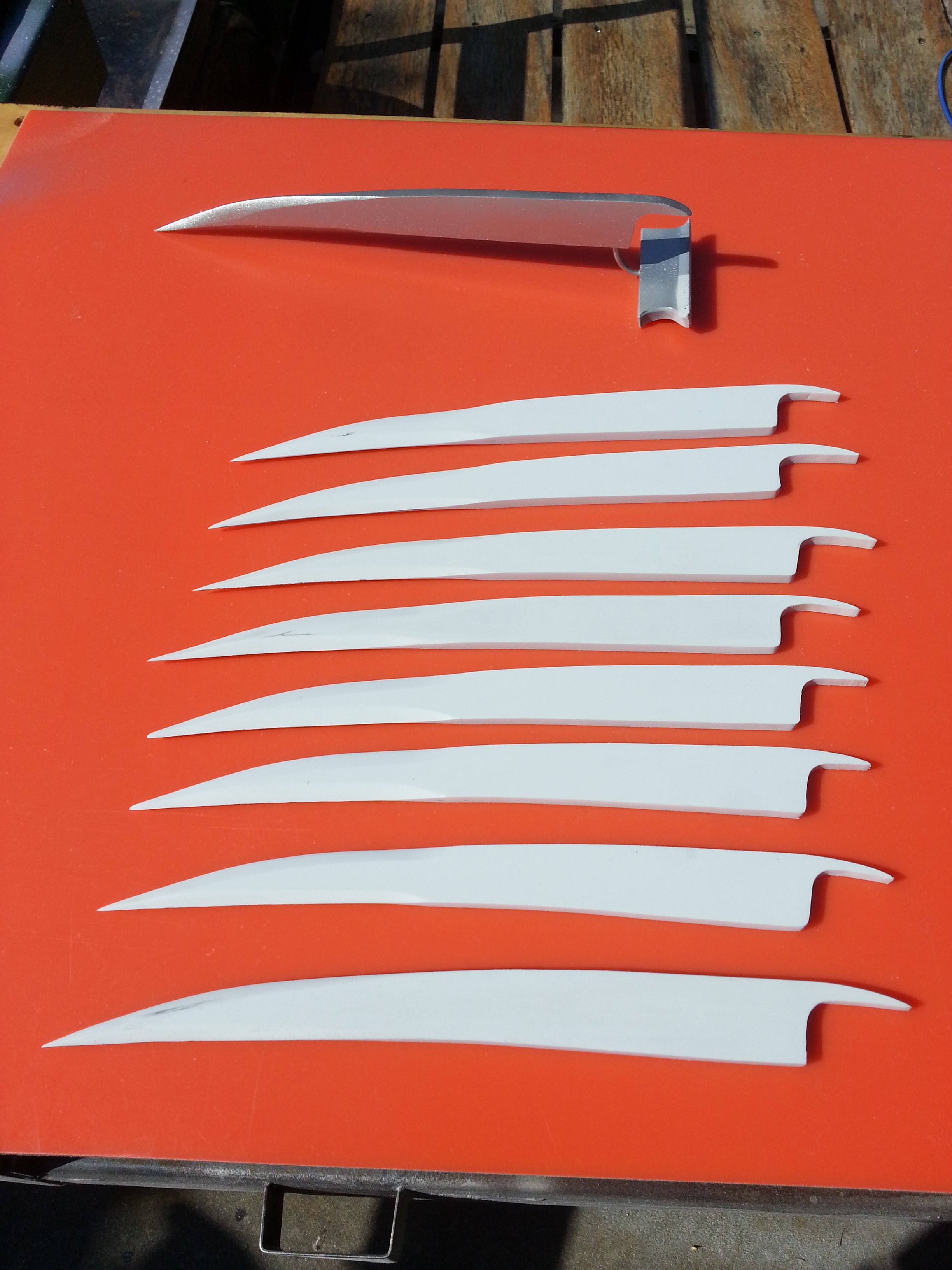

Thanks. I have made a number of sets for my kids and nieces/nephews out of PVC and have it down to a science with a good metal template that I can grind right up to and with the finish sanding takes me about 15 minutes each. Then of course there's painting but you can do them all at once, so that isn't that time consuming. I was asking because if I made too many more, I would have to figure out which is the most time efficient method, even considering the cost of silicone. 20140523_171208.jpgAlso, no one else seems to have the problem I have of not being able to get my knuckles through the wires, so I really appreciated seeing your solution to that, being the square wire and being able to take apart the paddles and "install" them on your hands fairly easily, 20140723_100521.jpg although I added a further stabilizing feature of the 90 degree turned of the wire into the hole in the back of the paddle. Again, thank you. I wouldn't have taken that extra step of cutting the slots in the paddle if I hadn't seen someone do it with, as your logo says, Designed With Ingenuity."

Yup, I do the same 90 degree bend on the end of my wires:

Ahha! That way you can get all the stability out of the geometry without the square wire. And that is why you are a prop maker and I'm a writer....who has a nice shop to goof around in. Cheers and thanks for your time. ww

Yeah, I still use the square wire though. It bends nicer than the round wire does.
