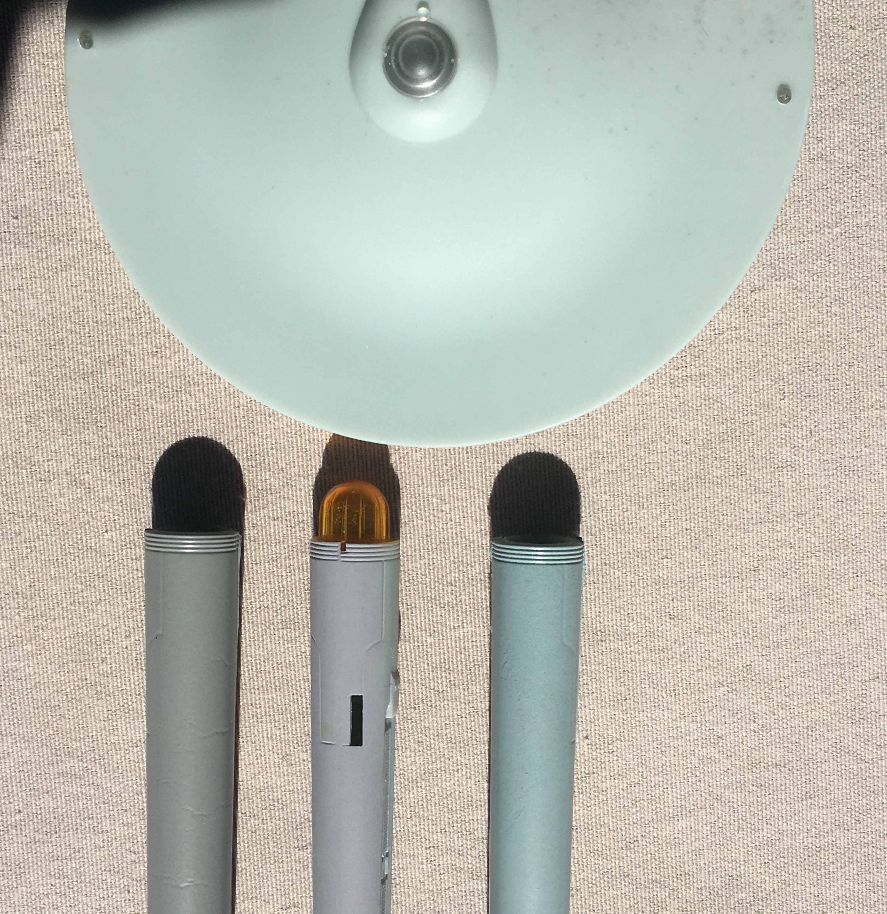

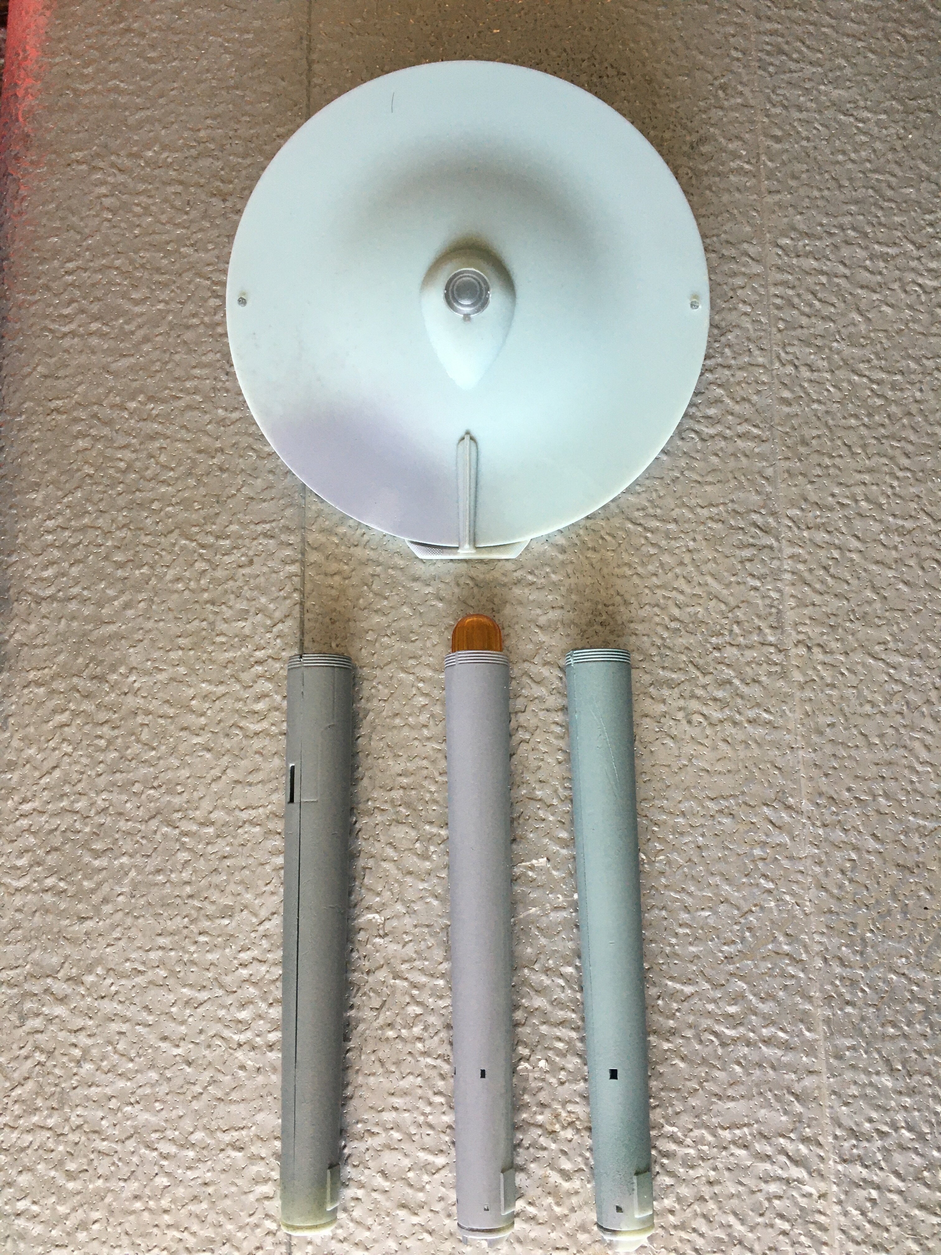

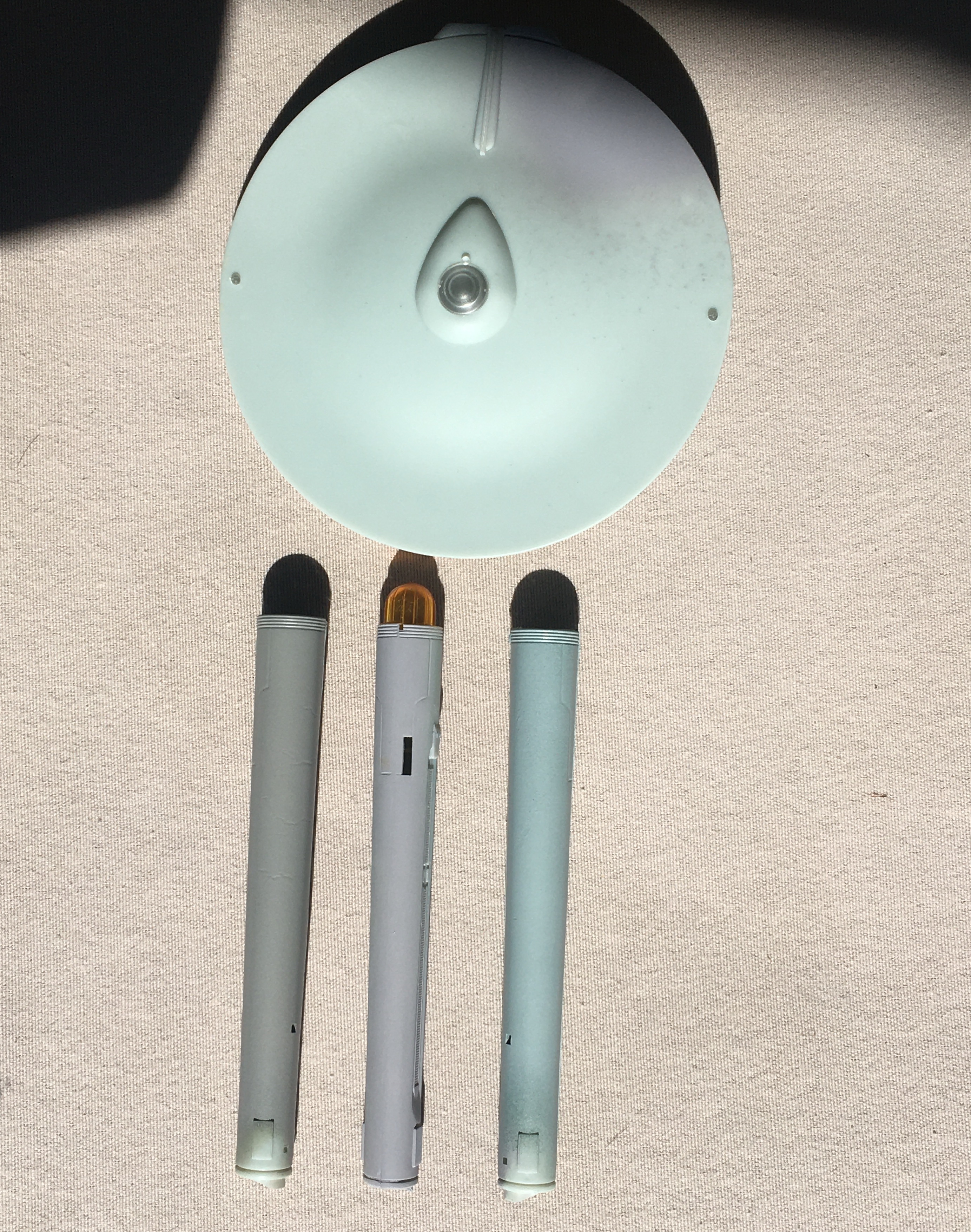

I airbrush my 1/1000 Enterprise models with a 50/50 mix of Tamiya XF-12 JN Grey and XF-2 Flat White, which is lighter than Gary Kerr's recommendation of a 10% addition of Flat White to JN Grey to match the hull color. I do this because I typically add several coats of clear to the model, which darkens the final finish overall, and also makes the decal film completely disappear.

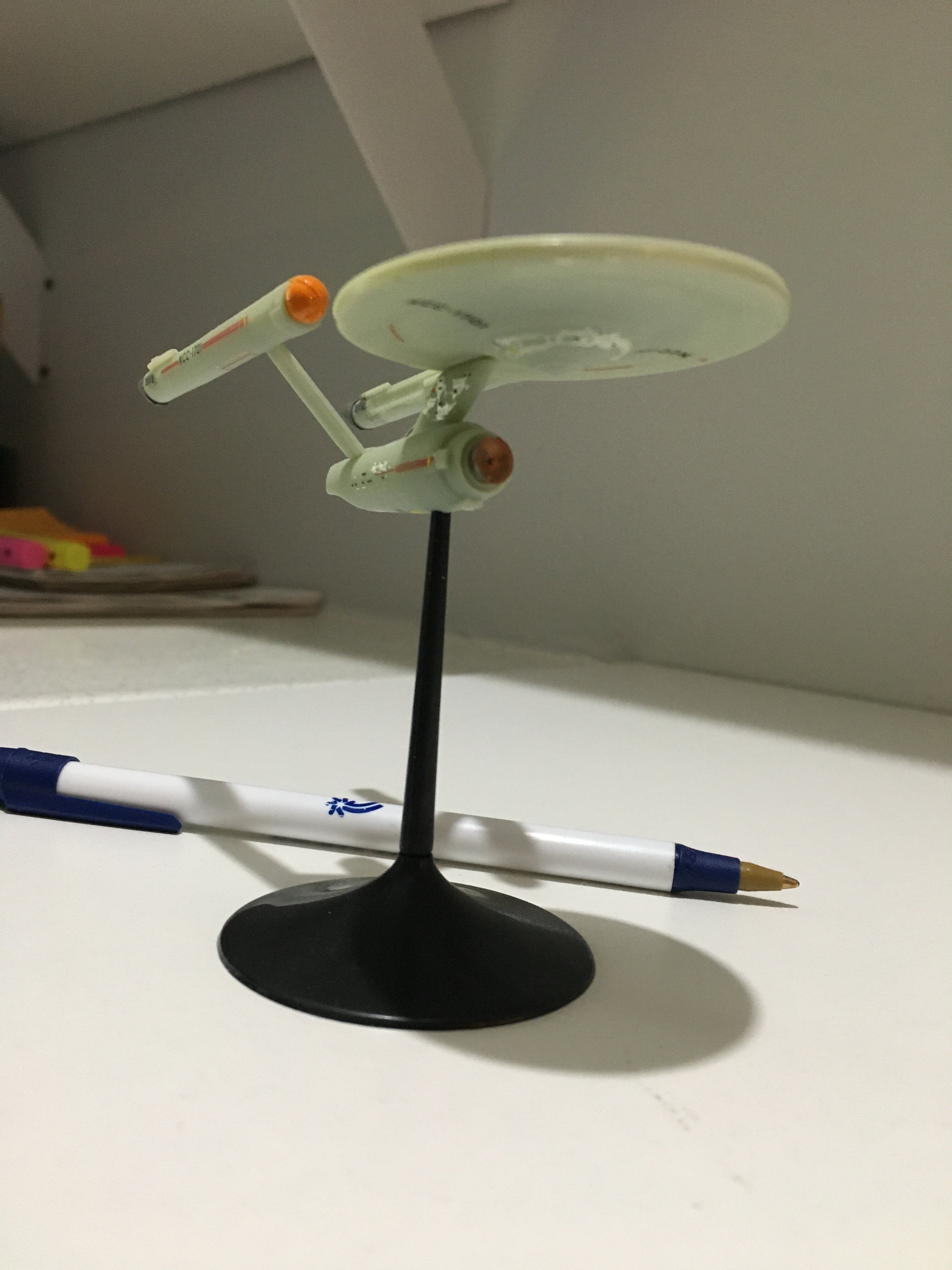

I'm wondering how the amber paint will turn out. Remember, that may be an accurate color for the actual domes, but, when lit from within, they'd appear much lighter. I've used clear orange on mine to simulate the lighting effects. I suppose it depends on whether or not you're depicting a powered-down ship.
