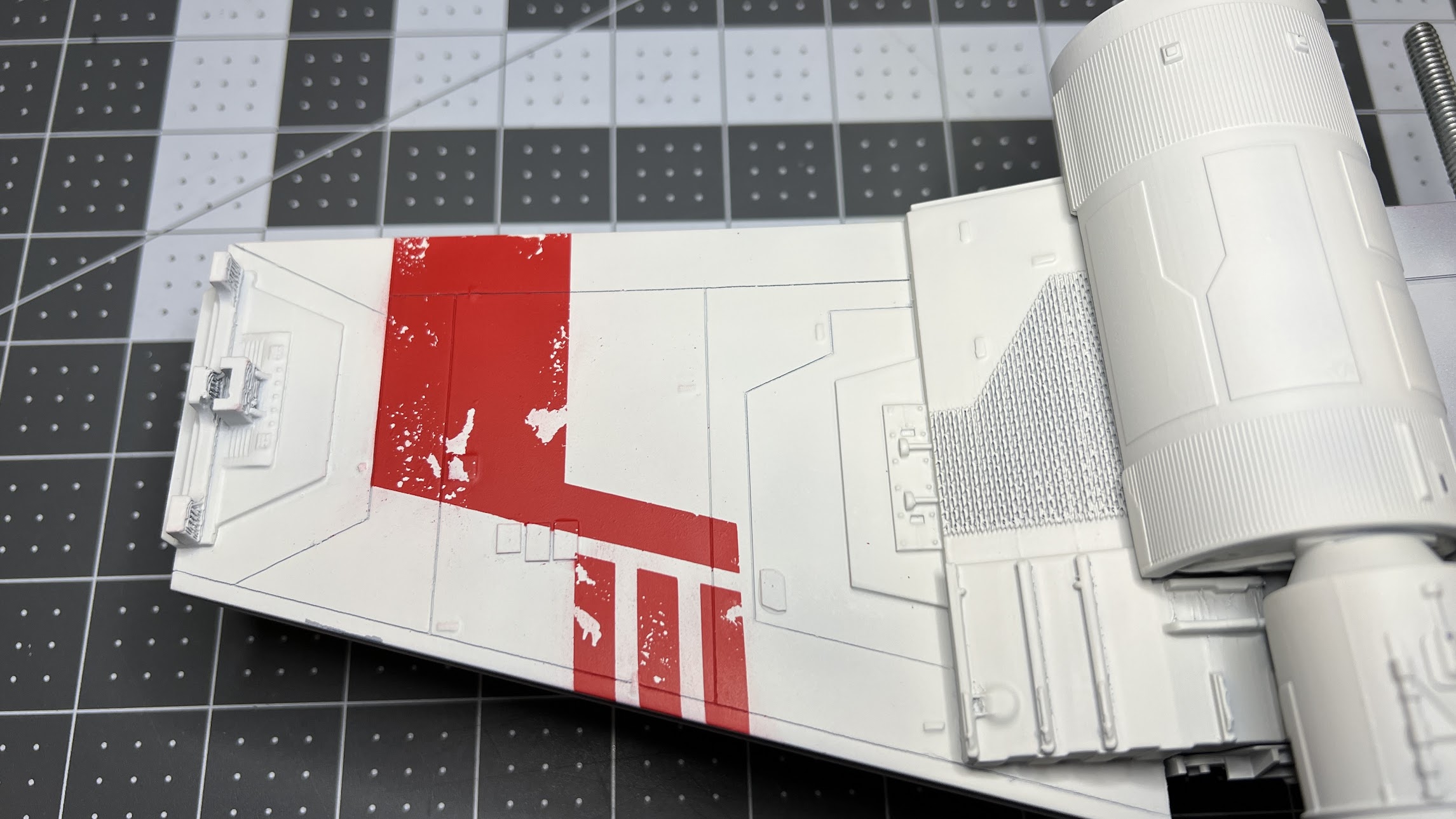

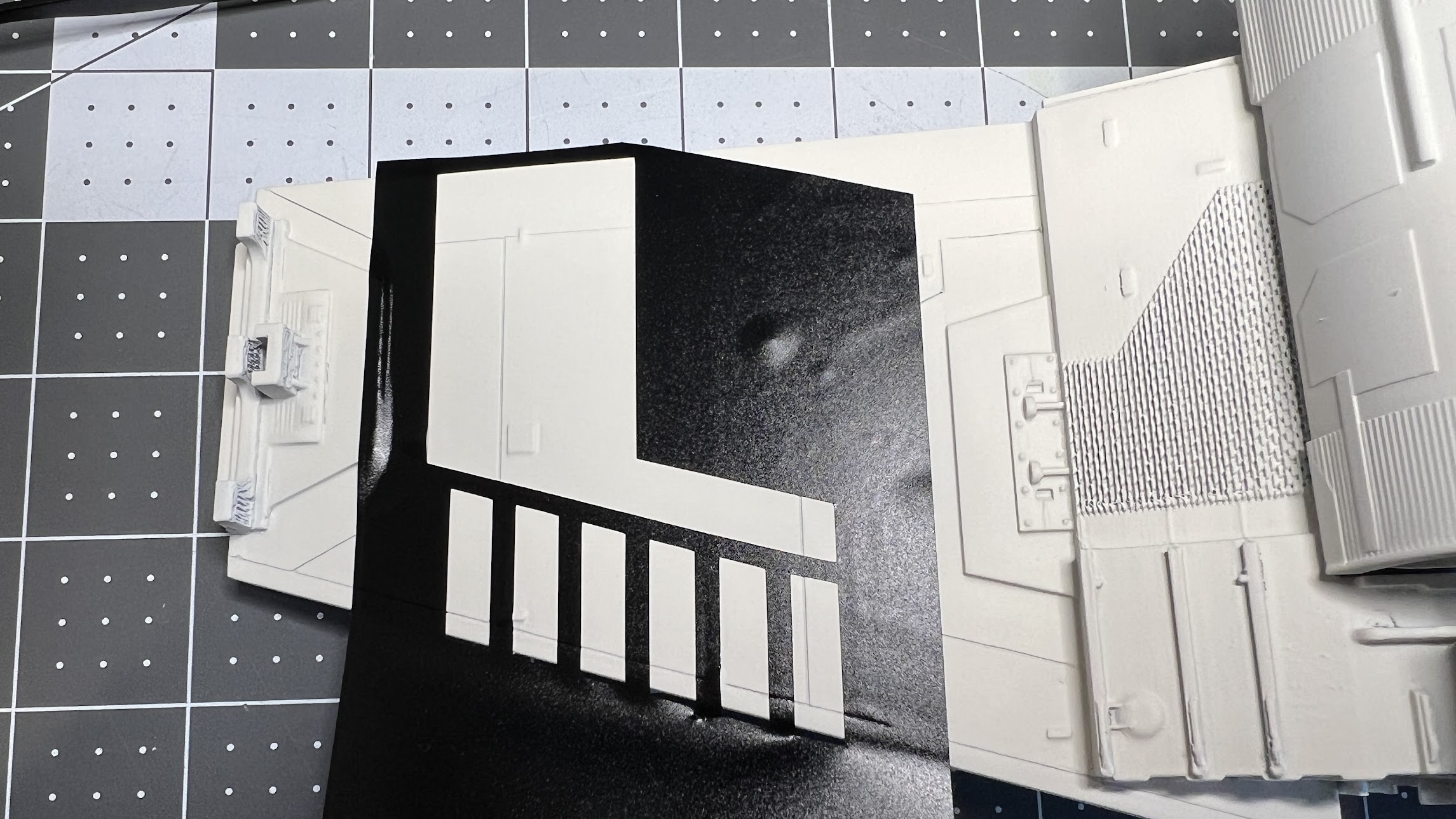

As others have stated, paint masks. I designed this one in Adobe Illustrator for my SS X-Wing, and cut it out on the Cricut 3 with a low-tack vinyl.
