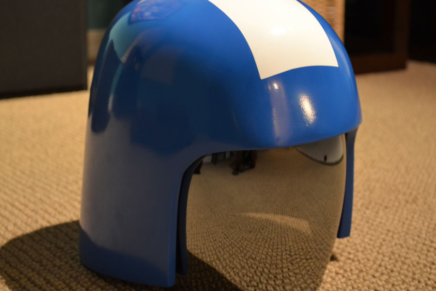

8/29/2013 Update: Here's the final product (more pics in the thread)

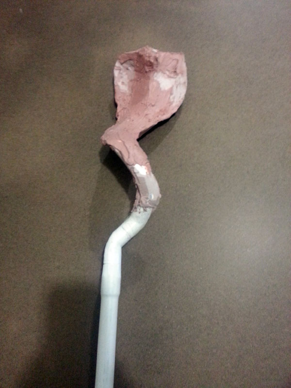

8/28/2013 Update: Here is the helmet painted before the stripe was added. I also included my friend's incredible Bondo/Dremel work on the Cobra Commander Staff and a new blog link covering the staff:

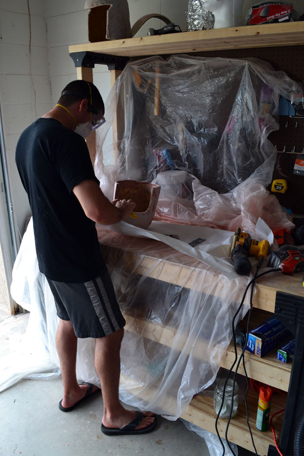

I decided to rondo one helmet and fiberglass the other. Rondo-ing was a thousand times easier than fiberglass, but it feels quite a bit heavier. The fiberglass also warped the hell out of the blue helmet. One side already had a dent, but the fiberglass just amplified that defect. Hopefully some bondo and sanding will take care of it.
I'll let those helmets sit overnight. Tomorrow I'll cut off the visors with a dremel and sand down all the fiberglass pricklies. If I have time, I'll start the bondo process. Here are the current pics:

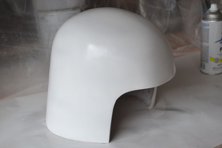

I dremel'd out the visors, sanded down the fiberglass, and slapped some bondo on them last night. This is my first time ever using bondo and I think I went a little too thick--I slathered it on like stucco. Got some serious sanding to do. Here's the latest:
I sanded down the final Bondo coat this morning. After four full coats, it's ready for touch-ups with the Bondo putty and, finally, I'll Bondo the trim of the helmet to sand it more rounded. I'm also starting on the visor with plexiglass and window tint.

I mounted the visor according to an awesome tutorial on the 405th forums. I used JB Kwik Weld to mount some 1/4" threaded aluminum posts with screws. Then I drilled matching holes into the visor that were slightly larger than the posts. Perfect fit!
I'm using a silver open face motorcycle visor. I'm content with its darkness, but I want to make it a bit darker and hide my face more. I'm testing out spraying VHT Nightshades on the back and airbrushing a light coat of Model Masters Aluminum Plate on the front. We'll see which, if any, will work for the visor.
