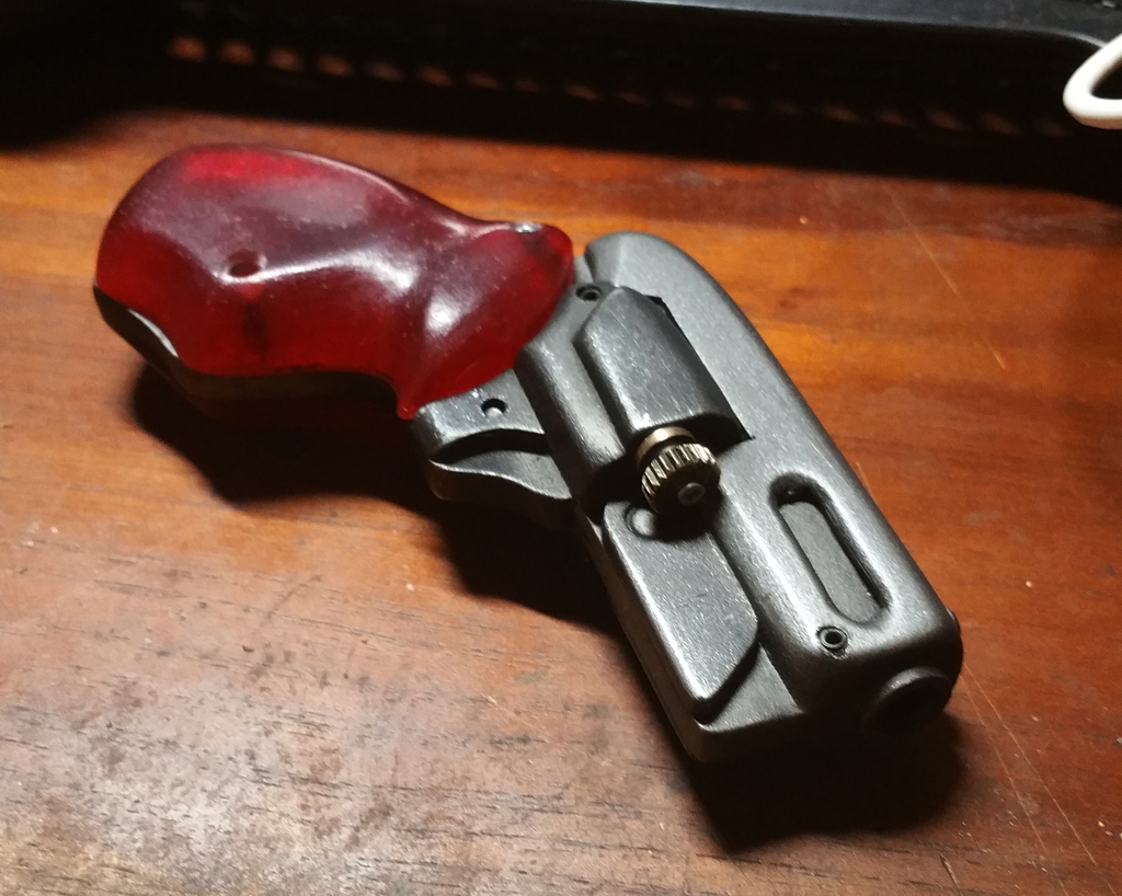

I've used graphite powder a number of times on prop guns. Just sort of wiped it onto the areas where I wanted to give it a metal look. I've also taken the stick of graphite and run it along sharp edges on the prop to bring out some edge distressing. It looks very good when its done, and if you're not planning to handle the prop, just display it, you can leave it as is, but if you're planning to handle it, you will need to seal the graphite.
I've usually used Tamiya flat clear to seal graphite, you don't need to give the piece a heavy coating, just a quick pass or two to seal the powder. Be aware though, that it will dull down the graphite a fair bit. These days I'm more fond of laying down a black gloss coat, going over it with a silver/chrome color, then laying down a coat of flat black. I do my weathering with 000 steel wool and a very light rub across the prop to slowly bring out the silver undercoat.
