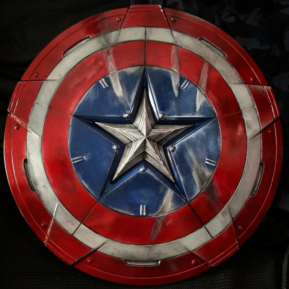

Also thoughts on this il_570xN.863265139_bq8b.jpg?
The only problem is its 22.5 inches but it is made out of Carbon Fiber
