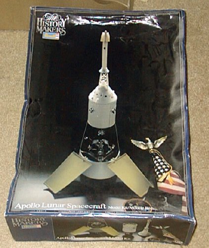

The Y's upper and lower head looks like it could be one of the clam shell panels that house the LEM in the Revell 1:48 Apollo: Lunar Module Eagle & Spacecraft Columbia Kit # 04808.
