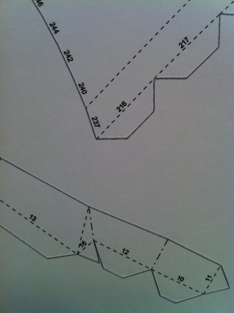

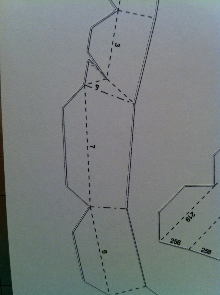

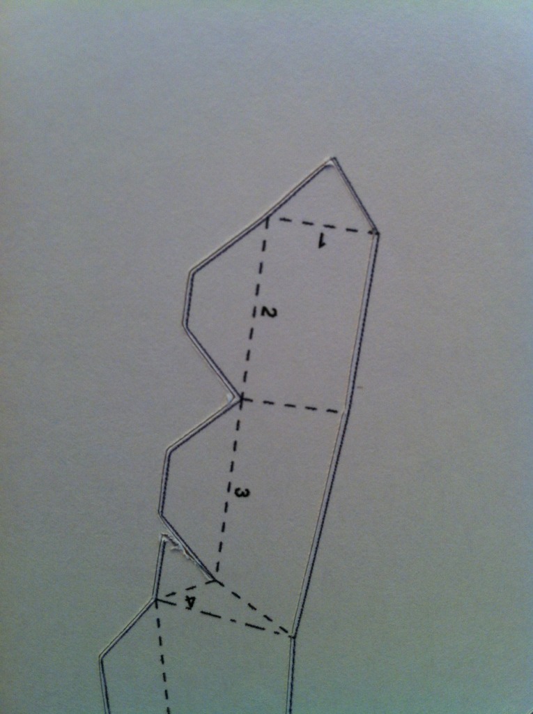

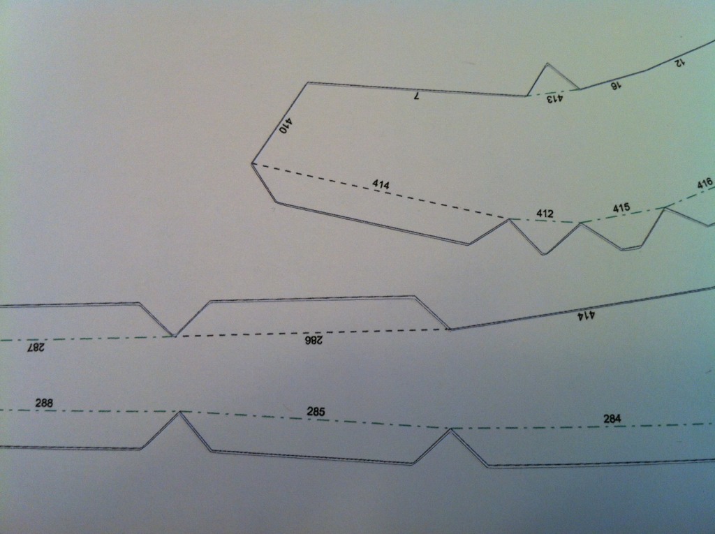

I folded and bought one and determined to get it right. I've come dang close. But ran in to a hiccup, if I set it to one setting it will print alot of it on the line but the rest will be off. These little errors I'm worried will make my pep be off scale/ wrap/ look like crap.
If I change the setting it will print better in the problem areas but then bad in previous good areas.
Here is one scale

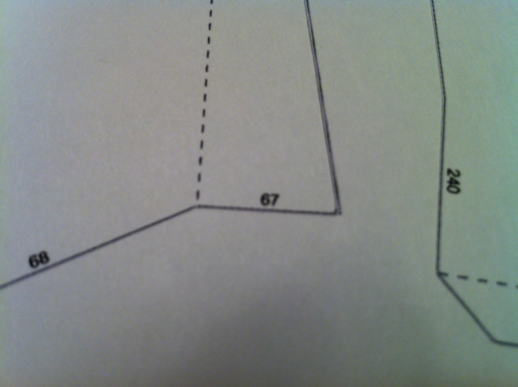

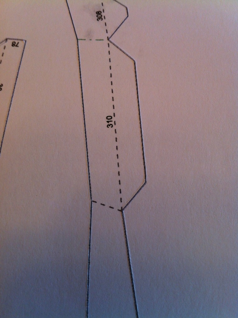

ImageUploadedByTapatalk1371865051.055571.jpgImageUploadedByTapatalk1371865067.550072.jpgImageUploadedByTapatalk1371865082.054159.jpg

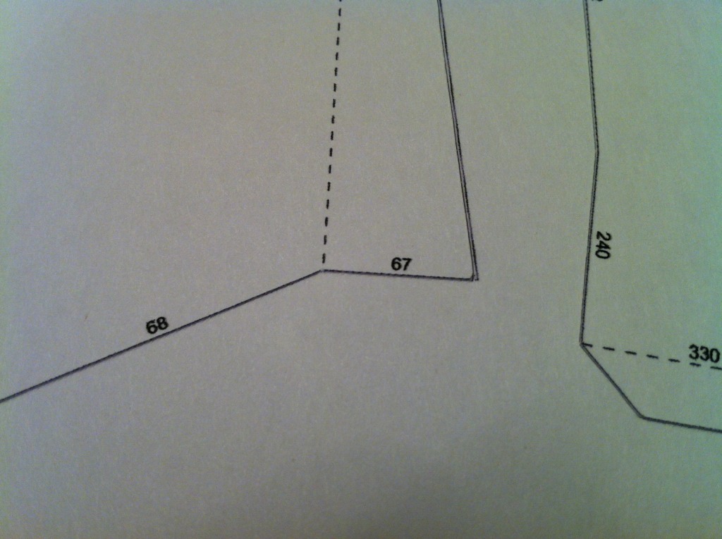

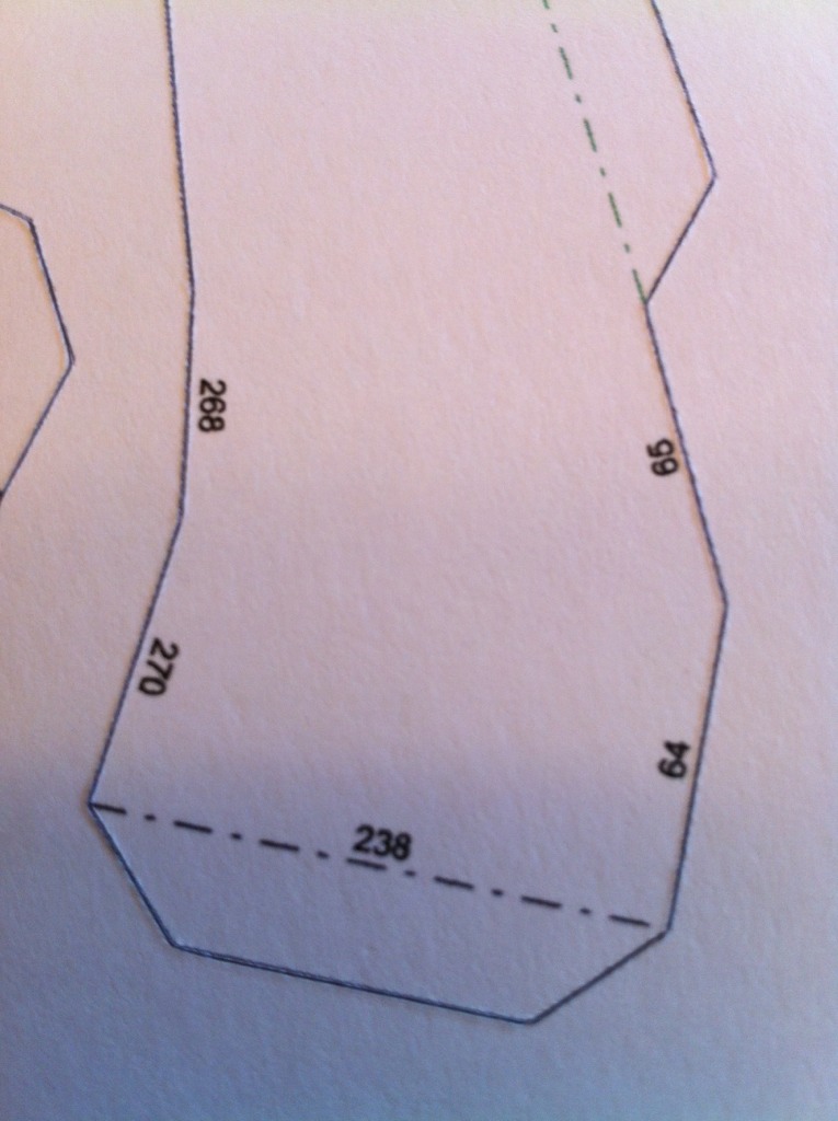

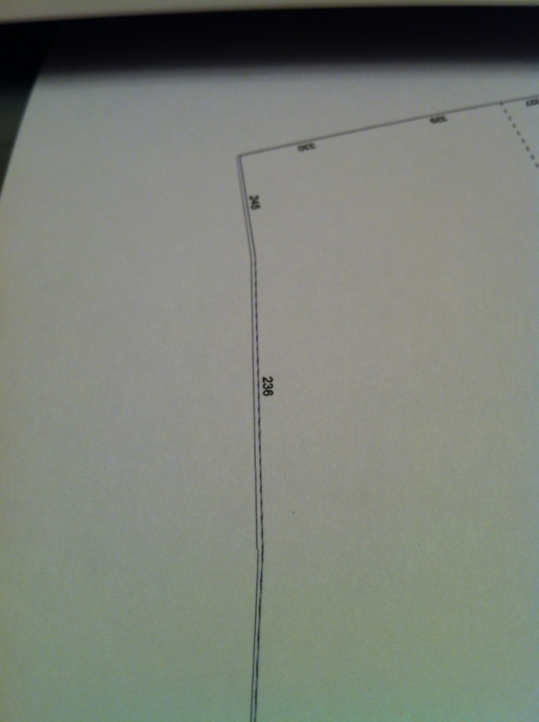

Here is the other scale. Look at number 66 for differences. This is what I'm referring to when I say it cuts good on area and not so good in another, change scales and the portions that were good/ bad flip one another

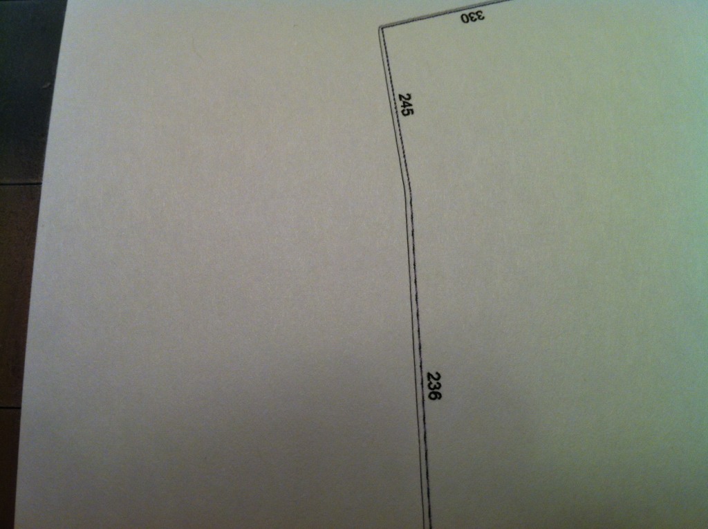

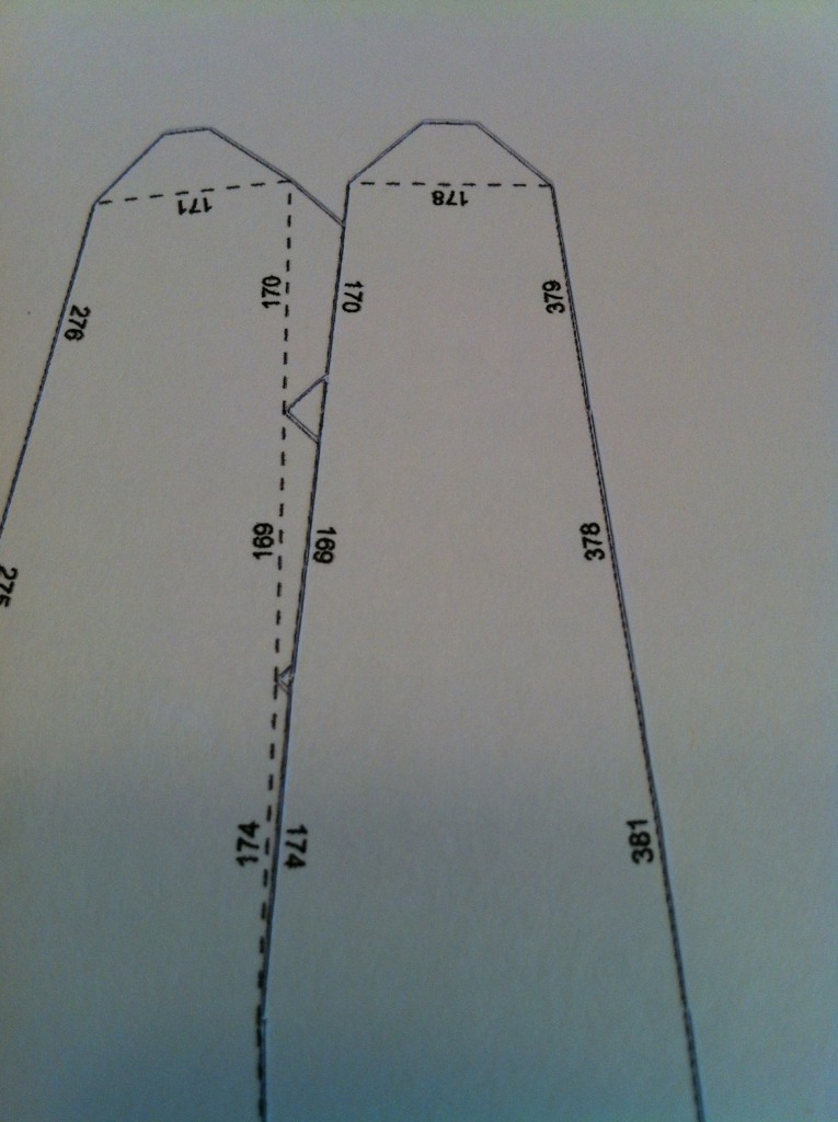

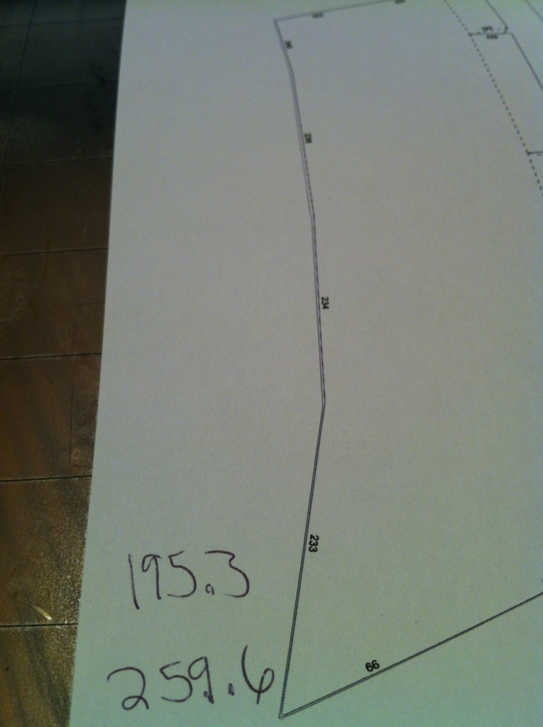

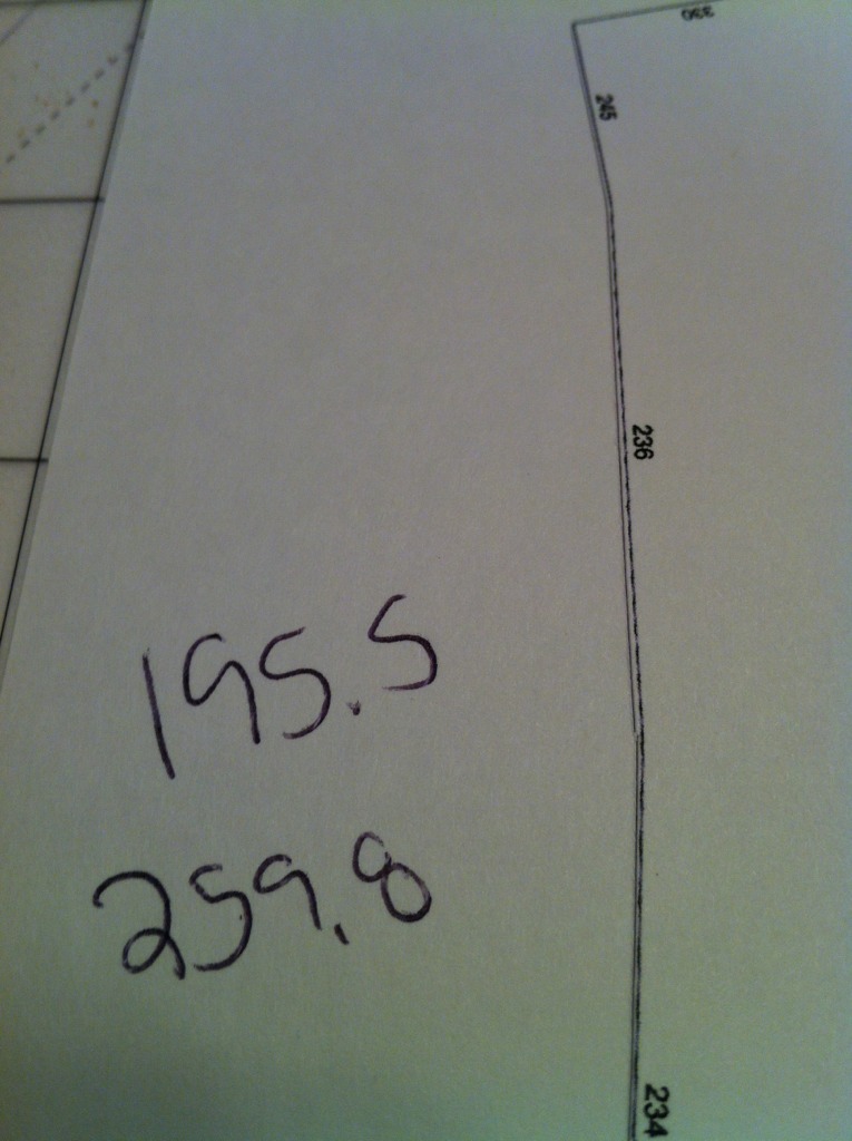

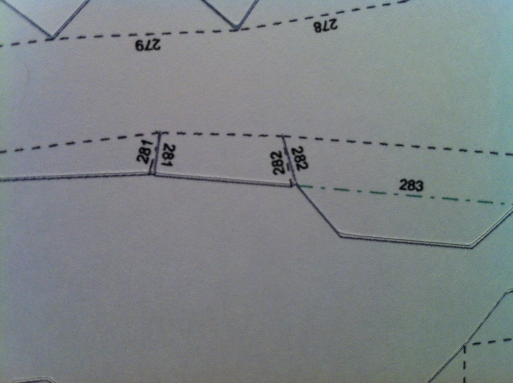

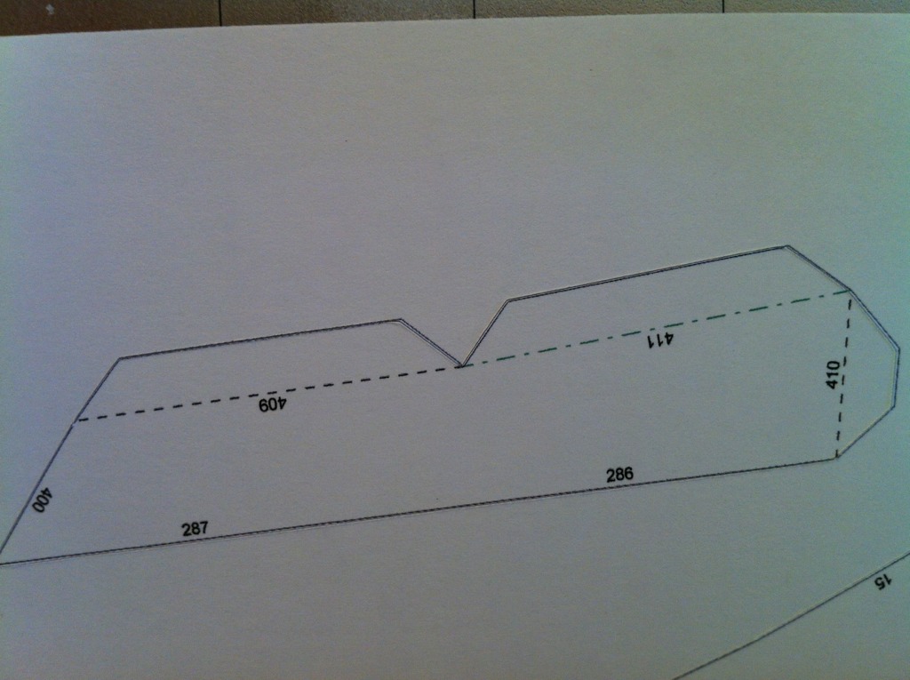

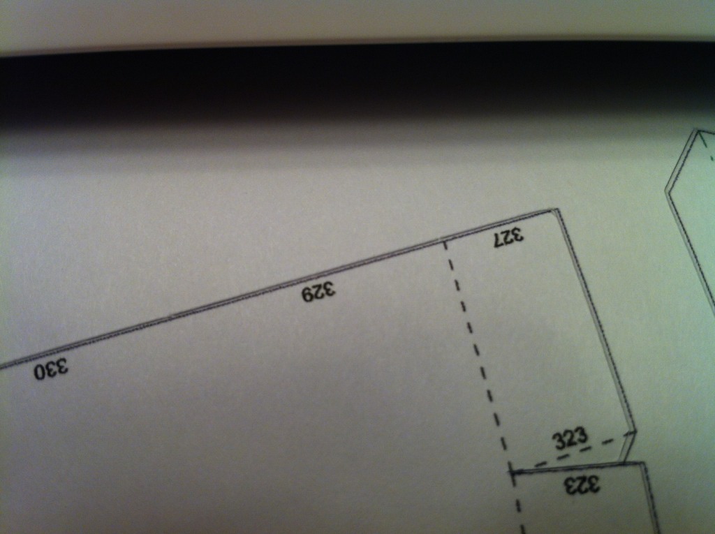

Mike. I went to 195.4 and 259.7. And got this. Part of the page is perfect. The other side is good but not 100%. If I go up in numbers or down the end results gets worst. Dunno what would case part of the page to be off
ImageUploadedByTapatalk1371917202.218166.jpgImageUploadedByTapatalk1371917245.306201.jpg
Mike would you mind throwing up a picture of what end product you get?
Update. Use 259.5 and 195.5. Parts are perfect then smallllll proportions are not. Worried that it will throw off the pep if this happens, of course the flaps don't matter. I'm about to go back to do it by hand lol
I don't really have anything to cut at the moment and I am tied up doing other projects too so I can't really cut out something right now. My results are similar to yours. I am not sure why or how to make it better. I have not looked into it a lot since it is close enough for me. It doesn't really effect the final pep much.

In some cases though it will match up in one corner and then as you move towards the opposite corner it will gradually get further out of alignment. This indicates that the scale is changing and so if you were to cut some pages by hand (like the really intricate ones that the Cameo can mess up on) and the others with the cameo then they may not match up. I do agree that at a point it gets close enough not to make a difference. But I would not have just been able to use mine out of the box because I did have this scaling issue.
