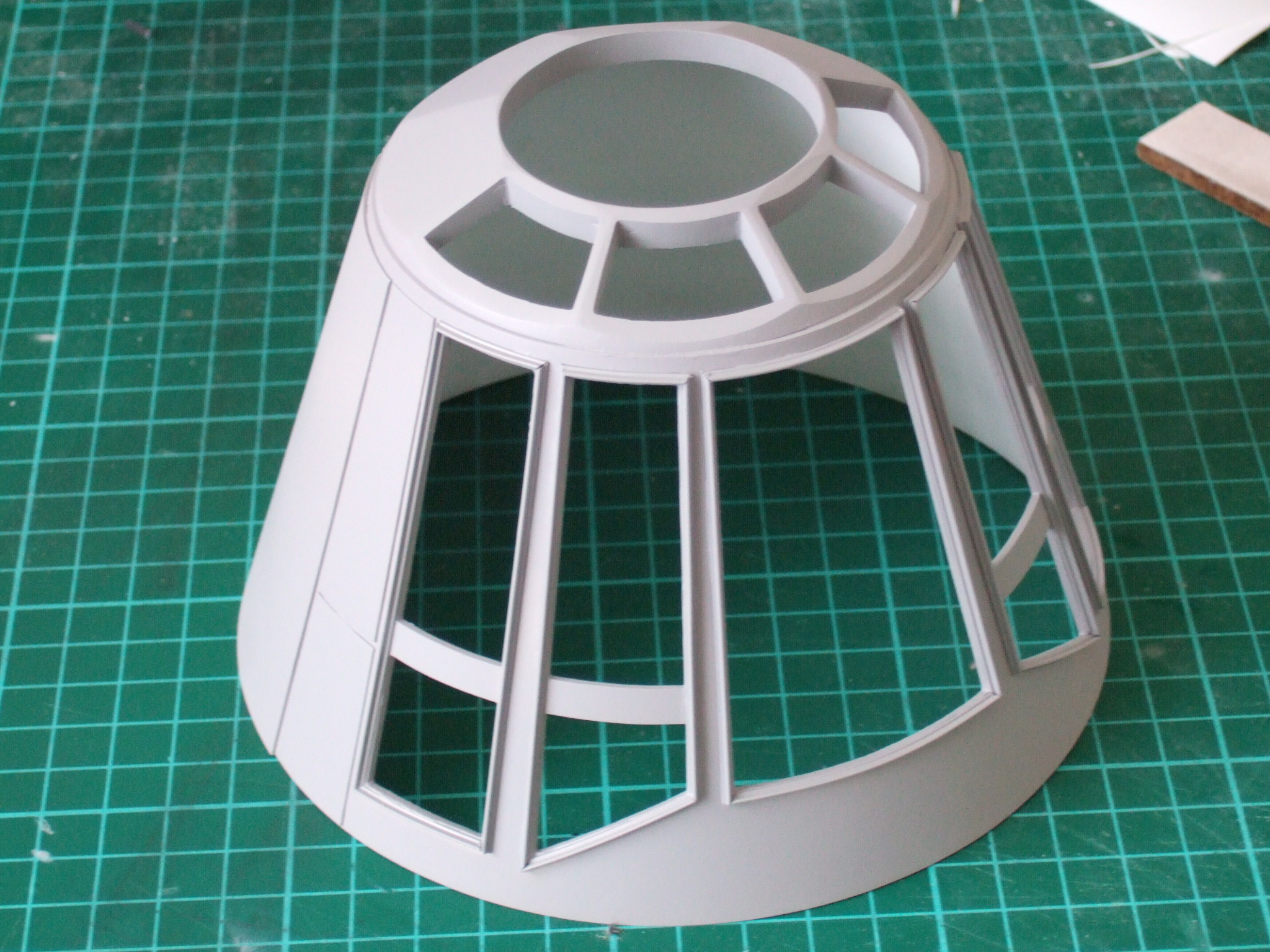

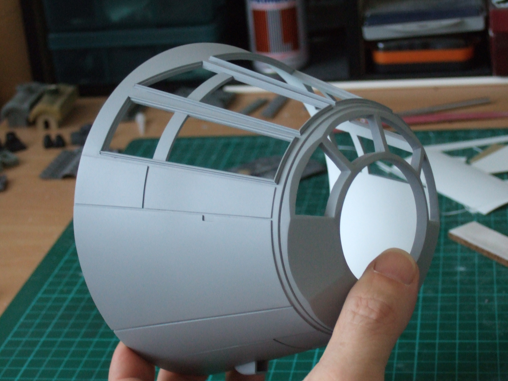

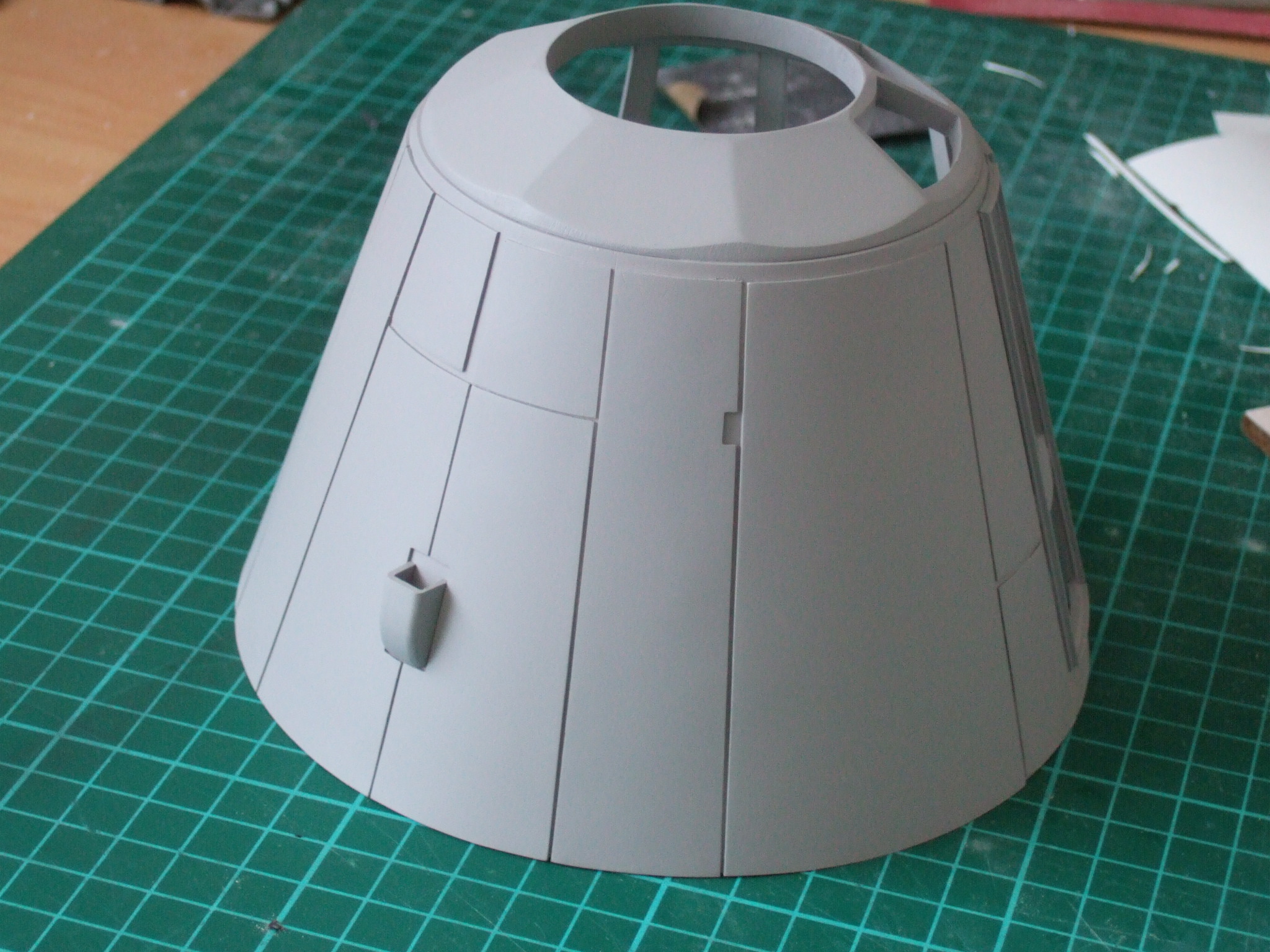

Well here's the Cockpit cone with all the underside plating & T-section window framing in place. This part really came to life after adding these details. Just 2 kit parts need to be placed on the underside, one of which I'm not certain to it's donor as yet.
The T-section strips were a real, how shall I say it, test, to cut right & place ok. I ended up doing all the long strips first, then adding the smaller ones last. These smaller ones are actually harder to cut just right, as they all needed to be just the right size to butt up to the long ones & have to be pre-bent in both directions to get a good joint & not be struggling to hold while glueing. Also each corner is mitred, most at a 45 degree angle on both long/short strips:wacko
I made a quick jig out of styrene to sand the 45 degree angle on the strips for a better fit, worked ok.
Studying the actual cockpit ref, I noticed the T-section strips were a mix of mitred & butt joints, some quite noticeably butt joints. I decided to try & be neater & go for all mitred. The difference is minimal, but the end result looks fairly identical.
I'll be working on the cockpit tube itself now, so is coming together gradually.
