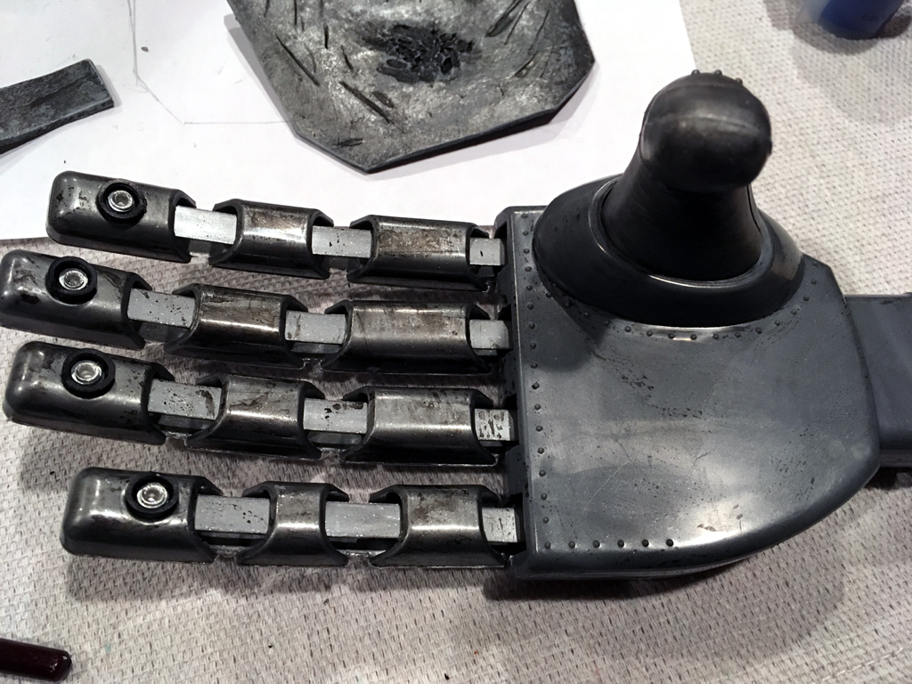

(stock toy hand and photo reference)

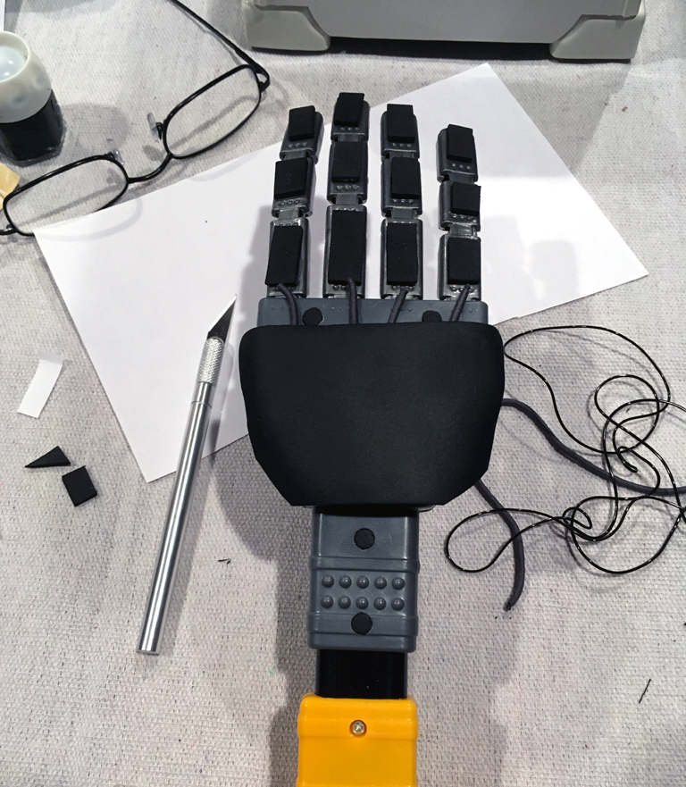

I started by cutting out a piece for the back of the hand, along with strips for each finger segment, varying in length and thickness after measuring between the faux rivets on the toy. I also did a couple of strips for the side of the hand. I'm not going to worry about the thumb or palm of the hand, nor the other parts of the fingers. In the movie, Luke's fingers have plates on each side but even with thinner foam it would take up too much space to look good. I'm opting more for general look & feel than picture perfect replica.

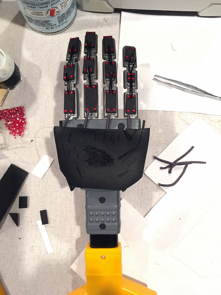

Once I had everything cut out, everything received a burst from the heat gun to help create a better surface for the Plasi Dip to stick to and shape the foam as needed. afterwards, I used four micro beads per finger segment plate to create the bumps (rivets?) that can be seen on each one and glued them in place with Elmer's glue. A lot of fans had spotted in the trailer that Luke's hand still bore the blaster damage from RotJ, so I opted to include that, which I recreated using a soldering iron and creating a center point then just lightly dragging out and away from it and varying the burn depth for a bit of texture. I then switched to a hot knife (re: wood burning kit with a blade attachment) to mark up the foam with a bit more wear & tear damage, but went a bit too overboard. Most of that should get covered up later after I attach some other parts. Wire and hair bands were cut to size so that they'll run under the ends of the foam, but still have enough slack so they don't get yanked out from the tension when flexing the fingers. Screws holes on the toy were covered with foam circles and glued in place. A round hole punch works wonders for getting those nicely shaped.
(initial sizing of the foam pieces, followed by the primary work on damage and rivets glued in place; wiring is just for appearance and not for final placement)

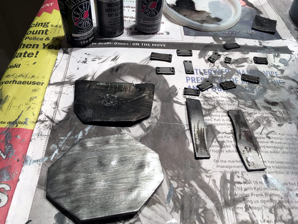

Next step was the painting... Plasti Dip went on first. This being my first-ever foam project, I learned quickly from various youtube videos that it's a MUST for any painted foam project. I allowed that to dry overnight before applying a base level coat of grey. That, too, dried overnight. On the third night I did an "ink wash" (to borrow a term from my miniature painting days) to weather everything with a mix of black, a hint of gun metal, and enough water to thin the paint down. Al the foam pieces received a liberal brushing, enough to darken the look and to soak into the cuts and dents. The toy hand also received a coating, which really made the plastic on the fingers look metallic from a normal standing view distance. [note: I was also working on a foam buckle, which is also in the photos, for Luke's belt. it received a base of tin paint rather than grey and a lighter wash of thinned black]
(base layer paint and wash of paint to weather things)
The wash only took about 30 mins or less to dry, so I switched to a sponge brush and dabbed on a light amount of gun metal paint to all of the foam pieces, then rubbed it around with a smaller brush. I wanted just a super thin coat to help cover over any base grey spots and darker areas from the black wash. I let that dry -- also another 30 or so minutes -- then did the same thing again but with the tin paint. After that dried, I took a tip of a flathead screwdriver and pressed it into a few areas of the finger segments and other areas to get a few more dents and dings. For the side of the hand pieces, i smooshed them together a bit to create wrinkles and dents. Afterwards, I went back and added a bit more black wash to the damaged areas with a small tipped brush to really make them stand out. Once that was dry, I used a drybrush method of a white & tin mix to create highlights on the damaged areas and edges.
(first pass on paint and drybrushing for detail; toy hand is shown pre-weathering job)
