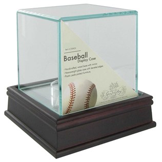

I started with a glass baseball display cube with a wooden mirrored base:
Hobby Lobby
The glass case is removable from the base, so I frosted it inside and out with a few coats of the frosting spray, then I lined the inside with the thinnest styrene sheet I could find. This helps give the cube a great diffused look. For the lighting, I ordered some LED panels from ebay with nine blue LEDs per surface. I used four total, and mounted them to a square of styrene I built.
I wired them all together, then wired in a switch and connected everything to a 12v AA battery pack I had lying around. Eventually I'll downsize the battery pack since it is a bit bulky and barely fits under the base

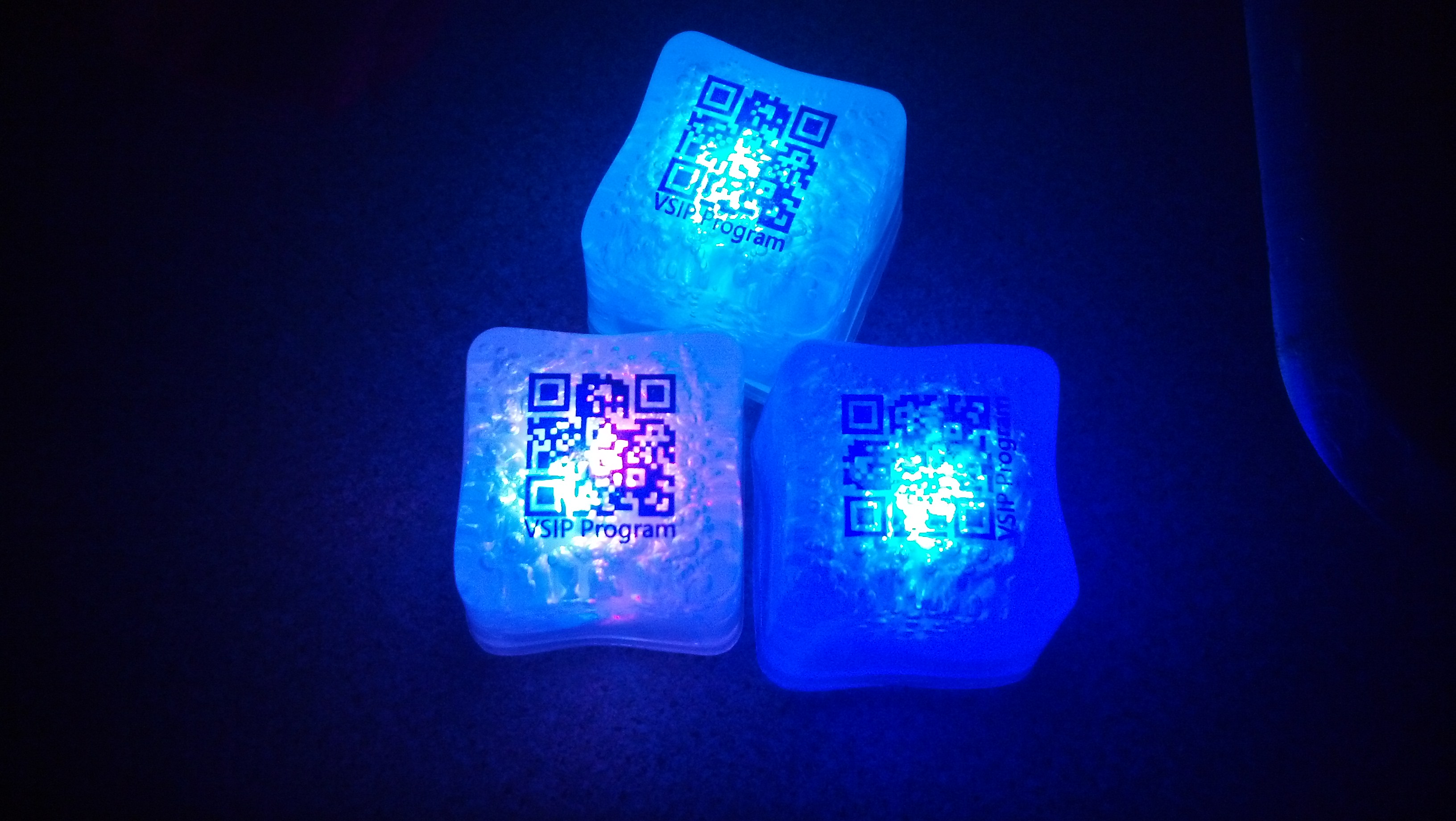

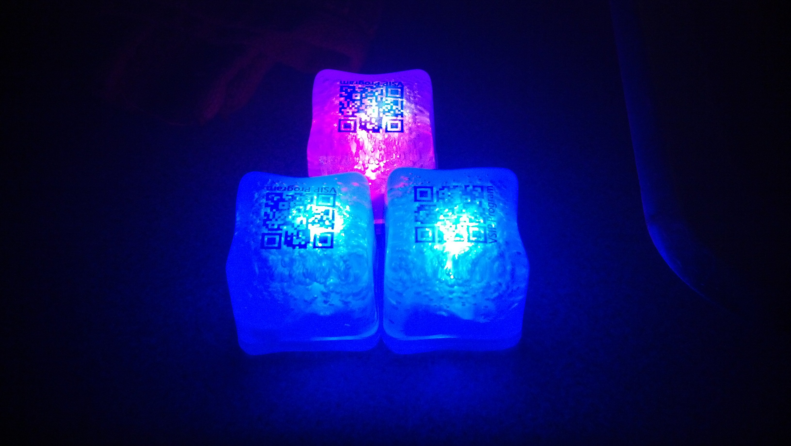

So while attending the Microsoft Tech Ed event last week I came across these Lited Ice cubes. They have 7 colors in each one and a rotating color swirl mode. I grabbed three of them to try out inside the cube. Not sure if 1, 2 or 3 will work best. I will try to nix the color combos to see what looks best. There is a white, dark blue and a light blue that seem useable. I still have to make my cube but will post pictures as I get them done.

IMG_20140520_233345_121.jpgIMG_20140520_233428_385.jpgIMG_20140520_233502_976.jpgIMG_20140520_233528_730.jpgIMG_20140520_233701_108.jpgIMG_20140520_233607_917.jpg
