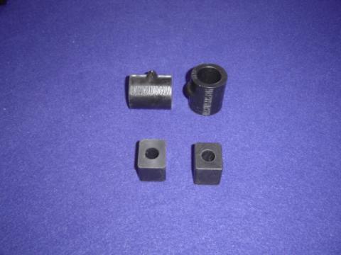

More info from the Datsun guy!
Hi Matt,
Some of the OE bushings may have had the slit in the flat side- will investigate for that and for a 5/8" center hole
Most of the OE bars back then were skinny by today's standards, but were probably all bigger than 5/8"
The smallest one I could find was from a 71-73 Datsun 1200 which used a 17mm/.669" bar- pretty close to 5/8" (.625")
Could be shimmed with a round or two of electrical or "friction" tape
Here are the OE 1200 17mm/.669" ones, but the slit is not in the right place
I am pretty sure all OE bushings are slit on the side now that I think of it
Some of the aftermarket ones of the same 1200 bushings that I found pics for, have no slit in them
Here are some square ones for the Datsun Roadster that looks to have a 5/8-ish hole- maybe the corners were pared off of one side...
https://www.datsunparts.com/assets2/cgi-lib.16196.1.jpg
I think there is no slit in these, but easily done with a razor blade
Will contact some of my Roadster peeps and get the exact dimensions
Regards,
Riley
If they are from Datsun none will be 5/8 - it'll be metric likely 15 or 16 mm
That being said 5/8 is a pretty small for any suspension part needing a bushing...
