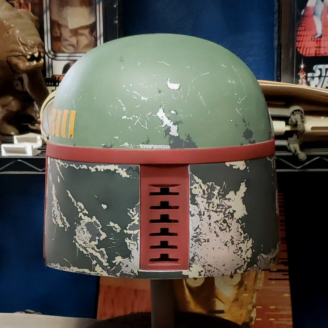

I got the red airbrushed on and have been working on the damage on those portions of the helmet.
The red looks very odd when it's first laid down. But the detailing will fix that. Here it is just after application.
I started the damage with the keyslot area. Working on the red areas allows me to use an additional detail color: a dark maroon/purple shade.
I've never found anything out-of-the-bottle that I like, so I mix up a custom color. Here's the keyslot area.

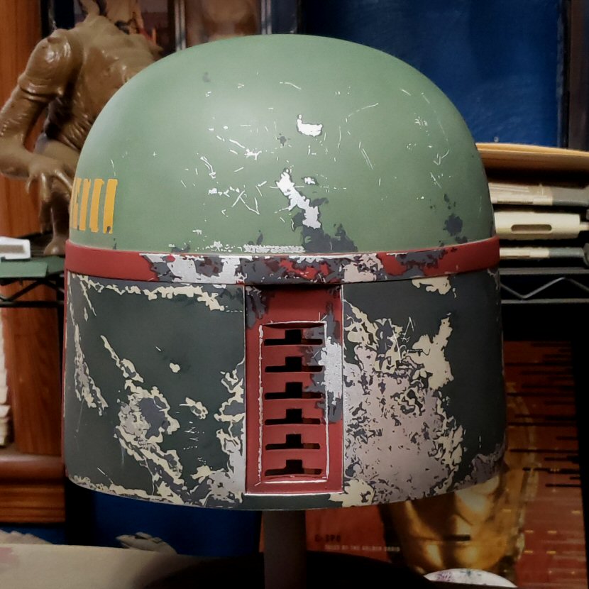

After that, I moved up onto the red band. I work this in three main sections. There are some good color breaks that let me focus on
one area at a time. I start with the center, then work the left and right portions.
So now everything behind the ear platforms is done! I'll start working on the front next.

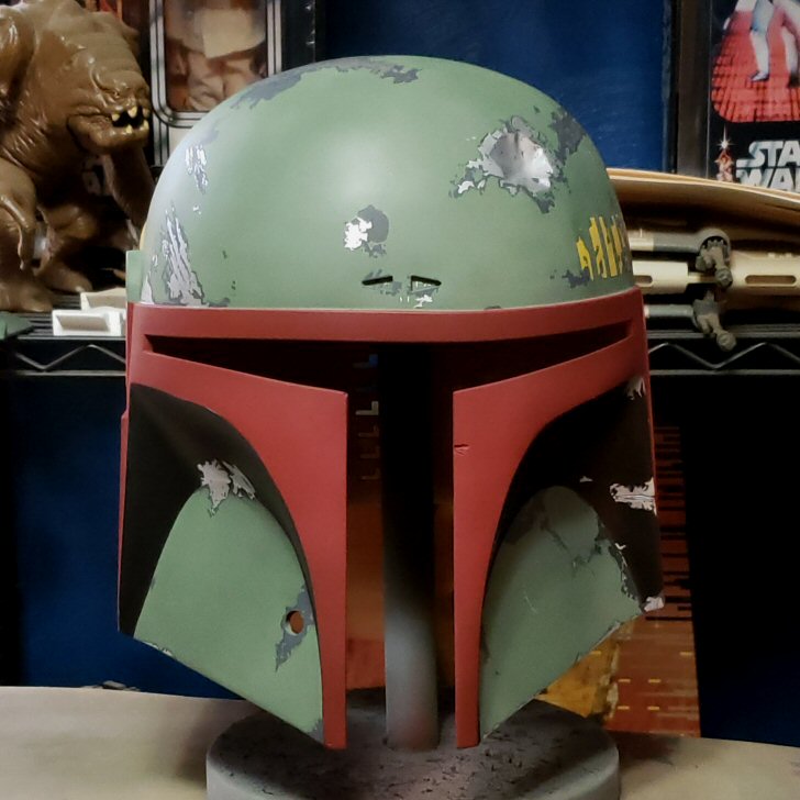

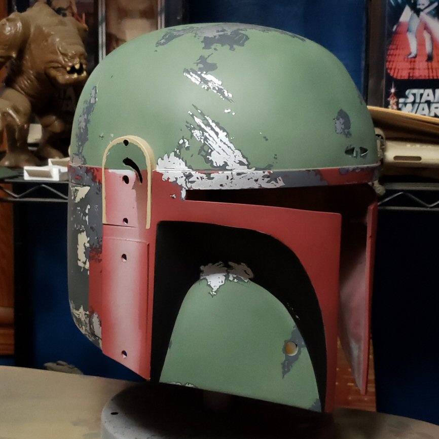

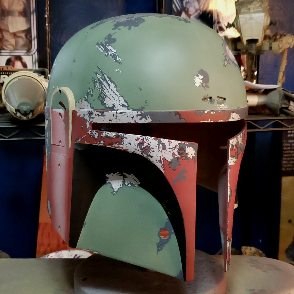

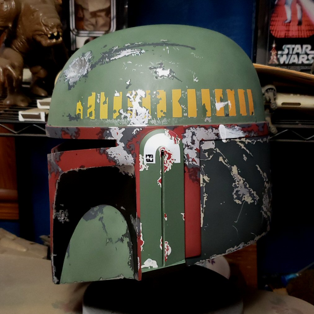

The front half of the helmet is coming along. Here are some shots of my work over the last few days.
To begin with, the area at the left corner of the visor opening and the left half of the brow. In these shots
you can see the work on the left cheek as well, since I forgot to post the cheeks when I finished them.
Next is the right half of the brow, as well as the right cheek.
Next I worked on the left mandible. Here are a couple of angles.
Finally for this update, the upper half of the right mandible. This area is an eye crosser! Lol
I break it up into two main portions, upper and lower.

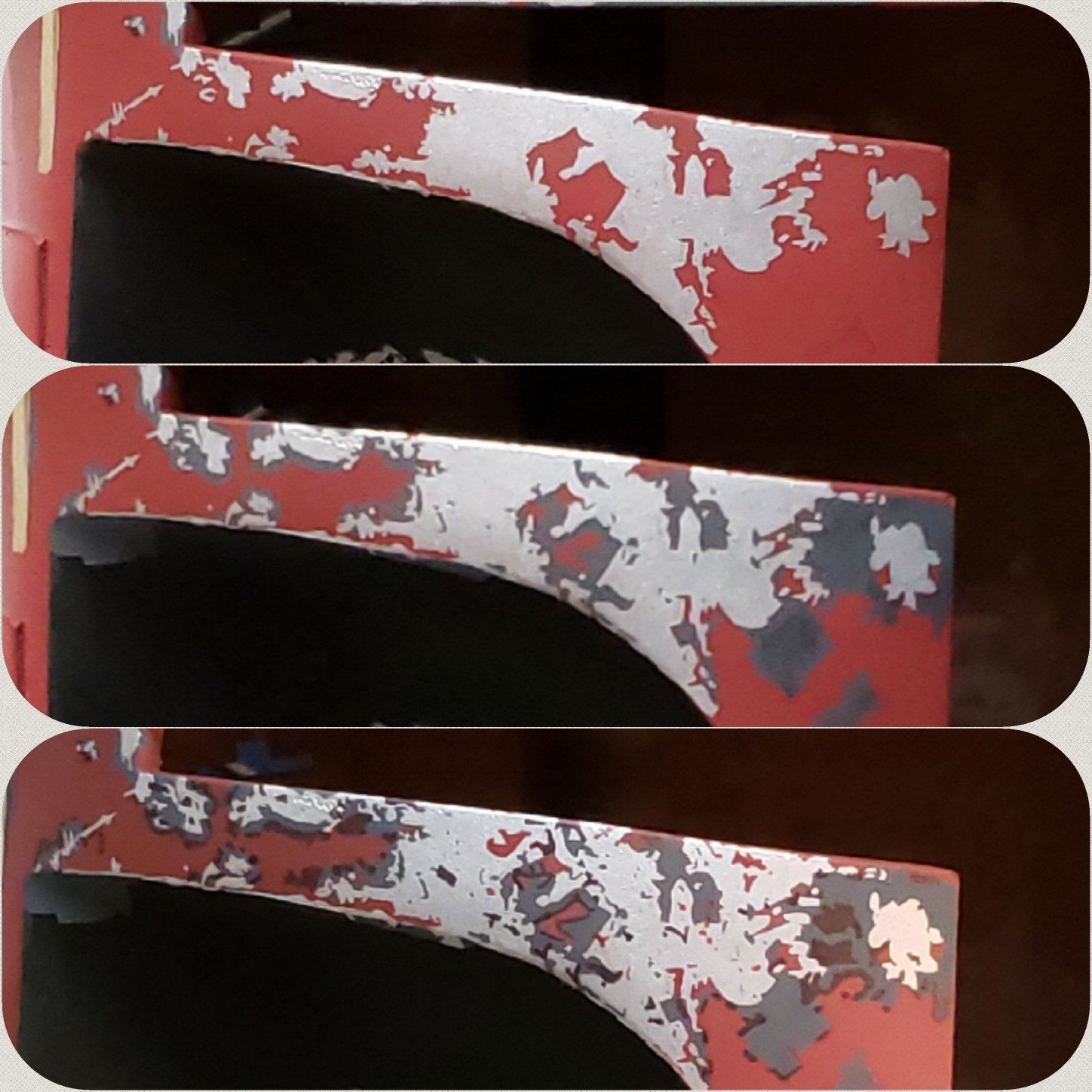

Here's an in-progress collage of the right mandible, showing the stages I go through.
First, the silver. Next is the gray. Finally I add the maroon/purple and base red details.

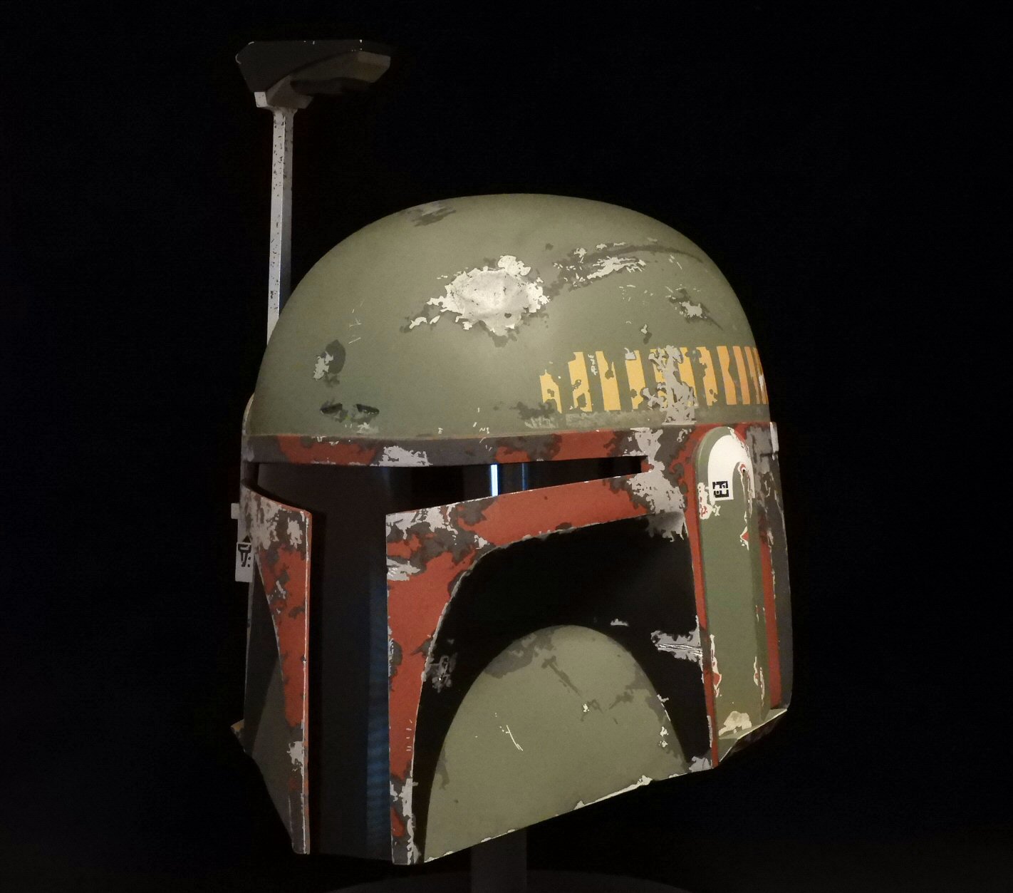

I use stencils for just about everything to get the placement of the damage. But I also have reference pics on my laptop screen while I'm painting
to make sure I get all of the small details and shapes in the right places.

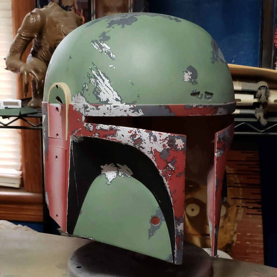

Lots more work done over the past few days.
I completed the remaining parts of the right mandible, which finished the "basic" painting of the helmet.

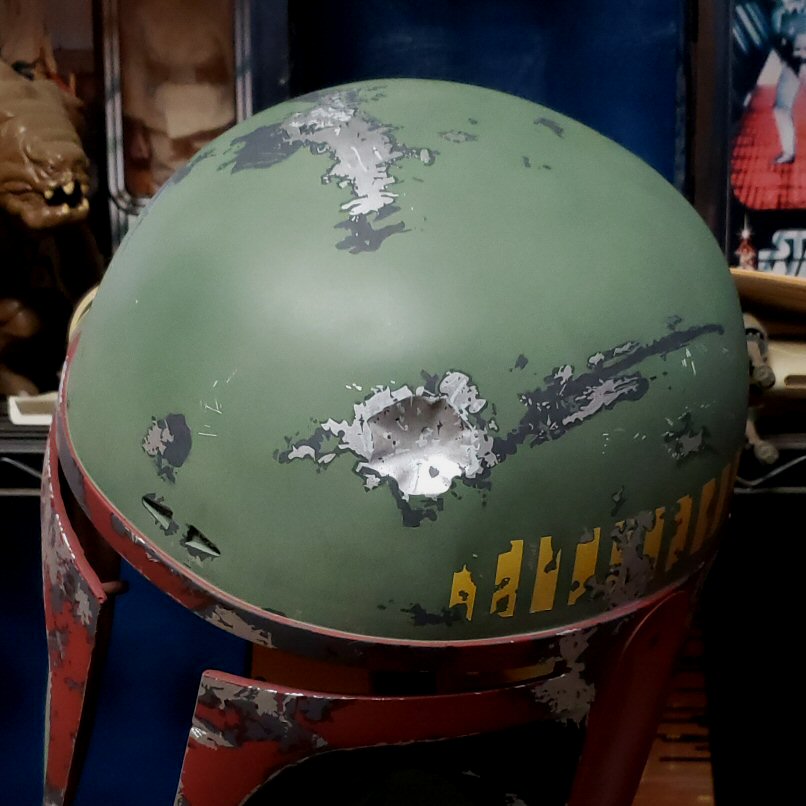

I moved on to doing some of the "effects" next. The pale contrasting gray is scattered around on different
parts of the helmet. The biggest concentration is on the right rear panel, but there's some on the right mandible
and around the dent, too.

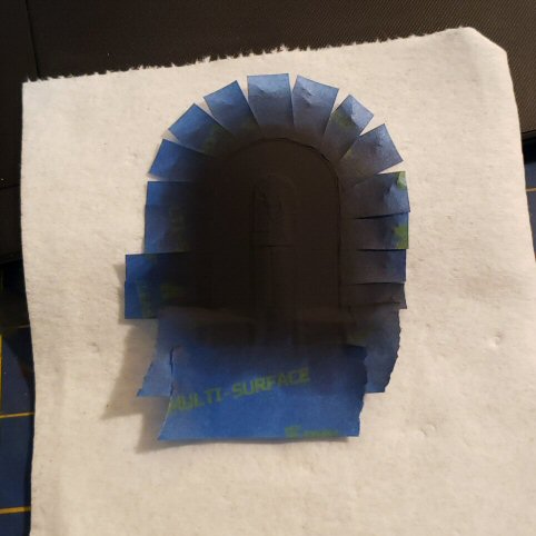

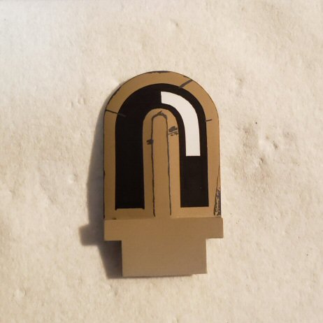

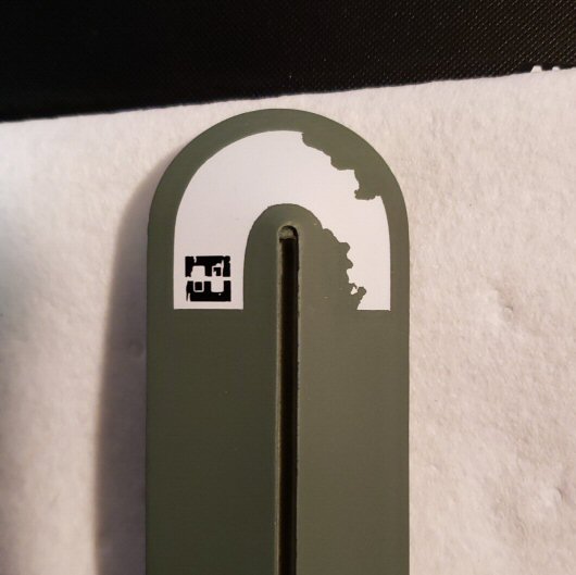

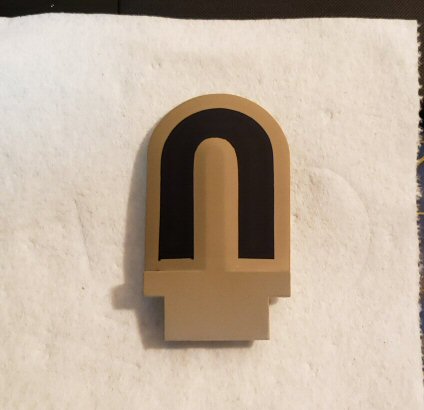

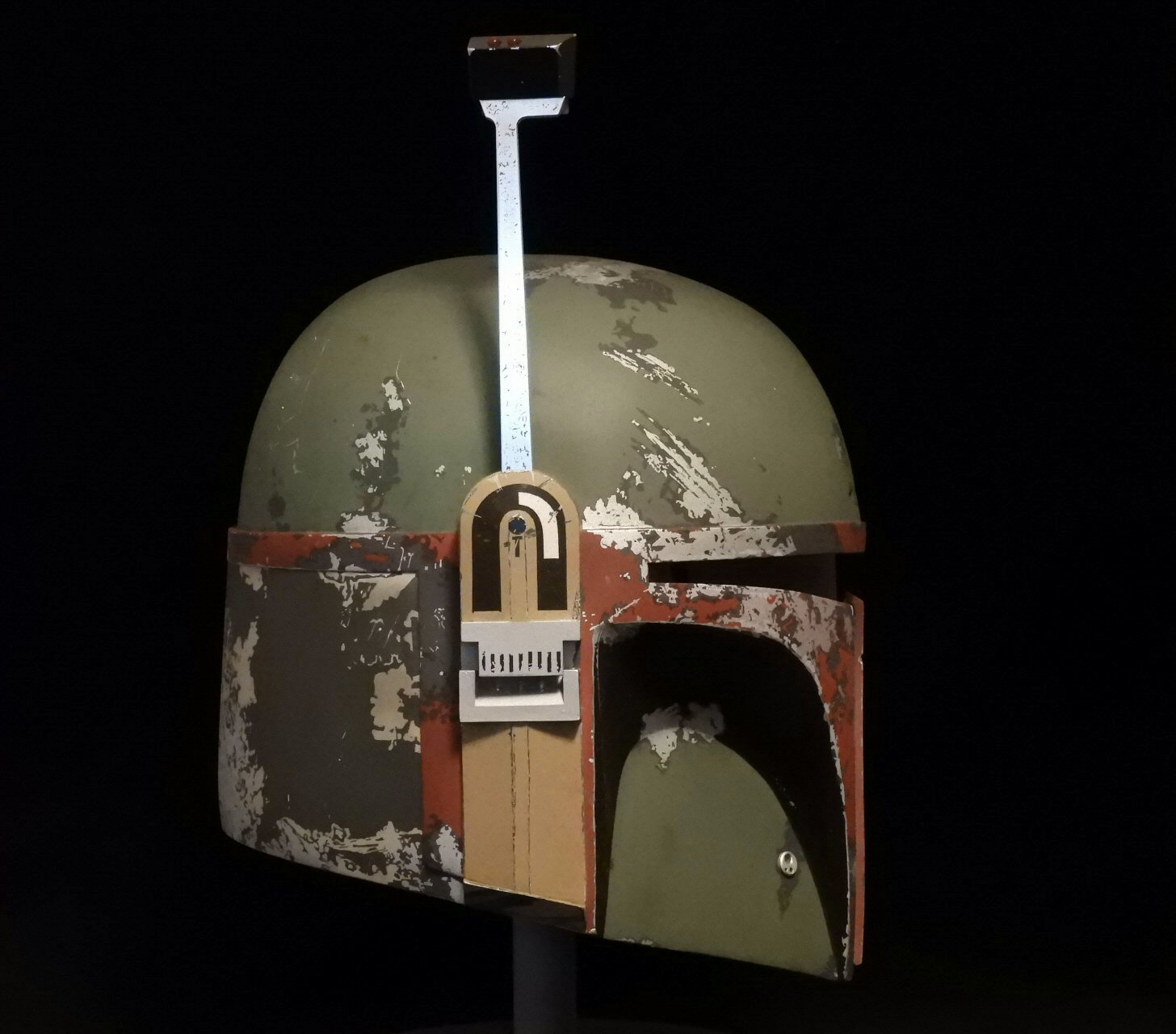

I started working on the ears as well. Here are the stages I went through for the left ear.
Here are a couple of shots of the beginning of the RF ear parts.
20180730_175126.jpg20180801_151239.jpg20180801_151258.jpg20180802_180644.jpg20180802_180659.jpg
Since these were taken, I've finished up the rest of the RF ear.

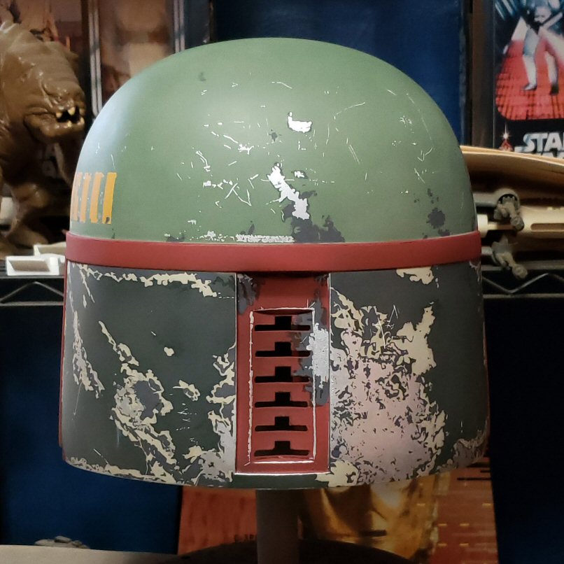

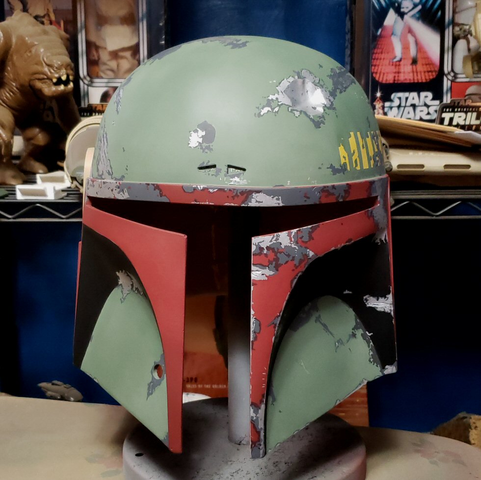

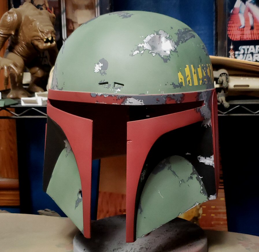

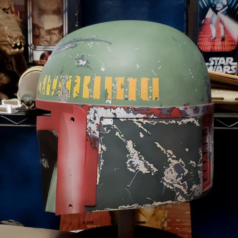

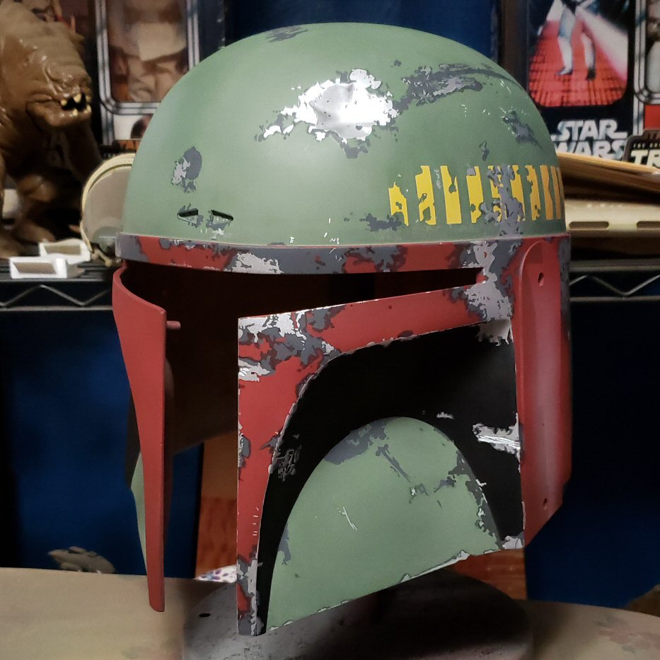

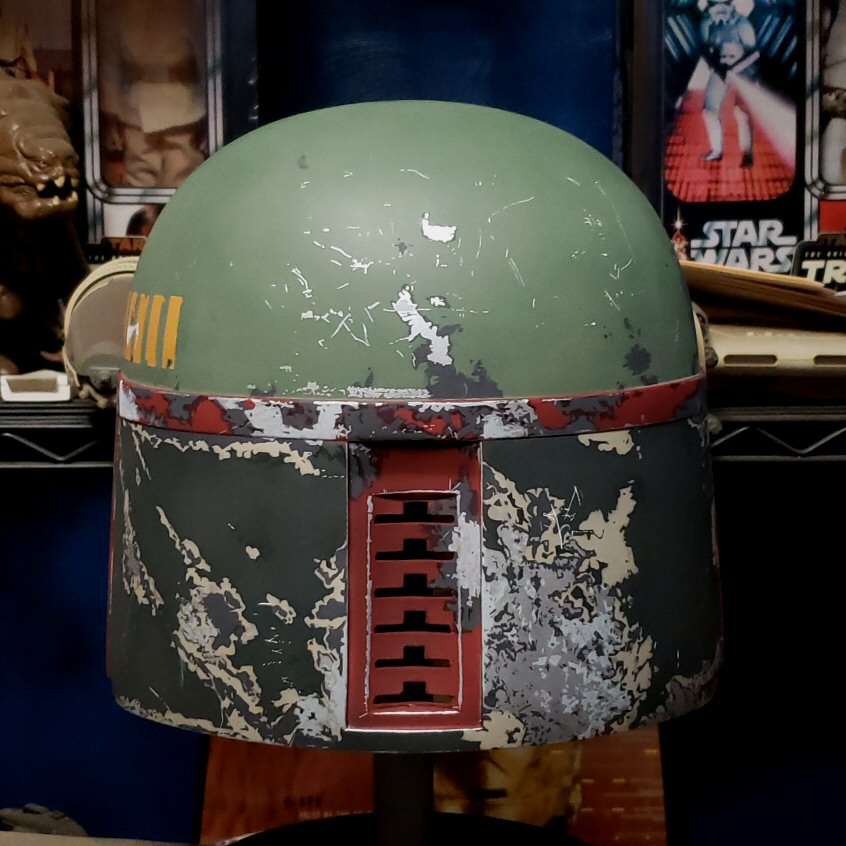

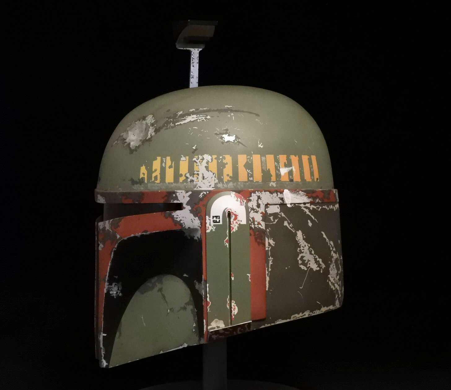

OK, this is it. . . the reveal! :) It's been a lot of fun working on this lid and in a couple of days it's going to get packed up and sent out
across the Atlantic. I always hate to send these off, but I know it will go to a good home. Here are some final pics.
Let's start with the front angles.
Next are the rear angles.
We'll finish up with the profile shots.
Thanks to Somerset for letting me add another ESB helmet to my portfolio, and thanks to
everyone who followed along with the progress!
