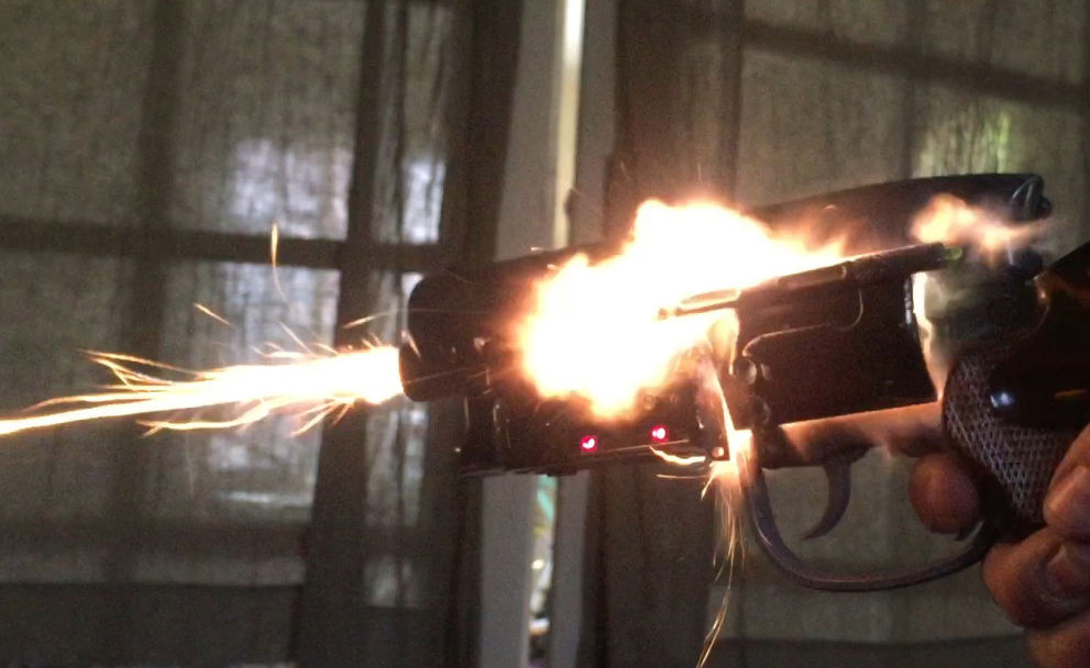

I had a little bit of free time today, so I ran down to the workshop and bored out the barrel.
Cool. As you can see a lot is still coming out the cylinder gap. I didn't make the hole that big since the way it mounts to the receiver is the same as the Tomenosuke - basically by working as a plug, which is the opposite thing that I want right now. Next time I'm there, I'm going to increase the bore as big as I can while it stays strong. Right now it's only at about 3/16 of an inch so there's plenty of room for me to go I think. Still, it's encouraging!
