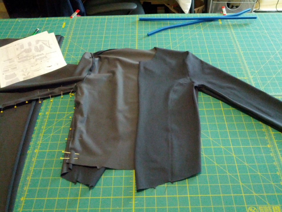

There were two patterns to consider: Kwik Sew 3052 and Jalie 2800 (which then requires Jalie 2916, altered). While the Kwik Sew would be fairly easy, there would be a lot more work involved, adding seams and seam allowances, and reworking construction methods. Jalie 2800 offers a lot of the correct seams to start with -- including the princess lines -- and would require a lot less tweaking. So I opted for Jalie 2800, and ordered the companion pattern, 2916.

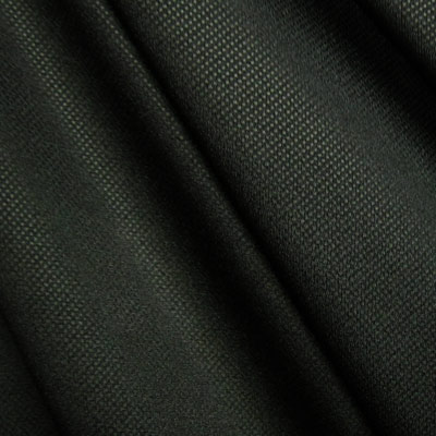

Then comes the matter of fabric: It seems no one can find *the* fabric for reasonable cost. So I set out to find something with stretch, reasonable body, and without too much of a sheen. I ended up finding some stretch crepe at the local fabric store that seemed to fit the bill, along with some herringbone fold over elastic (FOE) to use for the trim. Here, you'll see where I tested the fabric finishes together with the "drape" of the FOE:
I've gained something like 15 lbs since we moved up north, owing to a little less exercise and a lot less healthier food options. As a result, I've been reluctant to start on the suit. I finally decided I could start on the top, as the weight gain there hasn't been quite as bad as other places. I cut the pattern to the appropriate size, then started testing it out on some of the stretch crepe in a grey/blue. (Apologies for the grainy pic!)
I ran into a snag as I tried to install the zipper -- the stretch of the fabric made it virtually impossible to get it sewn in evenly. Since this portion won't be stretching, however, I decided that I'll be using strips of interfacing to stabilize the area before trying again.
Three other revelations came out of this:
1) The stretch crepe, while nice, is likely not suited for the purpose. It is a bit too lightweight to provide the necessary body to the twin-needle stitched seams, such as the princess lines. I've opted for a "high performance knit" I found a while back at Hancock Fabrics. It has a bit more body to it, and I've worked with it before, making yoga pants. It has a bit more sheen than I'd like but it's as close as any, I think.
2) The 1/4" seam allowance on the pattern are not long enough to accommodate the twin-needle stitched seams. Seam allowances will have to be extended.
3) The stretch crepe may not be suited for an Avengers-style Black Widow, but the blue/gray version would work perfectly for an IM2 variant. (Which I've now added to the "to do" list...)

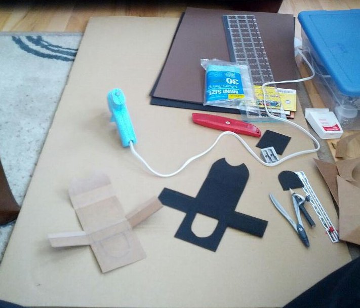

This week, I've put the soft products aside and went to work on the props. First up, the cartridge pouches on her belt. I'd originally thought to use the floss boxes, as Stretch did for hers, but soon found that those didn't quite have the right flap on them for my use. So, using the floss box as a model, I then developed a pattern on brown paper. I used transferred the pattern on to a sheet of craft foam...
...and knocked together a quickie prototype with some hot glue.
My gluing skills need some work, but overall, I was pleased. Building with foam means I'll need to seal it before painting; I'll also need to figure out what to use as cartridges on the inside. I'd love to find some lighter weight caster wheels, but so far what I've found in the right size would be too heavy to be supported by the foam or on my belt. So, I'm still on the look out.

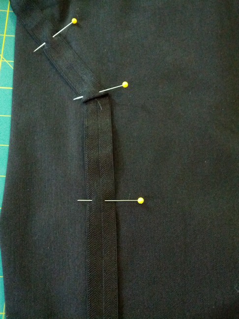

That resolved, I set to figuring the seam allowances. At present, I'm planning to go with the standard 5/8" allowance. Since the pattern requires only 1/4", I'll be tracing and recutting shortly.
I need seam allowances in various places on the suit: Knees; princess lines; forearm; upper shoulder. These seams appear to have been pressed and then the allowances top-stitched down. To that end, I tried two different methods. In the first (on the left), I sewed the seam with the appropriate stitch, then pressed it open. Once the fabric had cooled, I ran the fabric through the machine again, giving myself a 1/8" distance between the seam and my stitches. I repeated it on the opposite side of the seam. In the second (on the right), I was wired for sound... er, I threaded up my twin needle and went to work.
As you can see, the left looks more accurate. The right sample, however, offers more stretch and flexibility because of the twin needle stitch. I think I'll be going in search of a wider twin needle this weekend.

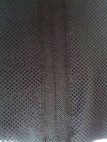

With all of those things settled, I moved on to testing my elastic trim. As noted in the first post, I've found some herringbone patterned fold over elastic that I think will work well. I wasn't disappointed! It took a little fiddling -- and removal of the walking foot (it didn't like the zigzag) -- but I think I have my construction method down here, too.
It's not a very clean application, as I fiddled with stitch width, length, and style as I went along. The walking foot did not work well with this, skipping stitches every inch or so. Switching back to the "standard" foot remedied this and cleaned up the lines a lot.
Given how good this hologram spandex actually looks, I'm really curious to see the matte hologram I ordered, all stitched up. If not, I still have the high performance stuff in the wings.

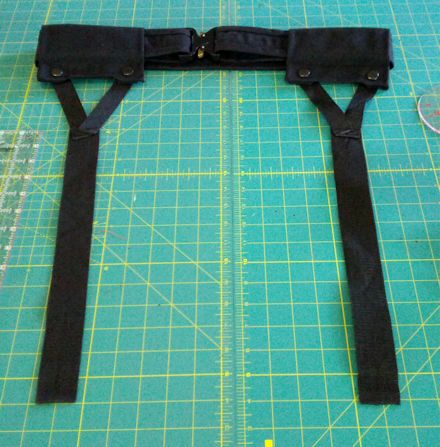

Slowly but surely carving away at my to do list! So far, I still haven't cut fabric, but have been working on the details. Today, I set out with the goal of finishing my holster rig. It's now 8 PM, and dinner should be ready soon, so... I'm guessing I'm about 60% complete at this point. (I got waylaid by some issues with the first coat of paint on my Valkyrie armor. Meh.)

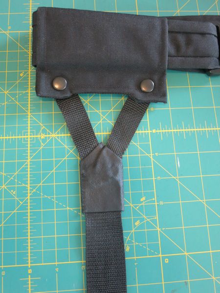

When I started today, I'd already had the belt and belt keepers about 99% complete -- all I really lacked were the heavy duty snaps on the belt keepers. I had to scour the internet for directions (they apparently didn't make the move from Houston!), and finally got them installed. I then put the other side of the snaps onto the narrower web straps. Connecting them gives them a bit of movement, and allows them to rotate to an angle to meet with the larger leg strap. I stitched everything together and ended up with this:
My machine handled the bulk without any issue. I then moved on to the plastic casing over where the webbing meets. Since I have a bit of worbla left over from my Valkyrie build, I decided to use that for the casing. To make a pattern, I traced the shape of the joined webbing and then added about 1/4" to allow for the worbla to adhere to itself on both sides. A little cutting, a little heat later, and I ended up with:
And, since I was painting anyway, I taped it up and painted the worbla.
Needless to say, I'm okay with the shape, but words cannot describe how much I hate the paint job! The can was marked "satin black." I suppose that it's closer to that than matte black, but it's definitely more glossy than I expected. It makes it look very home made, which was not the effect I was going for. ::sigh:: DH and I will be picking up some sanding blocks to work on his Hawkeye arrows, so I think I'll be picking up some dull/matte black in the process. Not only do we need it for his arrows, but now I'll need to sand and repaint these. Blah. Maybe while I'm at it, I'll dremel off some of the excess plastic on the sides.

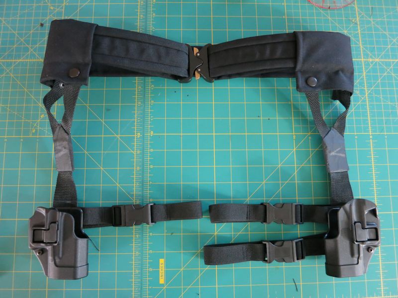

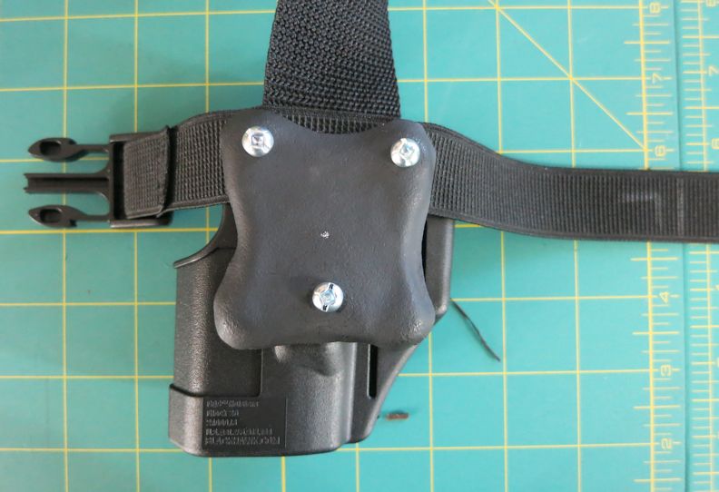

Kept working on the holster rig today. As mentioned previously, I formed a backplate for the holster from some extra worbla I had laying around. I only used a single layer as it didn't have to be extremely strong, and needed to have a little flexibility against the thigh. Using the CQC belt adapter, I molded two backplates and then hit them with a couple coats of Krylon ultra-flat black. The result was pretty good:
Once I started adding the webbing to the back of the holster, however, I realized the screws that came with the holster wouldn't be long enough to secure the webbing, the elastic thigh straps and the backplate. I opted for some 3/8" machine screws left from DH's Hawkeye rig. A bit shiny, but a felt cap or the like will bring it down and help keep them from snagging the spandex.

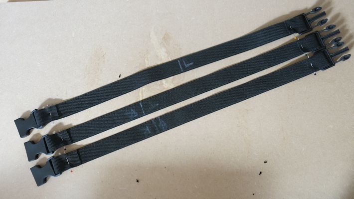

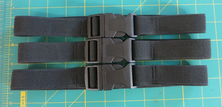

With the holsters temporarily in place on the rig, I then measured out where the elastic straps should be, and cut them according to a snug fit and enough hem allowance. They all still ended up being about the same length, despite a bit of difference in placement.
Elastics measured and pinned, I moved back to the batcave... er, the sewing room, and stitched up the bands. Though I tested my stitching on a bit of scrap, I still had some issues with the first band (bottom). I then flipped it over and made sure to carefully topstitch in the grooves of the elastic. I then did second row of stitching about 1/8" in to help secure it.
With the elastic stitched, I then marked the mounting points on the back of the straps using a silver marker. I very carefully poked holes with an Exacto knife, and threaded the screws through. I could then mount the straps, the webbing, and the backplate to the holster, making sure the screws were aligned with the existing sockets.
Wash, rinse, repeat for the other two.
And then I had a completed holster rig!
Not as screen accurate or clean a build as I'd like, but I'm fairly happy with it over all. Lessons learned:
1) Next time, flip the junction point of the webbing so that it's more flat on top, producing a smoother worbla casing.
2) Investing in the smaller AustriAlpin buckles would be nice, but the curved shape of these from Strapworks will be much more comfortable!
