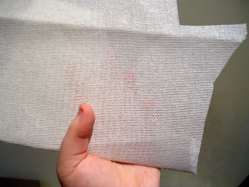

As for see-through material, I always use 20/20 or buckram (though most places sell it as embroidery mesh, though it's really a millinery product.) It's a stiffened fabric mesh that you can paint any colour you like using acrylic or fabric paint (or even just permament marker!) and see through very well. Great for ventilation too. I use it on all my costumes that require ventilation, blocking out or vision aid.
Looks like this:
