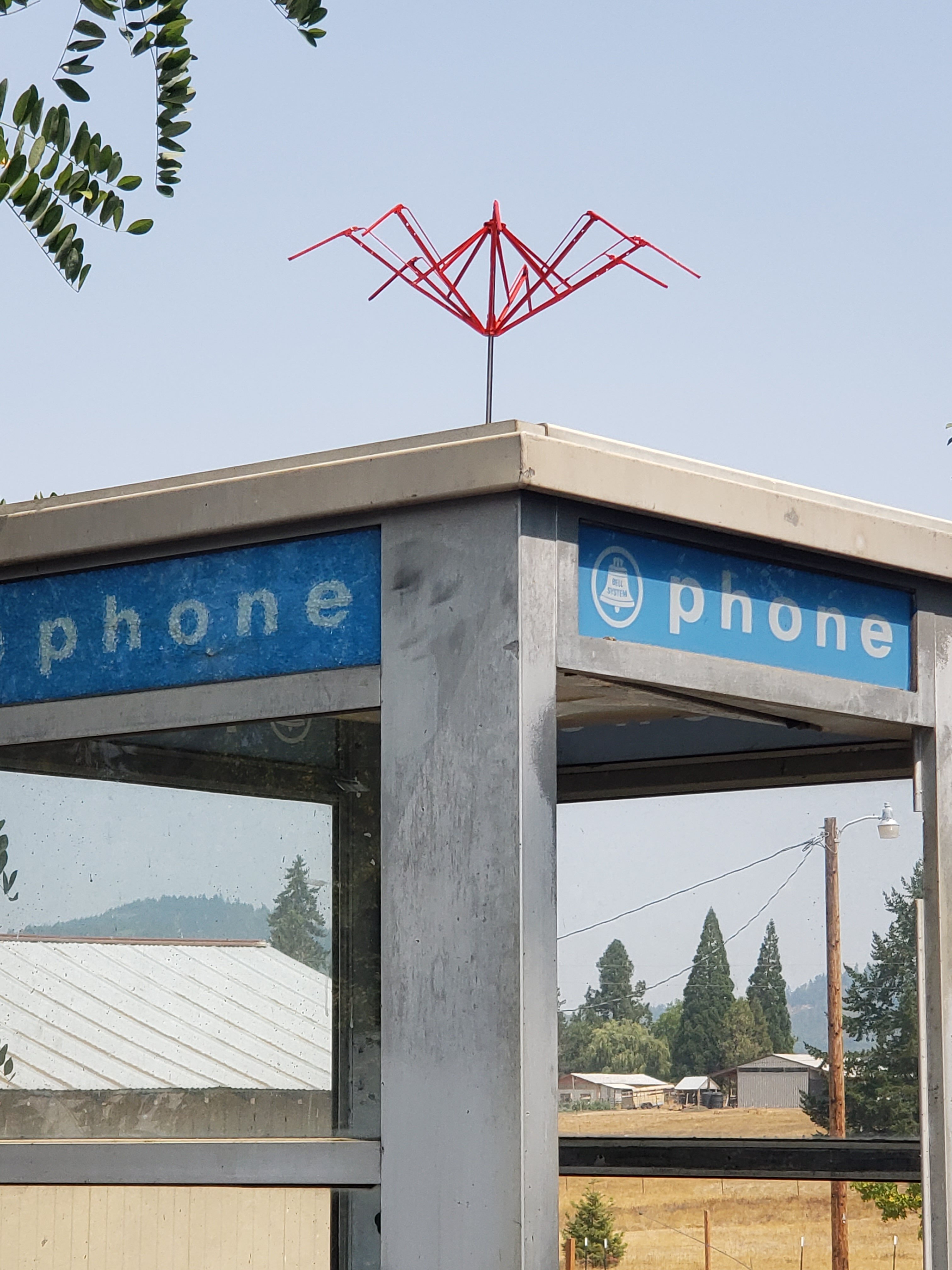

Much better on the height. I think this is a passable round one. Ya, I said that before but it was too tall. Future treatment on round one, if I get to it, is glitter red or glitter orange if that exists in spray paint. Looking for my next sacrificial umbrella for round two.

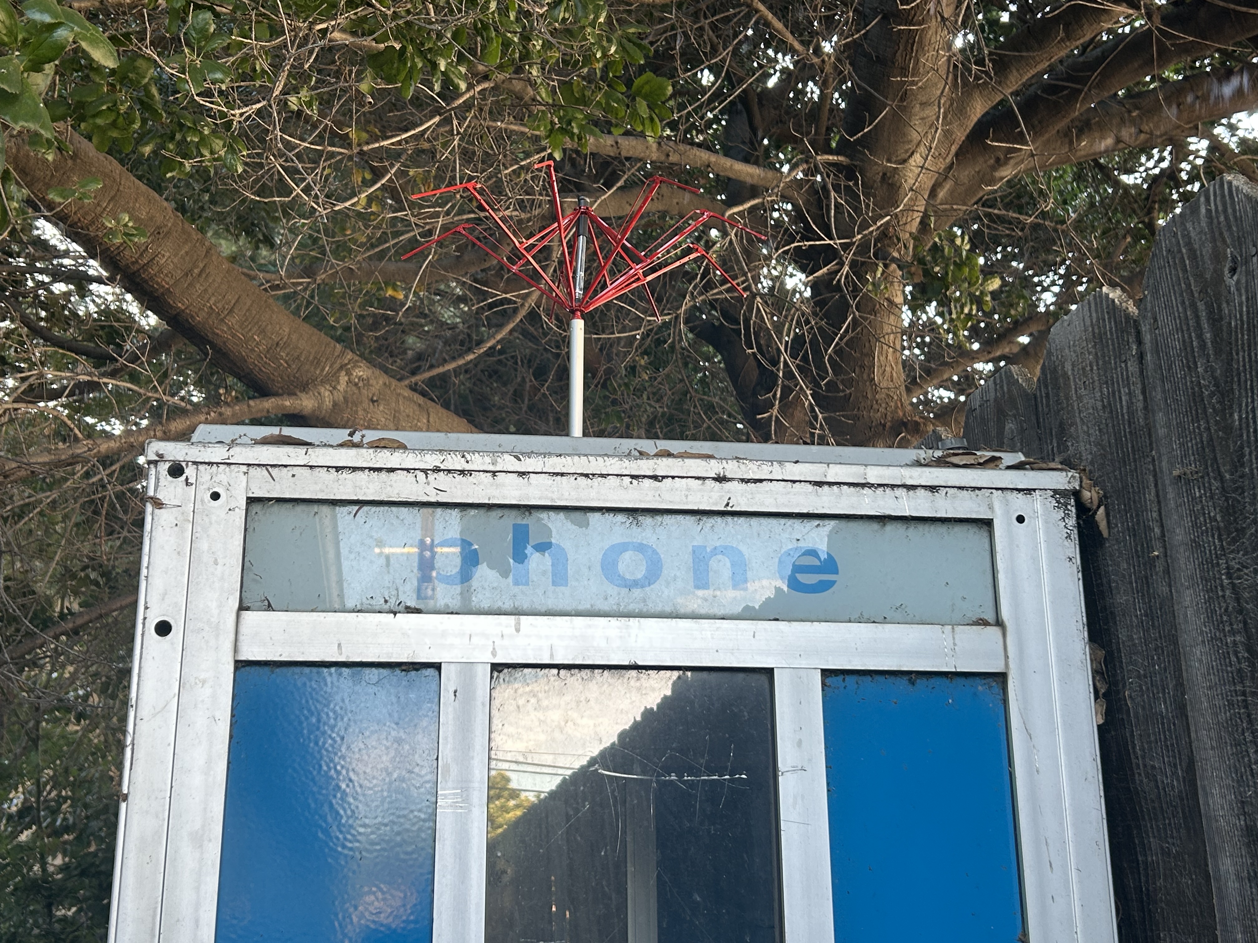

Mine is just popped on temporarily:

I love that it is exactly the same. Did you flip your umbrella over like I had to?

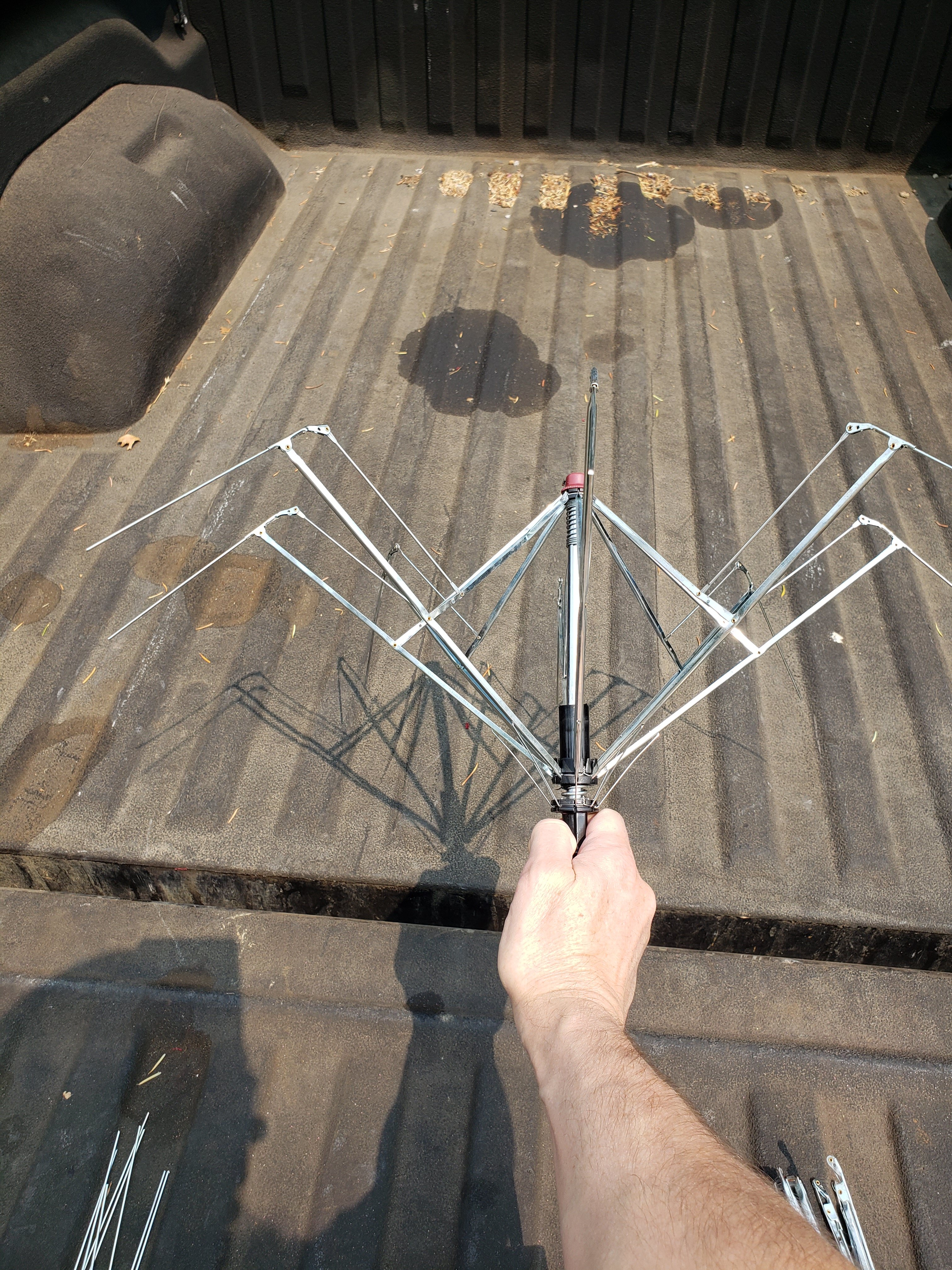

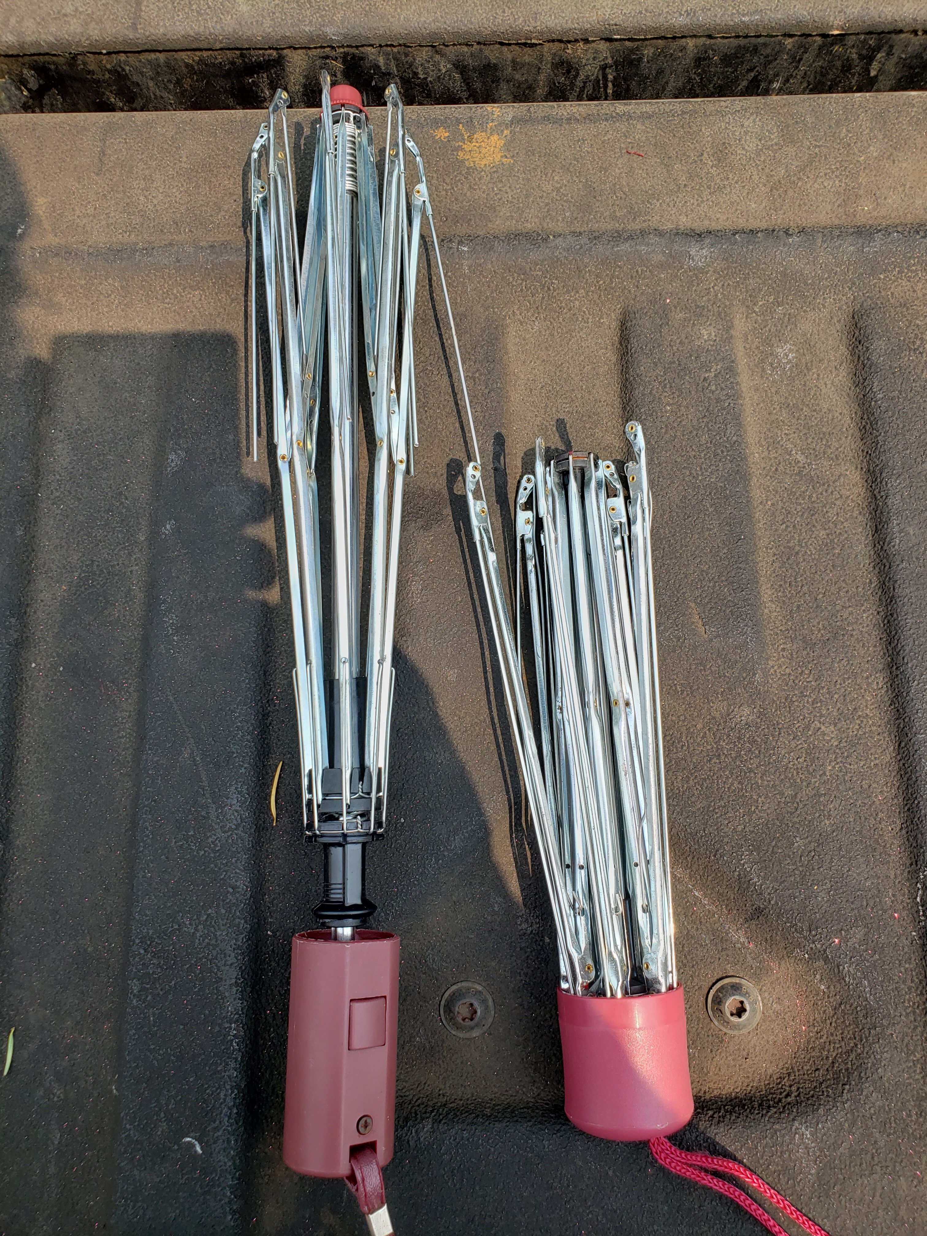

I have removed the hornet's nest from the booth so I should be able to get a first draft picture soon. I have started stripping down two more umbrellas and have found that one is rightside up as I had guessed. This one is not a match to the movie version so I will stay with my assumption that it was a compact model turned upside down. This newer one has longer initial arms and one less fold mechanism so the end arms will be rods instead of the folded sheet metal. However, this does give me the ability to construct an auto opening flip up version. It is the one on the left (below).
The spring will likely need replaced as it is very aggressive. The goal is to get it to flip up and deploy as it does in the movie but I also want it to then collapse and fall back to closed when done. The second half of the process is harder than the first.

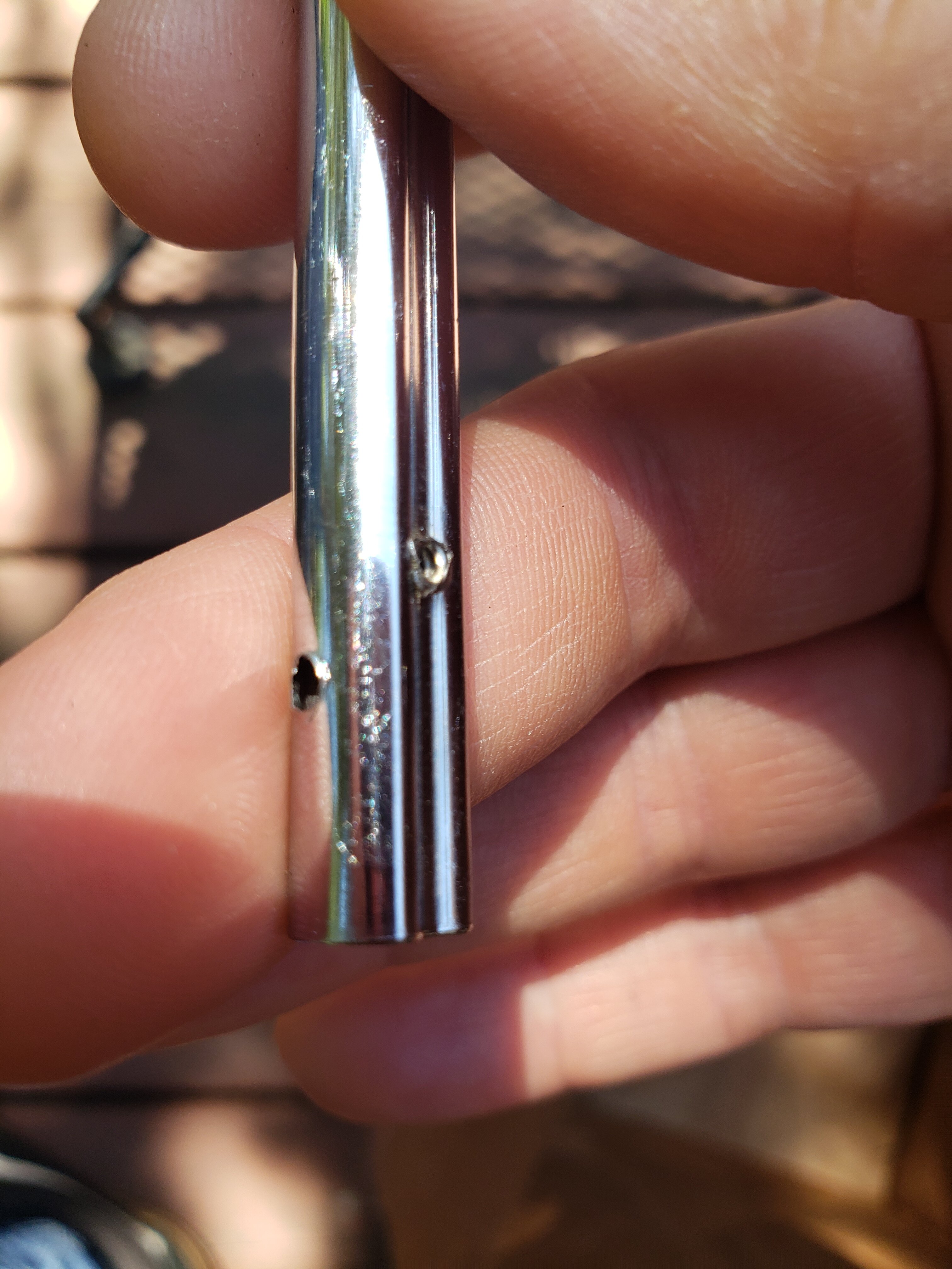

I very successfully broke one leg on the auto umbrella. The spring is far too aggressive. I am working on soldering a fix this weekend. It did work correctly with a new cross pin that stops it at the right expansion. I intend this auto to be stage 2 that swings up and expands for a good video opportunity.
The original round one has survived at the local booth now for about a week. I figured it would be stolen well before that.

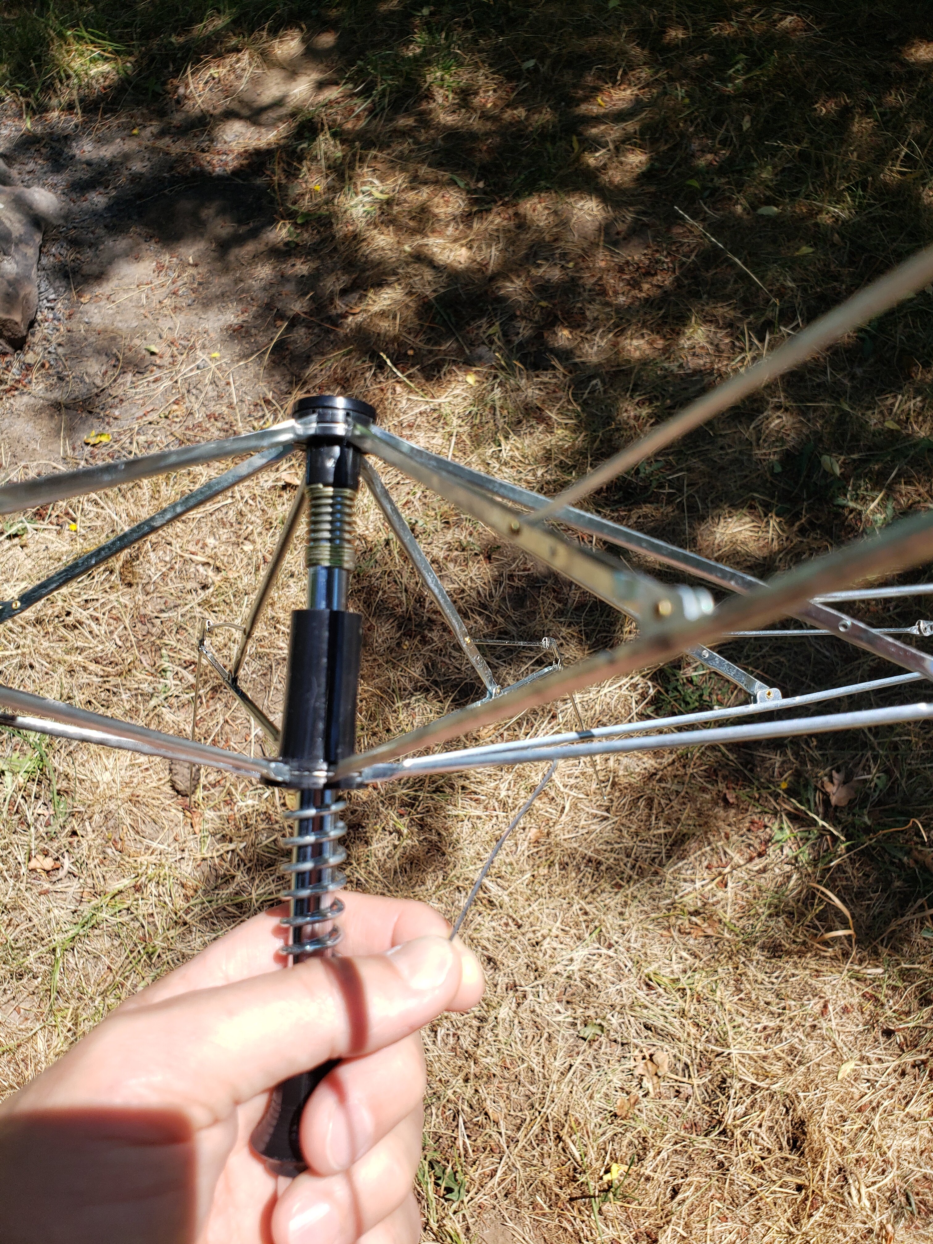

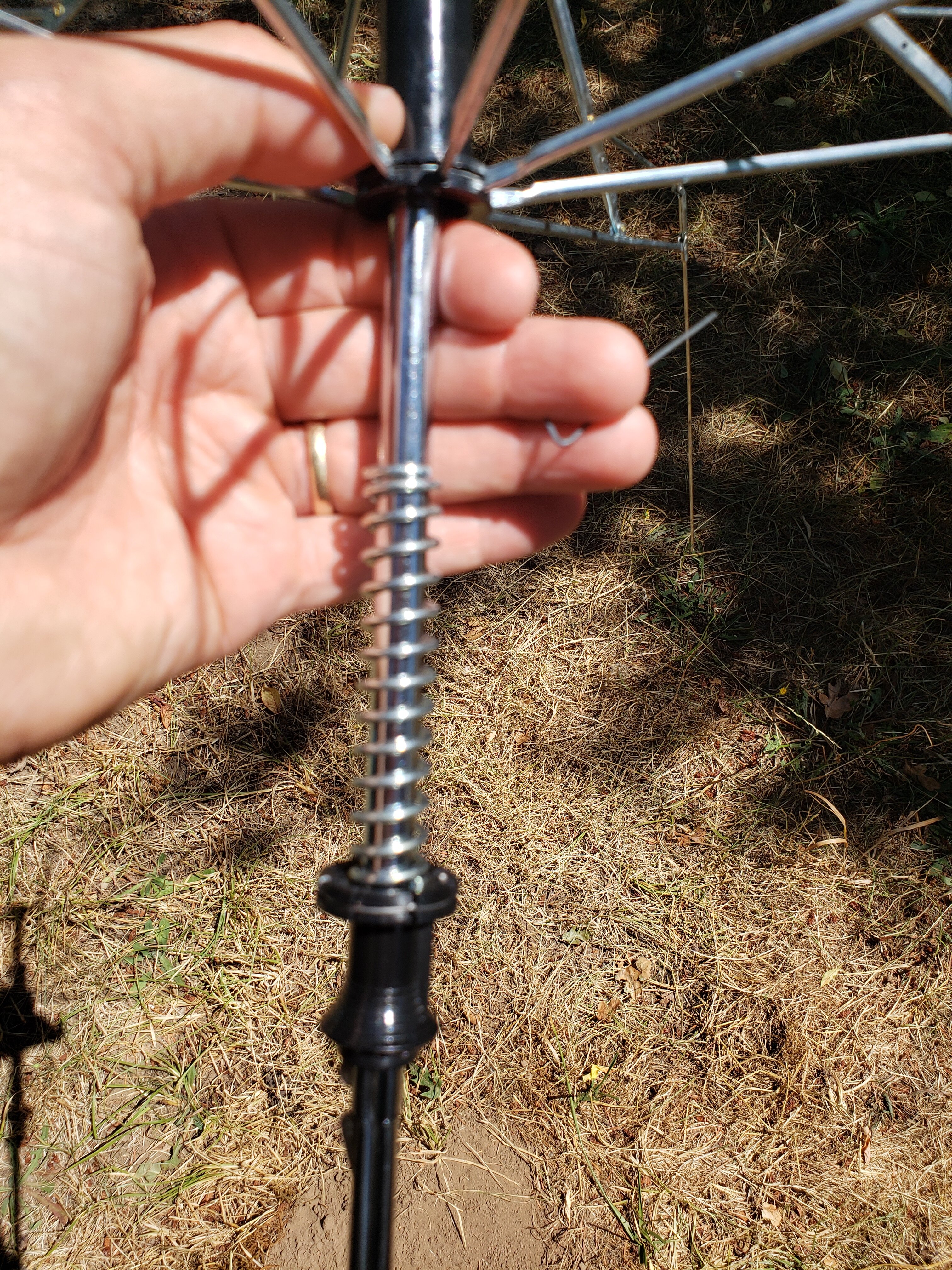

I found a twin to the larger umbrella (above) that had broken one spline from the agressive spring. I realized that the spring is completely unnecessary so just needed to be removed. I had it stuck in my head that I would need to cut it to save the lower black slide guide. However, I don't need that guide either. This means that the prep for this version really is 1) remove cloth, 2) Cut the tie wires between the upper and lower center guides, 3) Remove the lower handle (one screw):
and slide all the bits off the bottom.

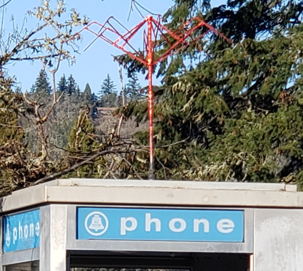

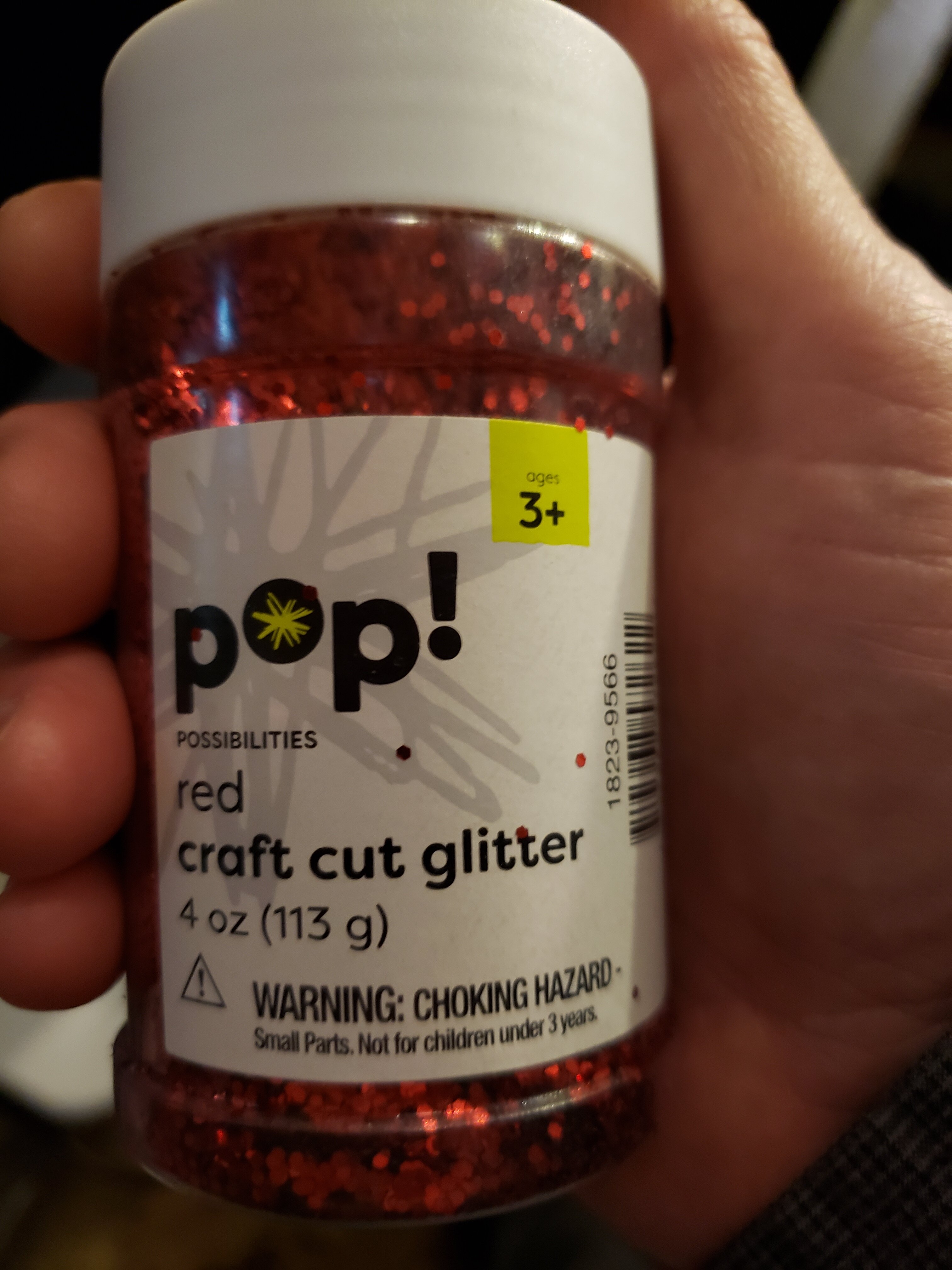

Realized I hadn't been posting my trials and successes. Went through another version or maybe 2. The request for a larger one was completed and then the red glitter version but I was a bit silly and sprayed it with glow in the dark paint not knowing that late in the evening the street light kicks on and it will never glow. The overspray killed the sparkle entirely.
I then did another and the sparkle was unimpressive. This led to the search for MASSIVE FLAKE GLITTER. Found a medium large:
But still not the biggest, the shelve spot was empty at Joanne's crafts.
Then the weather went bad and we have been stuck in fog for months. Weird year for sure. But today the sun is out and got pics. short vid and a nice shot of how the diffused sparkle grows bigger than the glitter itself, pretty cool.
So, big note, the glitter does not sparkle unless dry, so, fog and rain drop it back to just red.
