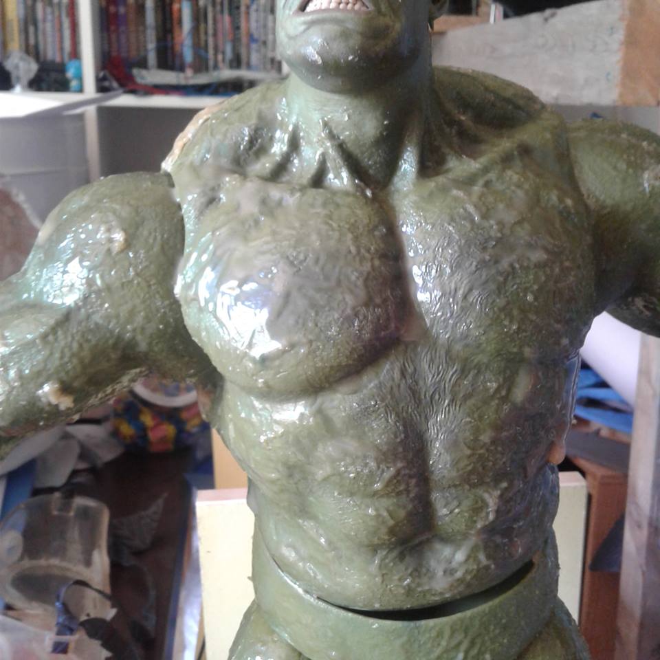

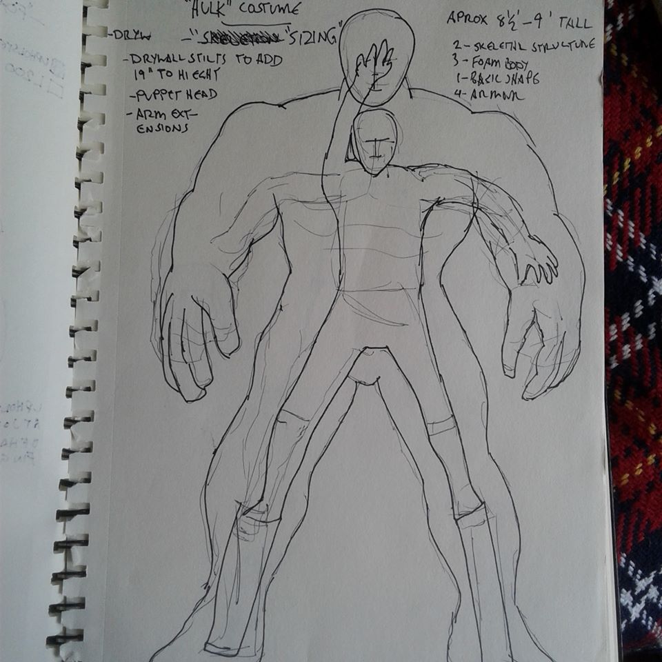

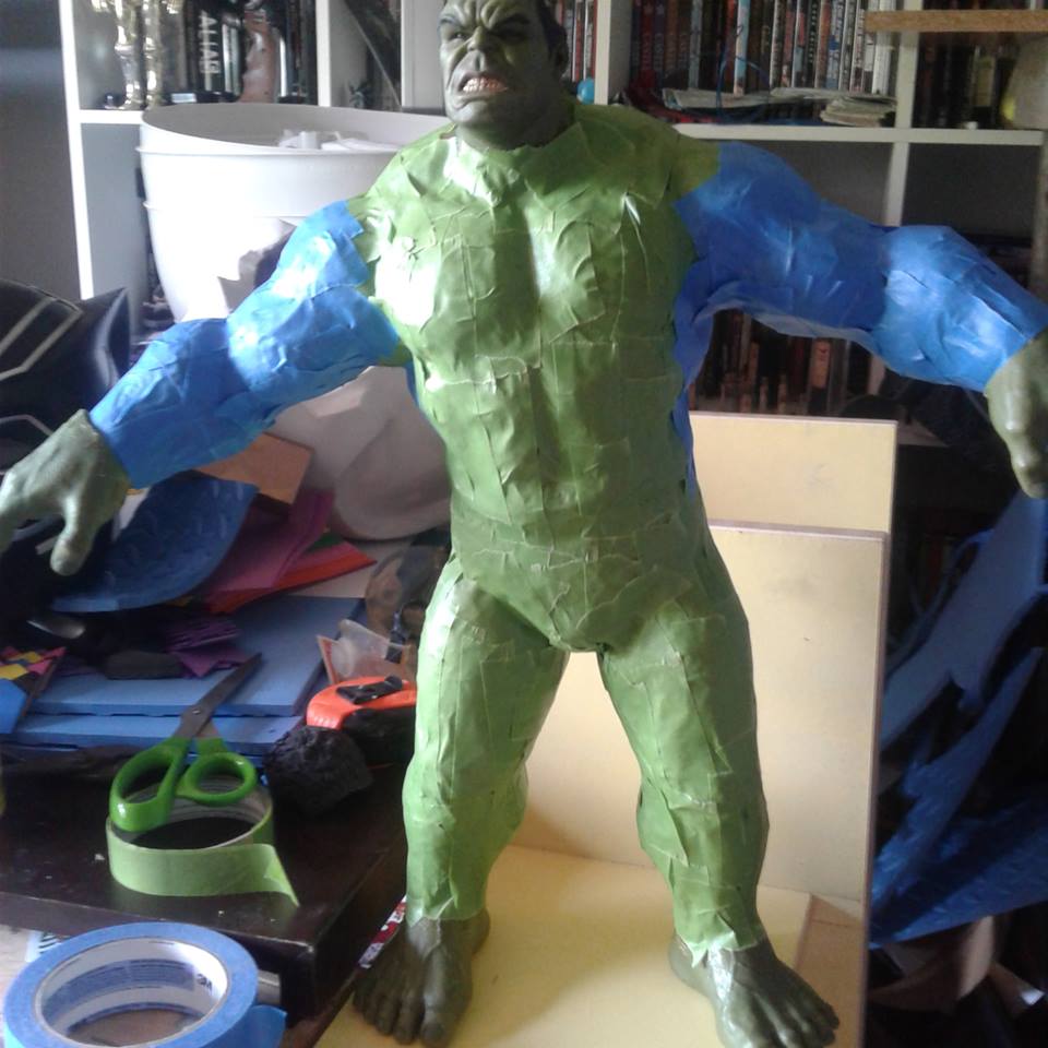

been away from here for a while now, what with life getting in the way and all. Recently I got inspired by my local cosplay group, as everyone had seen the Thor:Ragnarok trailer and was starting their Thor, Loki and Hel builds. I decided to do something different, and with some inspiration from Frank Ippolito's Rancor build and the expert assist for the body he got from puppeteer Ben Bayouthe, I have decided to build the World War Hulk! No idea on when I will be done, but gonna start now and see how long it takes. Basically, it will be a 9-10 foot tall walking puppet like the Rancor, with drywall stilts, cable-controlled fingers and a puppet head with moving eyes, brow, mouth and snarling lips. A voice changer and speaker will go in the mouth, and I will solve the problem of having to look out the chest by having a piece of armour there! I have started by using the Hot Toys Hulk figure as my mold for a pattern, as it is a 1/6th scale figure. I will make patterns on him and have Kinko's blow them up so that he will be around 10 feet tall. I started by doing all my preliminary sketches for the work, then covered the figure with latex rubber. Next, came the tape on which I will start drawing out where the foam body pieces will be. Next, cut the out and have them blown up! 18813863_10155814510720616_2336651297014650200_n.jpg18813241_10155814511140616_3050127569974808298_n.jpg18700264_10155814511615616_325646115491226308_n.jpg18814043_10155814512230616_6102507347661752846_n.jpg18881884_10155839062130616_7969821509758903810_n.jpg18881864_10155839365150616_8890175681479366407_n.jpg

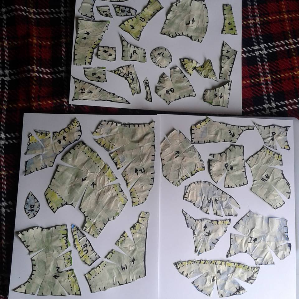

Thanks, Ronchan! Next up, I'm mapping out all the pieces. I'll colour some a different colour to show me which pieces will be a lighter foam density, label them, cut them out and send them to Kinko's to get blown up!19029392_10155859828875616_7611878963881965906_n.jpg

Alright, I've highlighted where the joints will be, numbered all the pieces so I can find them, marked how they attach to each other, and indicated which direction they flow. Next, let's get them blown up and order the foam!19030498_10155862432415616_7038259385329809515_n.jpg
