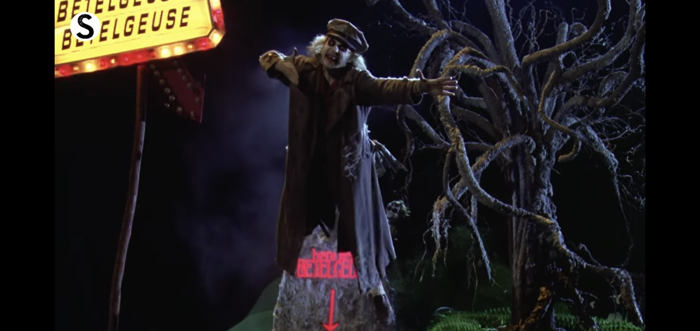

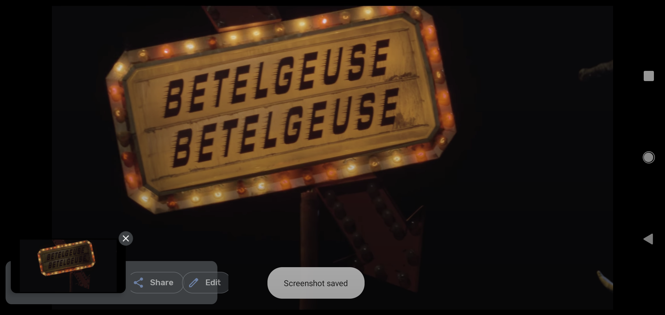

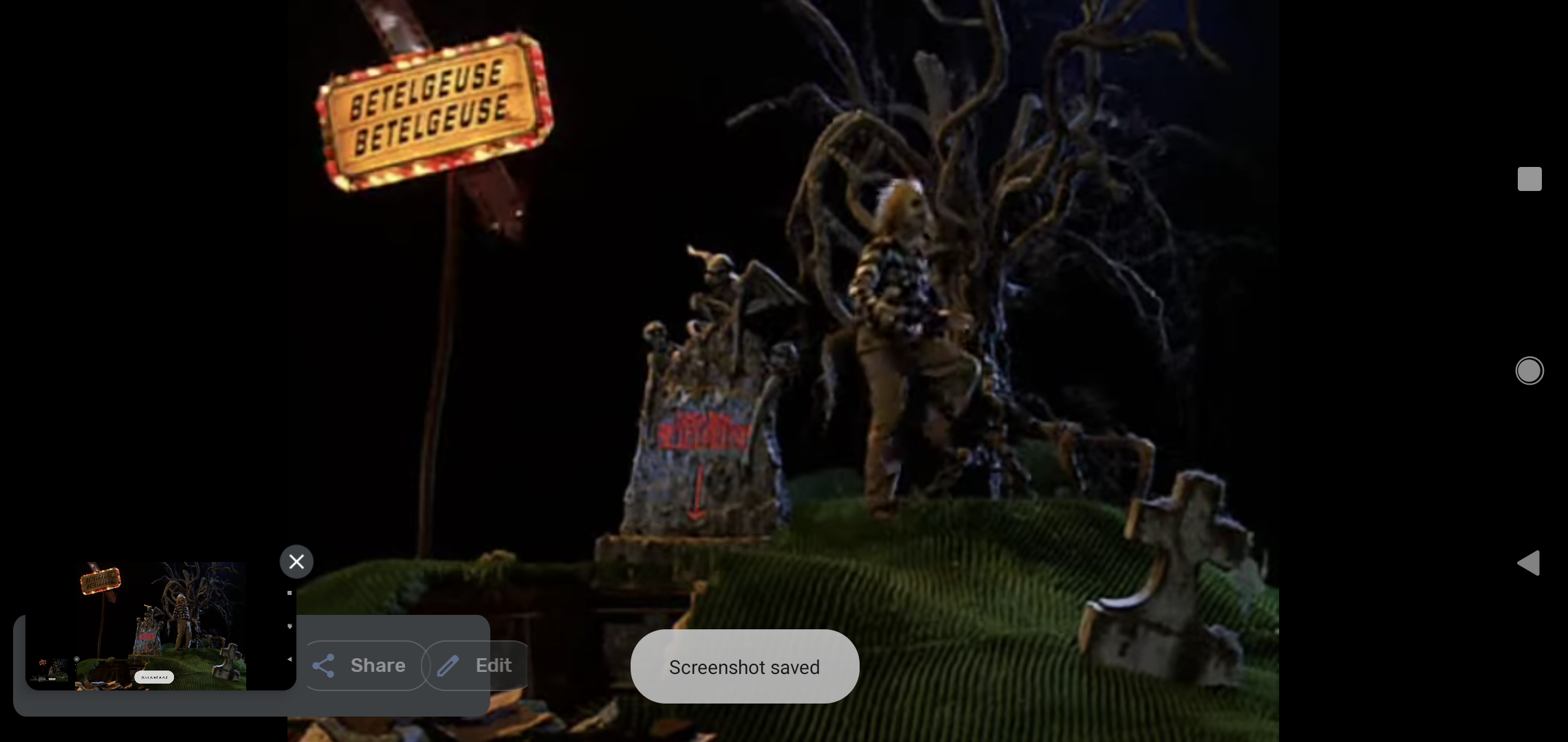

I took screenshots from my phone. Reversed engineered the design. I used an Edison bulb for scale and went from there.

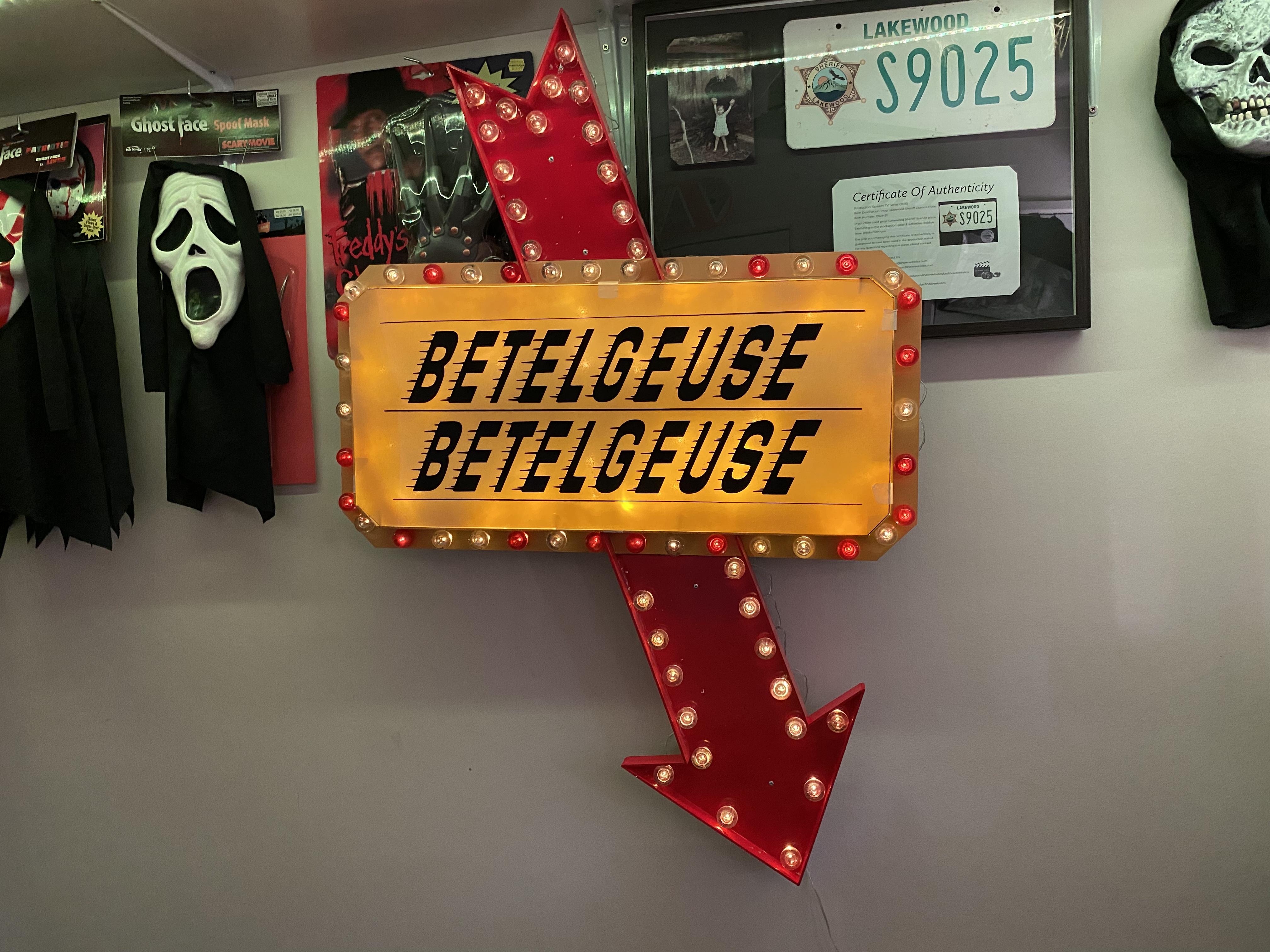

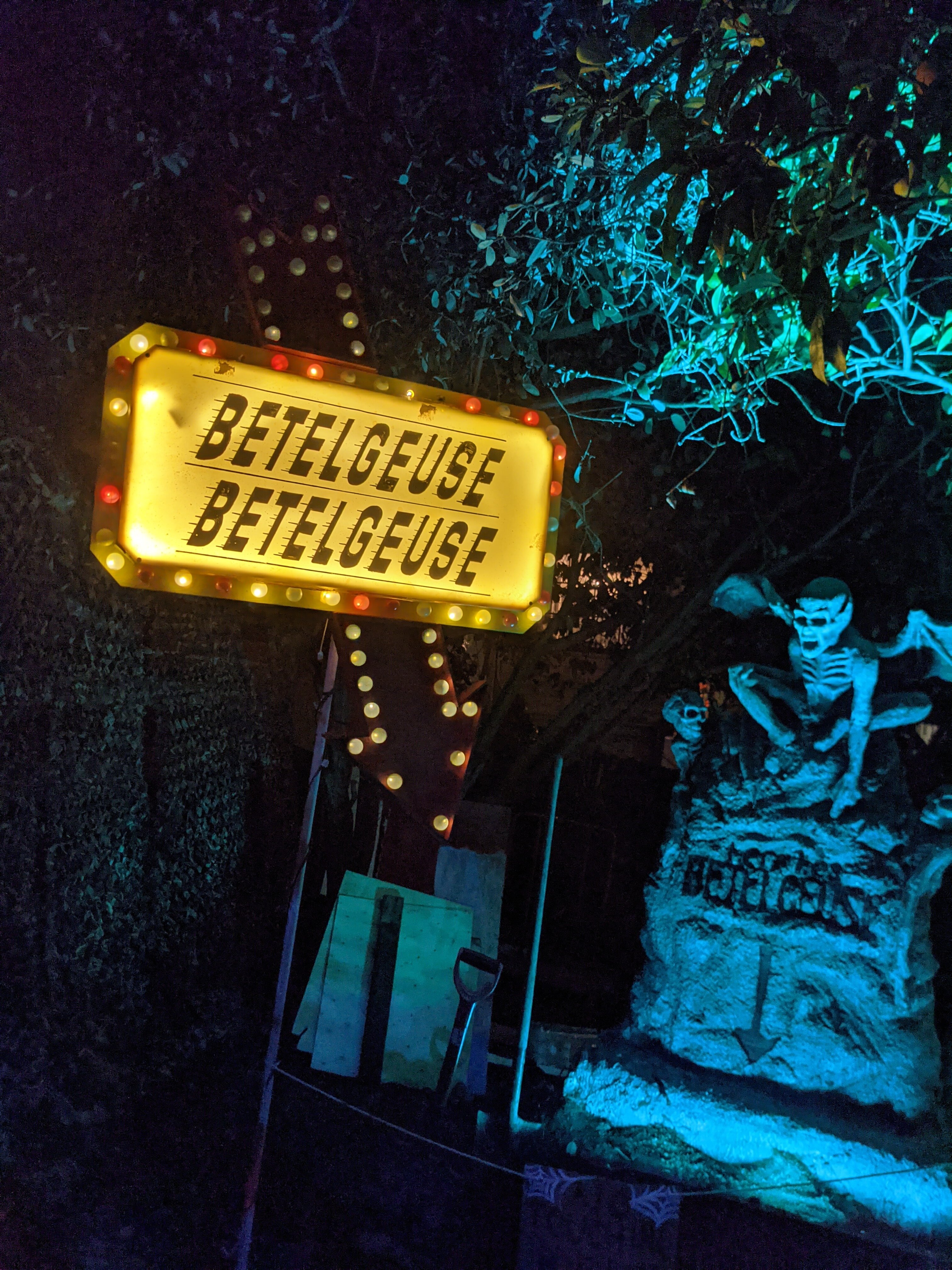

the built version...
vs the screen accurate version.

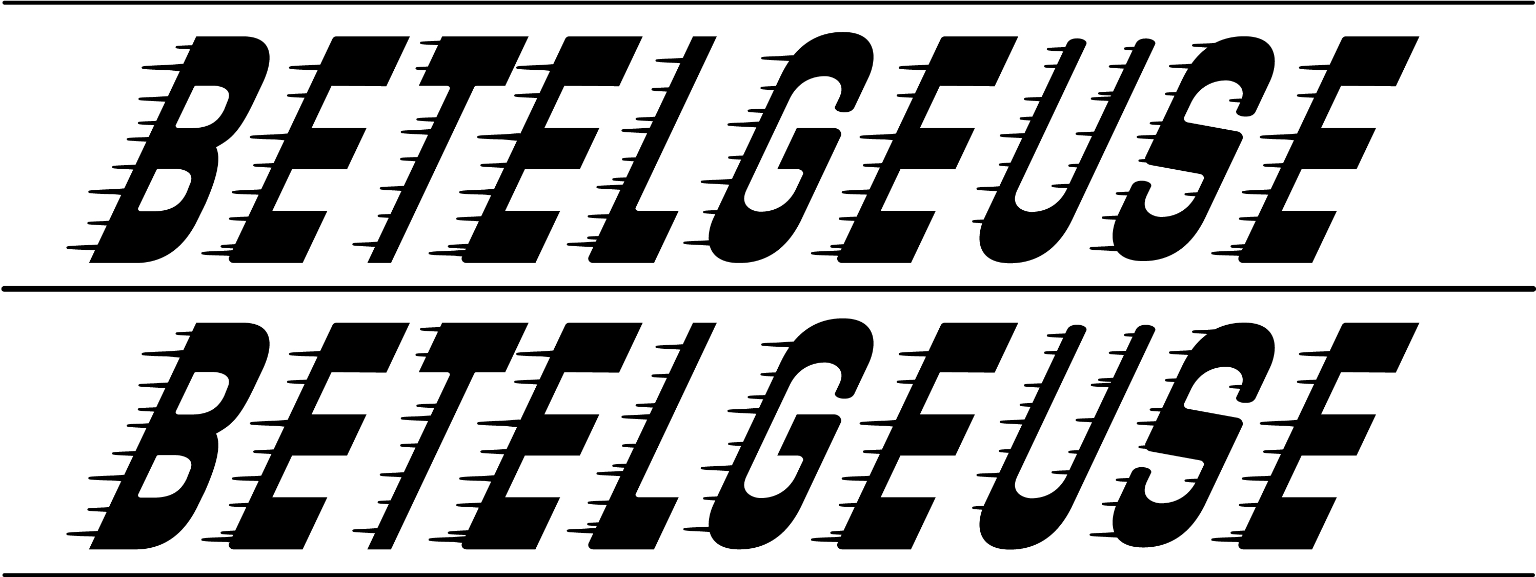

Sign Lettering

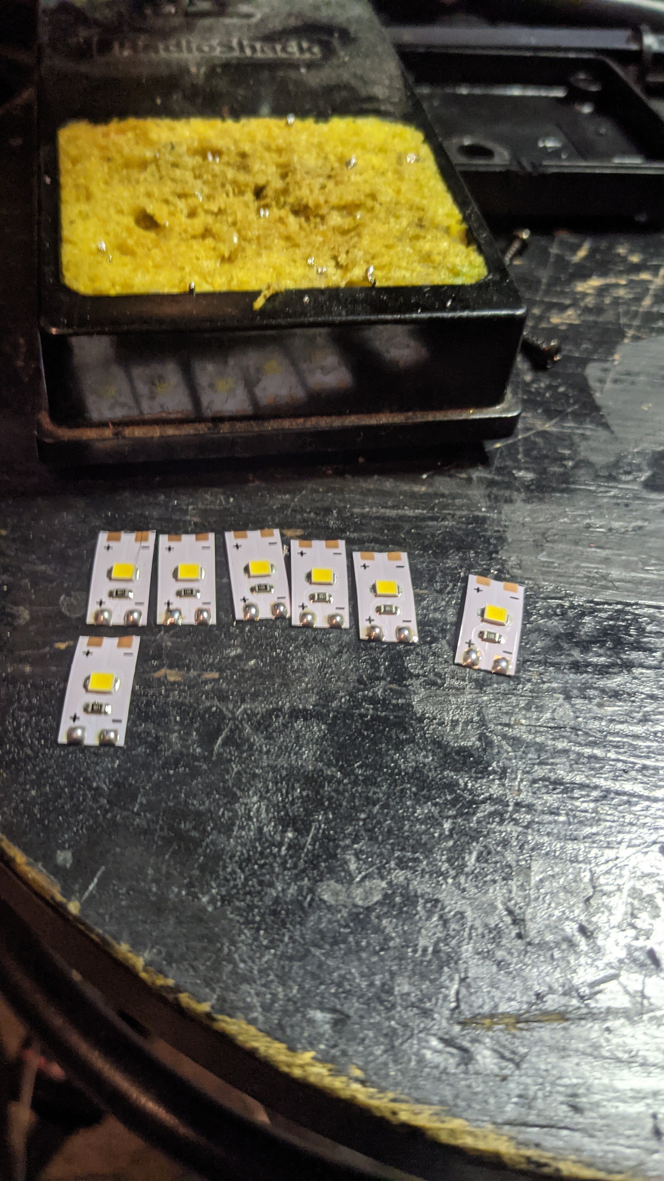

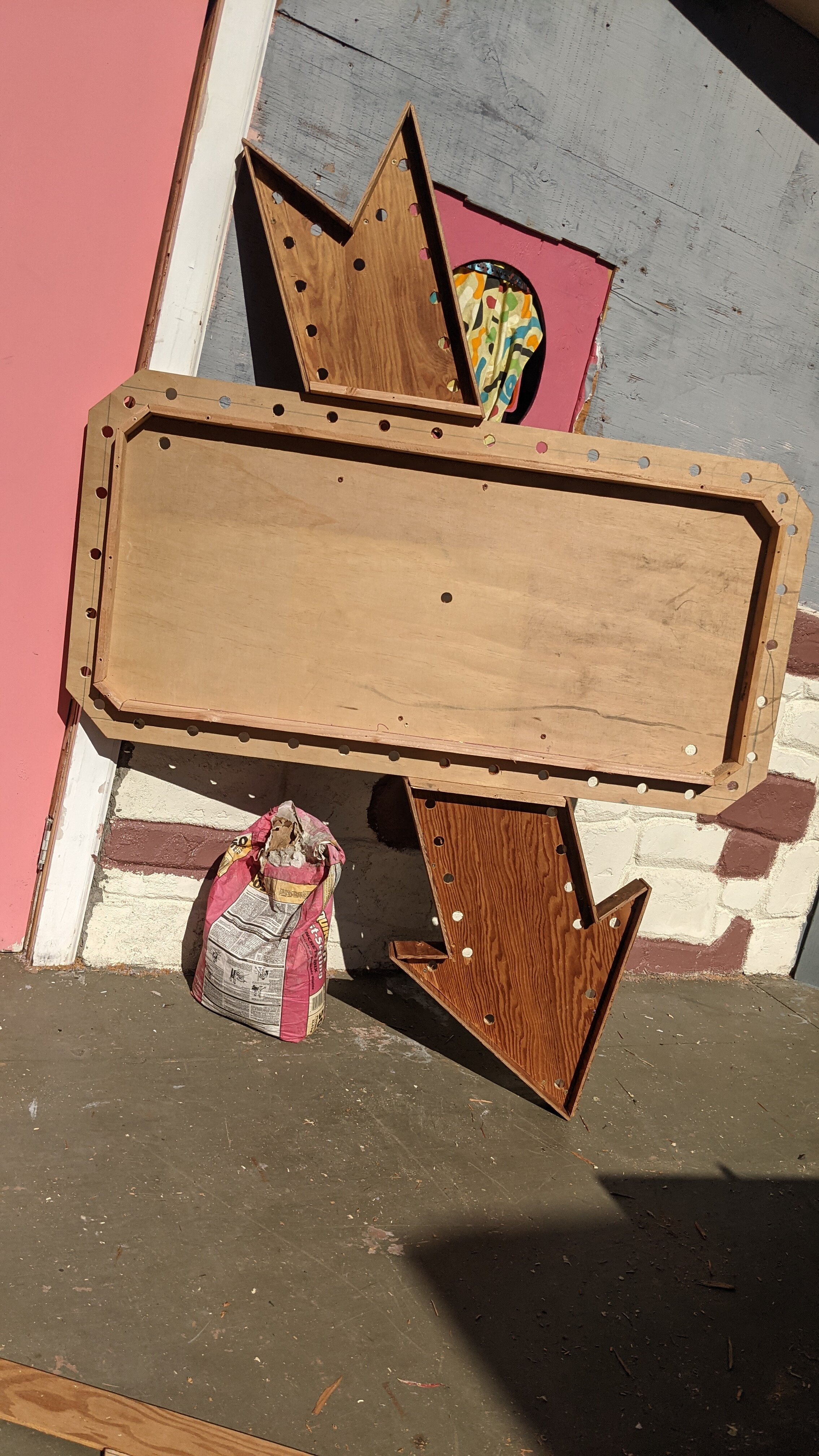

using yellow ping pong balls as bulbs and wired Led Lights from the back.
Painted and wired.

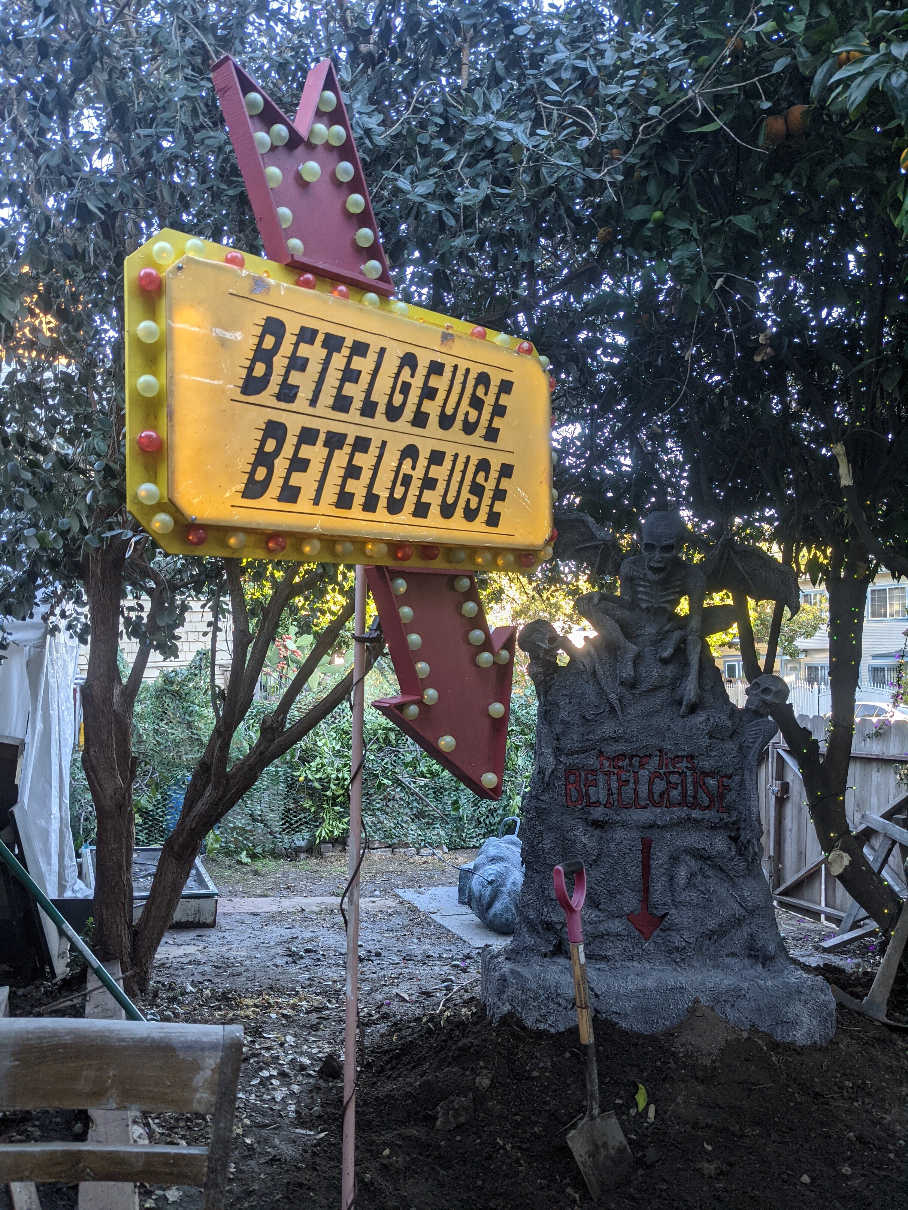

Beetlejuice Sign next to the Beetlejuice tombstone built by Freddy Schramm
Lights are animated to match the movie. I have video but have to figure out how to share it here.
Limited with time, i had to figure out how to wire the lights and have them flash to match the movie. I did not use arduino or rasberry, Didn;t have the time or budget...

I was unable to find the updated drawing with the dimensions... but the pdf's I do have are from the first iteration... before the accurate drawings.. the dimensions are all the same with only some minor details varying. The outer frame front eh main sign was removed and the inner frame is slightly thicker. the arrow outer frame was modified to allow the arrow to fit flush with the rectangular base. (the arrow frame would have prevented that. The dimensions are imperial measurements, inches (not metric) and the overall critical dimensions are there, including the angle of the arrow (but that can be eyed to look the way you wish.

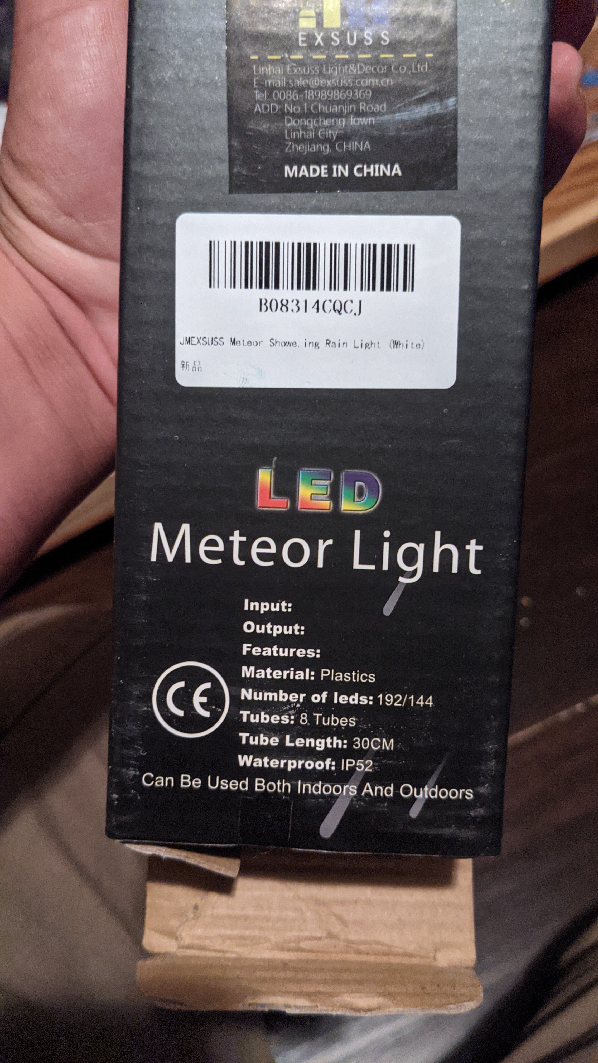

As I mentioned earlier, I didn't have time to use an arduino or rasberry to animate the lights. for the main betelgeuse sign, i used battery powered led strips and back lit it like a light table. easy, for the lights surrounding the frame, I used fairy lights. and for the arrow lights, i use a second strip of battery powered LED lights and wired them accordingly to a meteor light (Christmas icicle lights) because they already have a chip that creates a chasing light animation.
Sign Lettering
Painted and wired.
This is very cool! What font did you use for the Betelgeuse sign?
