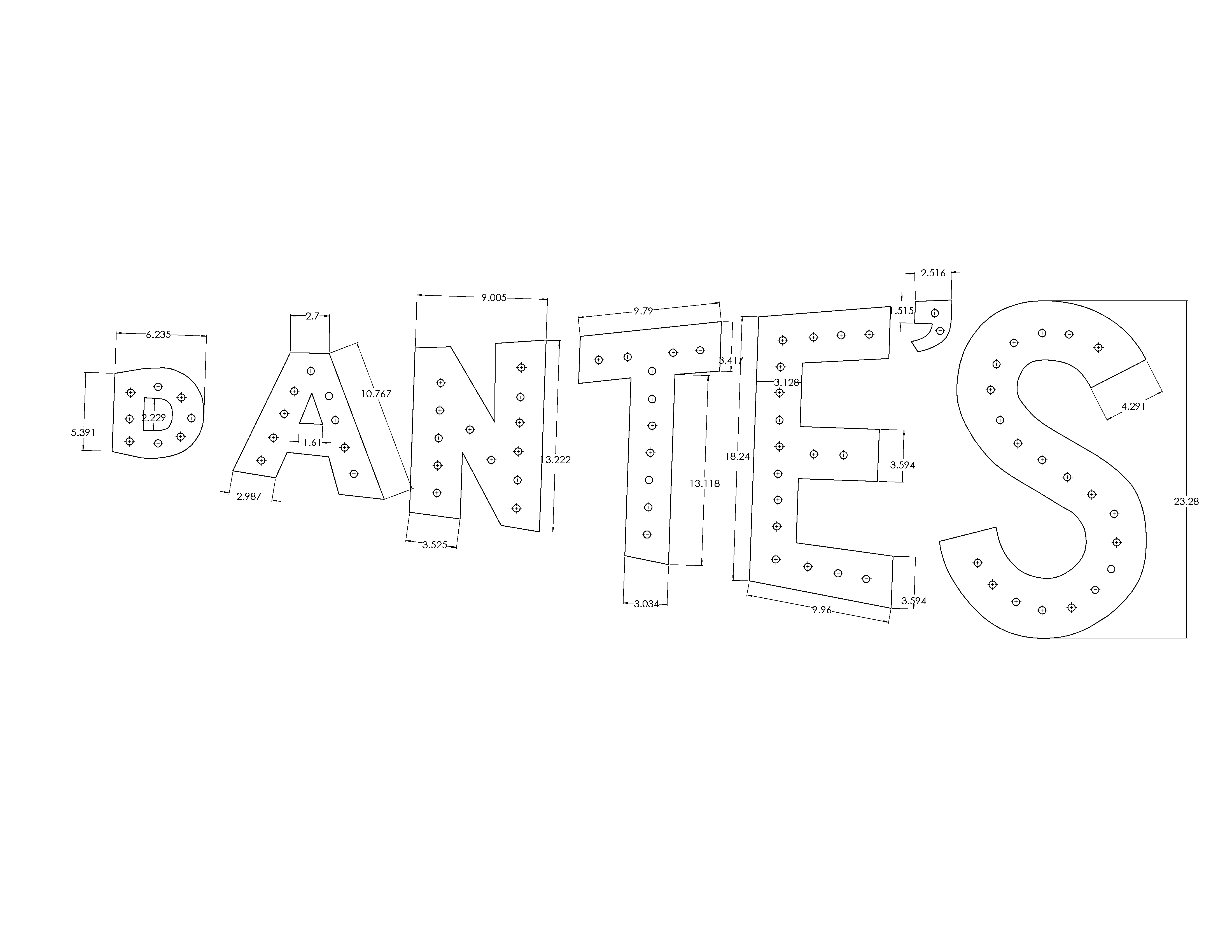

I used forced perspective to make the awnings look like they're extending outward. The right side does extend a little... but the signs are tapered and angled forward.
Materials were mostly scrap, free craigslist finds, and very little purchased materials.
I can make all details, fonts, and dimensions available for Inferno Room light box, dantes inferno sign, girls sign, air conditioned sign, and demon head art upon request.

How do you do the lights in the "Dante" sign? What lights are those? What controller is used to make them light sequentially?
I used off the shelf, battery powered fairy lights... i drilled holes thru the frame and inserted about 2 to 3 fairy lights per hole. It was a quick fix, most fairy lights have preset animations.
