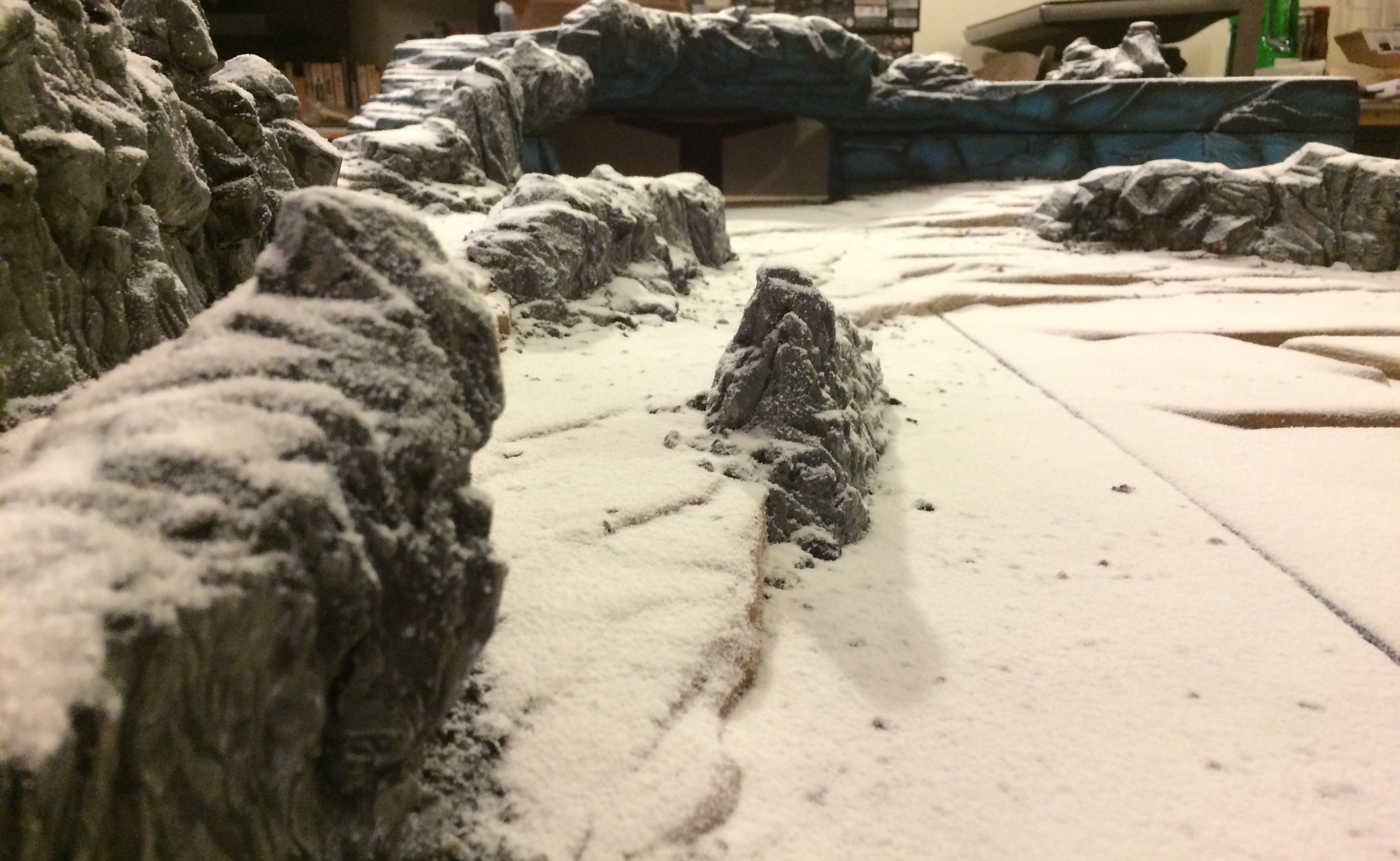

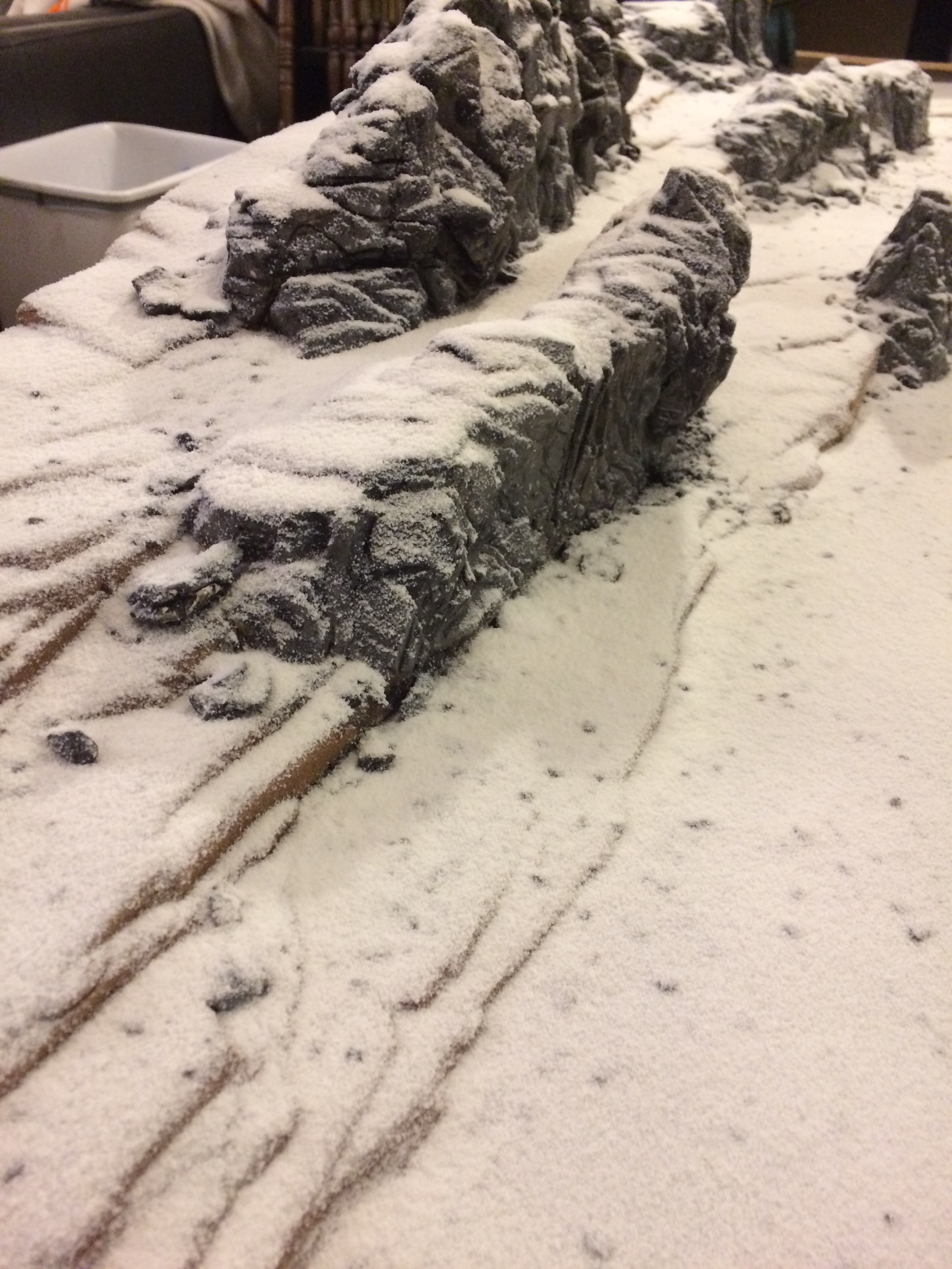

I recently completed a build for client that was my second of this type. I've included pics of both. The 40k board is the most recent and I'm having an issue with the power supply. One a Star Wars Legion Hoth game board and the other a Warhammer 40k display / gaming board.
