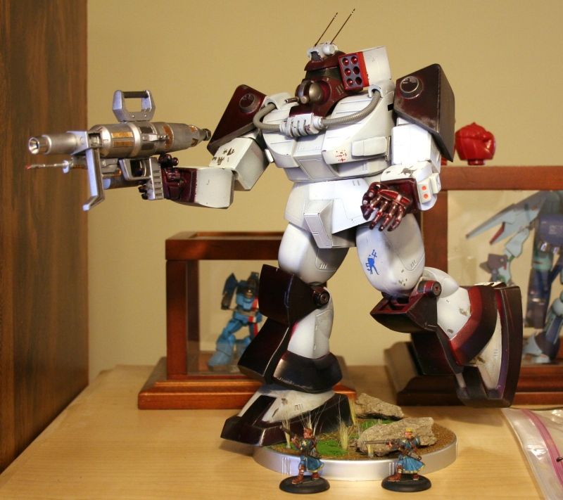

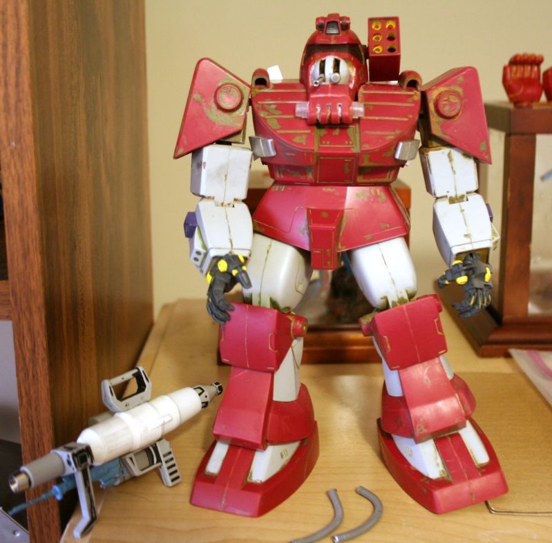

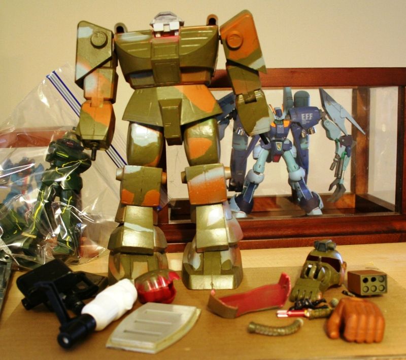

Simple Green or Purple Power is nice but takes a couple of weeks or longer.
Oven Cleaner/Caustic Soda gets it done in double quick time but you need to use it in a sealed container or bag, and it may take up to 3 times to get all of the paint off.
Good ol' Brake fluid works too but you risk softening the styrene and accidentally warping something.
EDIT: I used the Oven Cleaner Method on this kit that had thick enamel on it from the early 80's. Worked pretty good.
