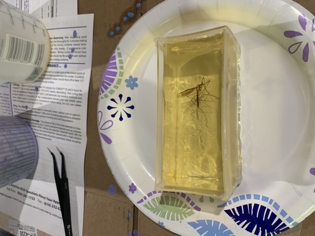

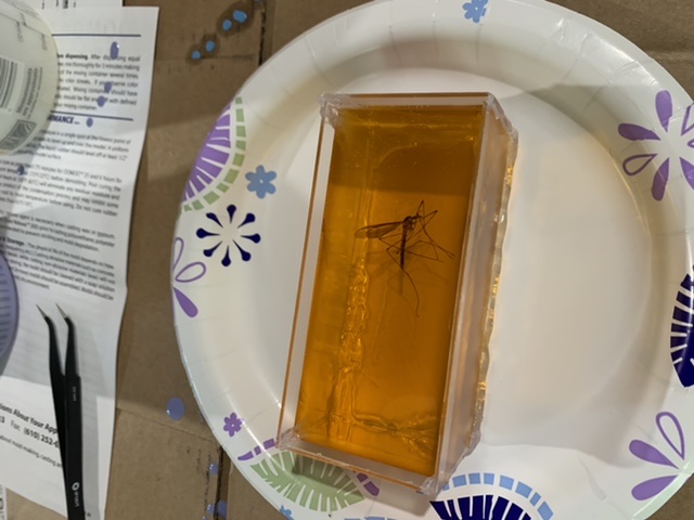

So after watching Peter’s YouTube video (referenced above), I made a “mold” out of plexiglass with the same dimensions he used in the video (2”x2”x4.5”). I even used a little less resin (8 oz) because I had the catalyst numbers for that amount. Funny thing was, when I first mixed and poured the resin, the color was perfect (using 24 drops of pigment - same as in the video). Now, a couple of hours later, it’s become much lighter - just a very pale yellow. Is that normal for it to lighten like that? Should I make it much darker at first, expecting that it will lighten as it cures? Will it darken back up as it continues to cure?
So I’ve identified a couple of potential culprits. First, I realized that the resin dye (I’m using Castin’ Craft) says to shake vigorously before use - which I didn’t do. Second, I worry that the resin might have reacted with and bonded itself to the plexiglass because now it won’t come out (I’ll try a chisel later today). Wonder if either of those things could have resulted in the color getting lighter.
I have had dyes lighten because of the heat generated from curing. I suspect that is the culprit here.

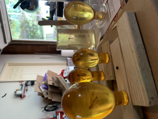

Since I haven’t had much luck with the square molds, I decided to make a silicone mold of a few plastic Easter eggs to try that. I made one big and one small since I wasn’t sure which would be a better size for a Hammond cane. They turned out ok. (I’m slowly getting the color dark enough - lots of trial and error!) I’m a little worried about being able to see the line in the middle. I mixed the color dye into the resin and then split it in two parts to catalyze separately so the color would be the same, but it still seems to create a line. Am I waiting too long to embed the bug and pour the second half? (Currently waiting about 18-20 min).
