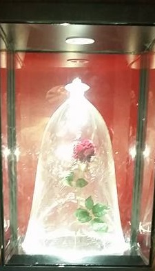

Yeah, it's not out yet. In fact, I THINK the prop roses we are seeing are based on the animated film. I've looked a bit and the only thing I've seen showing the rose for this new film is a shot of the rose under what appears to be a crystal goblet. I'm not sure they've even shown it in its entirety yet, however I could be very mistaken.
Not sure. This is the rose they have on display with an official Disney stand.
