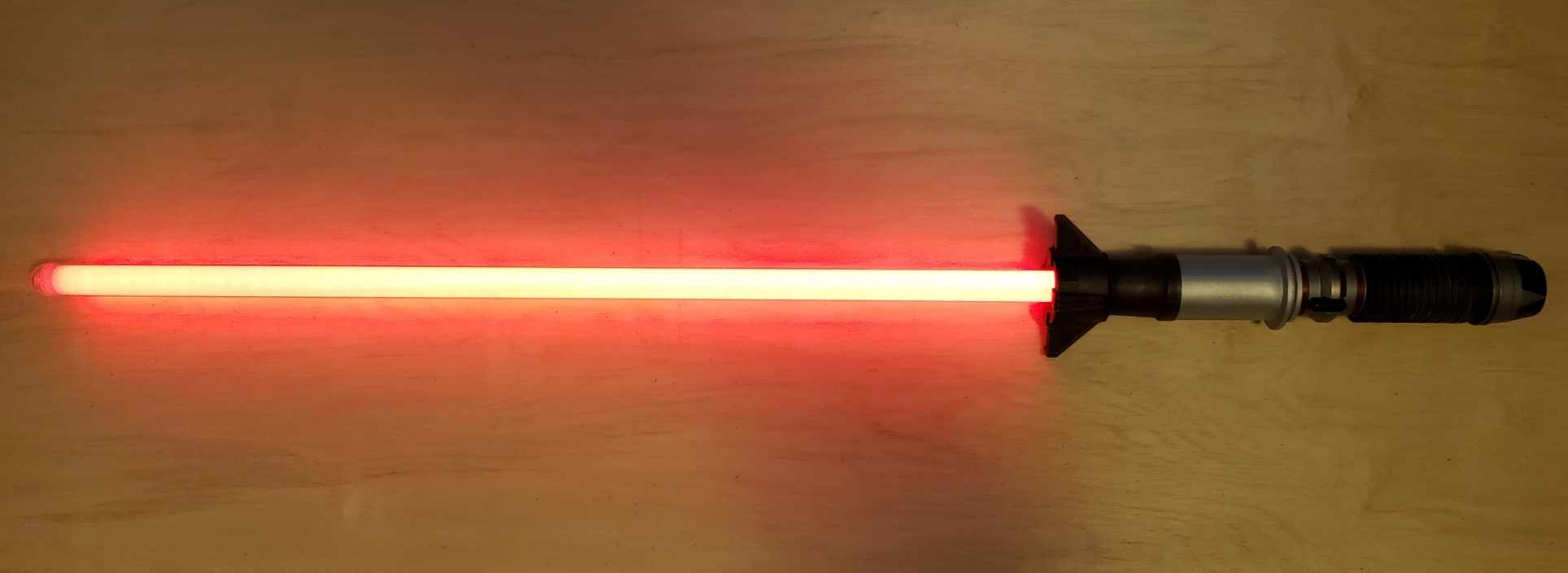

Just finished a saber hilt today. I stupidly bondo-ed the part that was supposed to screw open for the electronics closed….so I wrapped it instead of painting it to cover the gaping hole.

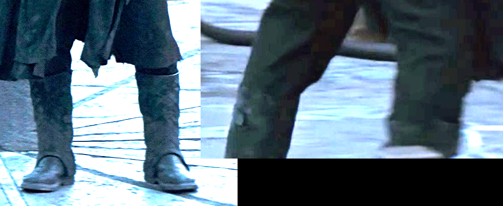

I did a quick Baylan for the Ahsoka preview at LFL, now I'm trying to go back and update what is needed. One thing I've notice and haven't got any clear pictures of is his boots. Looks like he may have armor or some kind of over laid. Has any one seen his boots?
Looks like it's spats with tabs in the back.
Kind of what I was thinking, with maybe one or two tabs in the back. Looks like gaiters of soft material and not hard armor. And in this picture it makes me wonder if they have chevron in the front, yet you can't notice it in any other picture so not sure if it's the lighting. Going to try and look more closely tomorrow.

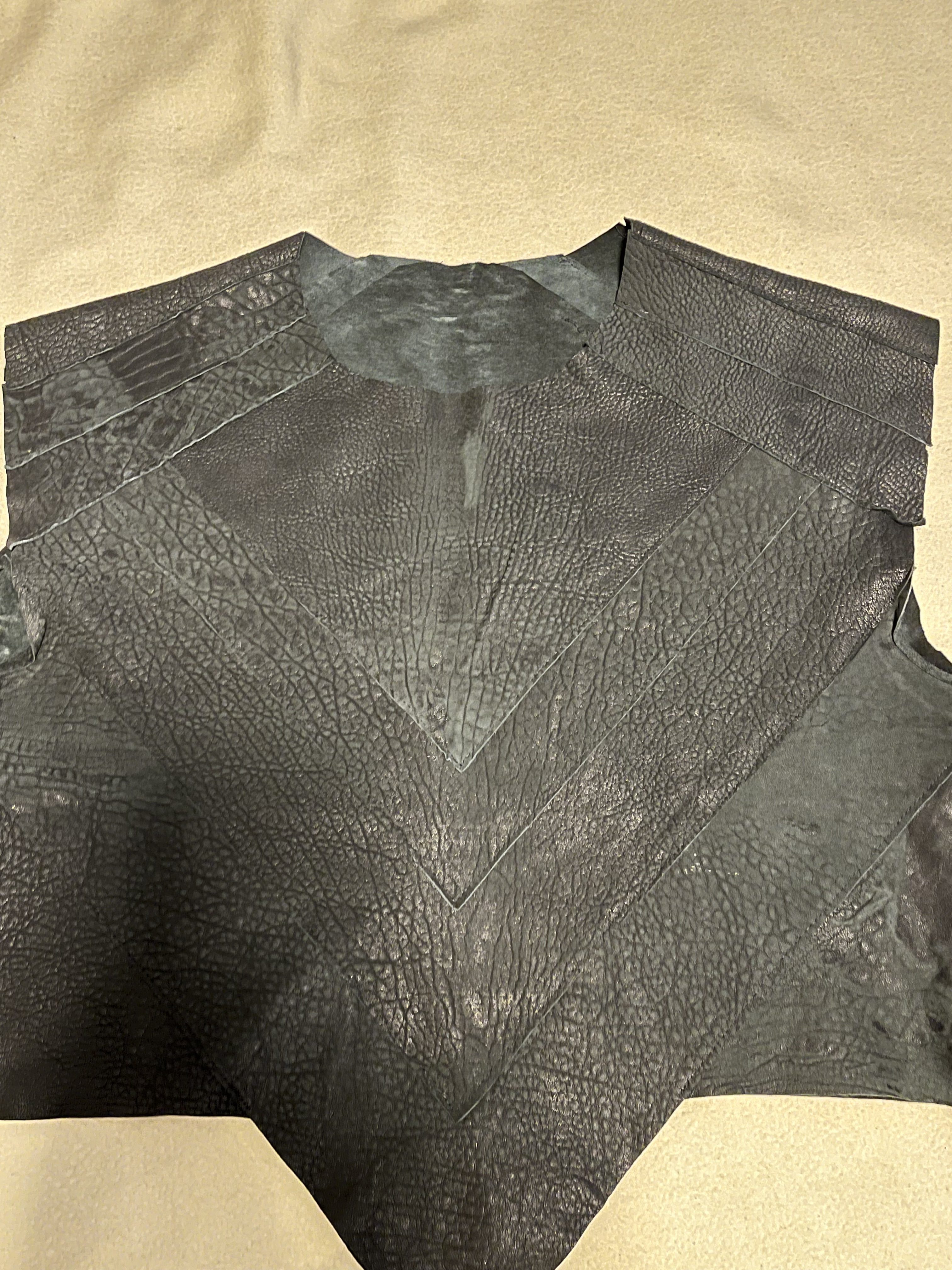

1. I think the tunic may be leather. Possibly even a couple different types of leather. The central piece looks smooth and the others a bit suede. Hard to tell.

1. Def a leather of some kind. I managed to find some faded black scraps leather for mine. While we didnt have time to whip-stitch or attach cording, just sewing didnt look too bad for the short production time. the pointed end was used for tucking behind the obi. Its mostly about getting the pattern right and people will know instantly, as they did when we were out there in June.

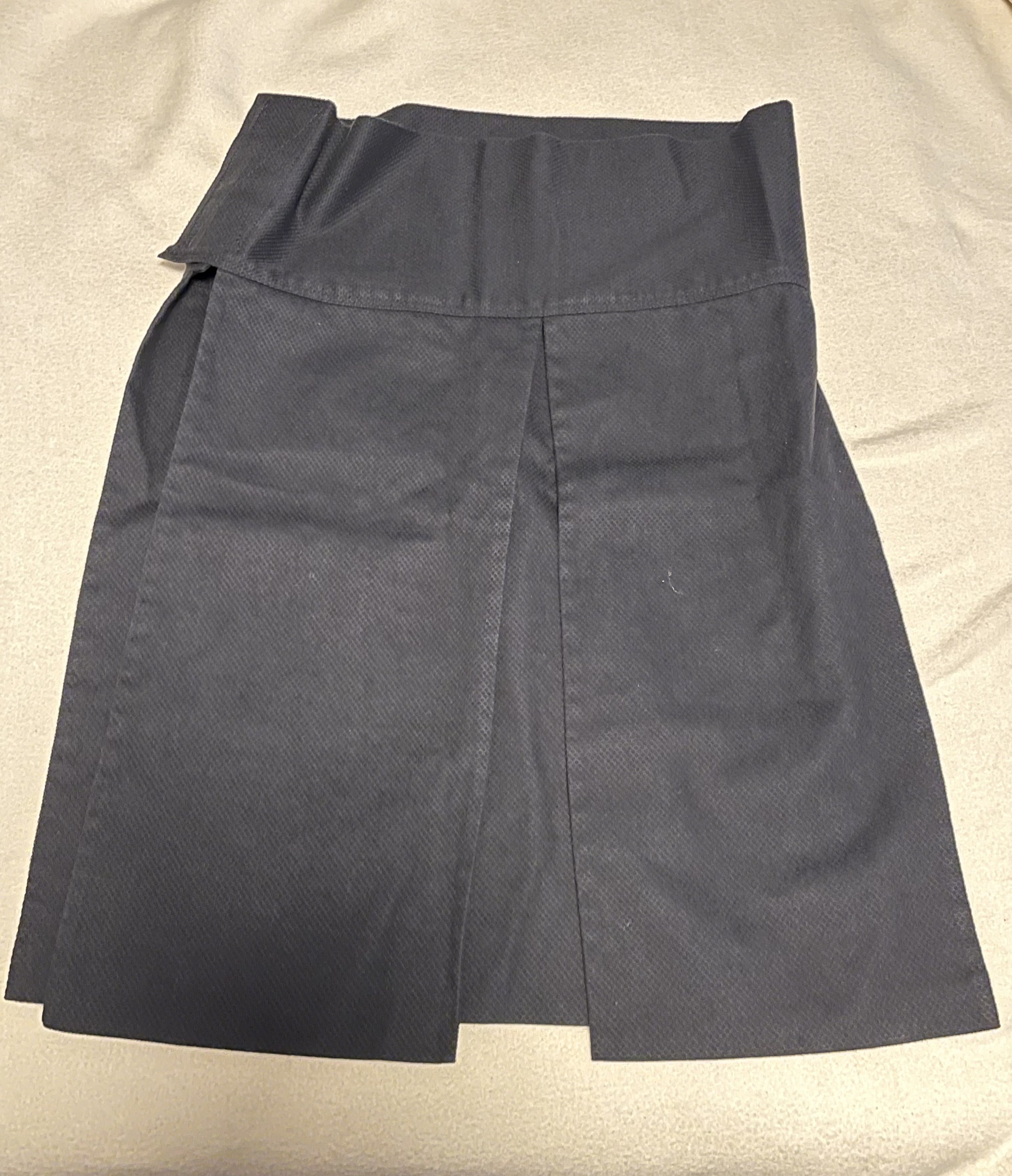

2. There is an obi under the belts (a sash like fabric worn on traditional Japanese uniforms) Its weird deconstruction this costume wife and I found they borrowed form medieval knights, Scandinavian materials and Japanese outfits. Since Lucas originally drew his inspiration from Akira Kurosawa's feudal Japan films its not that surprising I guess.
3. So to not get overheated with the layers, a gauze type fabric as the undershirt(with a mock turtle neck) and the visible sleeves, was under the leather tunic and a cloth vest as a middle layer(under vest) that I used to attached the shoulder armor to under the leather tunic vest.
4. Bottom half of the tunic we made as a separate piece for dressing/undressing. Think of it like a skirt with velcro on the side to enclose. made of a rough linen fabric that had texture. Sewed the obi to the top of this for, again, ease of dressing.

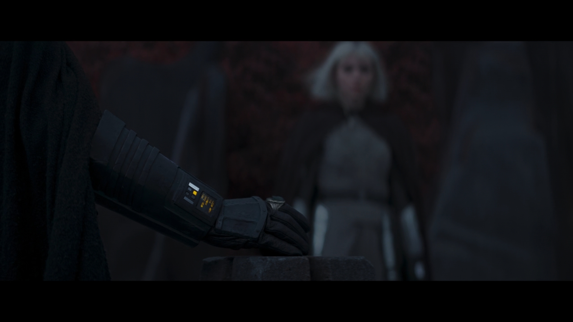

Also, after watching the first 2 episodes, I am definetely going to reprint the gauntlets and modify to fit an apple watch on one side (make a custom screen face) and a disney band port on the other.
View attachment 1731247View attachment 1731248View attachment 1731251
Your costume looks great! Your beard was way more consistent that i was able to get. Mine looks like I tried to dye the mustache and goat but left the rest gray. :) They look like they covered a pair of modern boots with boot gaiters. Definitely looks like they didnt spend much time on his boots, for what was an otherwise nice costume they made for the show. Check the instagram post images from Rosario Dawson she shared with Ray in them. How did you do the lit saber?! I had to 3D print mine and it turned out meh.
I just let my beard grow and it seem to fit the part. I agree that the boots look like they are covered with some kind of gaiters with a strap or two in the back.

As for the gauntlets… They were a bit of a pain; I used some Velcro and a strap going around the back end. They were a bit to small, I have since resize them better making them a bit shorter and a bit wider (was hard to bend my elbows and hard to close with gloves), I’ve 3D printed them and will be using magnets like used with the Mando gauntlets, will be ordering the magnets this week to see now it works. Also looking at butting some lights, the new print I did, I cut out the buttons to have them open, I put clear cover so light can come through. The button layout is a bit different then the 3D files I have but I might try to change it later.

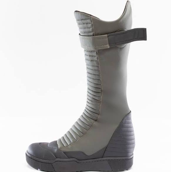

Shin's boots are from Demobaza. There are several styles with the same toes, quilted instep, and soles but the Tops Oneness Ws are the closest in color currently. (Edited from an incorrect shorter style. Somebody messaged me a better match.)
Sabine Wren's boots are also from the brand. Guess they shop at the same store!
