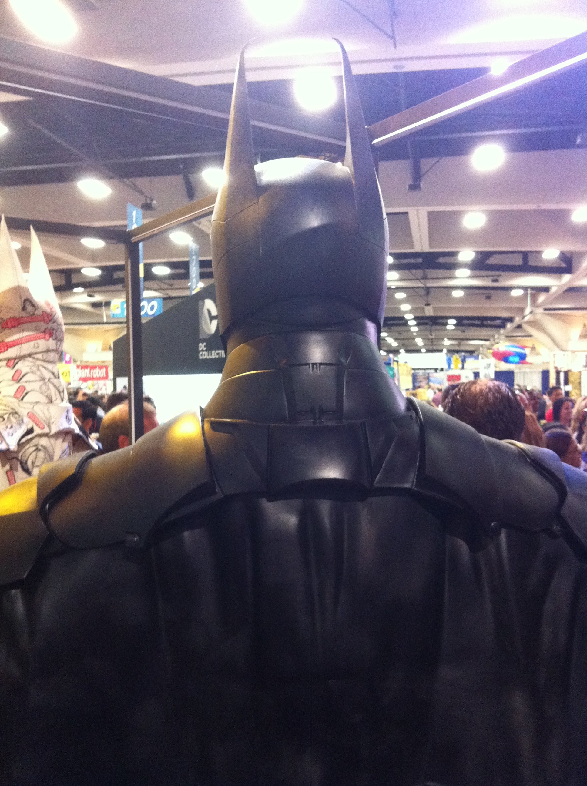

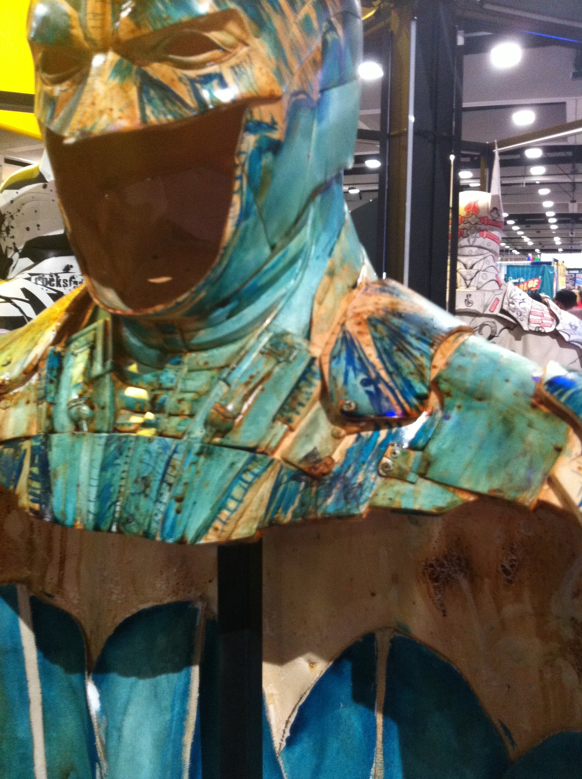

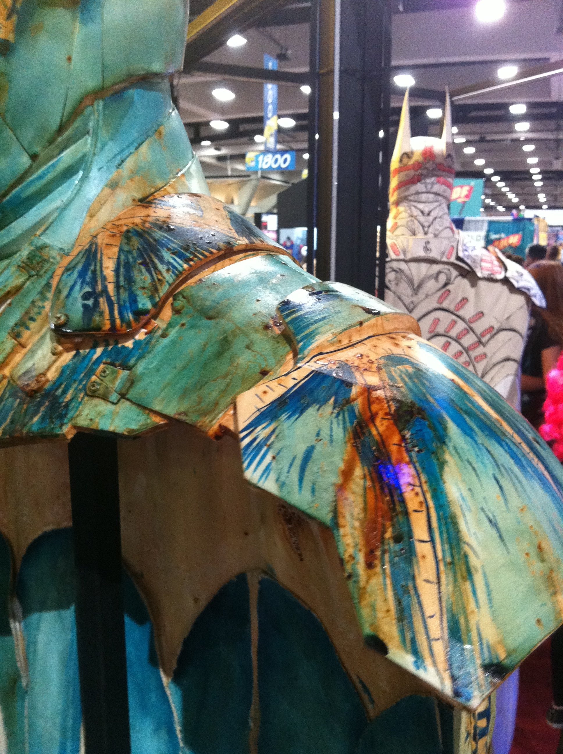

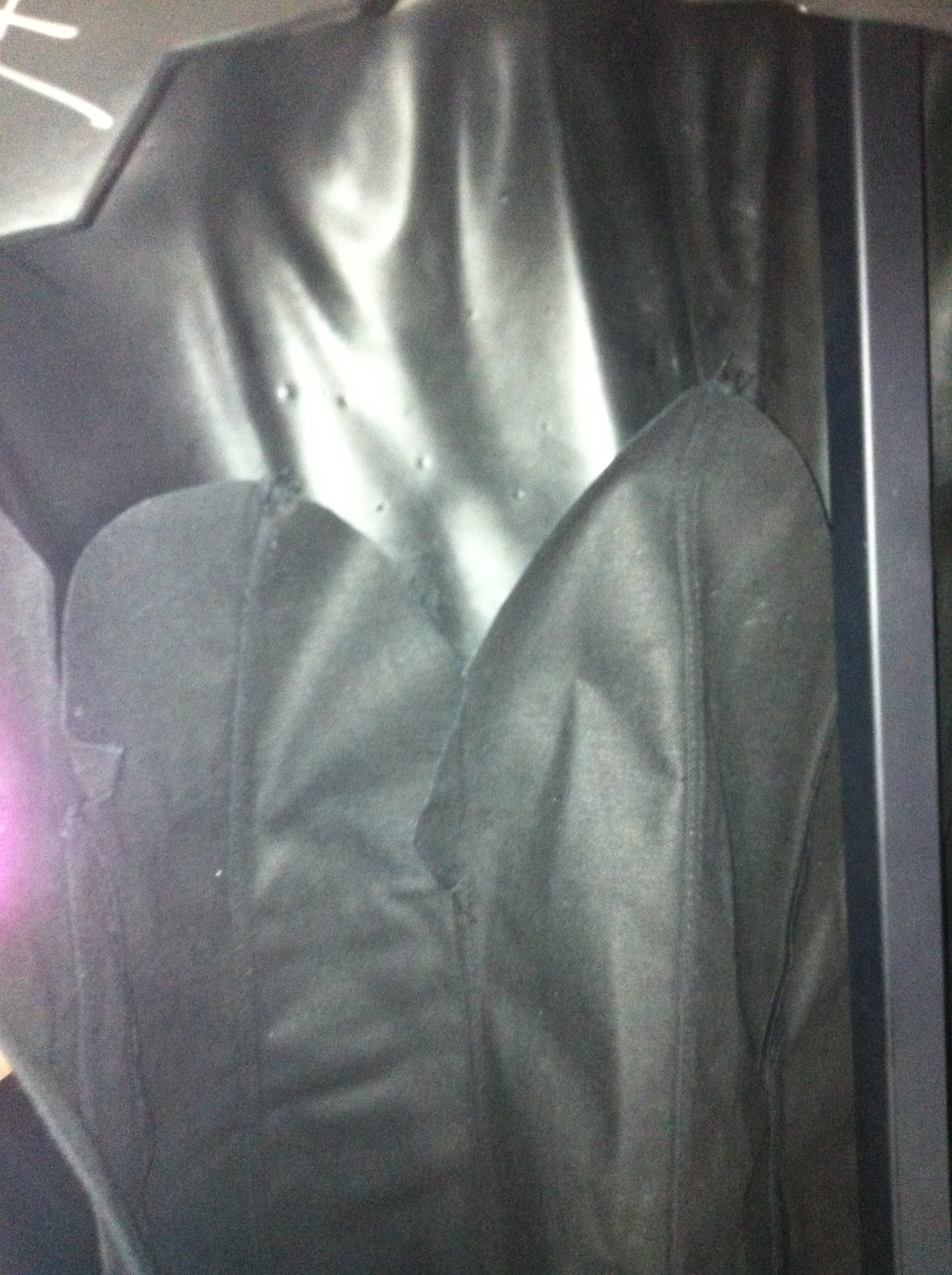

Then there's the matter of patterns. There should be a few different patterns readily available online for free - I'll see if I can pull up any of my old ones. The trick with the Arkham suits is that most of them had a yolk - a heavier neck draping, or the part that's in front of his shoulders when he's standing still. If I remember right though, Arkham Knight DIDN'T have that, and it actually just hung off the shoulders to the back... so all the better! One thing that is different about the Arkham Knight cape though is that the back panels were split in to two sections - the uppers and the lowers. Which really should just be layering panels to your liking, but maybe I'm wrong? In hindsight, I wish I had taken better photos when they had the Arkham Knight art exhibit down at SDCC, but these are the photos that best showcase what I'm talking about:
You can see that the panels that split the back are highlighted with white paint in the earlier images, with a completely different piece on the upper back. Since the cape mostly drapes behind, you really shouldn't need to worry about "wingspan" too much, unless you plan on doing some elaborate poses.

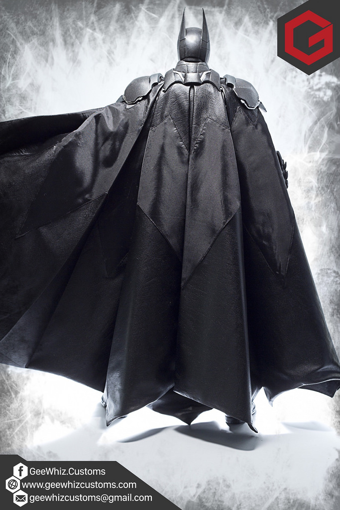

The Arkham Knight is one of the most complex capes of all the Batman capes. I have only come across one vendor that sells them and they are on Etsy.. Most people end up making their own. There are 3 different "layers" to the pattern on the back of the cape. Mine turned out to be 24 individual sections that I sewed together to get the right look. I attached a photo of one of the action figures for reference.
