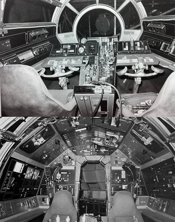

Bandai provided black decals for the controls and roof of the Perfect Grade. Set pictures show the are gray panels on the controls and roof. Did they make a rare misstep?
I used the decals because they offered too much detail that couldn't be painted.

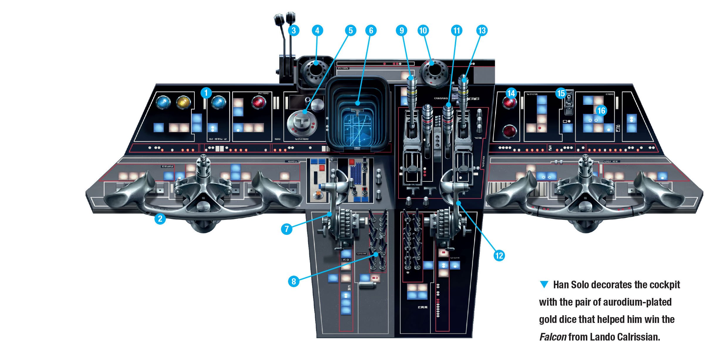

Well, it's complicated. The PG Falcon model is a very accurate rendition of the 5 foot miniature's exterior as it appeared in the first Star Wars movie. However the cockpit is wrong, since it's a rendition of the Empire full-sized cockpit design.
But yes - they didn't colour some of the panels in grey that should have been. Conjecture: perhaps because of issues printing them?
I don't think printing gray would be an issue. I don't think there's any all black version of the cockpit in the films so it's a mystery as to how they missed the gray panels. They are such sticklers for detail.
