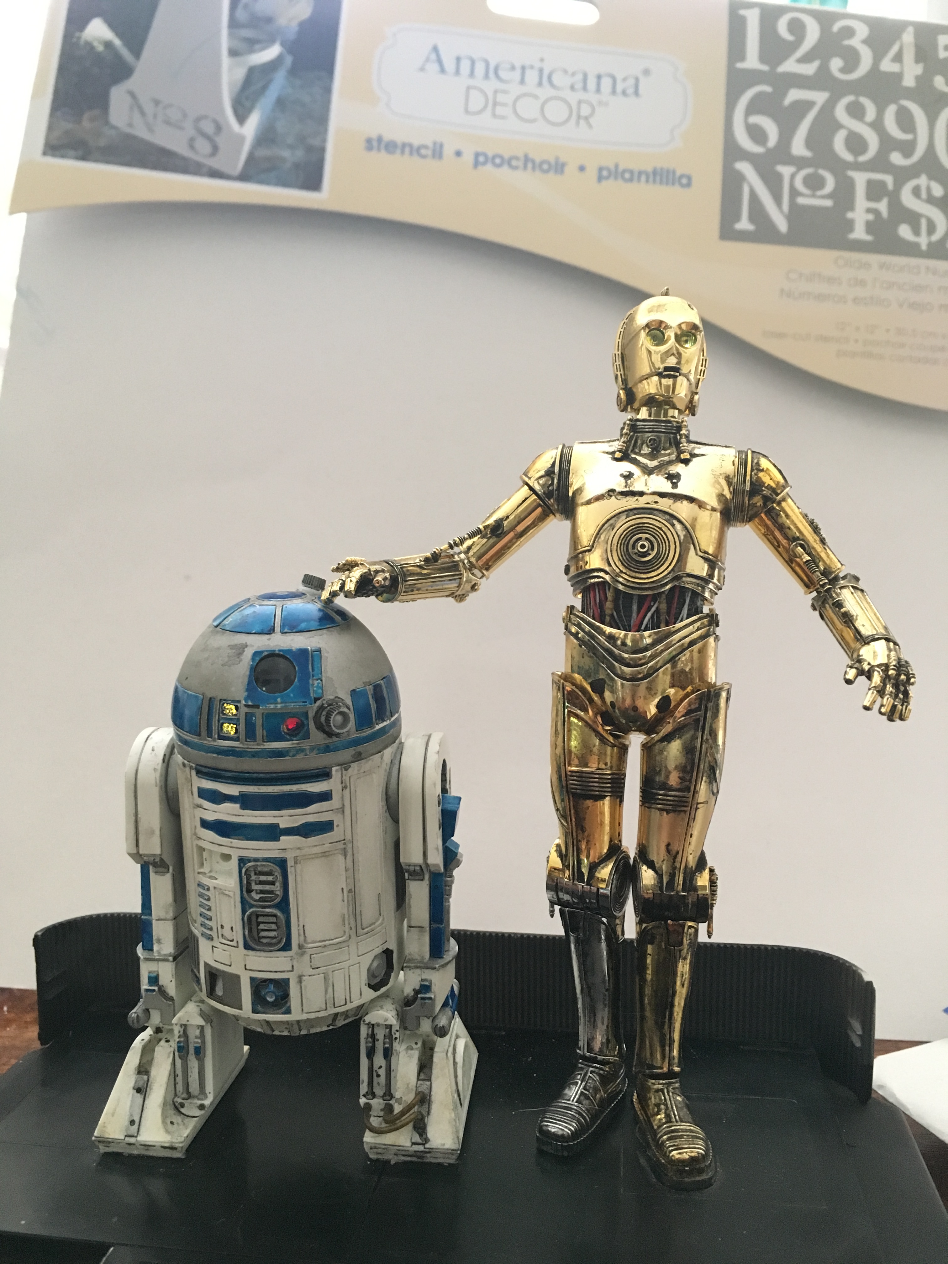

Here is are my Bandai droids. 3PO has a tiny smd in his head. I drilled through his neck and the joints in his legs to run the wires, which are exposed on his midsection. R2 has a single LED in his dome, wires were run down his legs into the base as with his counterpart. I used colored plastic-red in the front (i put a dash of blue paint for the "stuck" colorwheel) green in the back. For his logics, I took some hair thin fiber optics from a cheap lamp and put them in square holes I made up front and the rectangular one in the back, so as in the movies, they have actual dots of light. 3PO was weathered using India ink and water as well as white glue to try and recreate the shiny-but-"smudgy" droid from the original. Feedback is appreciated. IMG_1726.JPG
