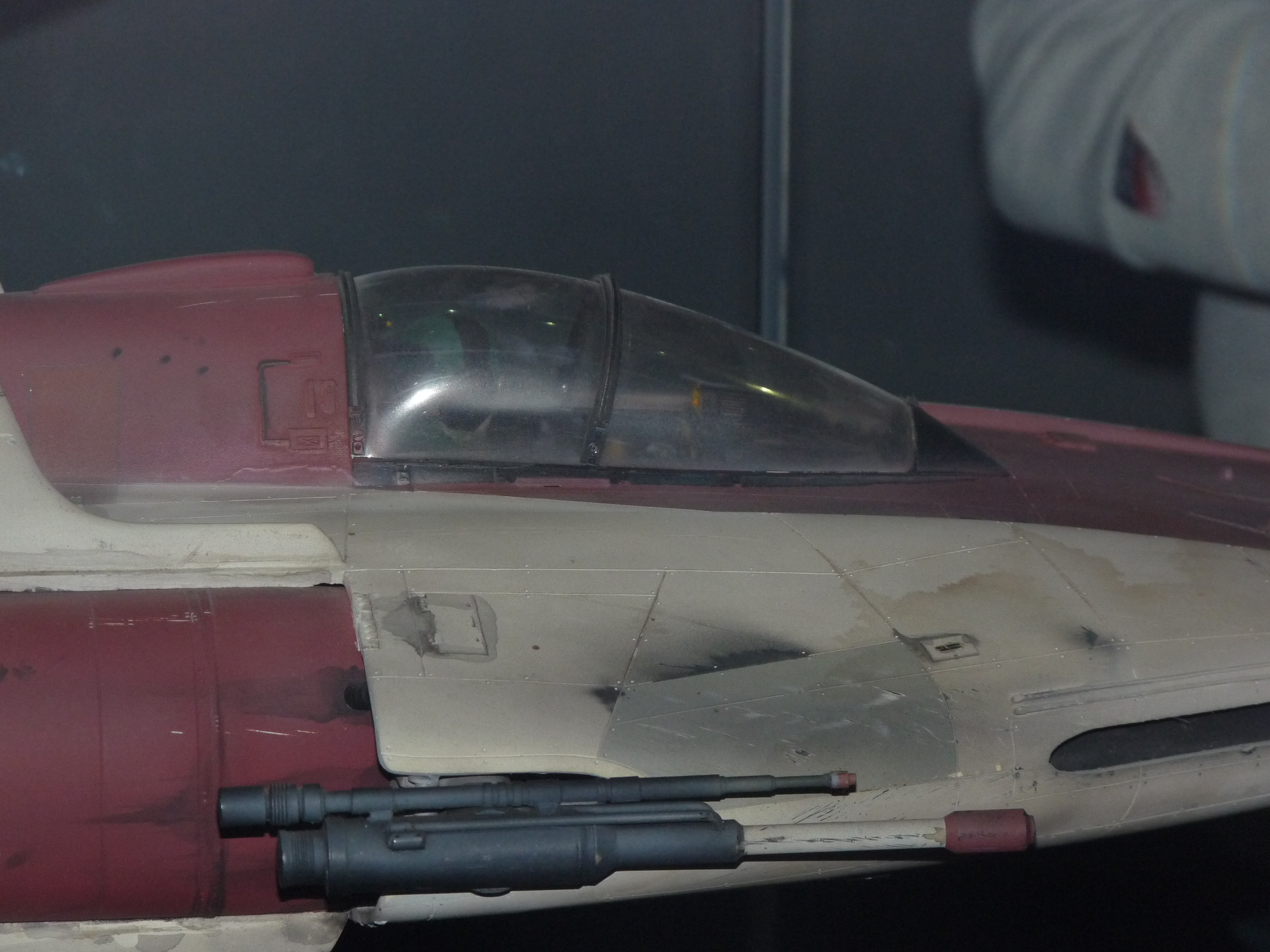

I did some oil stuff. I kept it in the same world as the studio model. Which was pretty sloppy. SO I'm not sure how well this will pay off. After this dries, I'll put another topcoat on.
Then some pigments, and finally a flat topcoat to call it done.
BTW, I've never used a clear plastic canopy before. Is there anything I should keep in mind before putting it on? Windex or something? What glue should I use?

There are a couple of places where the oils look too much like Paint, but I will pull them back with pigments. I'm a big fan of the abtalung faded U.N. white. It comes off exactly like insignia white. So it's great to pull back weathering

incidentally, I noticed that on the old archive pics, the black cockpit surround has some serious chipping. But it looks like someone painted it black between then and the later exhibits

Dip it in FUTURE!
I always use regular cement for my "glass", but I'm probably the only one who does. Most use white glue (like Elmers).
Excellent weathering. I really like the staining effect of the white areas
Thanks,
I really try to use only the stuff that I see on the studio model. So I skipped spatter because there isn't any on the model
That being said, I'm not that happy with it. I might actually add spatter to mute the staining a bit. Maybe even brighten up the grey (which is still too grey)
