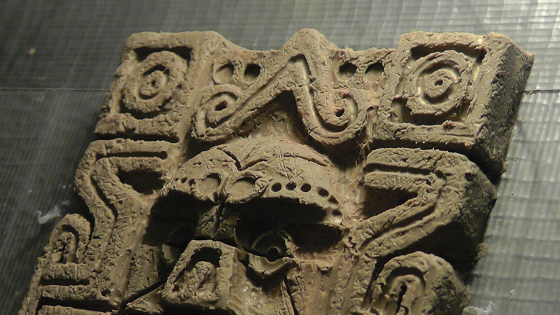

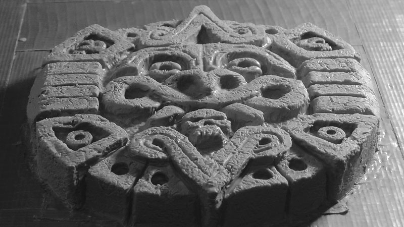

Aztec/Mayan Inspired Wall Relief Designs
That is a nice talent in your hands. Ater these few pics I think your room must be looking ancient and aut of this time/world
lol. Hardly. People assume my house looks like a freak show but it's pretty ordinary aside from the man cave with just a few props. My house just ain't big enough.
These are really cool and it would be very interesting to see what you could do with back lighting showing through all the recessed cracks and crevices kind of like lava!
Well frakshow..., I've just assumed that the fine works of yours sit in few places, like it was with mine few years back, giving the atmosphere.
Lol, like I said. My tiny house wouldn't handle it. Plus, got a wife to keep happy and she puts up with enough. :)
Anyway, working on the outer areas now...
-AL

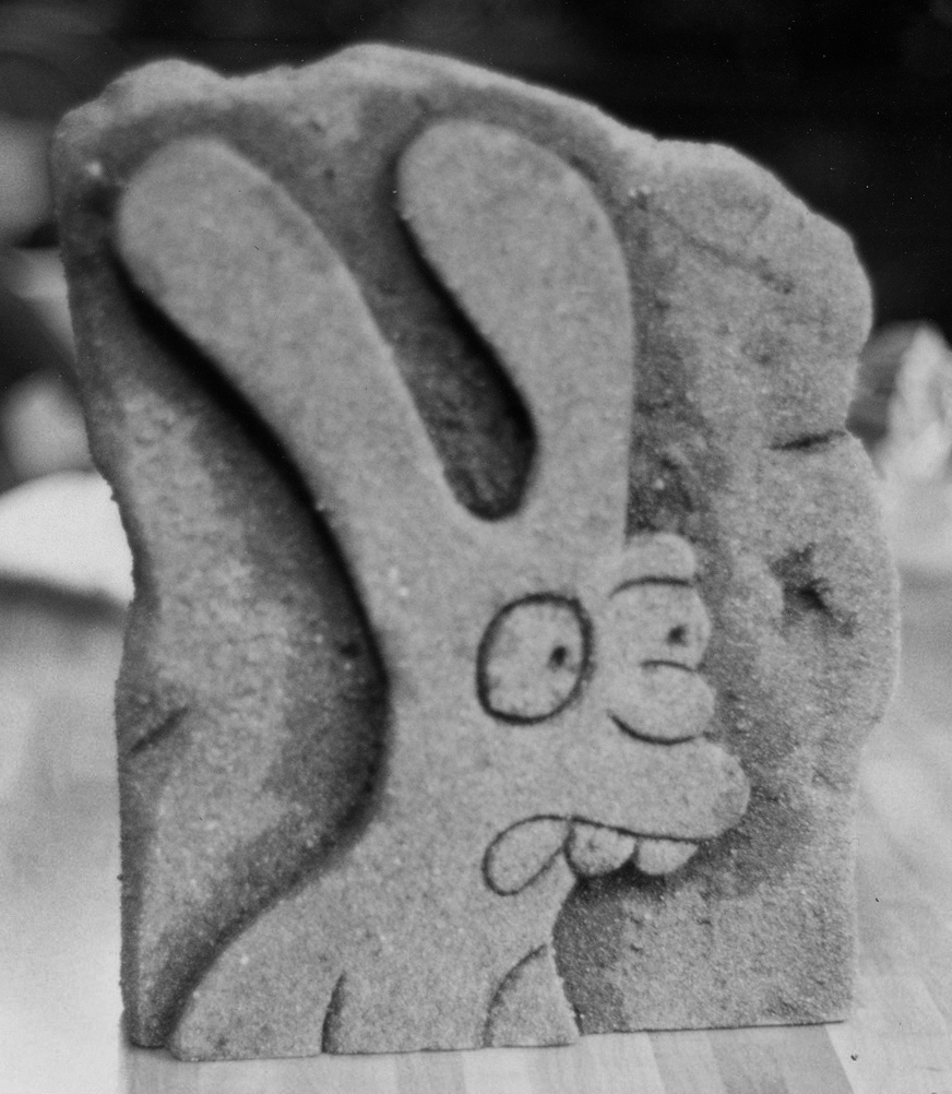

Have you tried sculpting with high density insulation foam? You can get all the detail you need and skip the clay step. I'll round up some pix of a couple things I've done and post them soon.
Here are a couple pictures of styrofoam sculpting. The "Life in Hell" Binky
is a sculpt in Styrofoam I did around 1987(?) with a high density Styrofoam Brand insulation foam.
The picture of foam with the cuts I did yesterday using a sharp knife and X-Acto blade. The foam will dull a blade pretty fast so you need to resharpen
the edge frequently with a sharpener. A small inexpensive V shaped sharpener works great. You can find them in outdoor and sporting good stores for less than ten bucks.
This particular foam comes in 4x8 foot sheets in a variety of thicknesses. If
I remember correctly you can get it up to a foot thick. Most cities have a building or insulation supply house that will carry it. Home Depot and Lowes sometimes carry a similar product that is pink in color and used for insulating
homes. You want the very dense material. The white cellular or puffed and compressed foam is too crumbly.
The dense stuff that I used is carveable and sandable. I word of warning. If you are doing a lot of sanding, wear a mask. Small foam particles get airborned and can be inhaled. Since they are not biodegradable, they will stay in you lungs pretty much forever.
I only carved and painted my stuff, so I don't know if a fiberglass type coating would work or melt it. Someone here probably can answer that.
I used to work for a company that used it for set pieces. We would melt Van Aken clay in a double boiler and brush it on to the foam. Then sculpt or texture additional details.
If you are making a large scale sculpture that you intend to mold and cast in
something else, this technique will let you build big items that don't weigh a ton.styrofoam_binky_bwjpg.jpgstyrofoam_cuts.jpg

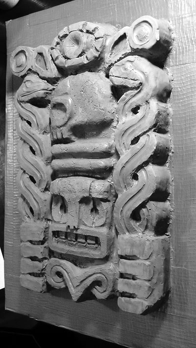

Revised the top a little further with added skulls on each side, as well as two serpent skulls in the diamond-shaped niches. Added preliminary cleaved stone texture throughout.
Sill a lot of cleaning up to do on the sculpt but I think it's really close.
-AL

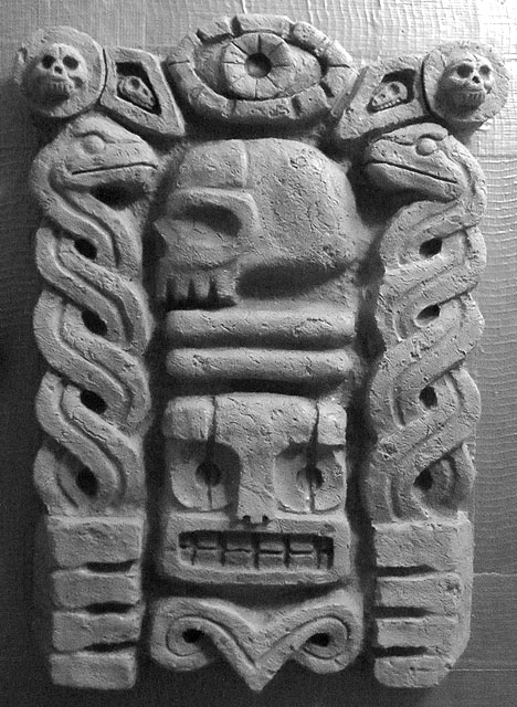

Finally completed the sculpt. I'm very happy with the way it turned out. It's difficult to photograph in its unpainted original clay form (hence the directional lighting and monochrome images) but here it is...
I made the surface look like it's been lost for centuries with cracked and cleaving stone textures.
I love this last picture. Looks ominous...
-AL

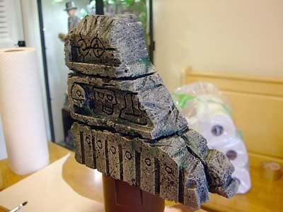

I recently pulled a handful of castings from the mold and are coming out great. The images shown here are of a raw pulls fresh out of the mold so no they have not been cleaned up or touched up where needed. They'll take another week or so to fully dry, at which point it's on to sealing, priming and painting.
Back with wire loop for wall hanging.
Here's the other sculpt fresh out of the mold.
