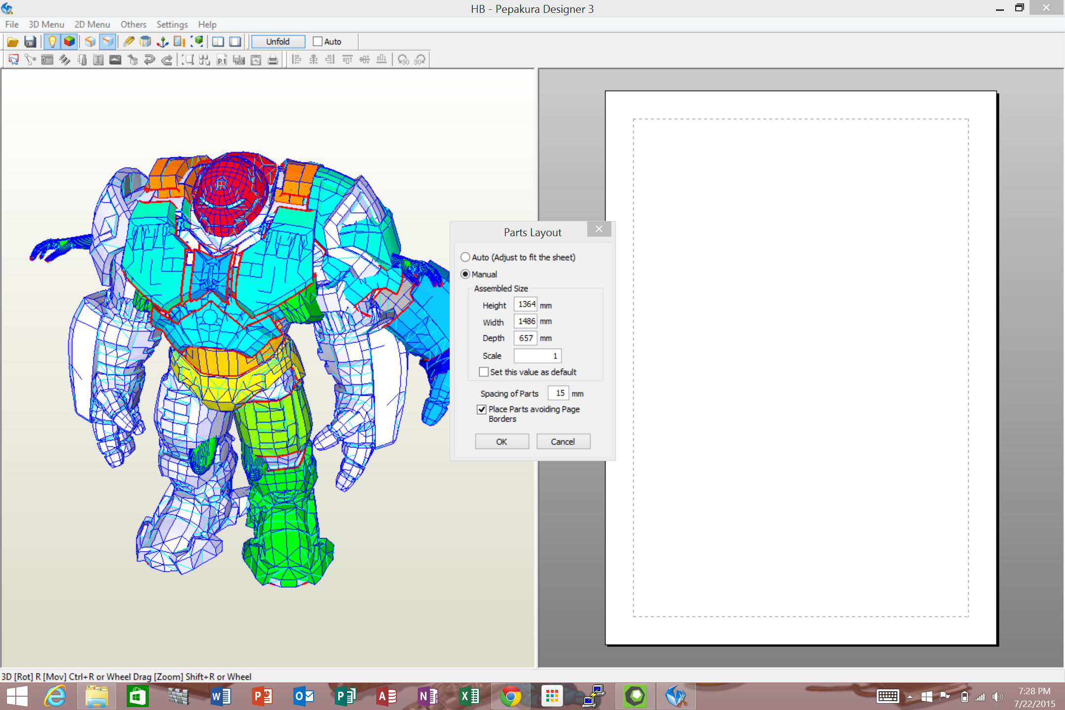

Hello and thanks you for all your hard work and file release. As you read this I am preparing my spare bedroom/workshop to build this in foam. At your present scale what is human size for it so I can scale it up to be aprox 8ft tall on completion. Wanna get size right on first try. to much work for a do over
I'll check tonight but I believe a scale factor of 1 is for 6' (that was my plan anyway).
For me I reduced the chest by .8 on the X and Y and will probably increase the stomach and rib section by 1.2 on the Z for a better fit.
I also modified the head piece to incorporate room for my neck since HB doesn't have one
i have pep version (without flaps) for 8,5 ft (2,60m) unfolded 70% (A4 size). can give you now, but you need to unfold the rest 30%. or, you can wait few weeks, i will done unfolding and Shadeling will share file in 1st post.
Strange, the full view is 1364 high = 57 inches
let me recalculate
Update: Yaaaa, I don't know what I was thinking, unless I had a child in mind what I unfolded at default scale of 1 wont fit most adults

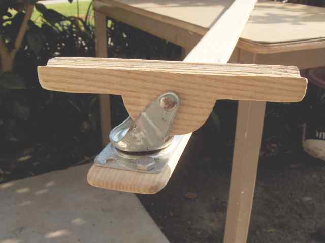

3 inch caster with the wheels drilled out attached to a fixed caster for the bicep

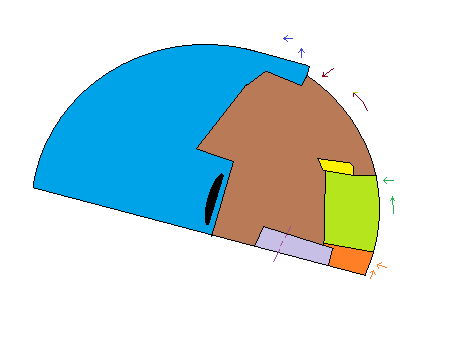

I'll do the same for the elbow with the swivel attached to the forearm for 40-60 dagree rotation
there will be an opening in the inside of the forearm where the levers for finger control for the hand which will not rotate
That's the idea anyway, trying to plan and price everything out before I start construction

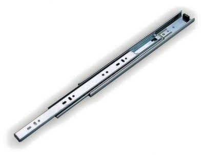

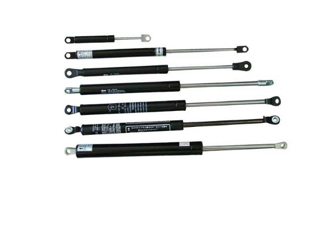

i just finished main part of chest, and its gonna be really huge. however, your idea is interesting, it can be worked. also, i think, you need to think about support details on the frame and some moving parts. like this:
View attachment 505011View attachment 505012
I love the piston idea. I'm not going too large, I'm planning on 6'3" in height. The shell will be have Velcro and earth magnets for easy assembly and storage.
