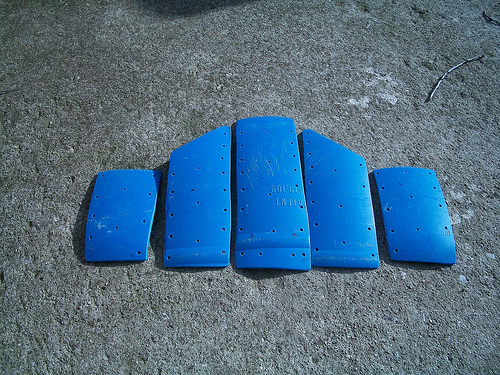

Here you can see some of the torso pieces cut, and their lacing holes drilled. Note I'm not making this pretty, it's going to be hit, a lot, by big dudes with rattan clubs, and it's going to be hidden under my clothes anyway. The lettering and stuff stamped into the barrels can be sanded down.

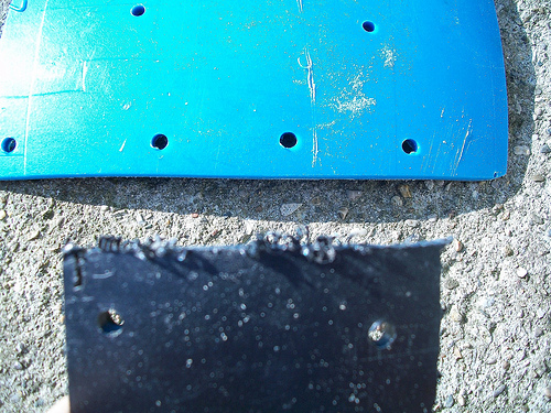

3) Once everything is cut, fire up that torch, set on medium low... ish. And braze the edges, you'll want to look for the plastic to start to get shiney, then brush that edge against your concrete or whatever. Repeat on the corners of each edge to kind of round them out. Here's a before and after shot.
