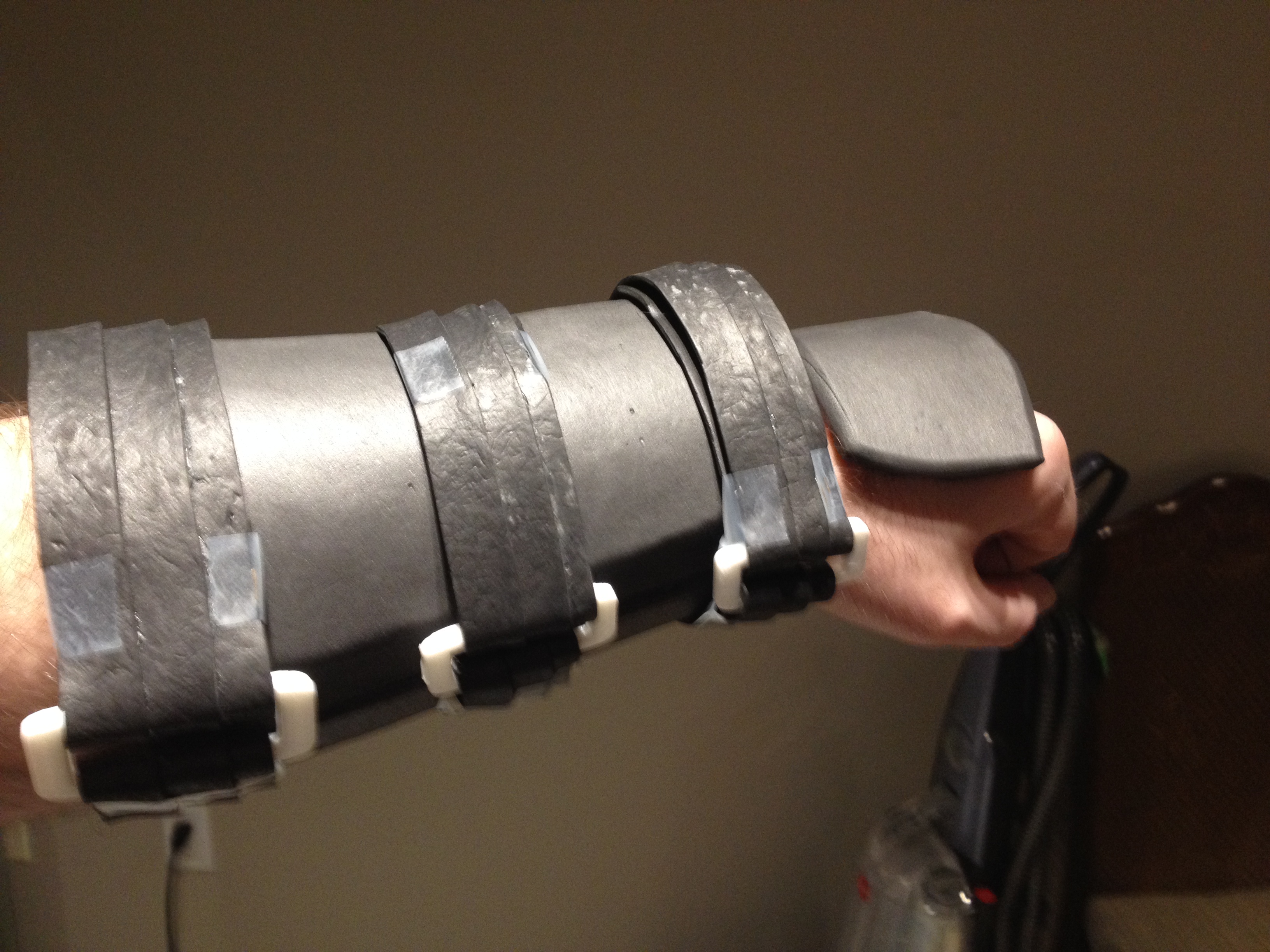

I wanted to add leather straps around the gauntlet. So I used a technique where you use a crumpled up piece of aluminum foil, iron that over top of the foam, and it gives the foam a beaten up leather appearance.
Here's the straps test fitted to the gauntlet with some tape and 3d printed pieces to loop around.

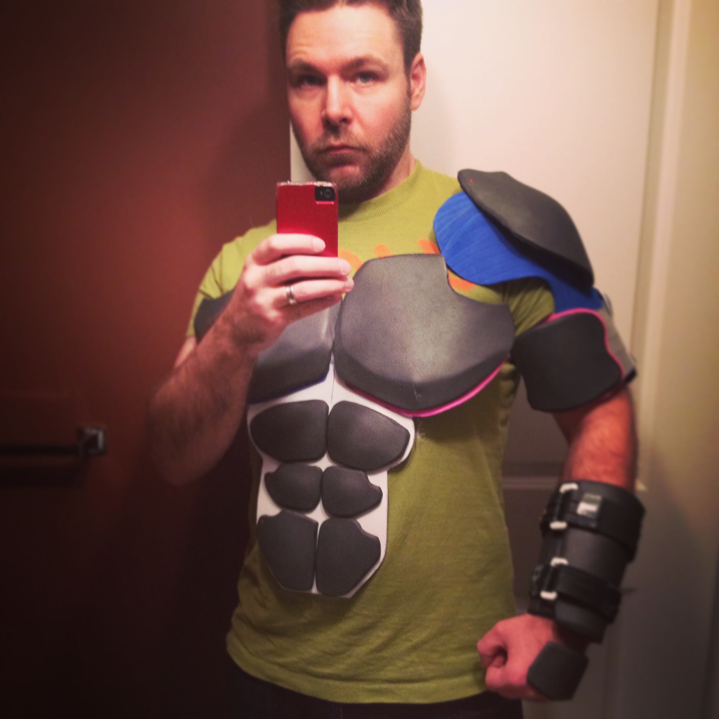

Next up was the bicep/tricep/shoulder armor. I used some thinner craft foam to give each of the pieces a bit of an outline. I created some kind of musculature type pieces to mount the shoulder on to which will then be strapped down tight against my chest. I etched in some detail lines just using a plastic tool I have with a pointed end.
Quick test fit of the armor to make sure everything is fitting together. So far so good.

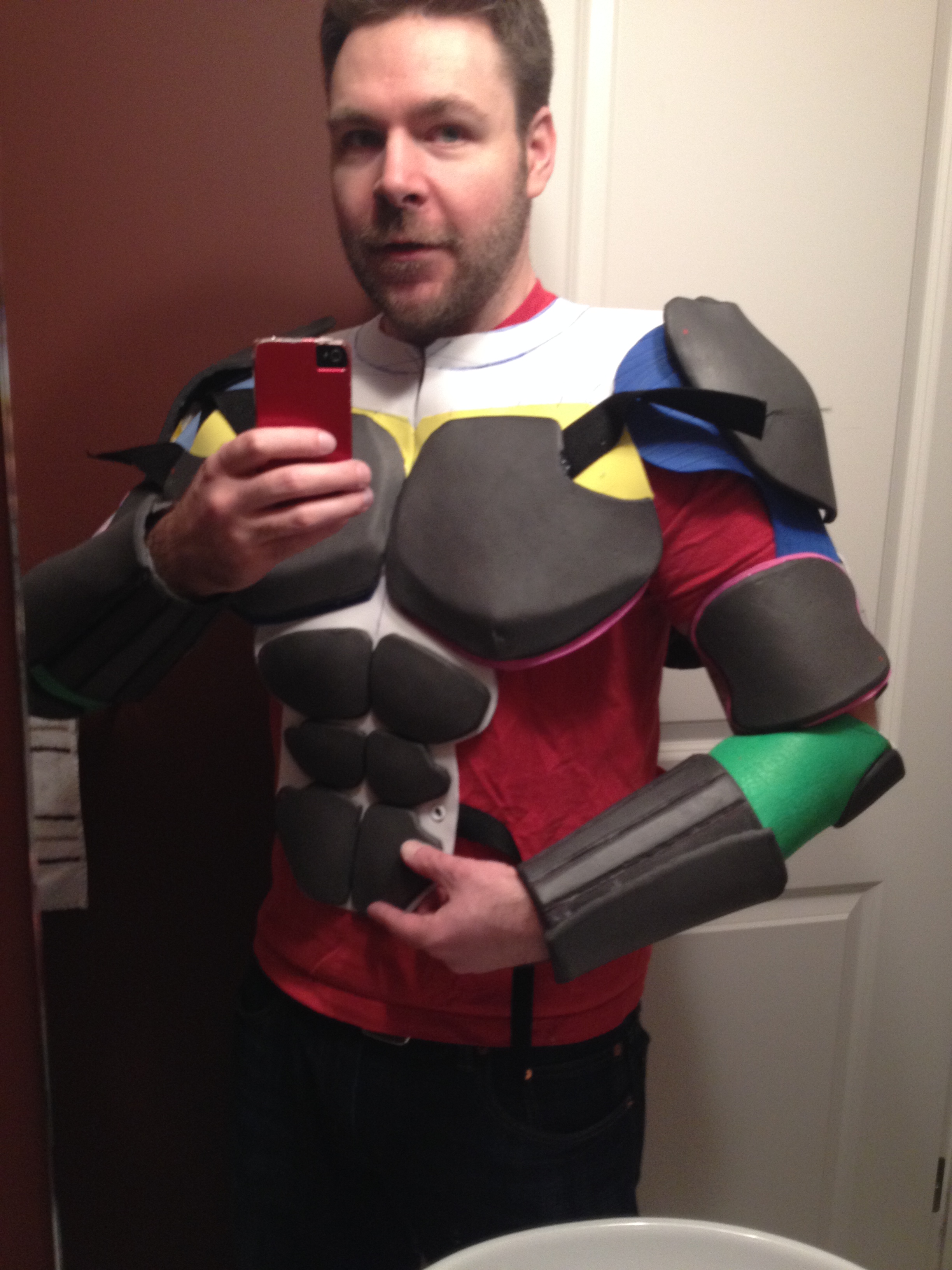

I started to work on the back and realized that the armor I had for the back was way too small. So I built some additional armor plates to sit at the top of the back. I also started to form a collar piece that would link the back to the front. My plan is to add some raised bits between the neck and shoulder similar to Wolverines classic stripes. I'm also going to thicken up the collar to give it a bit more pop.
Another test fitting of the parts. I need to start getting some strapping done. It was hard to take this picture and hold the armor on. The upper forearm needs more work, I'm not loving them right now.

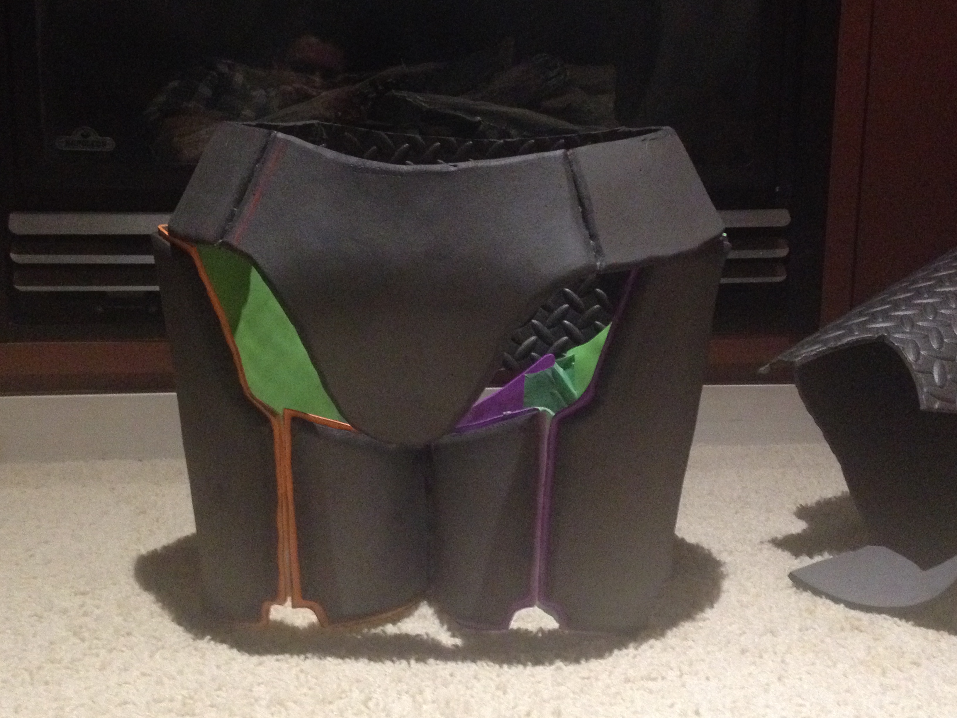

I cobbled together a pelvis and some thighs. I'm going to mount a belt on top of the pelvis to give it a bit more detail and maybe etch in some detail lines. The thighs still need more work as well. I'm going to extend them down a bit more with some additional detail bits.

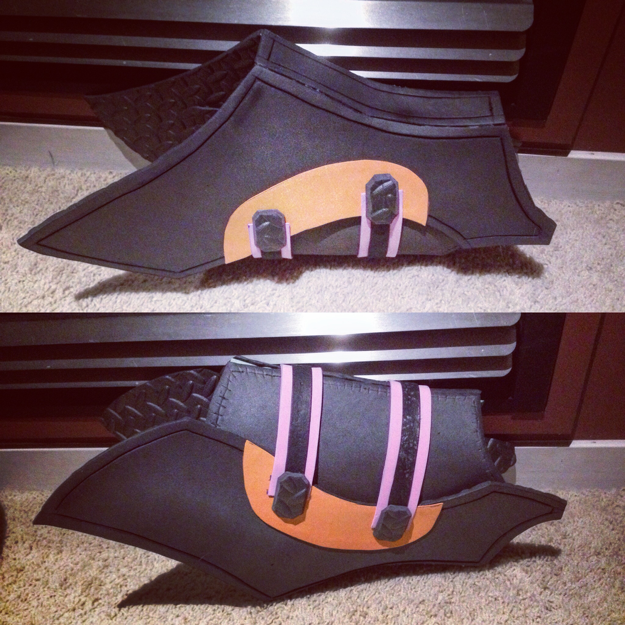

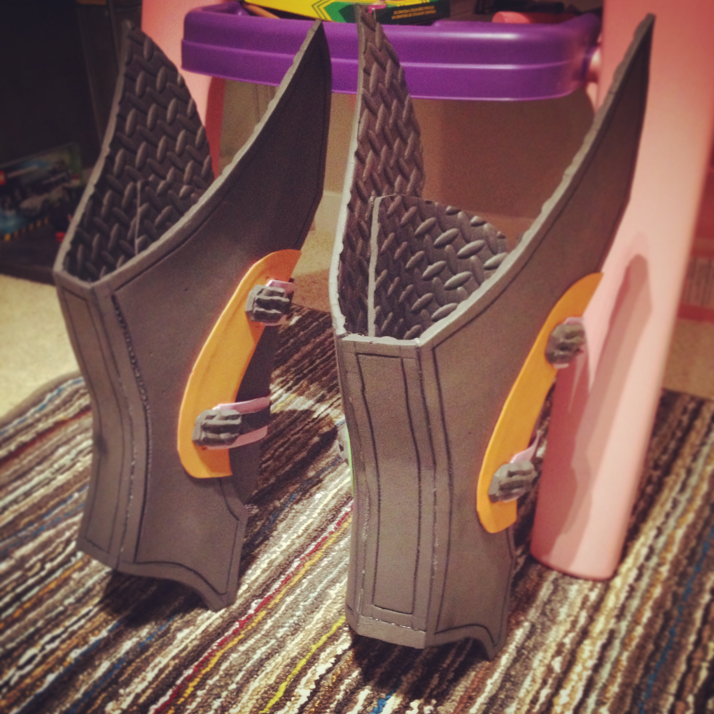

Finally we get to the calves. I tried to give them the winged appearance that Wolverine has always traditionally had on his boots.
First calf done. Pretty happy with how it came out.
Two calves done! You can get a better sense of the winged tops in this picture. I'm really happy with how these guys came out. The next step is adding boot covers and some knee pads.

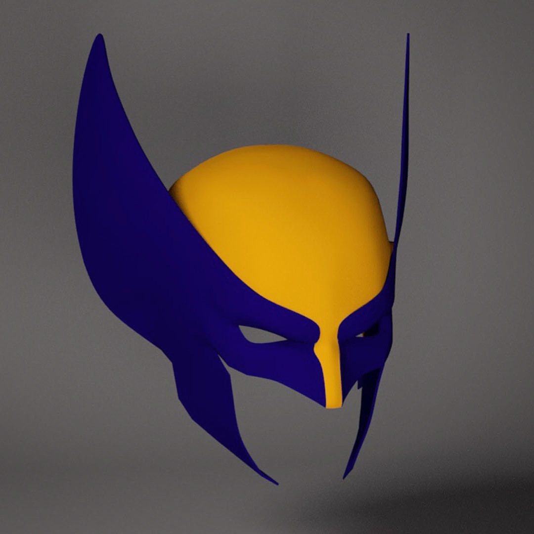

This is the helmet I'm going to be using for the costume. I took the pepakura file and converted it to be 3d printable. I'd love to show some pictures of the actual print but the damn printer nozzle jammed over the weekend and I haven't had time to take it all apart and clean it out properly. I swear those printers are more trouble than they're worth.
