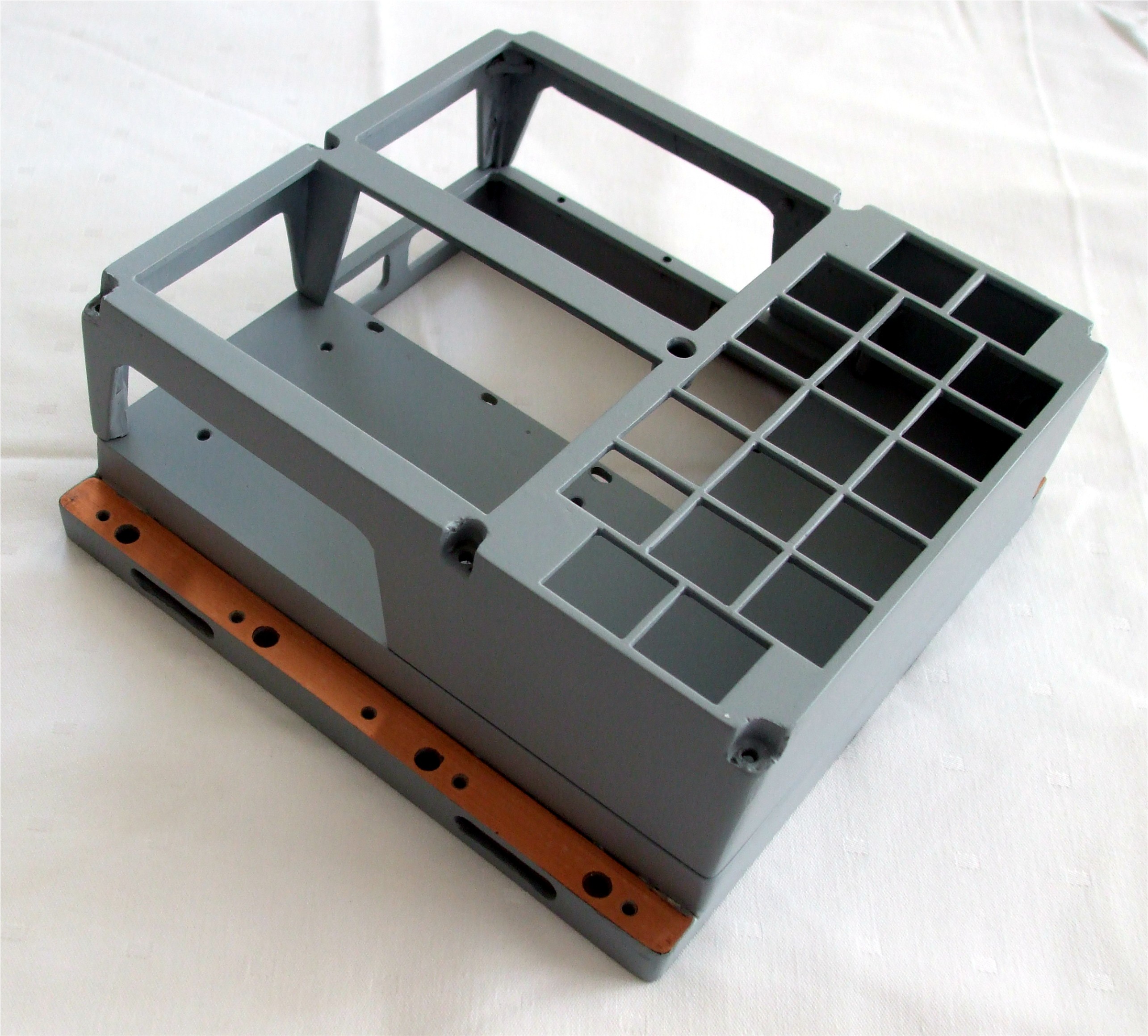

I am going to fab it up in styrene to start but I have a friend with a machine shop who might mill me some parts.

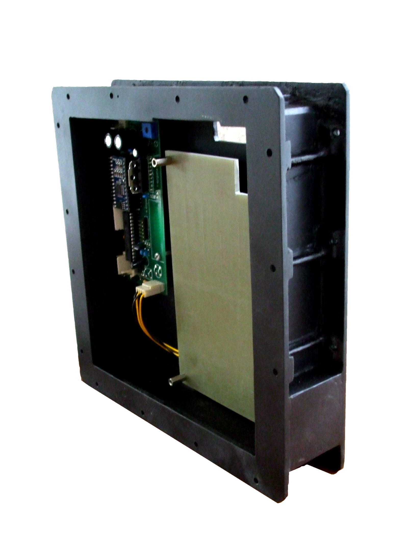

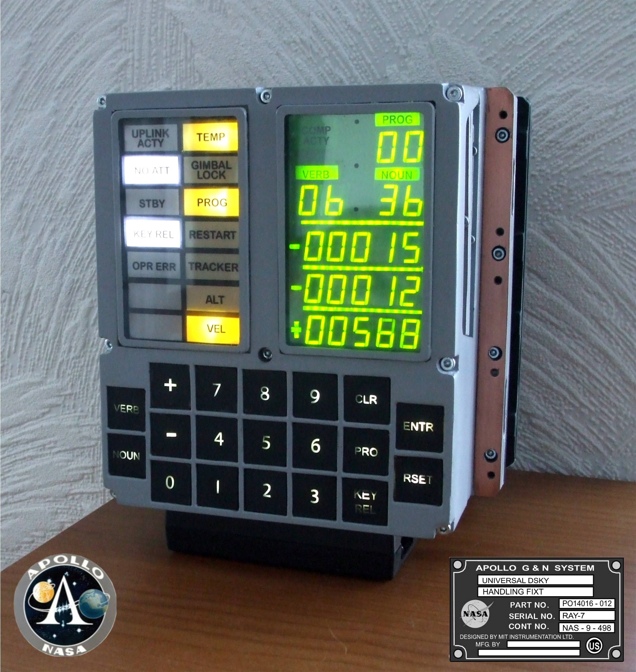

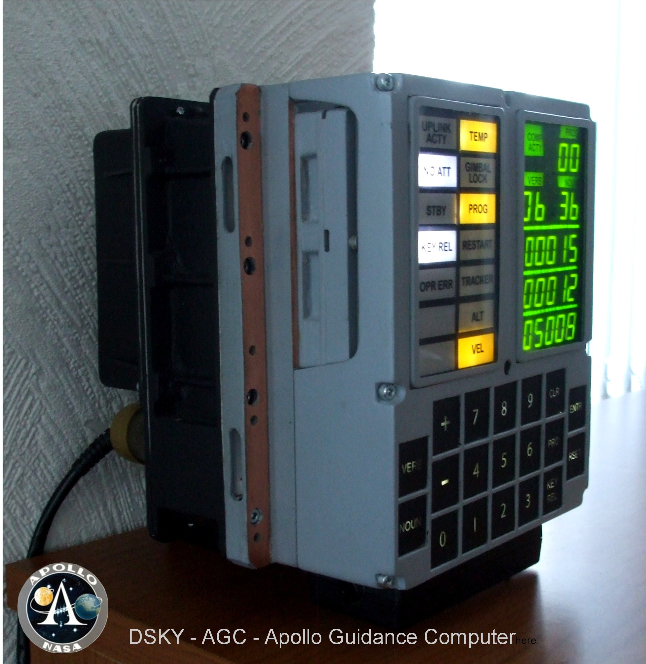

Yes I have. Thats a physical model of the electronics in a "Block 1" spacecraft (worked but didnt go to the moon) I am working on a replica DSKY reproduction with LGC simulator. His is the real thing but doesnt look like it. Mine isnt the real thing but does look like it. Thanks for the link though, it provided additional info I needed for the software development.
agc2.jpgWorking DSKY-Apollo Guidance Computer
Very impressive work, especially the back, there must be consierably less pictures of the back than the front.
How much of it was guess work
