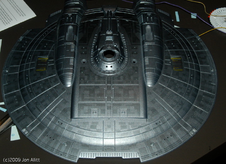

I'm in the middle of this right now:
every square inch is covered in waterslide decals to get the subtle panel shading :unsure
Amazing idee, Do you have a thread about this. I have the NX-01 myself but have not started yet.
If you dont have a thread please make one.
/Conny
it's a decal set from here:
http://www.acreationmodels.com/
Apparently the re-release of the polar lights 1/350 1701-A is coming out with a full decal sheet for the aztek panelling (which is why I'm practicing on the NX)
