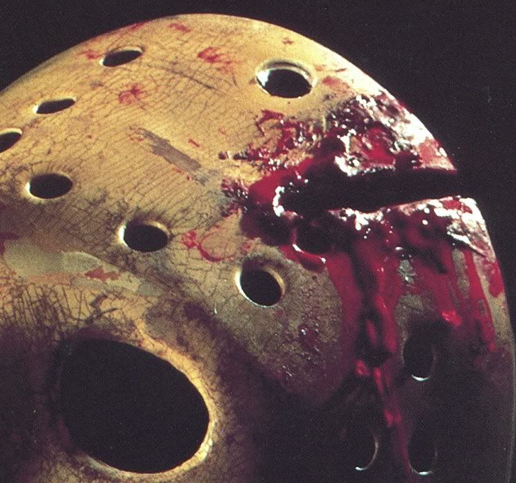

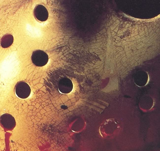

Anyone know how to get this kind of paint crackle effect?
fiberglassmasks
I have tried the store bought crackle medium and the elmers glue. Niether come close to this as it is a much finer crackle. Anyone know a way? I have been using enamel spray paint.
No guarantees, but I've gotten that effect unintentionally when I put on a lot of coats in quick succession, or thick coats. You could try temperature shocking it a bit too, but I'm not sure how much that would help.
Strangely a couple of years ago I was painting a predator model helmet and after i painted it with normal warhammer paints i spray painted it with a clear car lacquer and the paint went exactly like this
Im sorry i cant be any more help
you can try painting it with urethane paints first, and then paint over it with acrylic paints. the reaction will cause the paint to crack
That looks the effect that forgers use on fakes of famous paintings.
However they do it.
I'll bet it does have something to do with incompatible paint coats.
