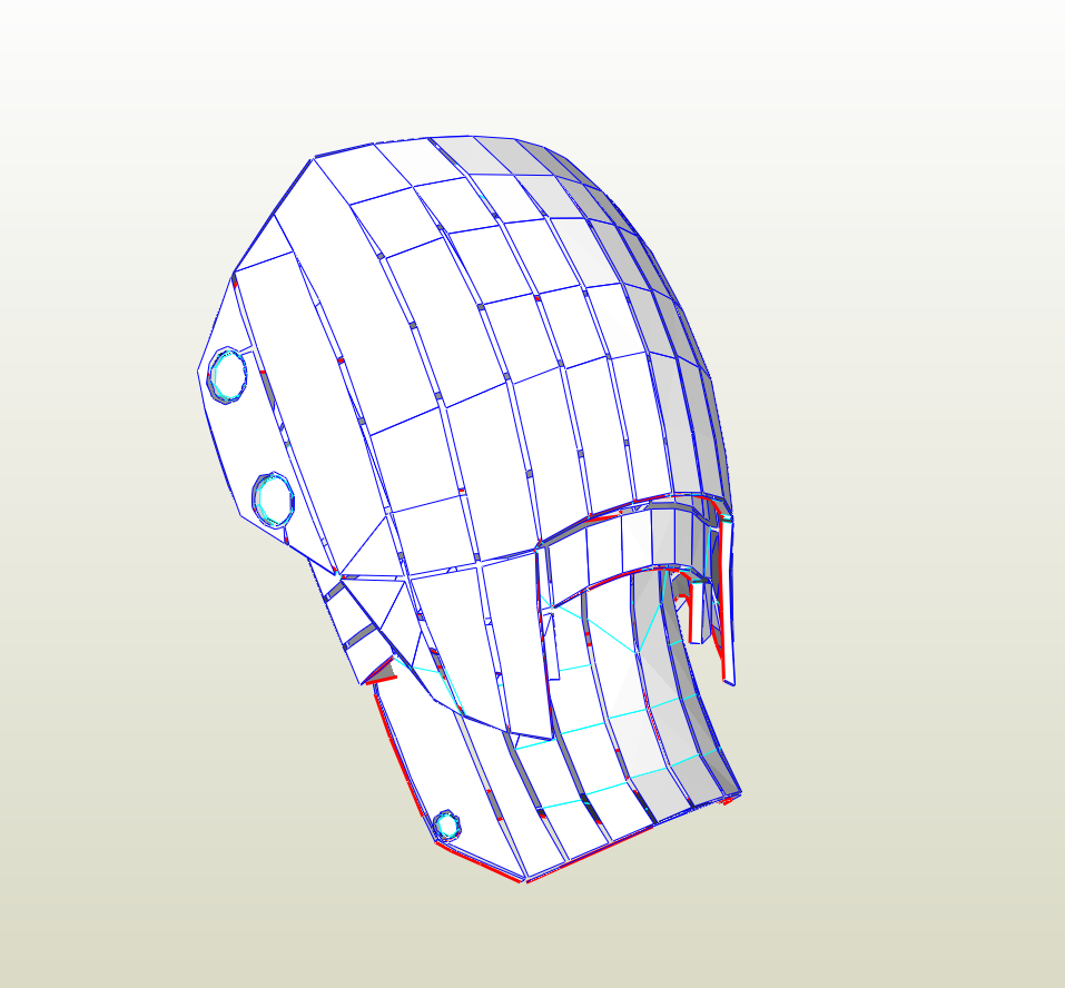

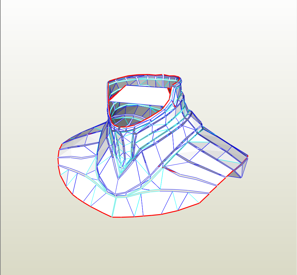

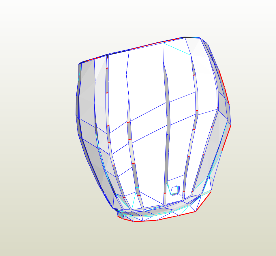

The Pep images are here: (I do have the actual files)
And here are the reference images:
