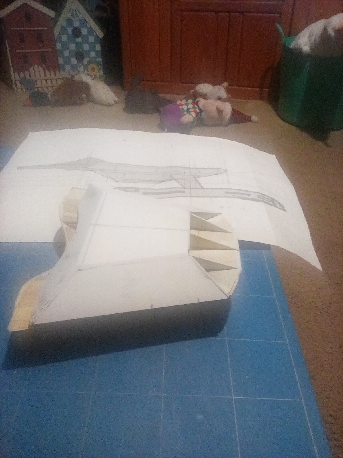

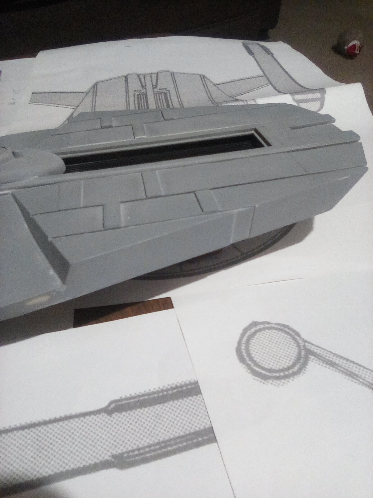

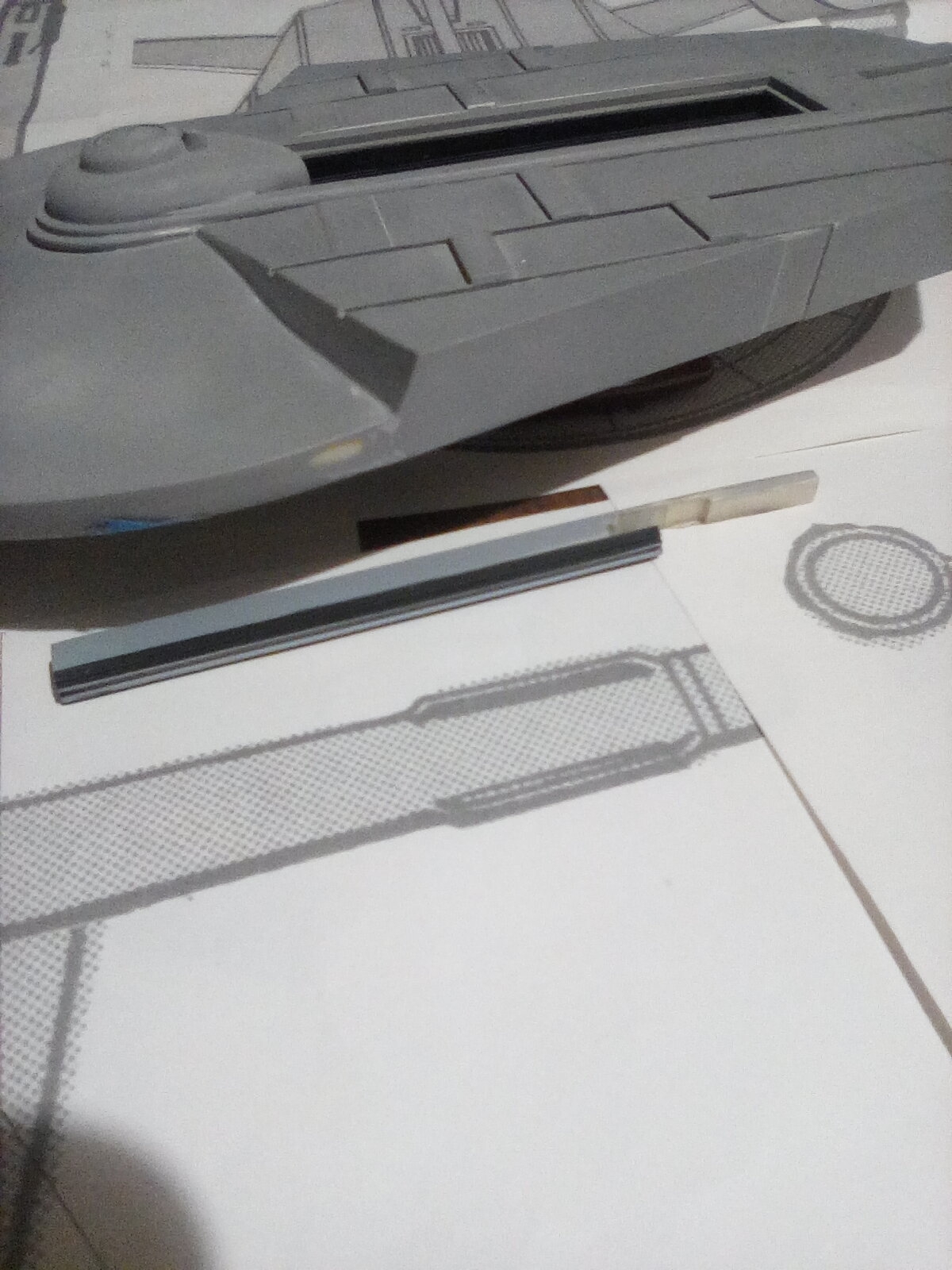

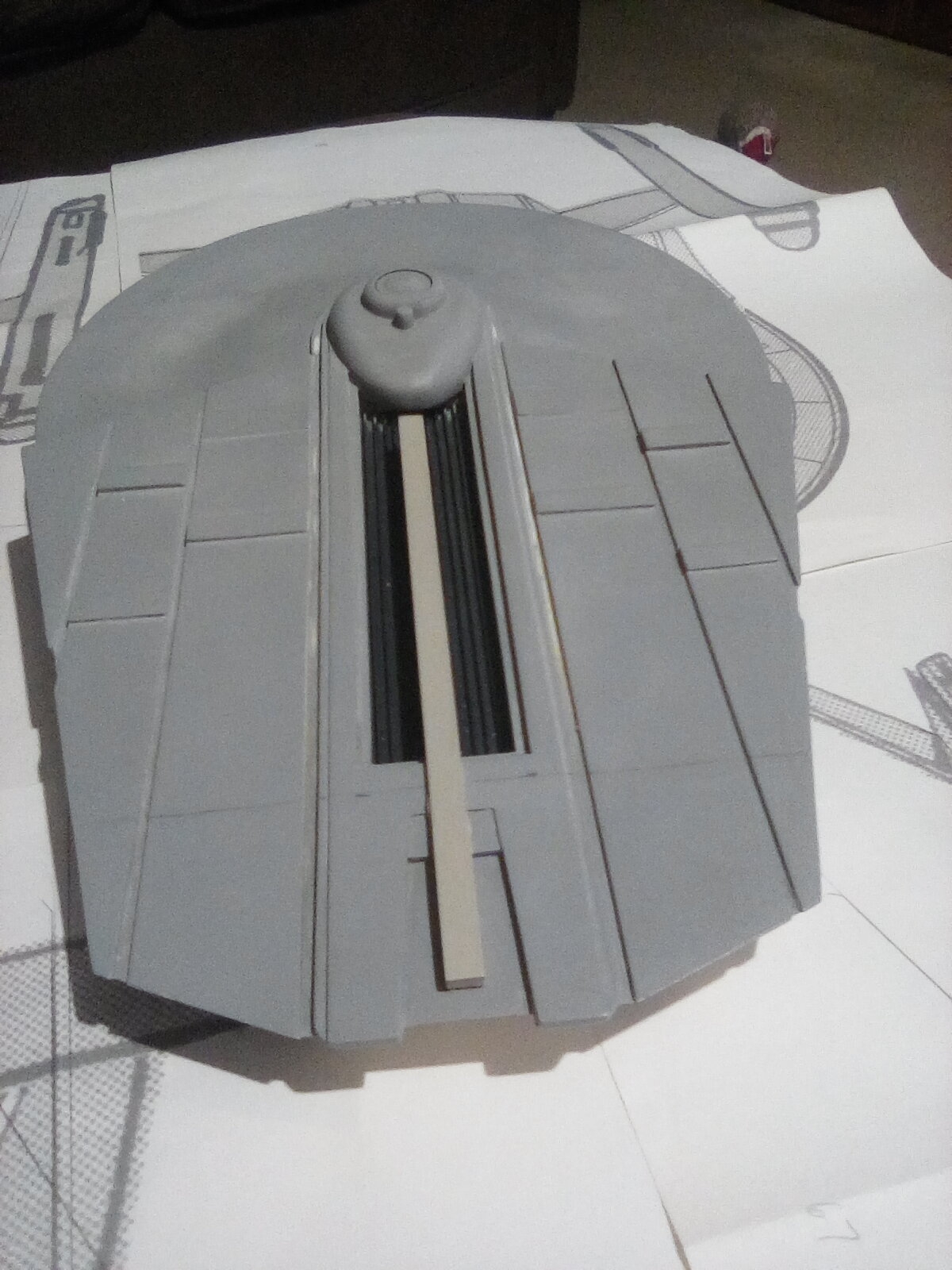

While attempting to clean out my studio...I ran across an old project I started....and aborted out of frustration.

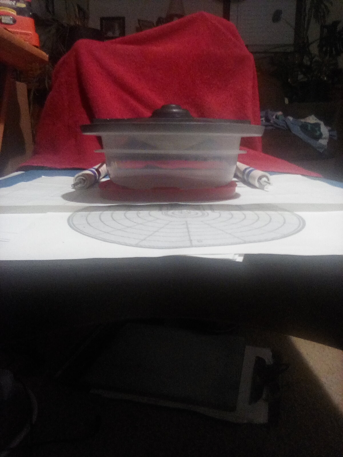

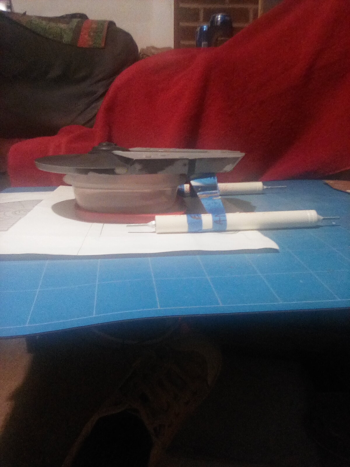

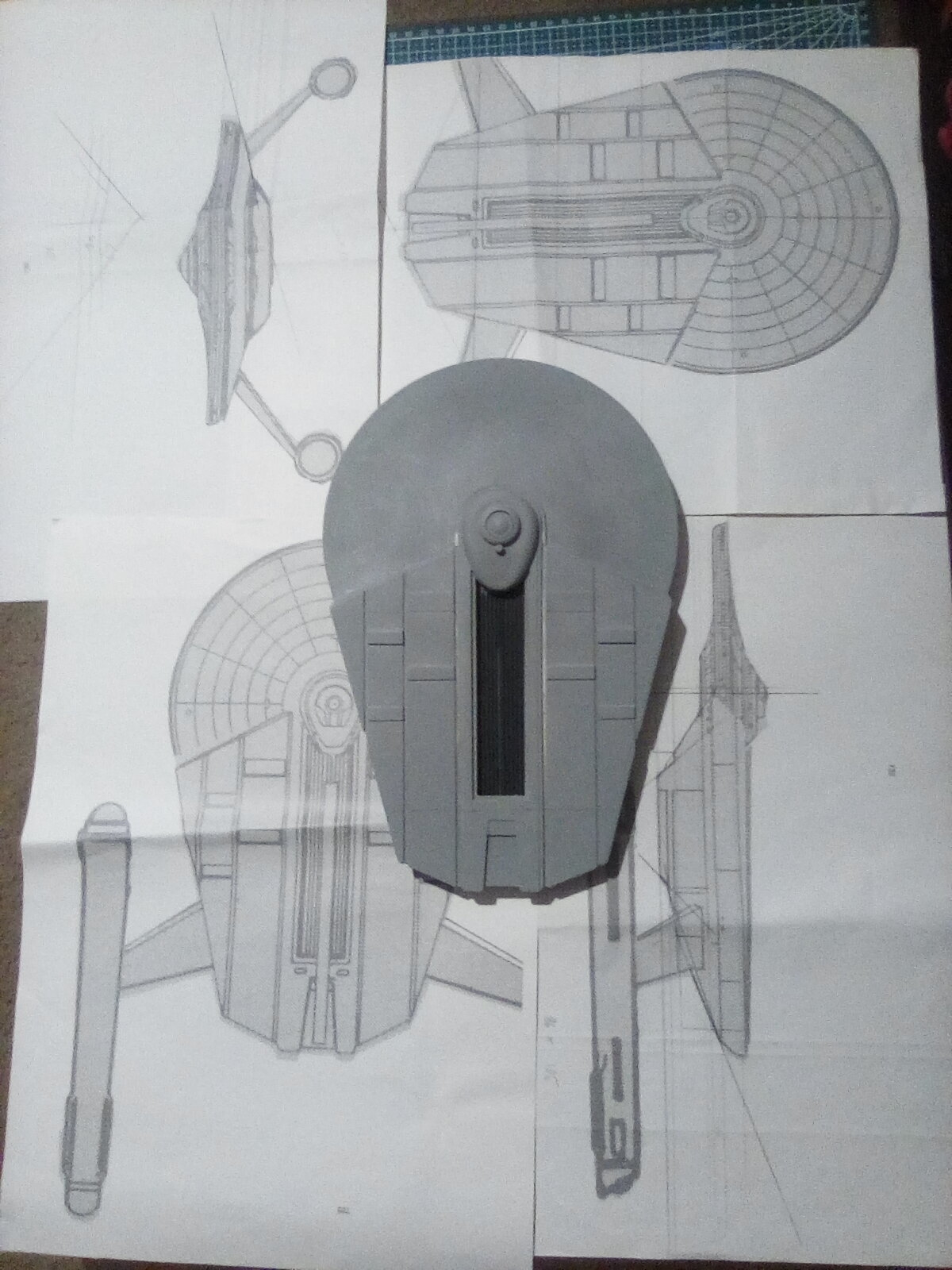

Images are expanded to scale to match AMT/Ertl Enterprise. The reason I stopped the project was frustration... The drawings don't match, pylon placement is too wide to fit (compare front view to top view) and lack of detail how all those angles work out on the underside.
Knowing that I couldn't count 100% on provided Trek Manual schematics, I developed the philosophy.... what did the Reliant do. While I was happy with the results I achieved on the upper section...modification being I ran the upper rear deck horizontal instead of angled down...

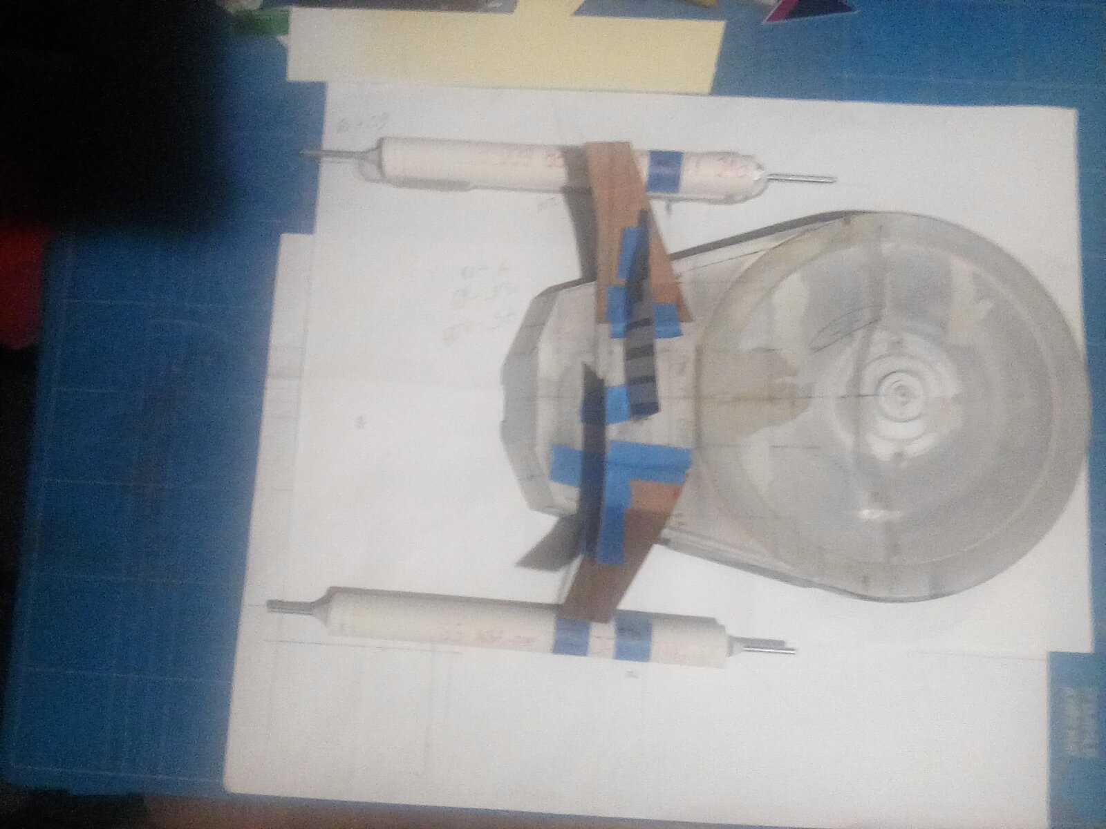

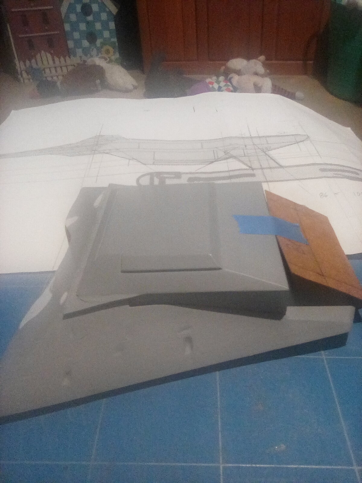

When it comes to my attempt at the underside....it didn't really work. While I liked the square major drop down section... it just created problems with how it affected the angles on the side and in the rear.
Note how rear angles look awkward... there's no way to cover the gap on the two slightly angled side portions of the top section (think landing bay one and two from Reliant).....and in the side view provided, there's not even an indication they exist. In addition, the initial attempt was based more on the schematic dimensions....and not on what works real world. The length of the underside details extends beyond the real world tangent/cord relationship.....meaning the part I made would have to be rounded at the front edge where it meets the saucer or it would just stick out. Either way...what I made just didn't work for me.

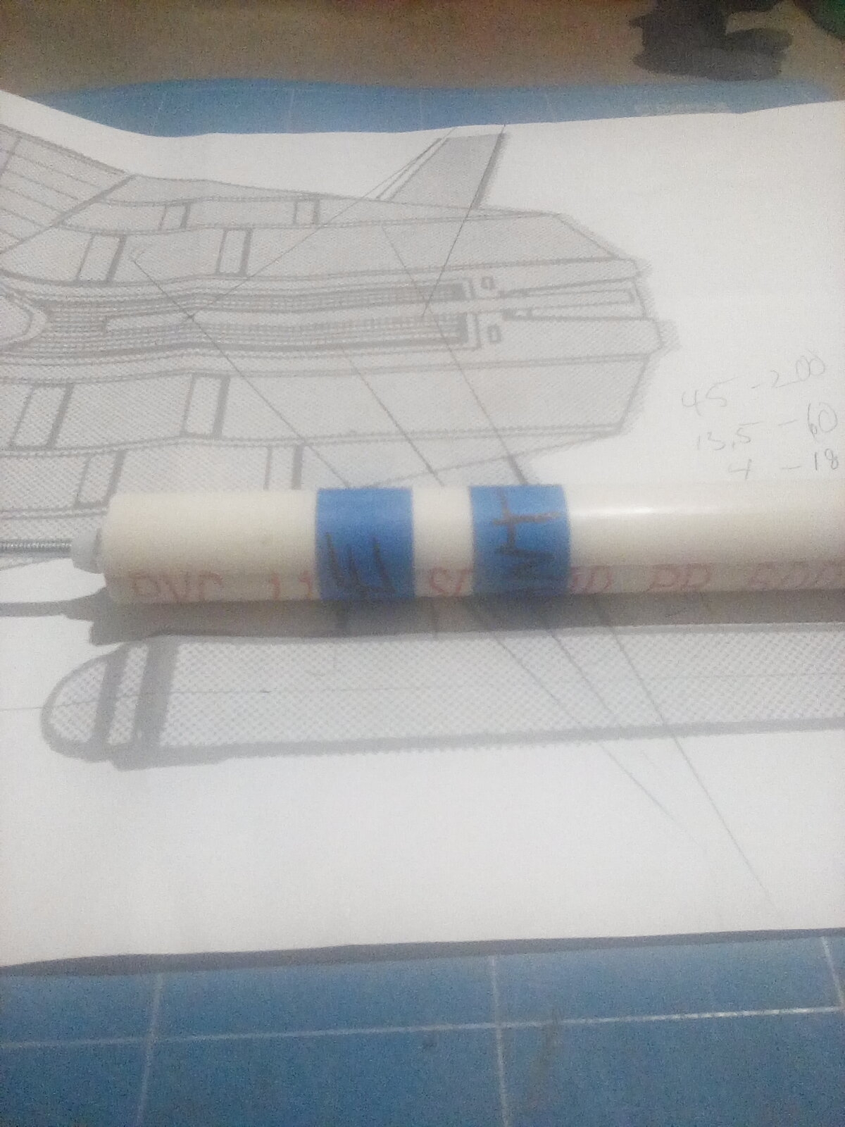

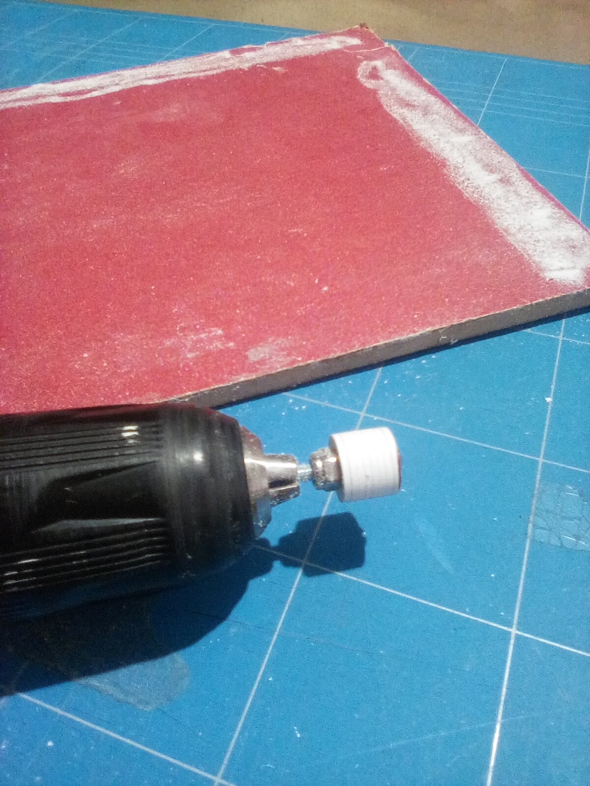

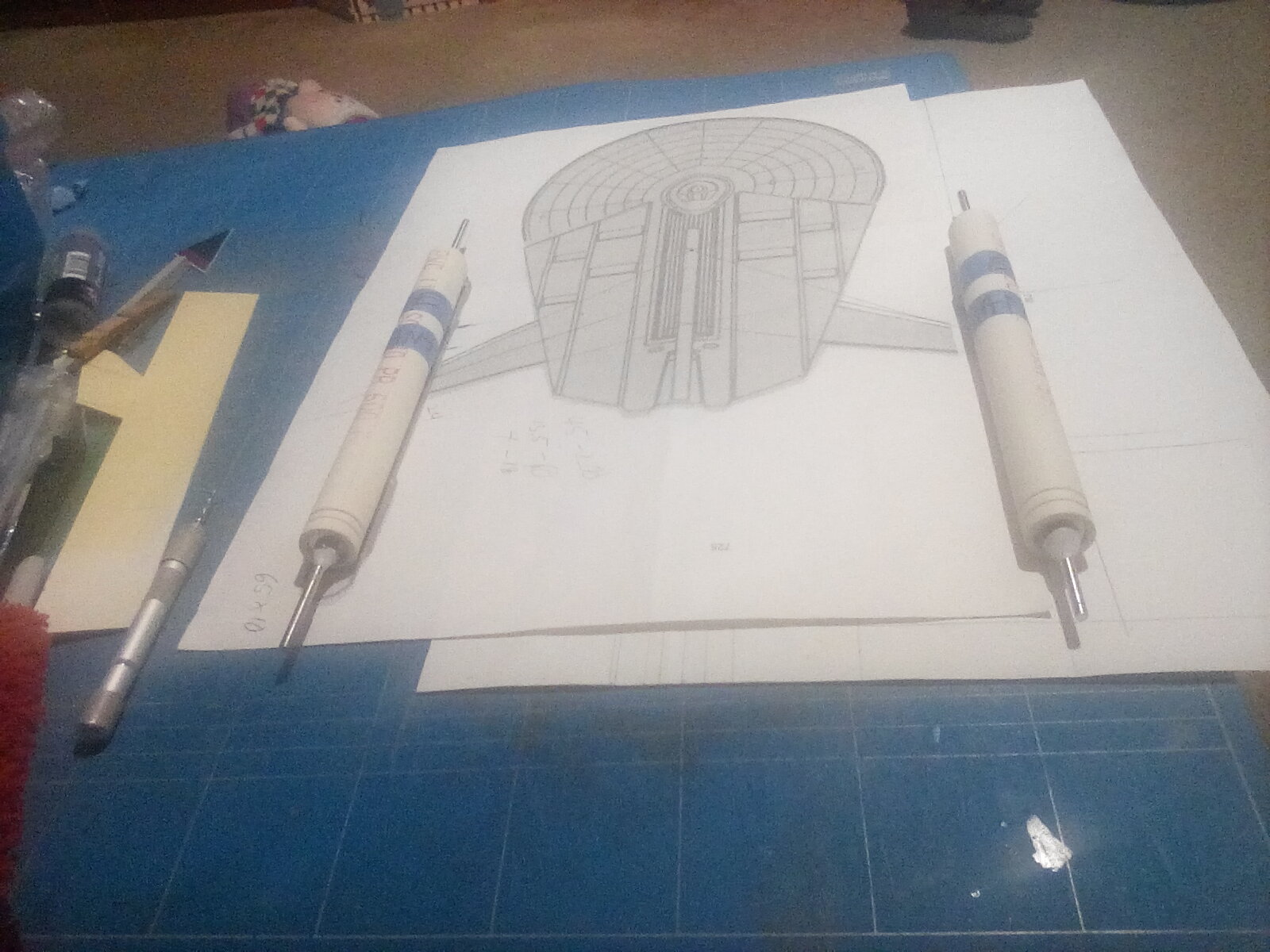

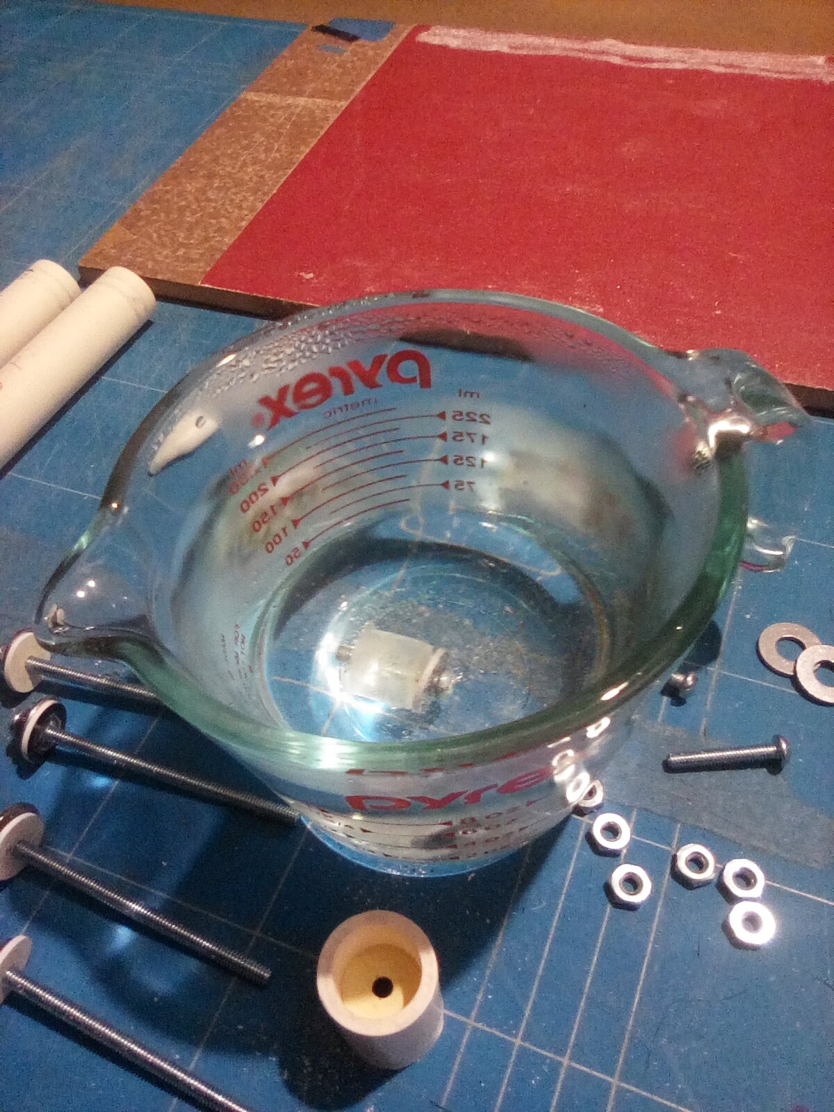

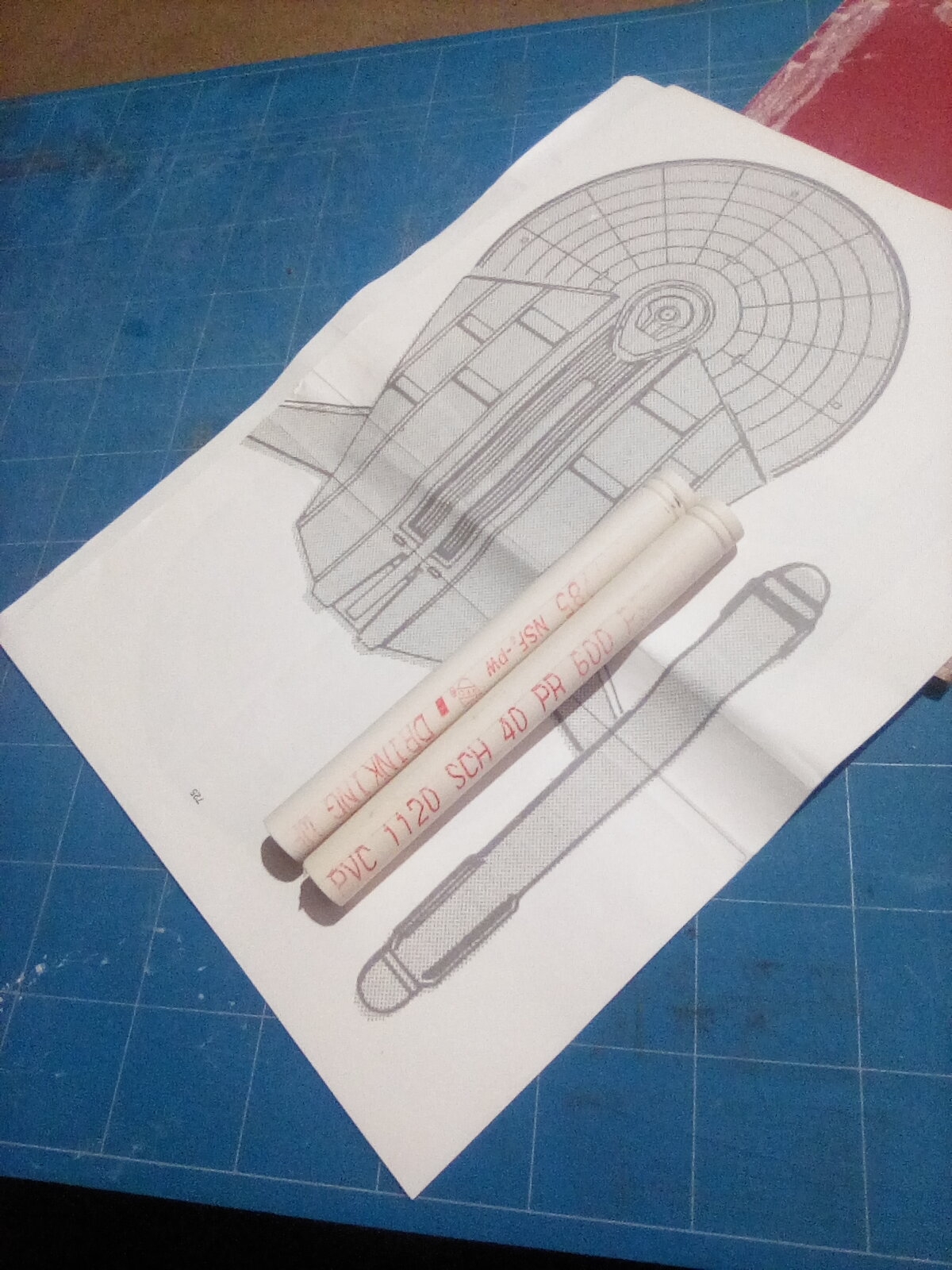

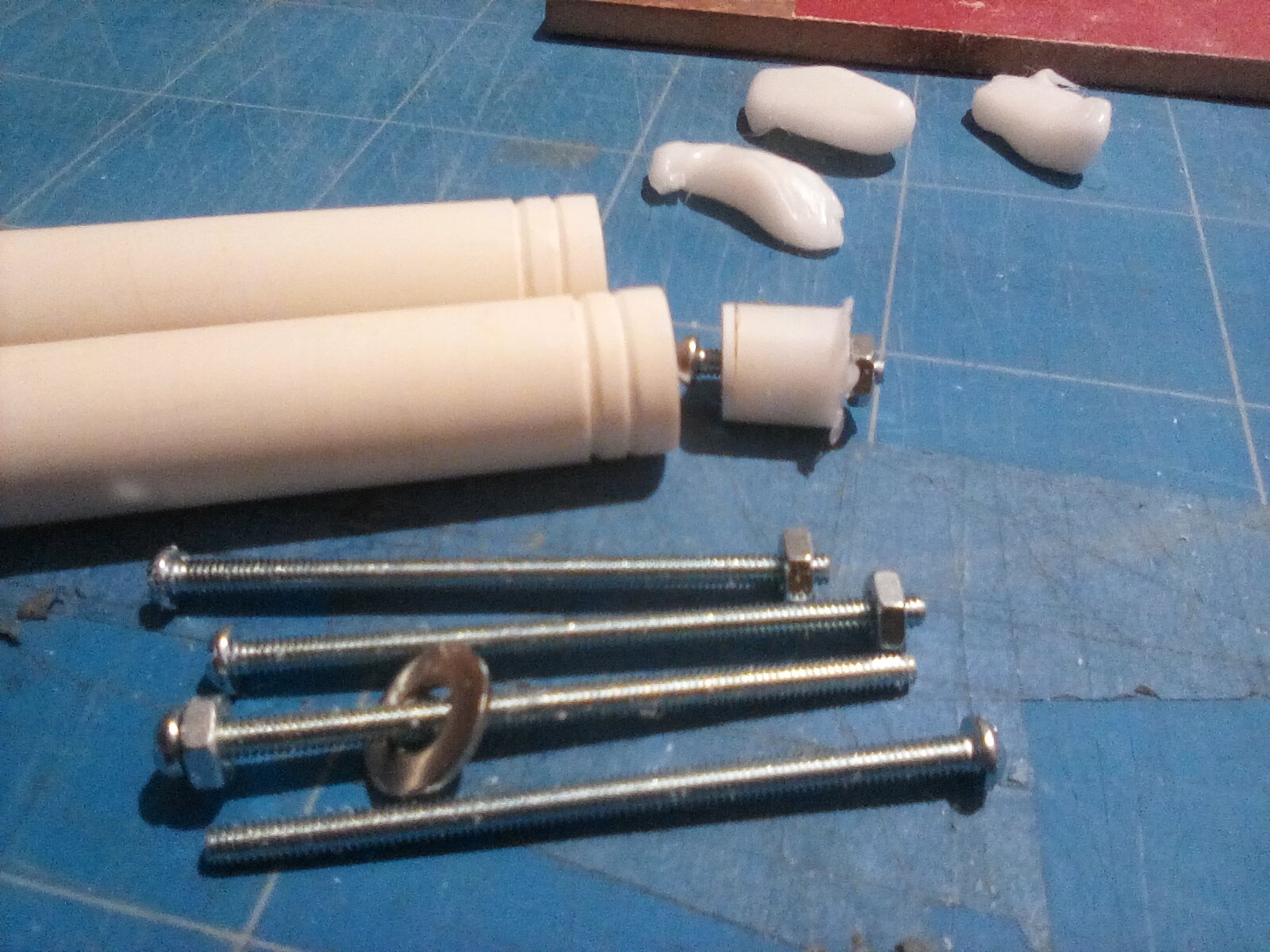

I'd like to have some input....or suggestions... on other ways to resolve this. Maybe there's something I haven't thought of. Additionally, another issues is somehow the nacelles got separated from the kit parts. I lucked out that a PVC pipe matched (within microns) the widest portion I needed. To tamper it down....break out the red neck lathe!
I was able to center bolts inside the pipe by using thermoplastic pellets....cool little beads you submerge in hot water...when they turn clear, you can mold them to TBE shape you want. Too bad that, when they harden, you really can't want or machine them. They do hold the final shape well and secured the bolt as CENTER as as could tabletop get it. Bonus....when you're done...just melt in boiling water again...and reclaim the plastic to use later. Pretty cool stuff!
