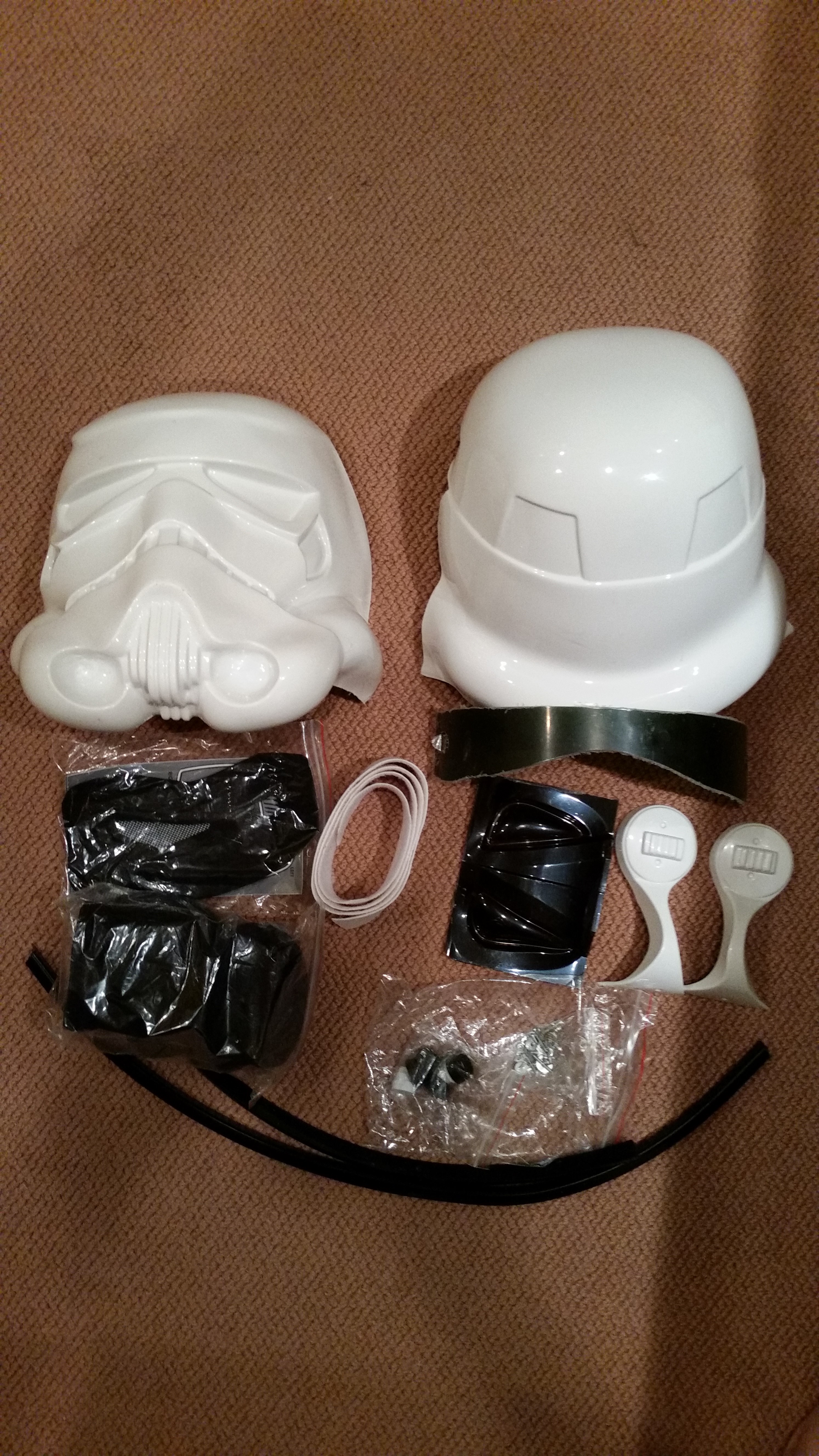

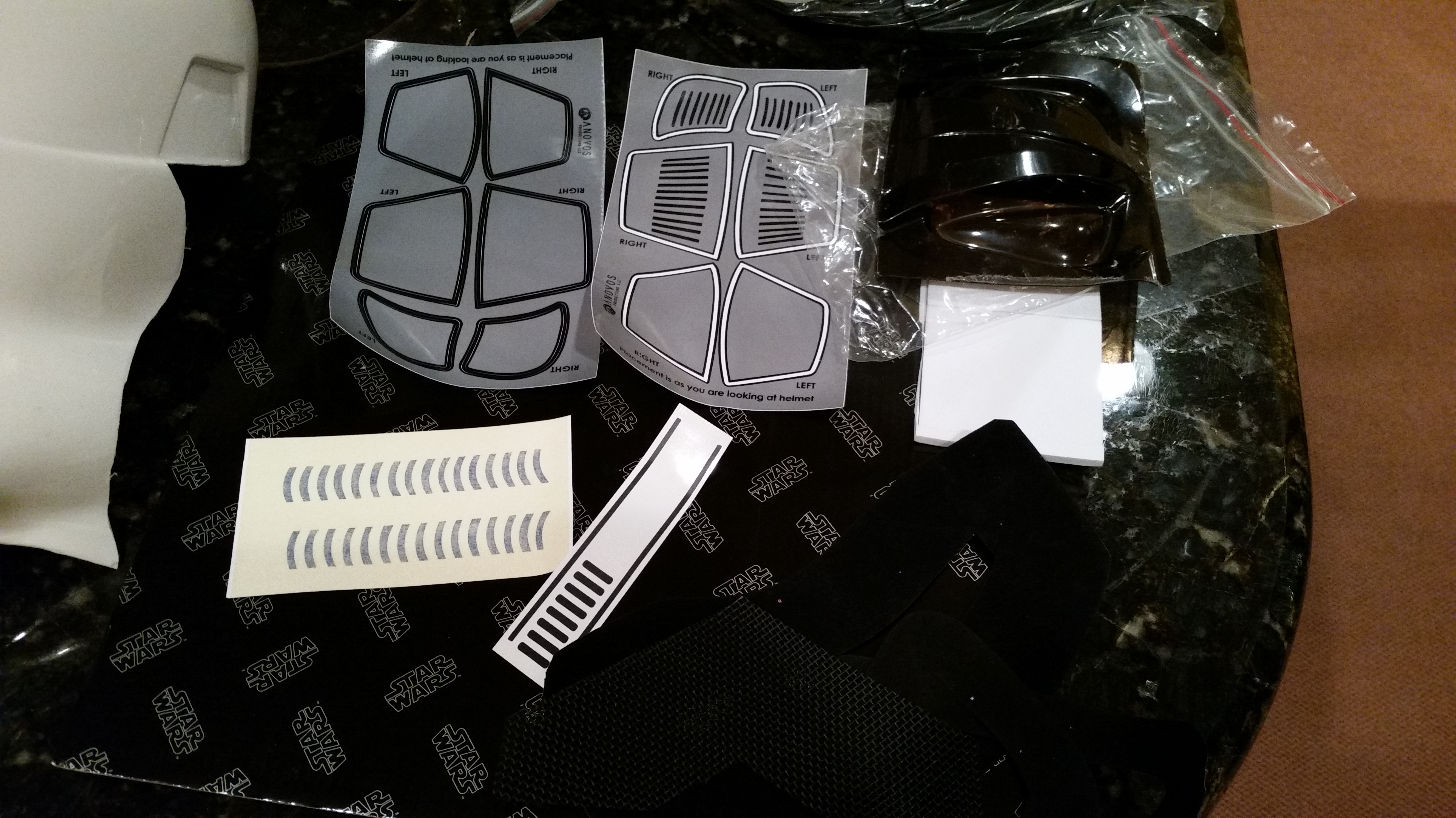

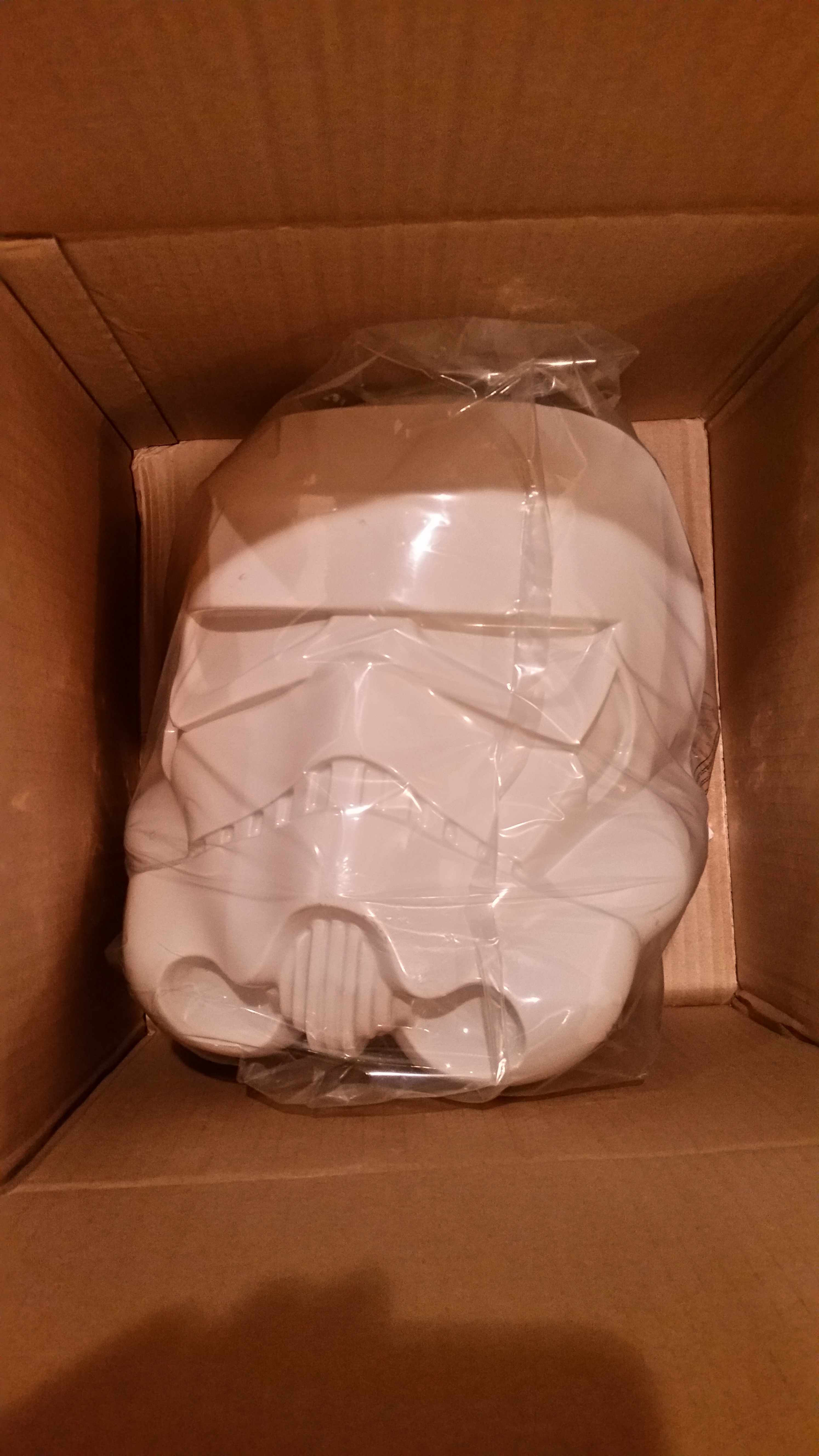

Well after a long wait it has finally arrived. As you can see everything is in one plastic bag with a few of the smaller items in their own bag. Face and dome have a protective film on them. Decals for both regular trooper or sandtrooper versions, ESB version would have been nice but is not included.
