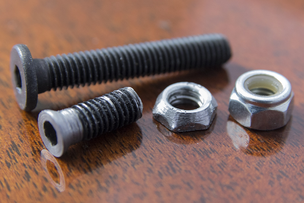

The screwing in from both sides on a 4-layer frame is obviously somewhat of a problem. Up top it's ok because the trigger screws are singular, and the safety mechanism is a core, but near the bottom of the grip, there's nothing holding it together. So I used an OpenBuilds screw and an M5 locknut to make these ultra-low profile 60 degree taper fasteners that'll lock the grip end of the frame together, hidden under the grips themselves (in that big center hole you see in earlier pics, just chamfered with a center drill).

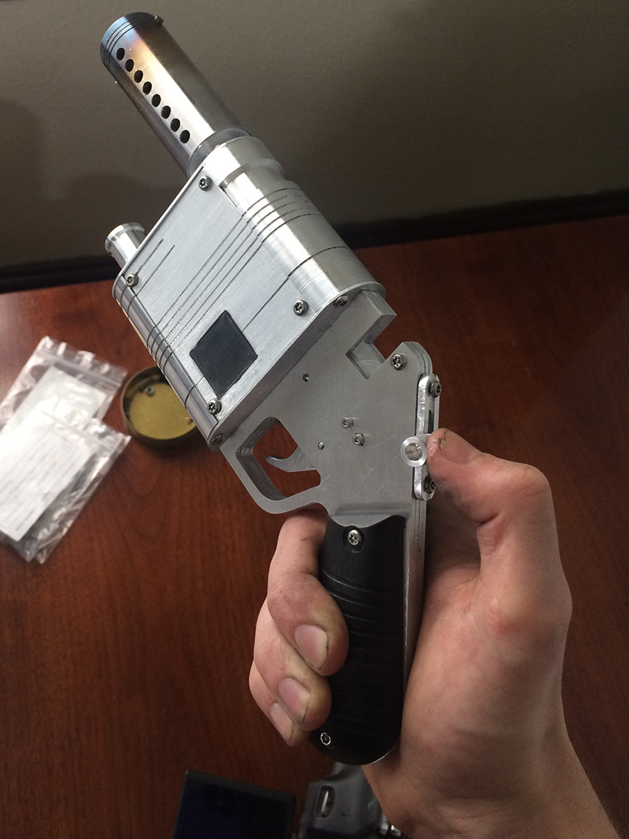

Boom:
20170124_194745929_iOS.jpg 20170124_194904022_iOS.jpg 20170124_194945040_iOS.jpg
Just quickly taken at my desk here after assembly. I'll be disassembling it again for an intro/demo/assembly video anyway, and of course beauty shots will ensue, so there'll be higher quality images to come.
But for now, that's the lot!

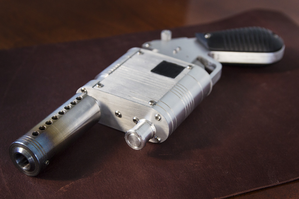

Very well done and mod interesting to see how it was done.
(well lit, in-focus photography was key)

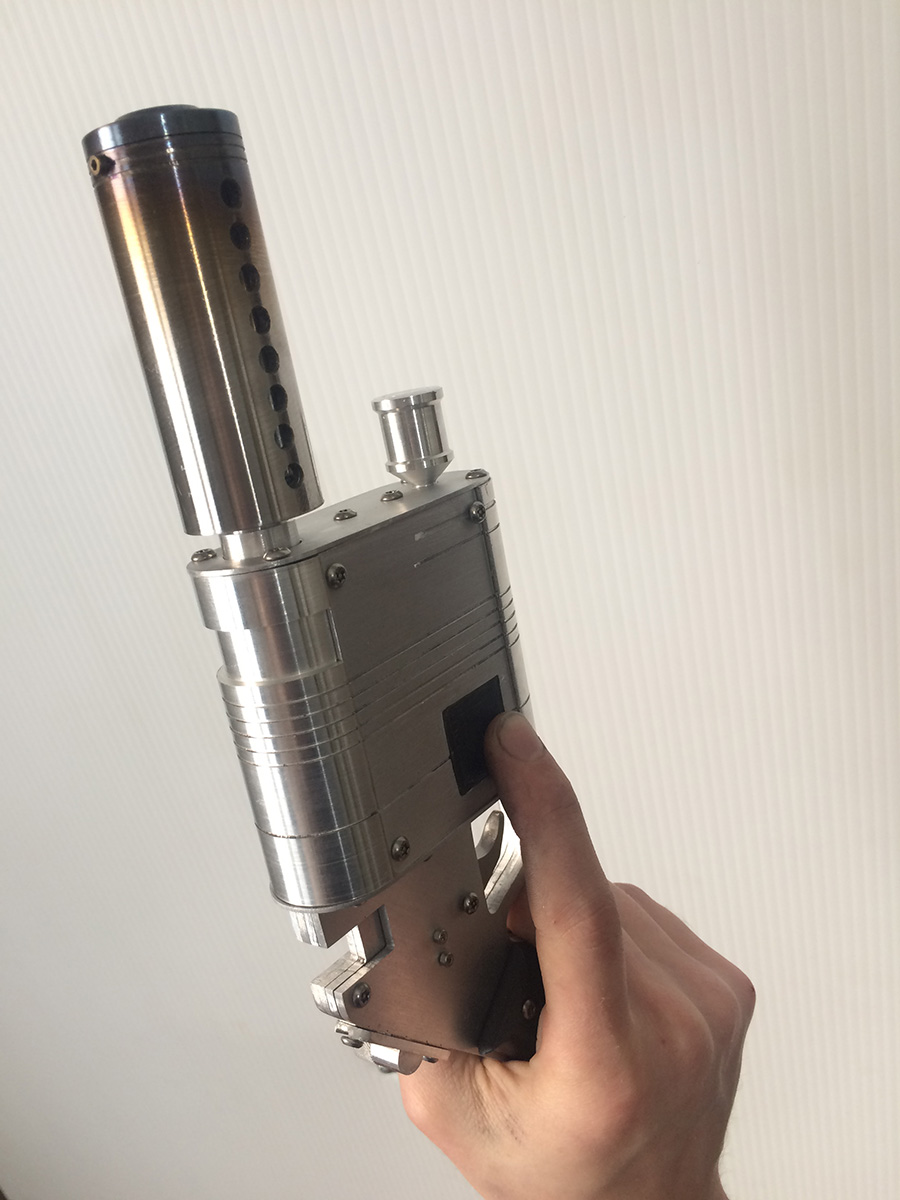

Super job wow , it's going to have sound (special-effects ) !!!
Well, this one probably won't, but the way I constructed it, v.2 certainly could. More than enough room for some microswitches, LEDs, an Arduino Pro Micro or similar board, and a good-size (maybe 50mm?) speaker driver, if a spot for an 18650 can be found somewhere.
Stunning job!
How did you do those beautiful burn marks on the barrel end?
Good question, thought I'd already answered this! Well, right there is the reason I made the barrel from stainless instead of aluminum, because you can't do this with aluminum:
MAP-Pro (fake MAPP) makes real short work of it, you've just gotta watch your colours carefully and then allow it to equilibrate some after soaking, because the heat will continue travelling after you cut the gas. Fortunately stainless is a horrible thermal conductor, so you have plenty of reaction time to look and get ready to quench. Notice from the final layout pics that the base of the tip insert is still gold.
