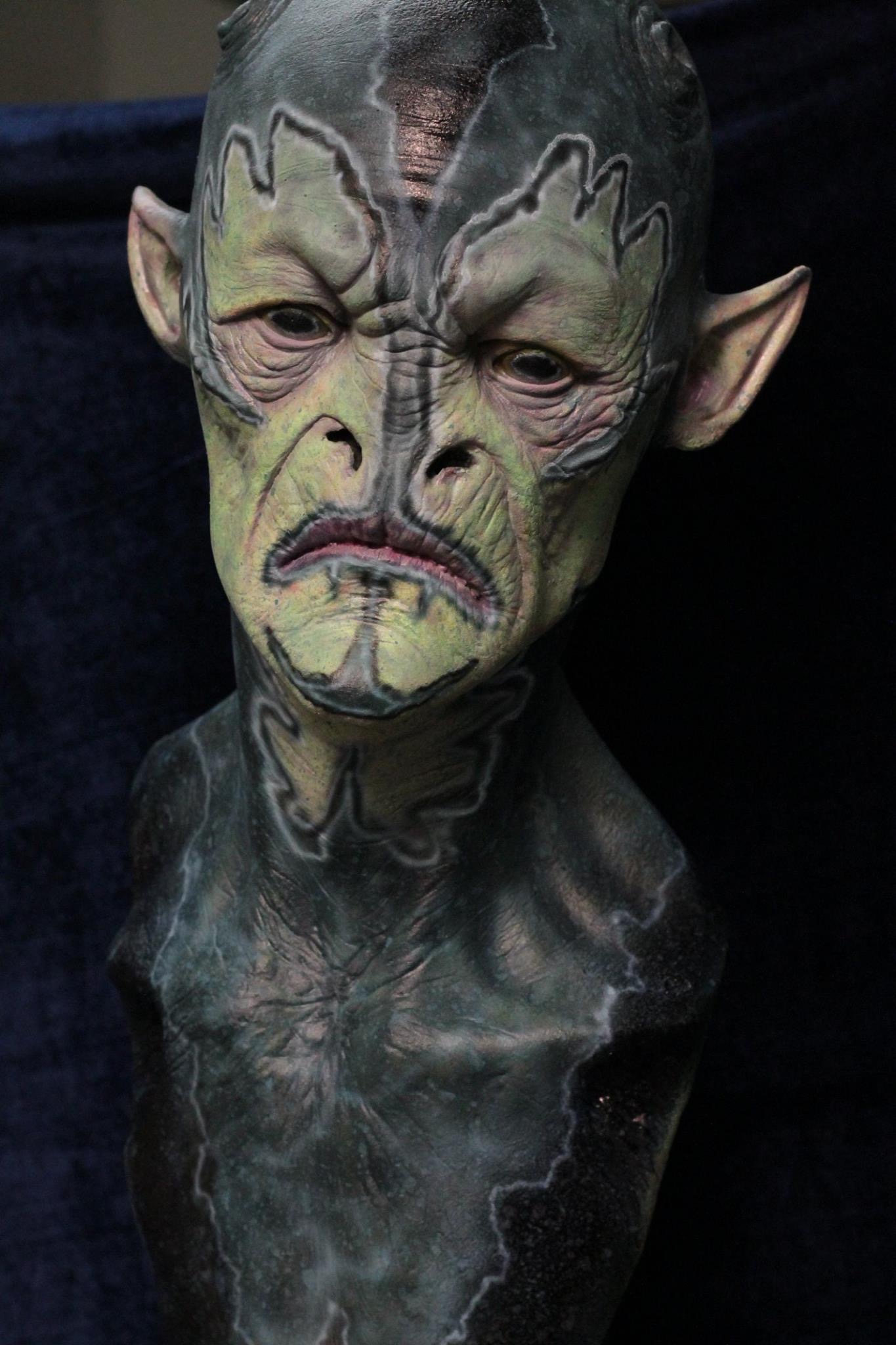

This is when the experimentation and mistakes happened.. I tried to do a pattern with a darker green -- Webbing that slowly shifted towards the front of the head. Well, I wasn't too happy with that so I tried to go over it a bit with an even darker green. No dice.. tried to lighten it back up and do spots. Even worse. Eventually, I ended up just blacking out the areas.. or blueing out more accurately, and then doing a black pattern with white highlighting over that.
This is where it was after that whole menagerie of errors. It basically looks like he is wearing a cowl or swim cap. Completely unnatural and just plain weird.

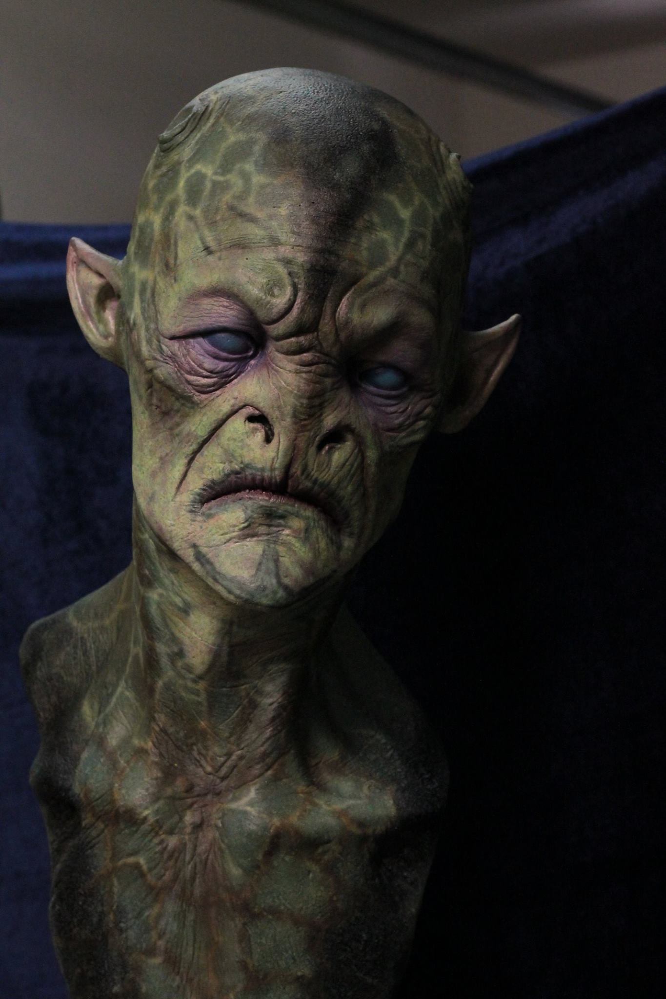

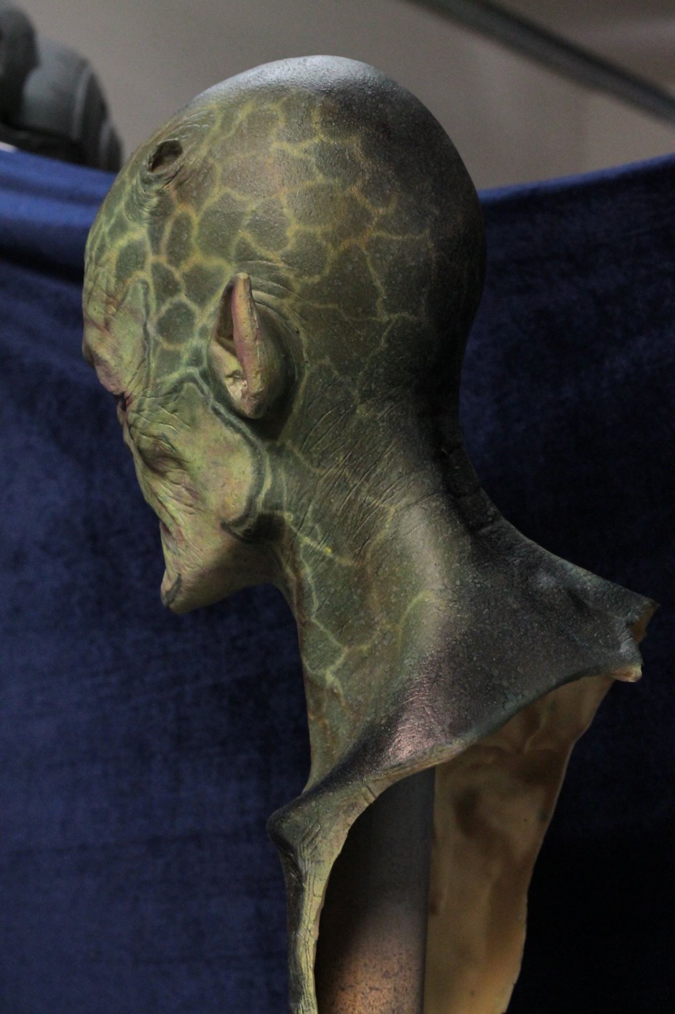

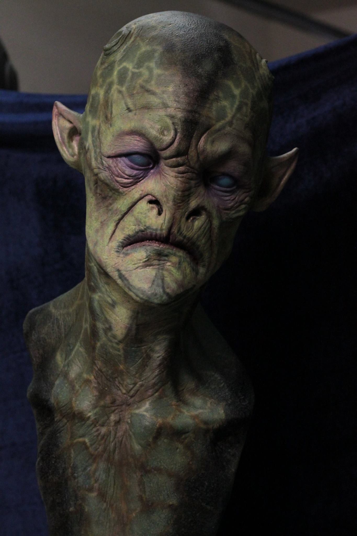

I ended up taking a white and doing the webbing I was going for initially over the blue areas. I then tinted the whole blue area and face with a green, and went over the back of the head with a brownish green. Did some more work on the face and tried to tie everything more together to feel a bit more natural...
Here it is after the updates
I still need to gloss the eyes and make some horns but I'm very happy with it now. I think if I were to completely repaint the piece I could improve in a lot of areas, but I'm not altogether unpleased with the results.
A quick before and after. Really a huge difference.

I agree, looks awesome. Only thing id add, and you may have already done so, is epoxy on the eyes and maybe a little in the mouth. Well done
Great work as usual, I dont know how I didnt pick up on this thread sooner. So aside from the PAX, what other paint did you use? I cant believe thats a latex mask. Looks awesome.
ChuckyAPP, thank you! I havent actually glossed them yet. I was packing up for a move while I did this and I already packed up my epoxy! I'll have to make horns and gloss the eyes down the road.
