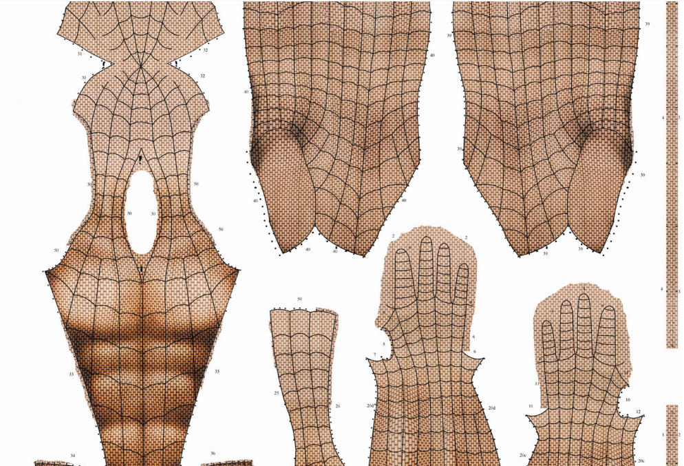

Amazing Spider-man 2 pattern
Thanks again for the print! Fast service, I got it less than 1 hour later!!! I'll post pictures once the suit is printed and sewn.
Dude awesome job bro! Question for u. Can/will u separate the red portion of the pattern from the blue portion? The reason being is I want to print them on red and blue Lycra. Thx bro.

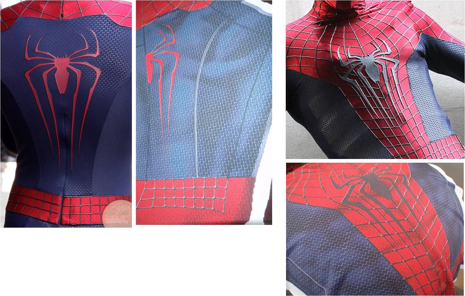

nick have right...for example this is the color used if you want print on the red lycra.
I just have finished printing the file.
Here's the comparison with reference picture.
It look great.
I took the back with flash, so it was too bright
Thank you Orhadar!!!
