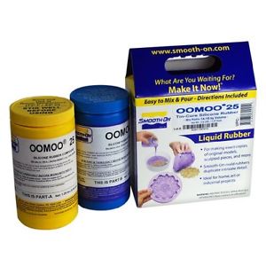

look into silicone called "smooth-on oomoo 30" it will be way easier for you to use.
you mix 2 parts together equally instead of the kind you're looking at where you have to use a scale.
welcome to the site!
I live in the UK and its very hard to get smooth-on products here. that's why I wondered if from the links above they would be a good alternative?
you should be fine....most all resins are ok to mold in silicone.
just make sure the thing you are making the mold of doesn't have sulfur in it....silicone won't cure right if it's used on something with sulfur in it!
