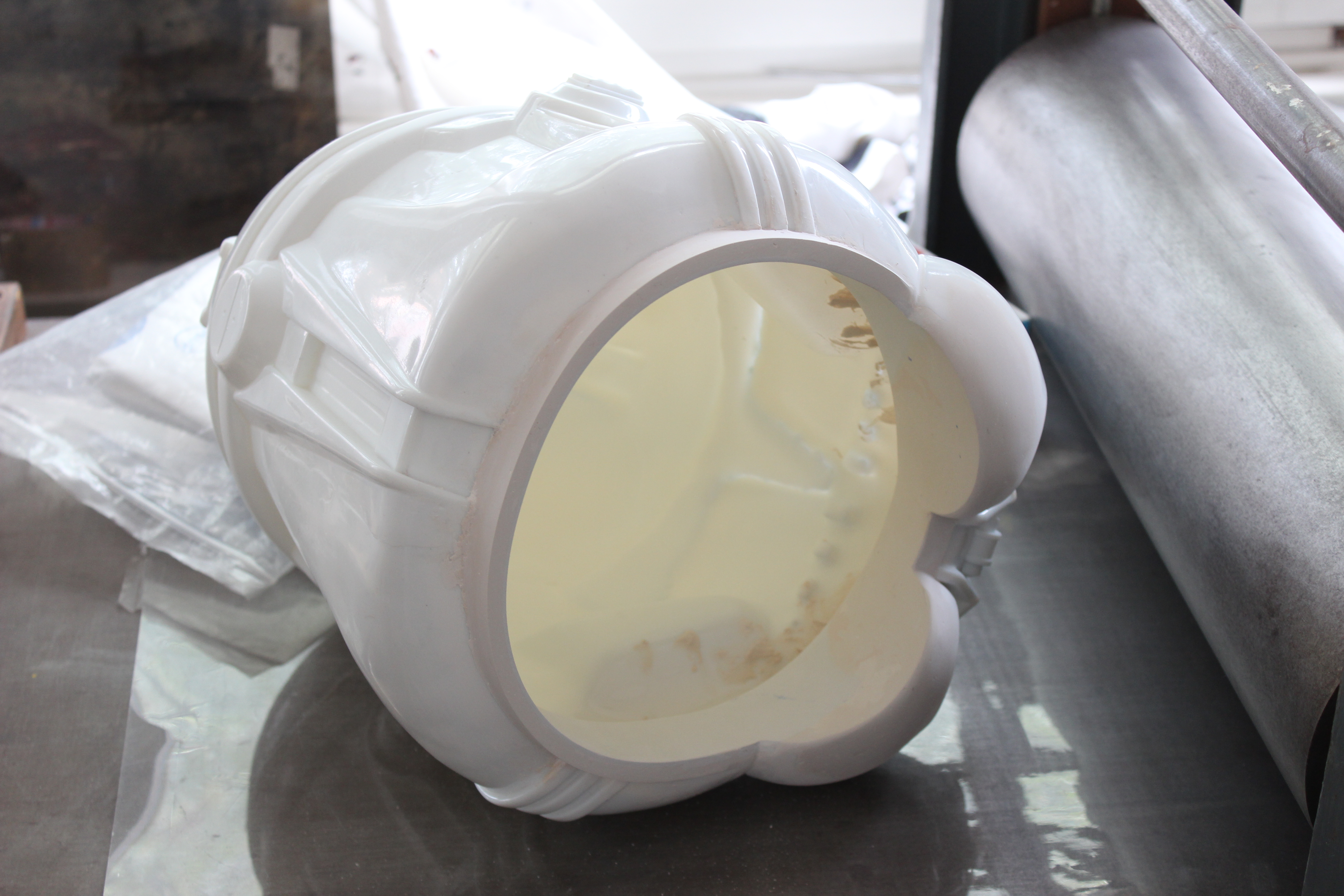

First: bought me an clone helmet on ebay, modified it with an neckring and cleaned/ filled/ sanded it to be my model for a silicone form.

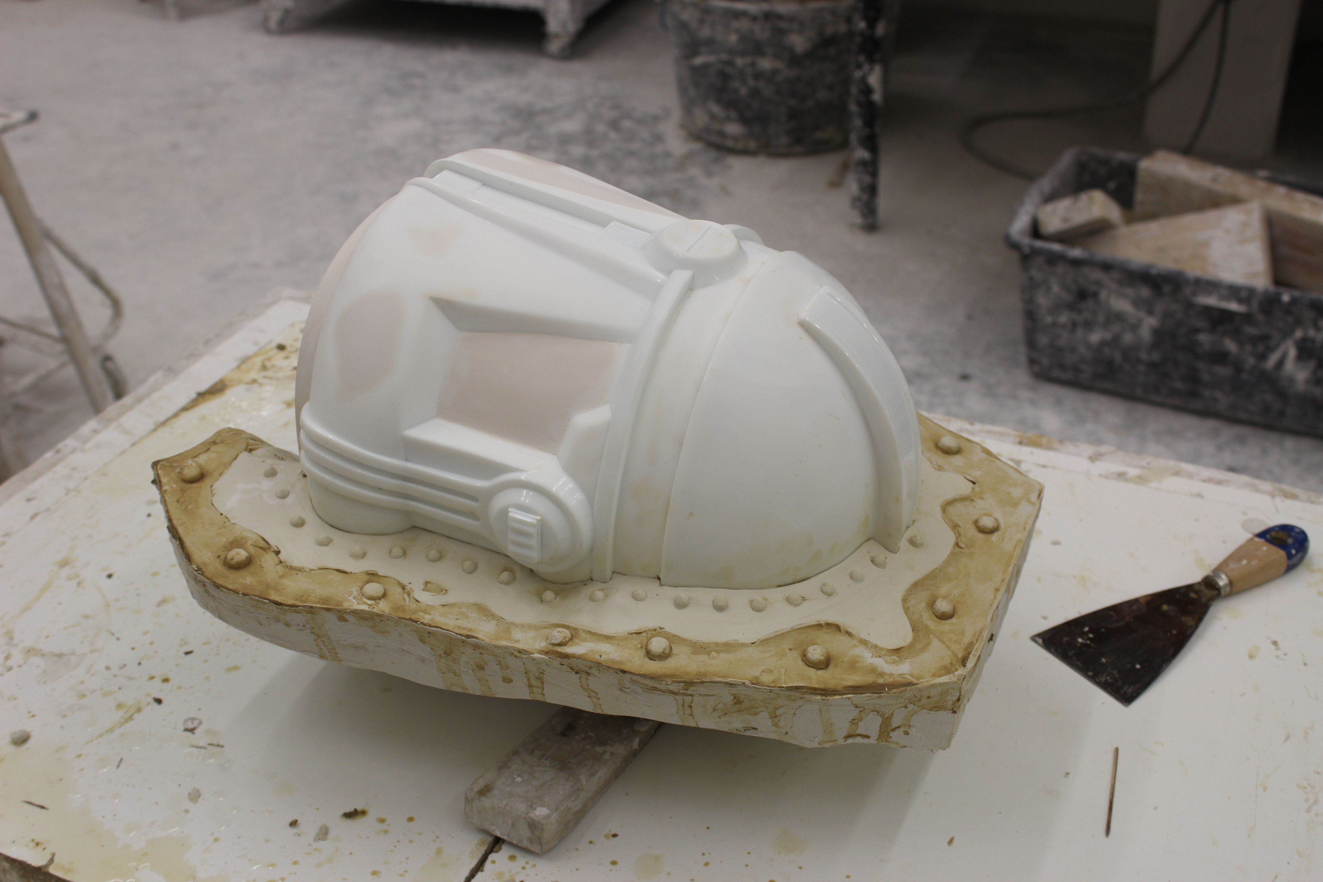

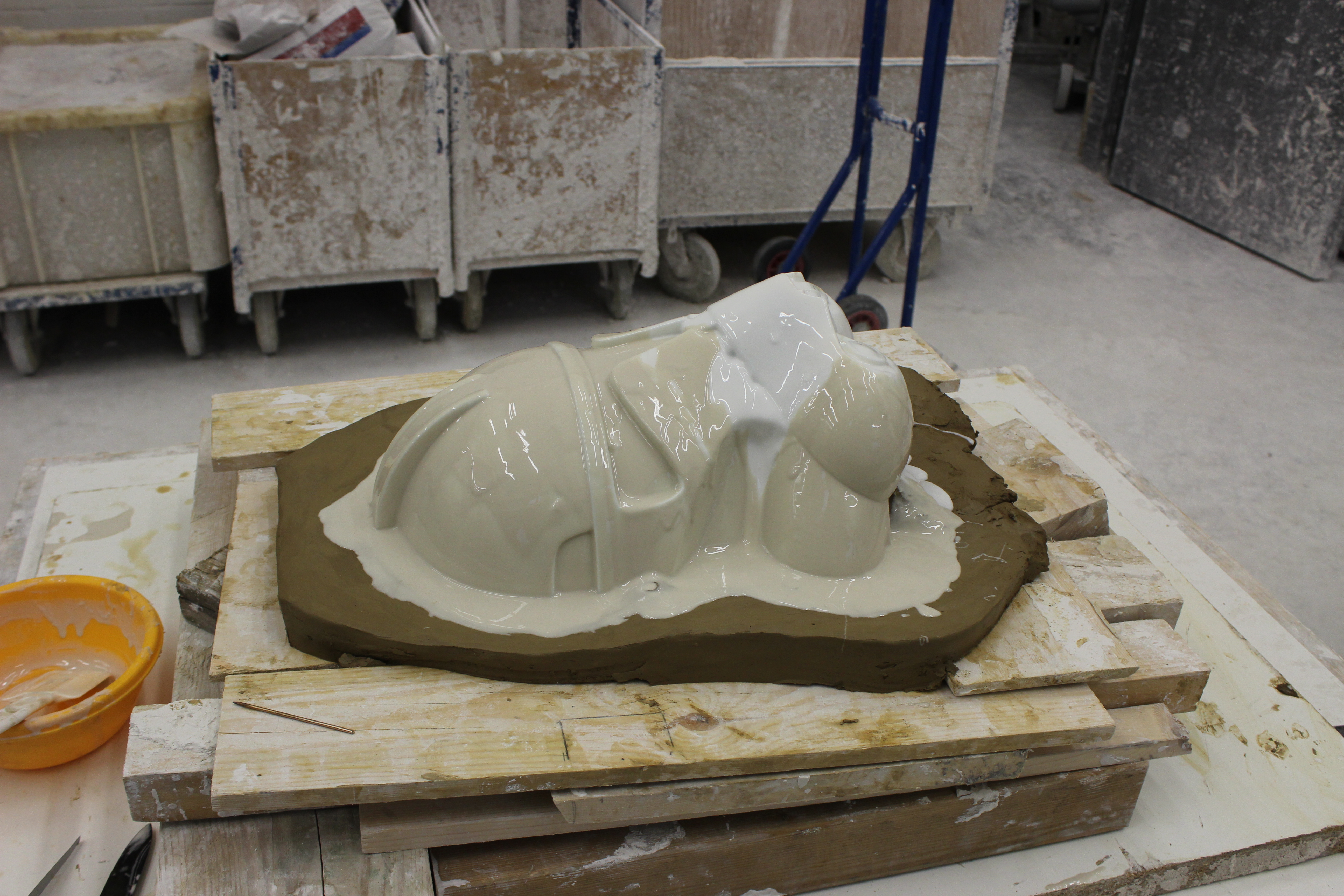

than, as i said, I've done a silicone form

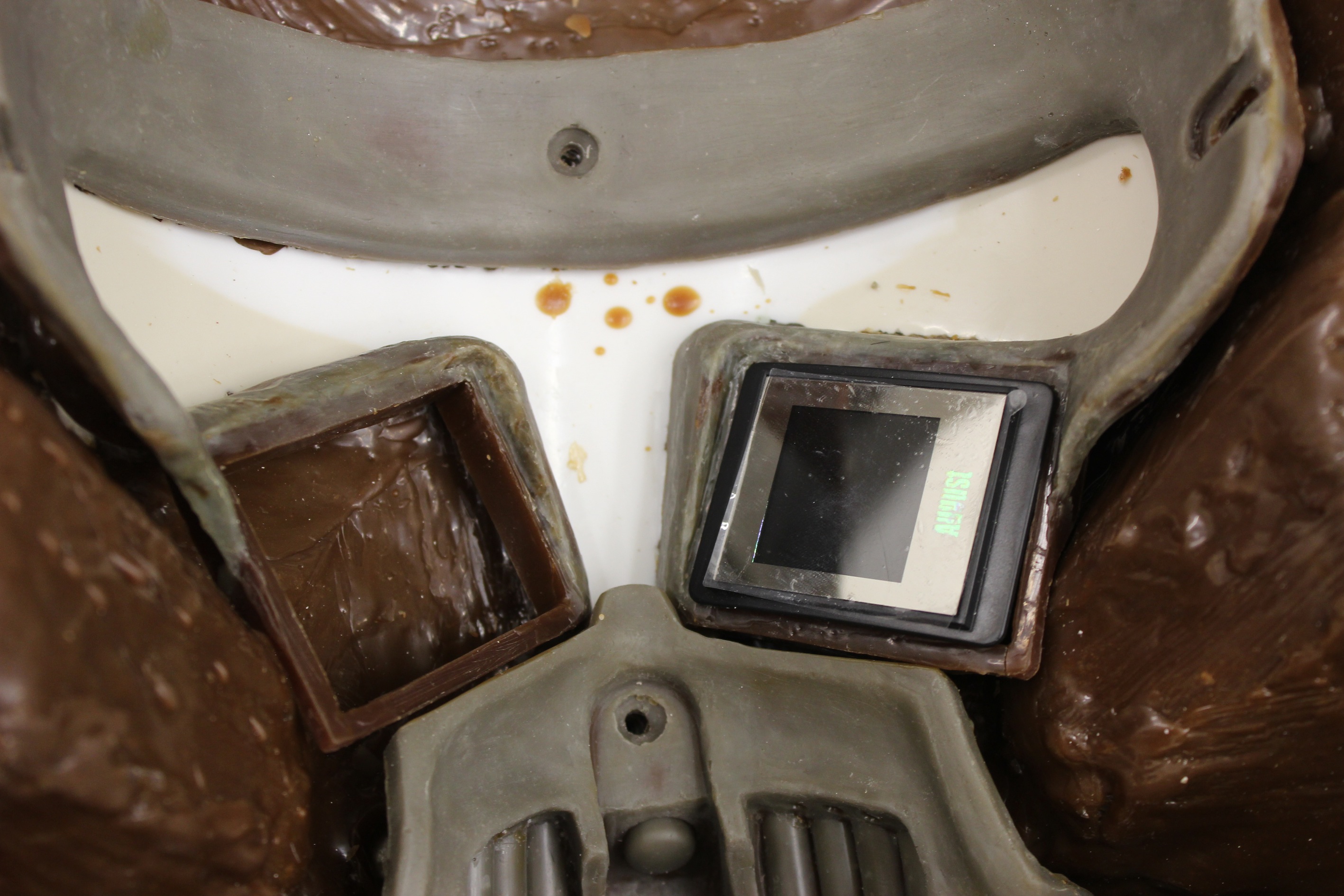

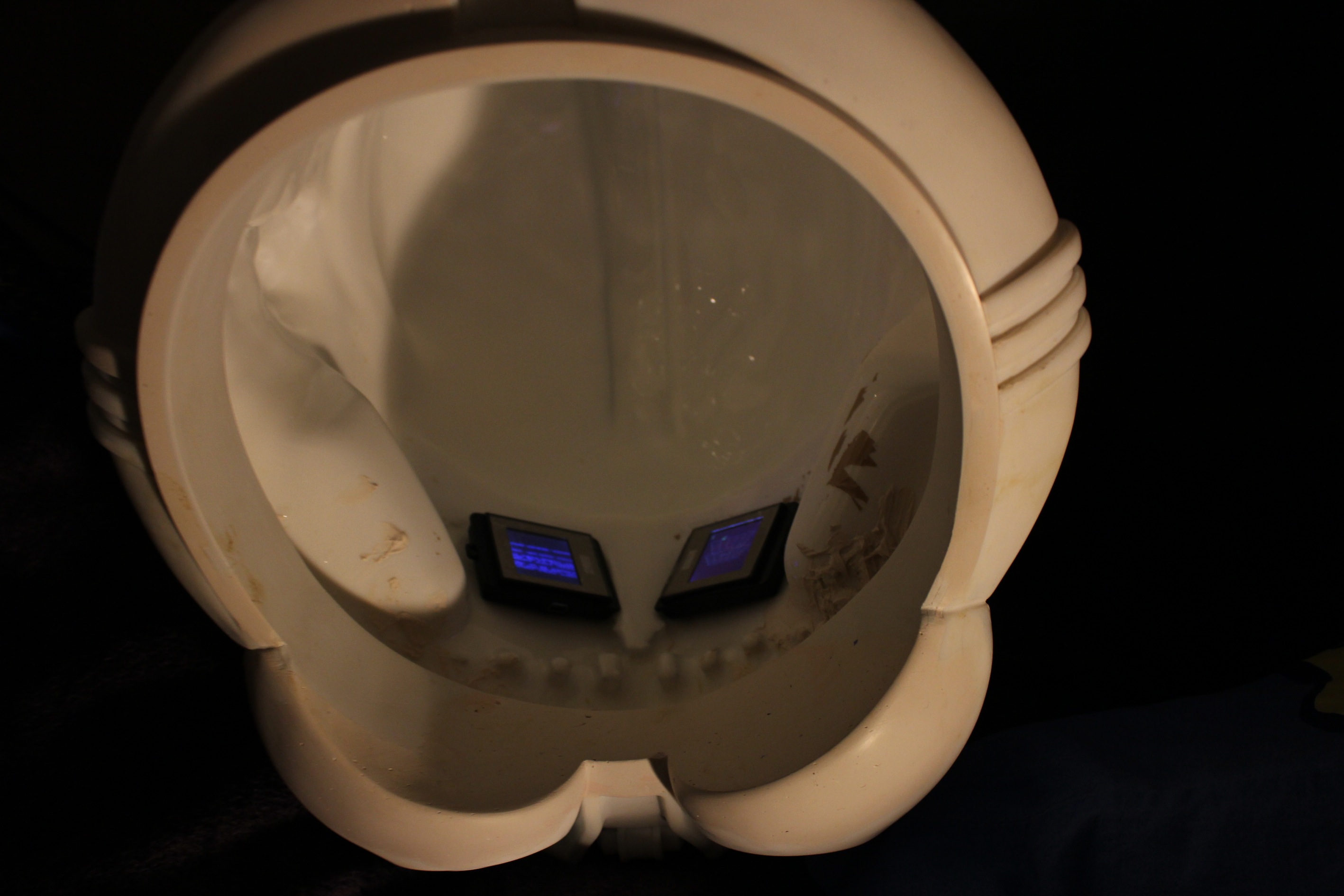

so far so good, i guess some of you already know well about negative forms. so the next steps will lead to the metal cast. but before i had to make models for the helmet interior, because i don't want to just cast its in aluminum, but give it a complete interior to screw in, also with some technical equipment in it. in fact i want to cast 3 helmets. one 501, a shock trooper, and a commander grew… though this is not my favorite, but its really predestinated to be an aluminum helmet. so the shock trooper helmet will get an microphone and little boxes, a sound system to hear the environment sound, and some sort of little monitors. i ve to say that i never really liked the description of the interior. so ill do my own, as i imagine the camino style helmet interior…
well, for the interior i already made a half wax cast of the helmet, so i could sculpt in the parts. as you can see here, the visor form is already wax too, the mouth part still needs to be formed. next step are the small frames for the little lcd frames….

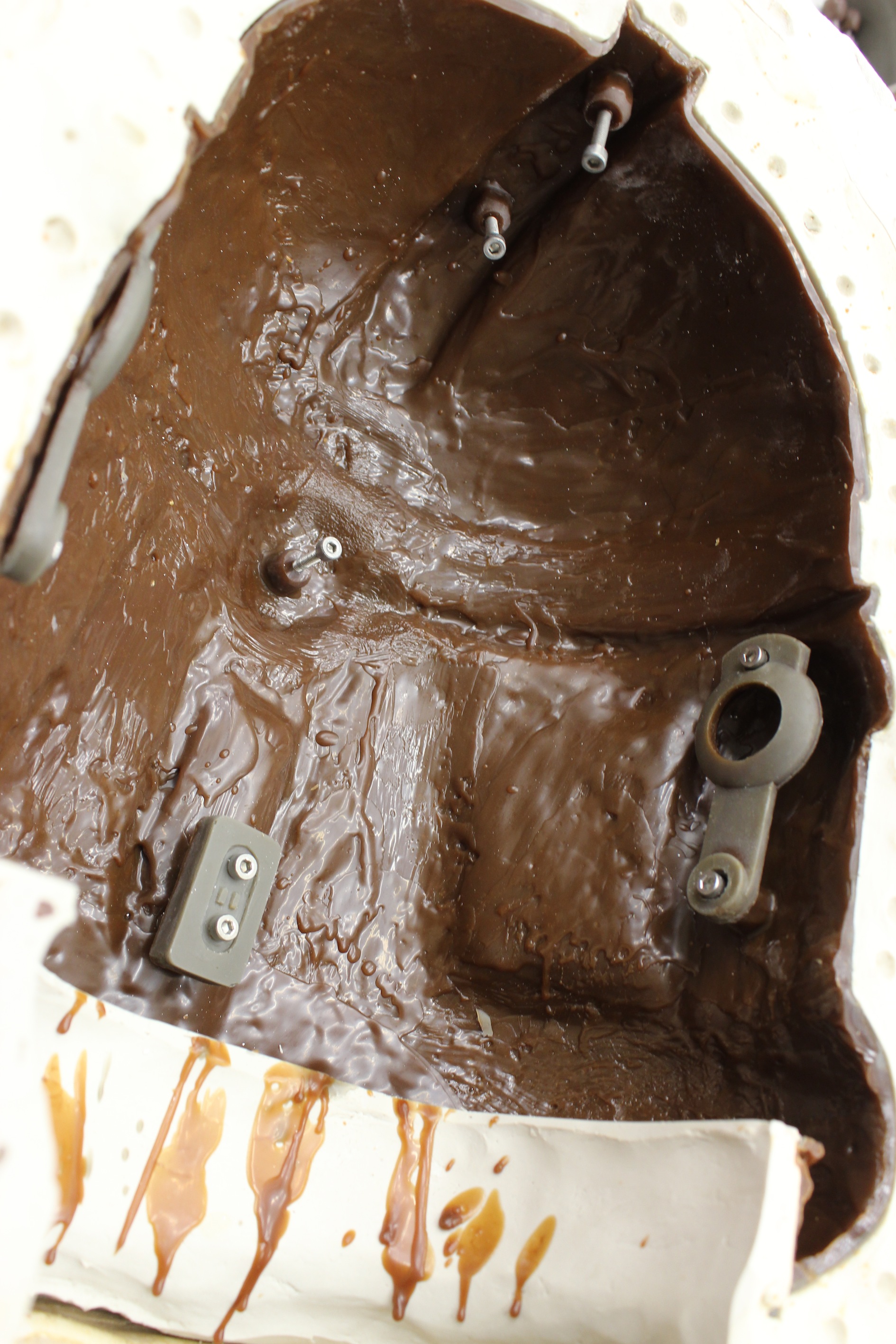

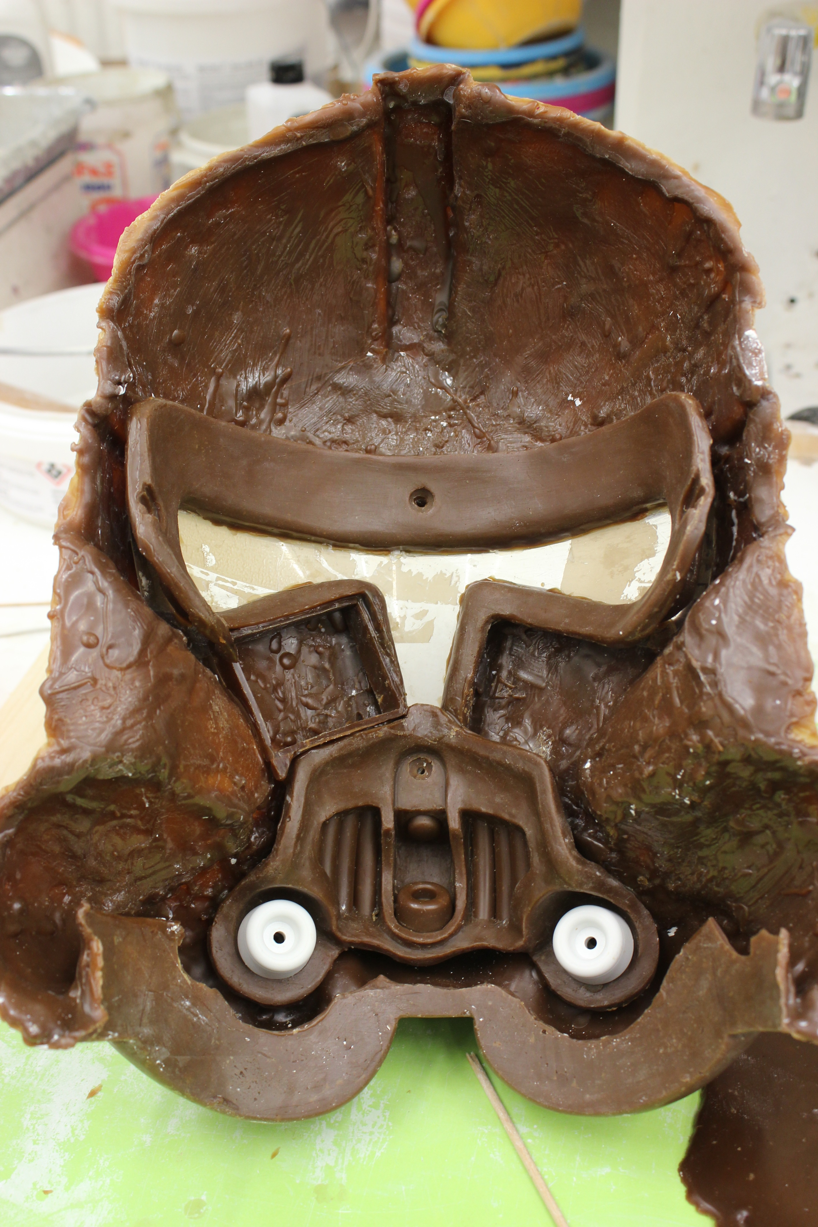

thank you, i hope anything will work out like i plan too. here are some updates: first wax helmet is done. so every thing out of wax will be change to aluminum after burning out the wax of the casting molds.
at first here are the parts for the interior. the stainless screws will hold the nuts (now into the wax balls, so they will be cast into the aluminum) and will be replaced with shorter ones after casting. down left you can see the headphone parts, one already with a speaker inside.
next image show the silicone mold with the brushed in wax.
and here the glued in nuts
and the parts into it, just a test for fitting.

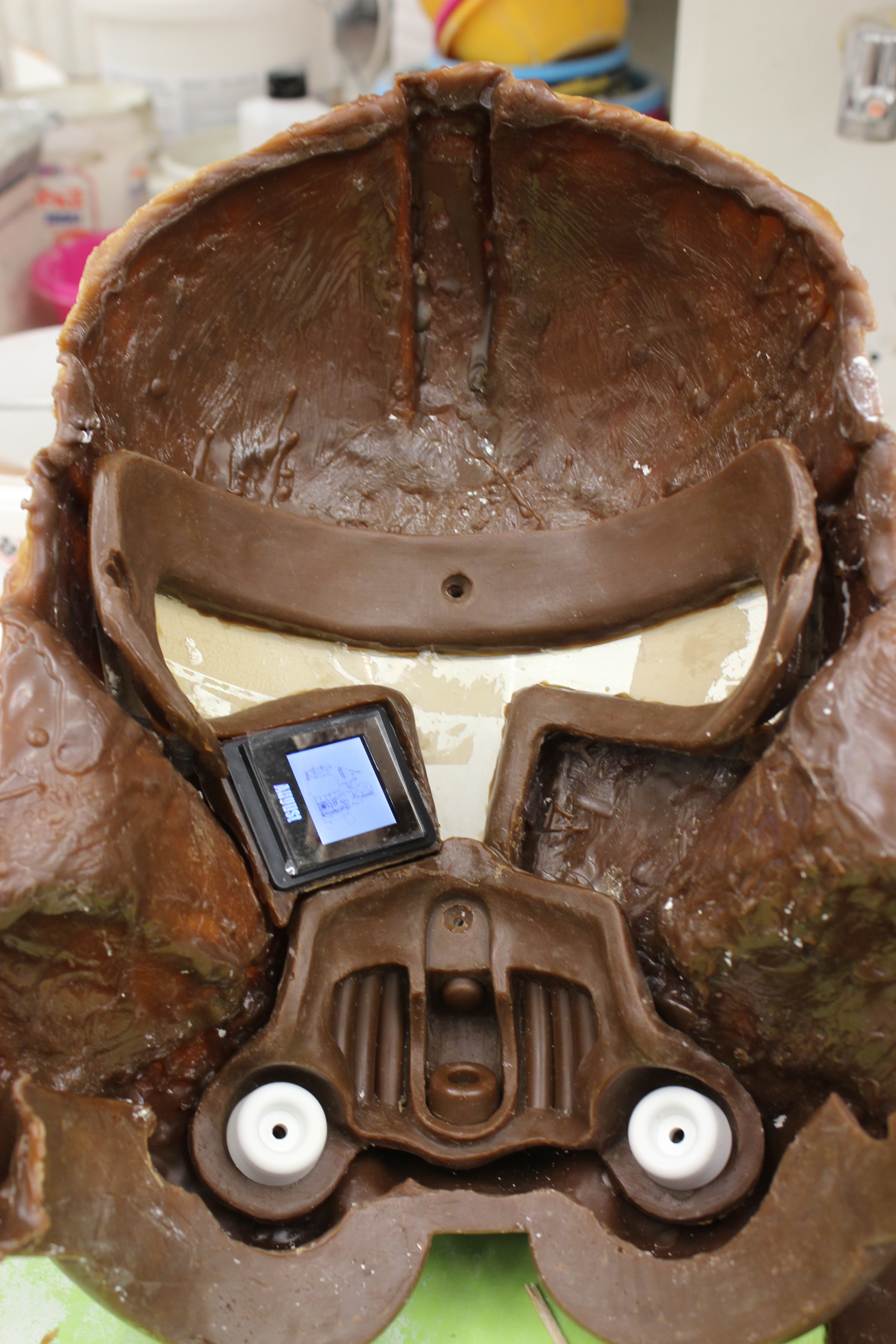

same procedure with the front part. the little displays are fitting pretty well now.
and finally, after putting the two molds together the completed helmet. looks not bad at all. now i ll have to clean everything up and fill any little bubble in the wax. than cut out the mictips for the speakers and drill 2 little holes in the "ears" for the microphones. than its finished and ready for the casting system and to form it in.
