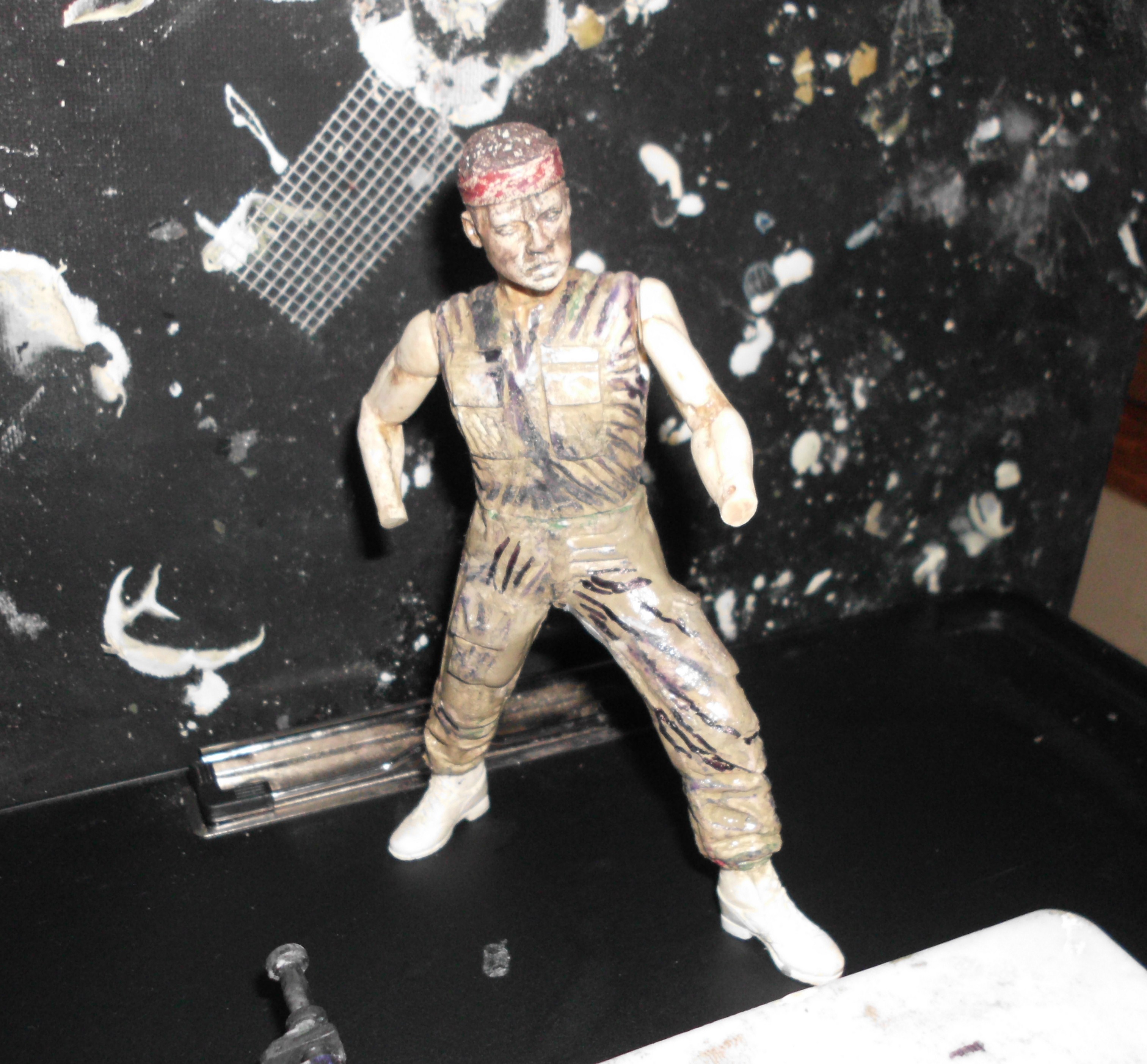

rpf1.JPGBeing bullheaded and stubborn, I still have not given up on making a scratch built Vasguez with smartgun. After many attempts and remodes to figure, I' m becoming satisfied with the appearance, The black sharpie lines are where I want to alter the “wrinkles” in clothing, also adding the sidearm holster. Putting a base coat of paint definitely highlights “flaws” for sanding. As far as the M56, the master turned out great after three going into scrap box. I knew I would need to break it down to multiple subassemblies, I just didn’t realize how many. The problem I am having is recasting, between air bubbles or areas that just won’t cast well, I’m having to go back and redo a lot of the copies (again light amount of black paint shows everything wrong).
That’s it so far, no where near being finished, in my defense this is my first figure scuplt.

What weapons and mods were the real studio/filming props made from?thats how you get your weapon,if they used a m60 then buy a m60 in the scale you are building at,if it used a longer barrel from another weapon then buy that etc etc.this way you will end up with an identical or nigh on identical weapon,the same God for body amour,pouches etc etc.dome can be made from sculpting material but if you have difficulty buy them.only real way to eliminate air bubbles is to use a vacuum chamber to suck the air out the molds.and no i don't sculpt or cast stuff it's just what I read and still remember it from other threads/forums.
For your head sculpt, maybe try using reference pics of Jenette Goldstein from other roles.
Nail down her femininity first, then "Vazquez" it.
Just a suggestion, as I wouldn't know how to begin sculpting a head in that scale.

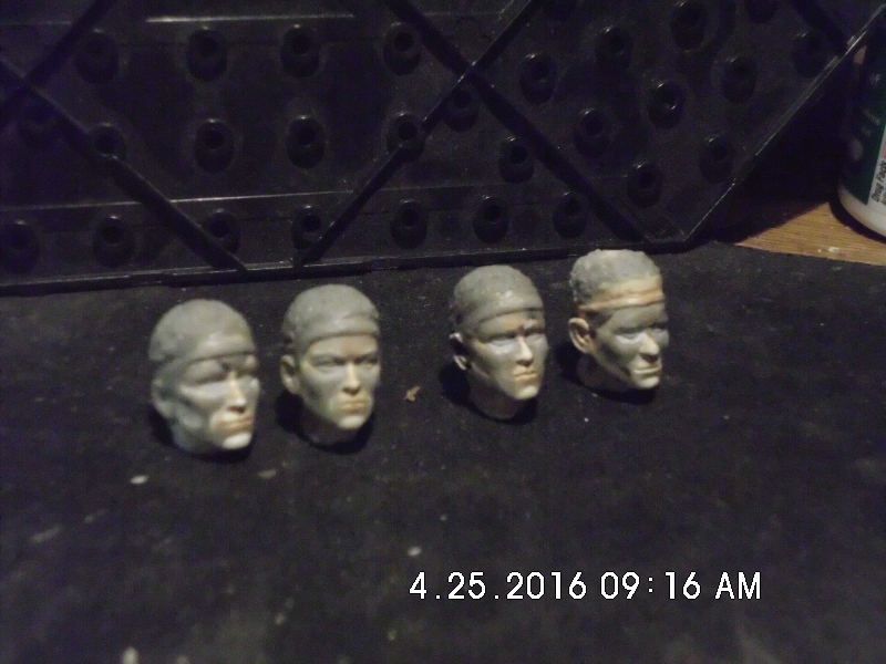

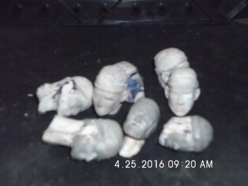

Not having enough sense to know when to give up. I am still tring to finish my Vasquez custom. Even more now that neca I coming out with one. Looking for opinions which if any looks close ? Be honest ( brutally if necessary). on a side joke here are about half of my fails
Dude, these are all very nice head sculpts! When you say 'Neca' scale, are you referring to the 7''line? it's obvious you have a lot of talent! As a sculptor myself, I would recommend that to get a good female likeness you have to look at the face far differently than a male face, try to keep everything a bit soft and curvy, you don't want to give her face any deep or hard lines, especially around the nose and mouth. Even if her face is angular, you could put those angles in, but soften them out afterwards. Another helpful hint is going to be in the final paint job you do. Look at the way light hits her face in the photo reference you use, and try to simulate that. I'm impressed at your determination to get t right, very admirable! Oh, another trick you might want to try is to sculpt her as a 'non' Marine with a feminine hair-do......She's got the bandana and short cropped hair that makes her 'manish'....I ran into a similar situation when I did my sculpt of The Thing from another world', I was doing the sculpt of James Arness in make-up, and i couldn't get it to look right for beans! So I re-started the head as a normal portrait, complete with hair, and Bingo! it happened! Then i shaved his hair off, and added the make-up, and was finally able to get the character right. Hope this helps!
I think you're doing very well with the head sculpts... certainly you are putting in the time on it! Being your first (really? hard to believe...) the results so far are very favorable. Hang in there, keep working it until you are happy with it - or happy enough. Mcusanelli's tip sounds like a good one... and it sounds like he is Mike Cusanelli, btw, who really is an outstanding figure guy (hi! Mike...) so he knows what's up.

That's how a lot of people started out, myself included! For me, I got more interested in the figures that came with Monogram's planes and tanks, and the 'how-to' pamphlets that Shep Paine did.....And when Star Wars came out, my 13 year old self went bananas and got inspired to go into art in some form......It takes a bit of time to learn, but judging by what you're doing, you're on the right track, so keep plugging away! There is a book I recommend to everyone, an oldie but goodie, that I tell everyone to get that will help you with all kinds of things, like proportions, women's faces, and drapery -out of all the anatomy books I have, this is the one that helped me more than all the others, I go back to it on every sculpt I do to check my work... It's 'Drawing the head and figure', by Jack Hamm. From 1963, so it's as old as I am! Widely available, so you shouldn't have a problem finding it. He also does another one on animals that's fantastic too. Even though it's meant for people who are interested in drawing, as soon as you open it you'll see why I recommend it, it's just brilliant!
