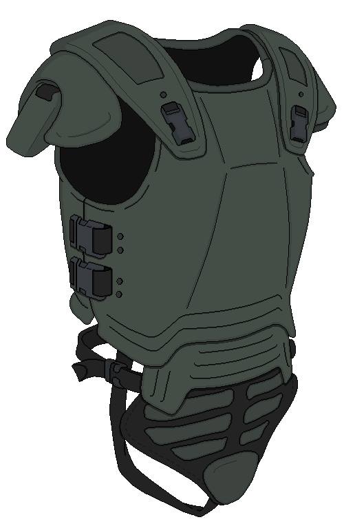

I'm looking for any Details on the armor that is screen accurate as possible so I can CAD up a set of STLs for this build. I'm looking to create the entire suit from Shin guards, codpiece, to the details of the shoulder connections. ANY patterns (eva foam, pepakura, etc) links would be appreciated!

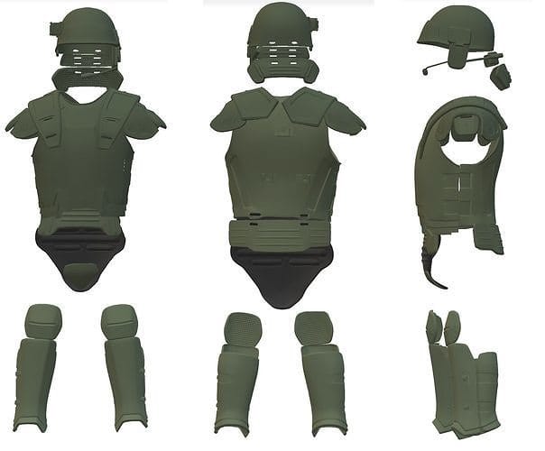

Very curious if anything came of this, I've been bit by the Fusion360 bug, and am considering doing the same. The only models I have found are terrrrrrrible meshes ( for $90 ), that seem ripped from videogame assets.

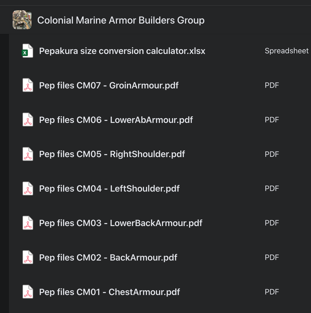

Yes I have. There are pdf outlines/templates for cutting out of sheet materials and pep files for doing similar but as far as I can find there are no 3D CAD files that would allow someone to just print a set on a 3d printer.
From the discussion above there may be some on facebook as Badjer1983 makes a comment about thickening the model to 5mm but as mentioned previously if you don't use facebook then you cant even find them to take a look at them.
