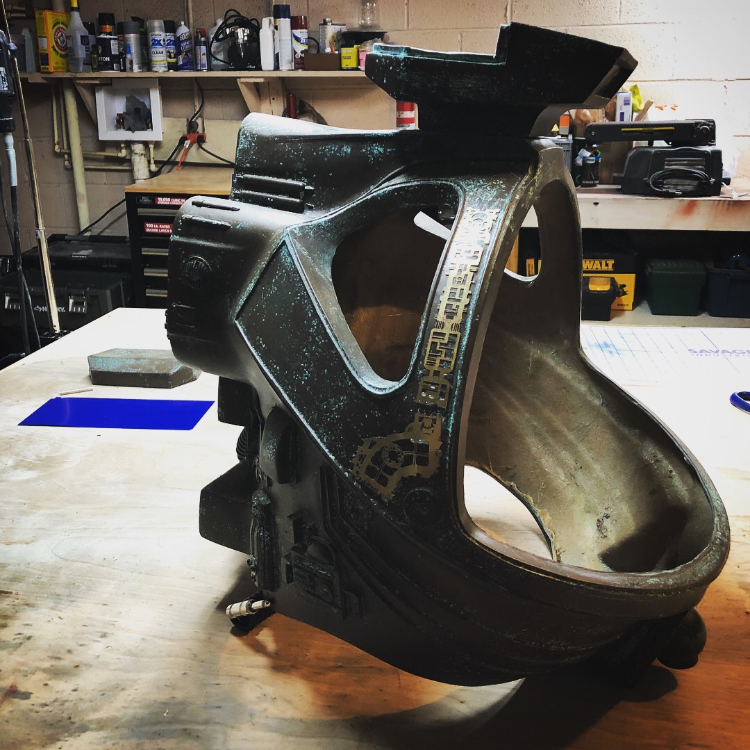

thanks! Nothing is actually painted aside from the red on the knobs on the backpack and the black handles on the stomach box. Everything else is a natural patina from the brass powder mixed in the resin.

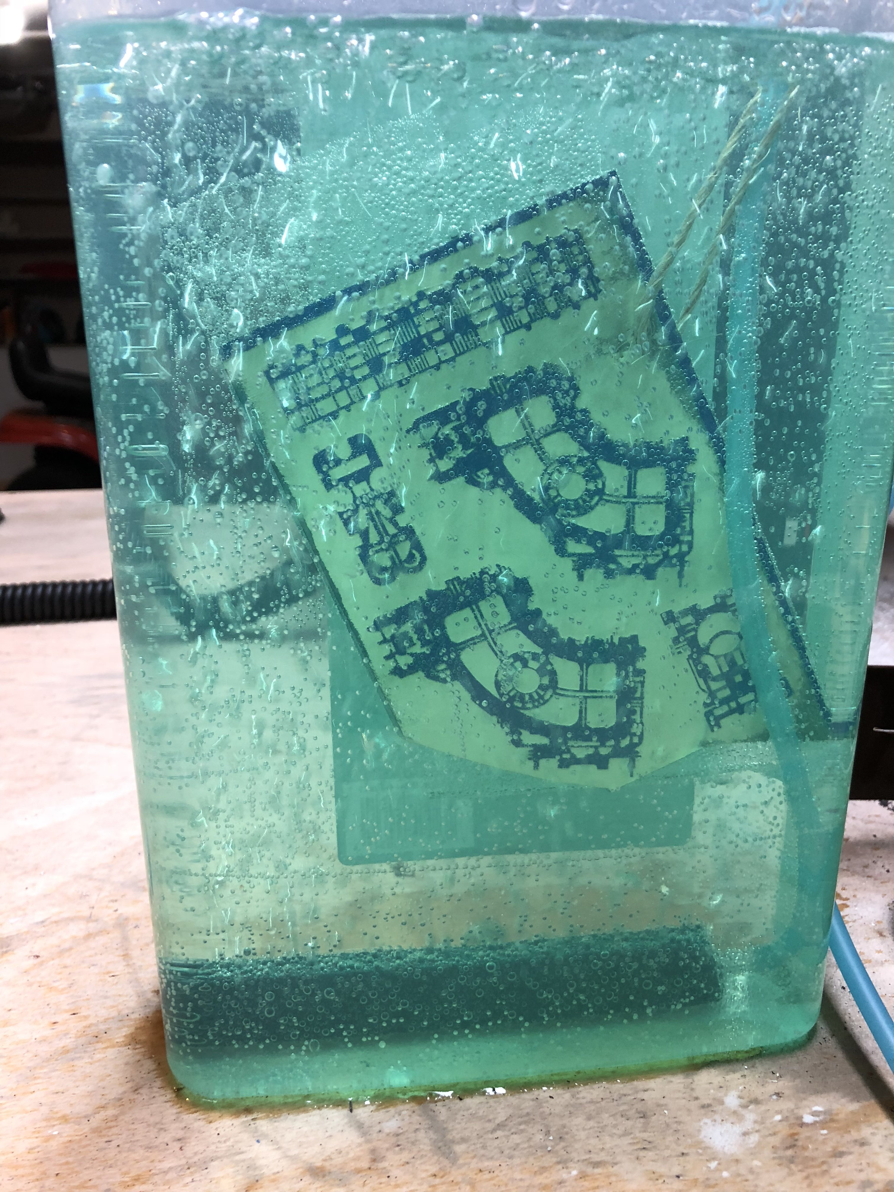

We’ve got brass details! Now to get the rest of it etched.
Re: Alien environmental MK50 suit group build PIC HEAVY
OH WOW!!! Those etchings came out fantastic! And now about those laser cutter costs... ;)

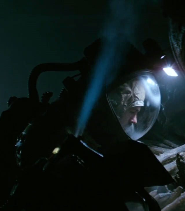

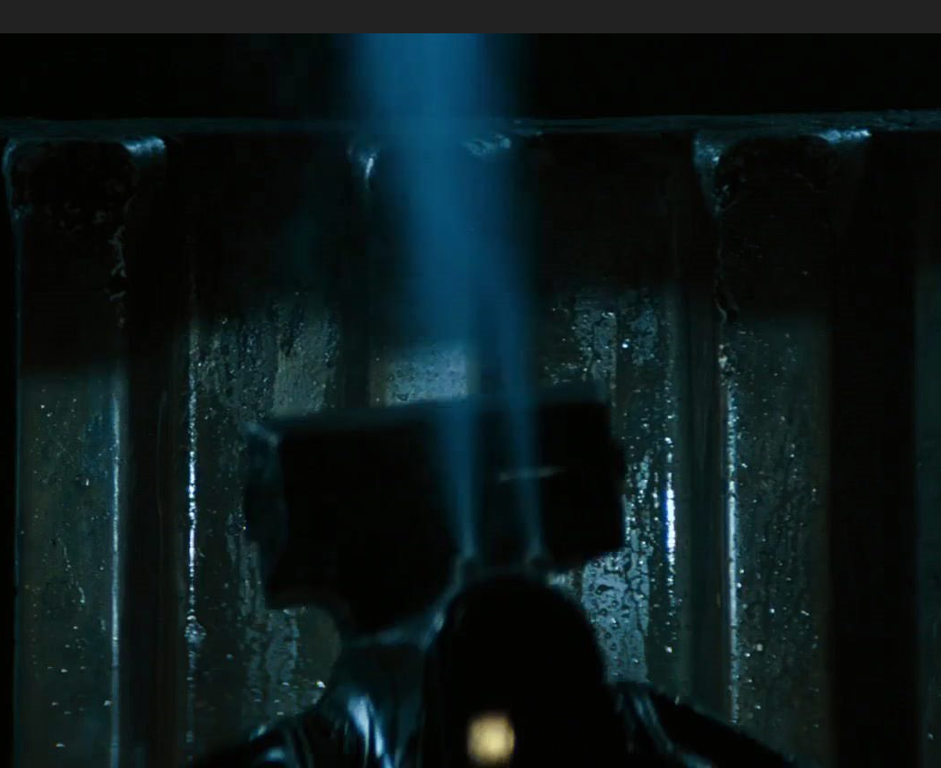

As we're nearing completion of the hard parts of the suit we're starting to focus on the details. Next up is the purge system. Been throwing around some ideas and was thinking of using a CO2 tank and a solenoid valve but also wanted something a little simpler. Does anyone have any suggestions what might be able to achieve this effect?

For the venting, what about a "mist humidifier"/"essential oil diffuser" like this:
https://www.amazon.com/BalanceFrom-...89094&sr=8-3&keywords=mist+humidifier+cycling
(I'm not affiliated in any way, nor am I promoting this particular item, just giving an example. Searching for "cycling mist humidifier" or "cycling essential oil diffuser" should get you in the right ballpark.)
The important thing is that many of these have an "intermittent mode" that mists for 20 seconds (or whatever - it varies by model), then is off for 10 seconds. May be a bit long of an "exhale," but you'd have something out-of-the-box that would give you a cyclic mist effect without a solenoid or any microprocessor electronics. Maybe you need to add a squirt gun nozzle to throttle the jet a bit and figure out some way to make sure the water inside doesn't spill out, but... can I say "that's your problem" without sounding like a jerk?
Added bonus: You can put aromatherapy oils in it and each suit can have a different purdy smell.
This project is super cool! Great job so far.
I'm sure y'all have probably seen this already, but maybe someone else hasn't. Great closeups and different angles on some pieces:
https://www.youtube.com/watch?v=x1yRMxS7TT8
Thanks for the info, i actually have one of these diffusers in my house now. The smoke plume looks correct though i would still need a way to push the plume out. gonna try some canned air upside down next to see if I can get it to feed through a hose. Or possibly use it in conjunction with the diffuser or E-Cig to push the smoke

More etching underway for Toms helmet. Using cupric acid this time and so far it’s a much quicker process and cleaner etch.
