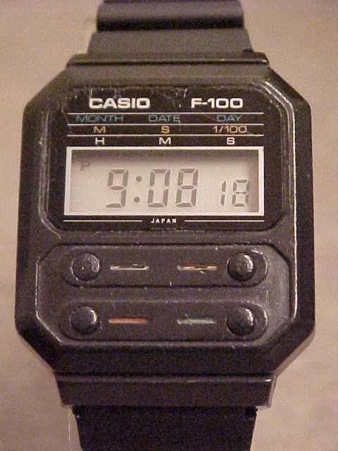

Having spent far too much time fiddling around with Tinkercad making a good model of the iconic Casio F100 watch, a job lot of "broken" pebble watches came my way and the rest is history.

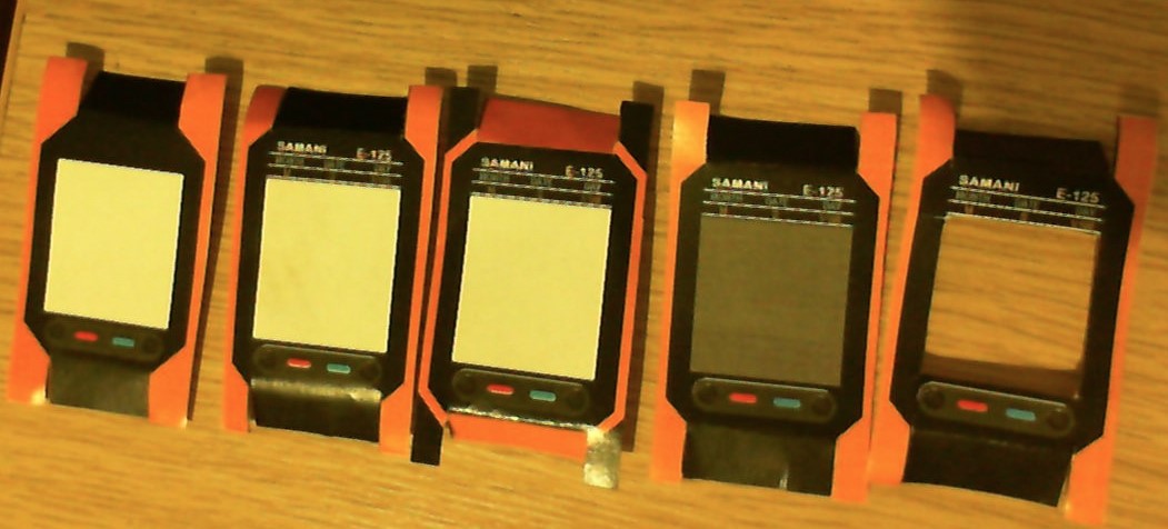

First using all the measurements and preference photos I had to hand for my 3d model, I drew (in MS PAINT !) a skin for a pebble watch. This went through several iterations, prints to paper and test fittings.
I scaled the final image in Publisher to 3.3cm width and fine tuned all other measurements with paper templates.
I chose to use the SAMANI branding from Alien Isolation.

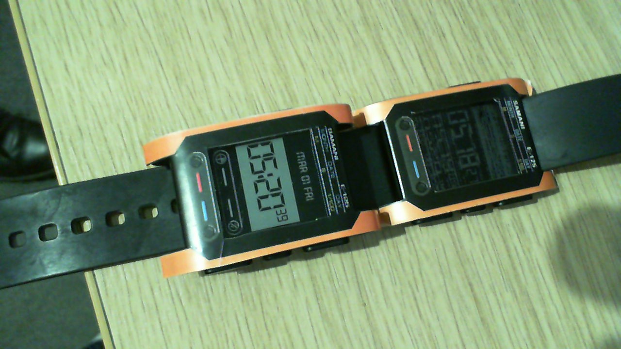

Printed to adhesive vinyl, cut out the "skin" and stuck to a pebble watch.
The most recent couple of iterations are shown. Font changed to Microstyle extended on lower watch.
Watch-face was made in Pebble Watchface generator, with another (black and white) Paint image as the background. Bluetooth and Battery meters are overlaid on the watchface "buttons"
Joining strap has been designed in Tinkercad for printing in TPU.
Skin has been modified to use a larger font in Microstyle Bold extended for the top line, and further modify the button bar to more closely match the watchface.
