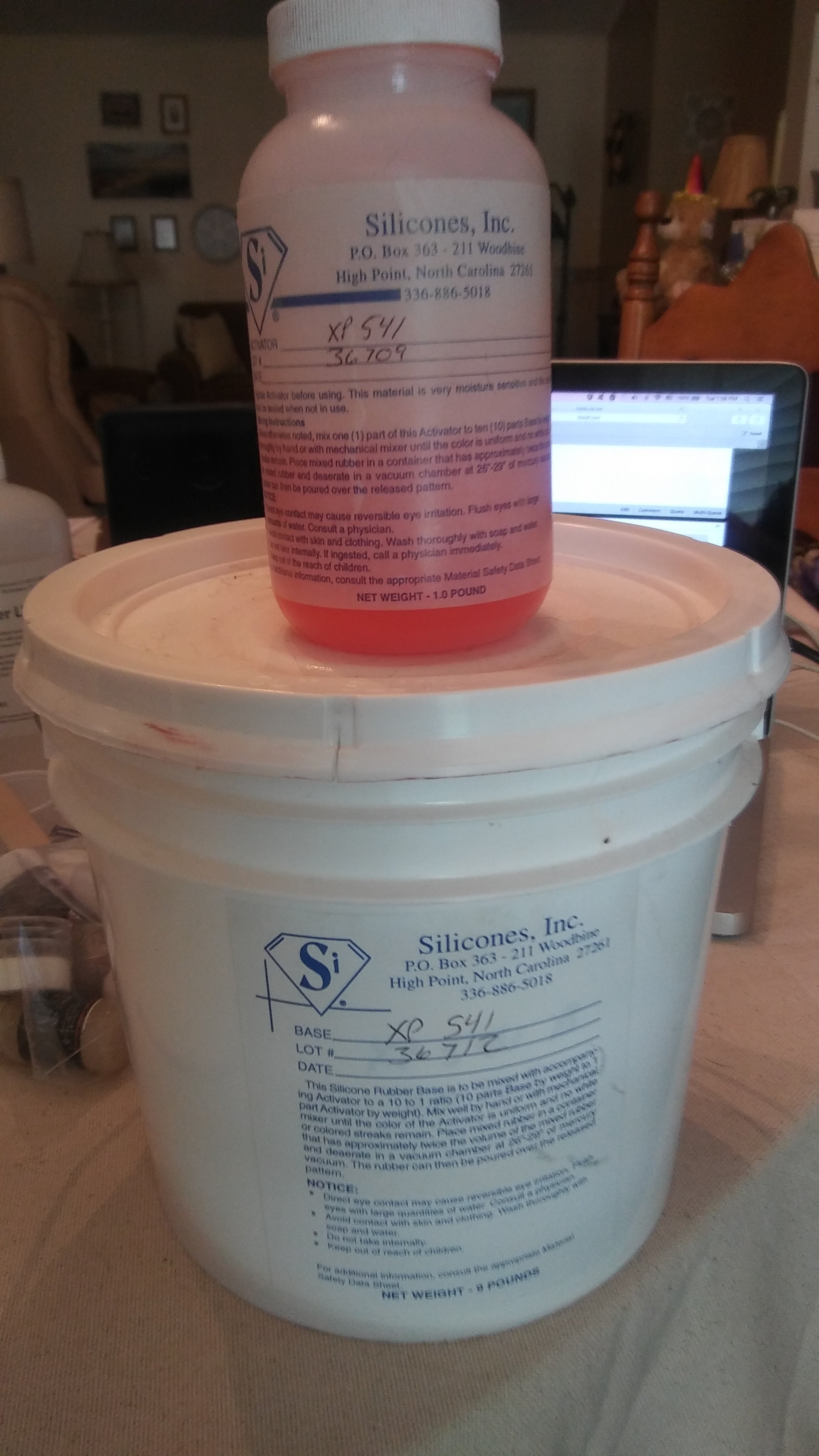

Silicones, Inc. in North Carolina has a lifecasting silicone that i regularly use - XP-541. About $150 for a gallon kit as opposed $231!
XP-541 is a bit more viscous than BD especially for the beauty coat so i thin the first coat with silicone fluid.
Other than that XP-541 is great!!

Smooth-On's 'gallon kit' is basically 2 gallons at 18 lbs. Is the XP-541 actually a gallon or larger?
I had forgotten the mix ratios. BD 1:1, the XP-541 is 10:1- 9lbs base and 1lbs activator for $143.
Smooth-On makes it confusing by how they name their kits and I bet it hurts business since at first glance you think you're paying $90 more, when you're getting twice the amount at about $30 less per gallon.
