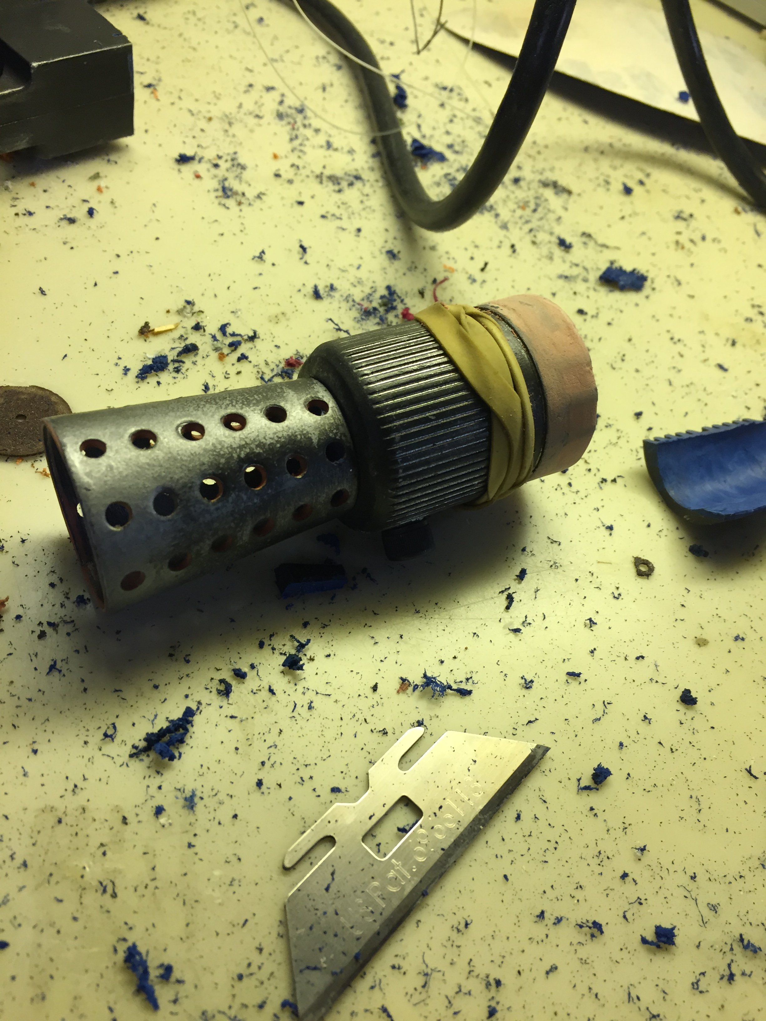

Next step was the flash hider. While the metal ones are beautiful they are way out of my price range and the 3D printed ones are up there for me as well, so I decided to remove the flash hider from the Rupies DL-44 that came out a little while ago and try to clean that up.
Once removed, I used bondo to flesh out where the divets are and to cover the hole left after removing it from the toy.
The divets were then added to the base using a dremel.
The whole thing was then painted with a base of flat black, then a coat of chrome, then rubbed a copper sharpie on a paper towel and "brushed" the flash hider.

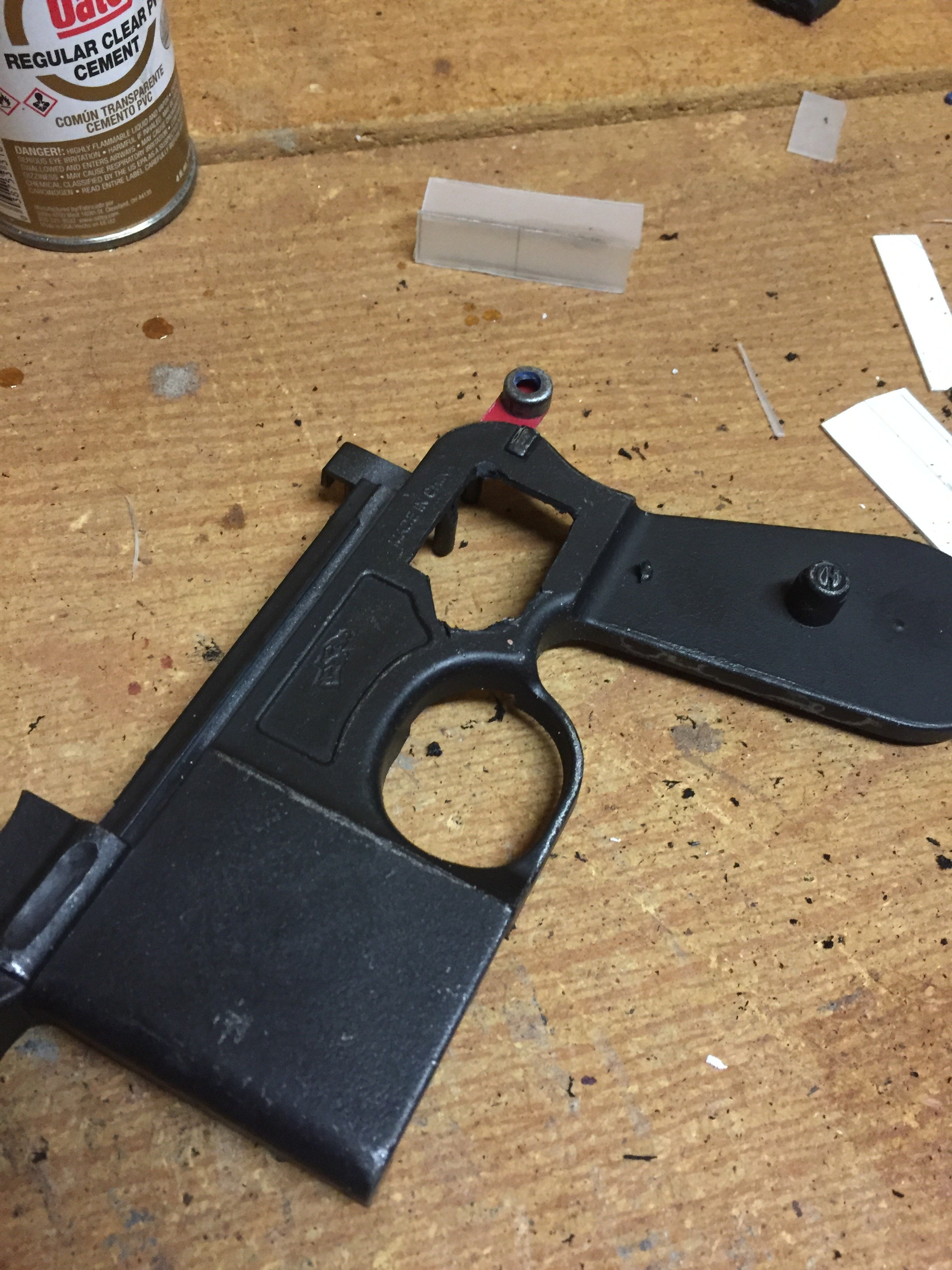

Next was to work on making the body of the Mauser more accurate, first was to cut down the barrel and remove the massive selector switch on the left side.
Then glued a bit of styrene underneath to support the bondo that would fill the hole.
The safety was also added at this point using more plastic and a hardware knob.
After that was done I "milled" out the spot and glued a rectangular bit of styrene into the space (I don't have a progress picture of that part apparently).

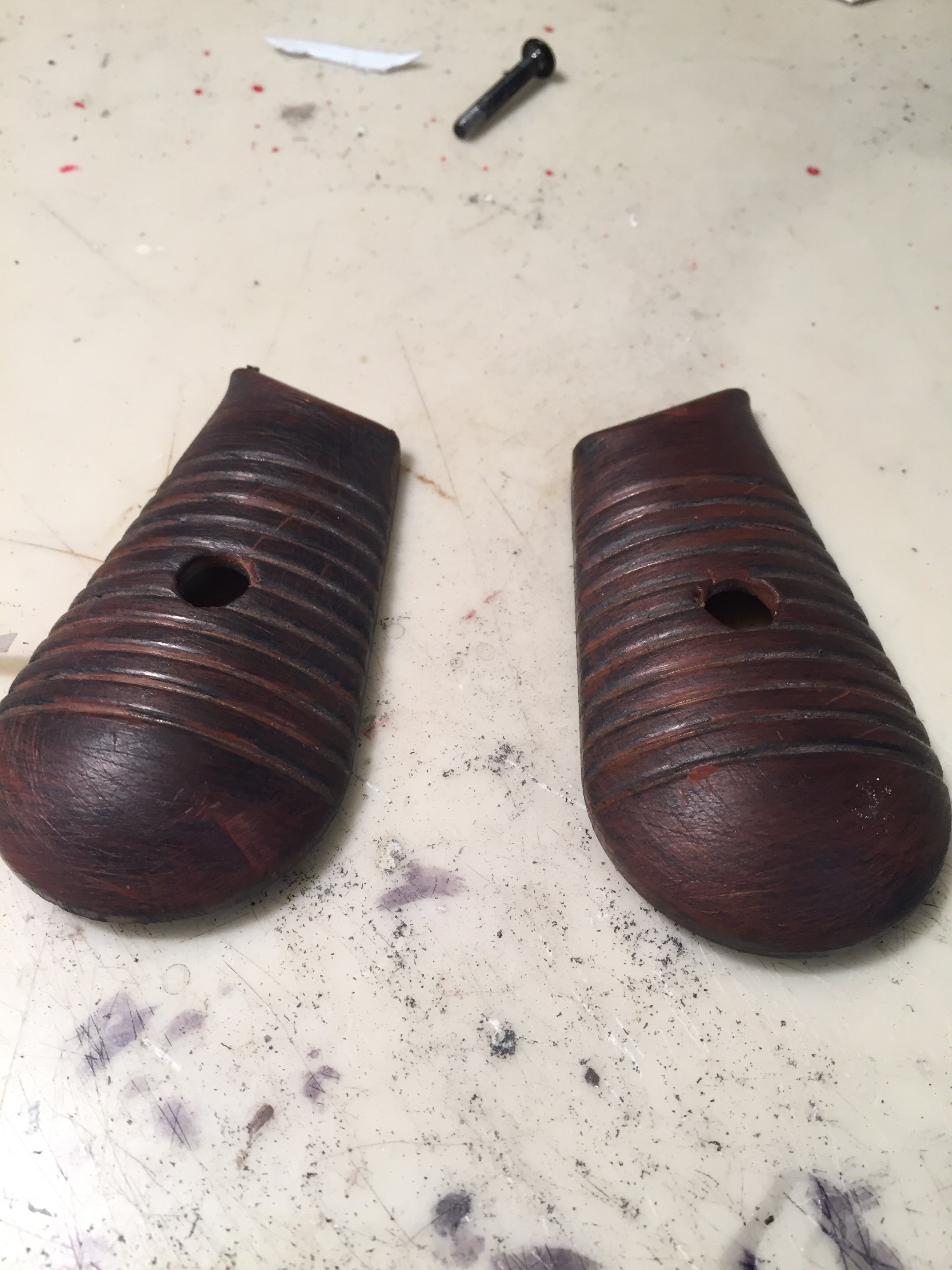

The last thing done was adding wood grain to the grips, done using sandpaper for the grain, spray painting brown, sanding again, "brushing" with black paint on a paper towel, then doing the same with a red expo marker (It's what was red and near me at the time).

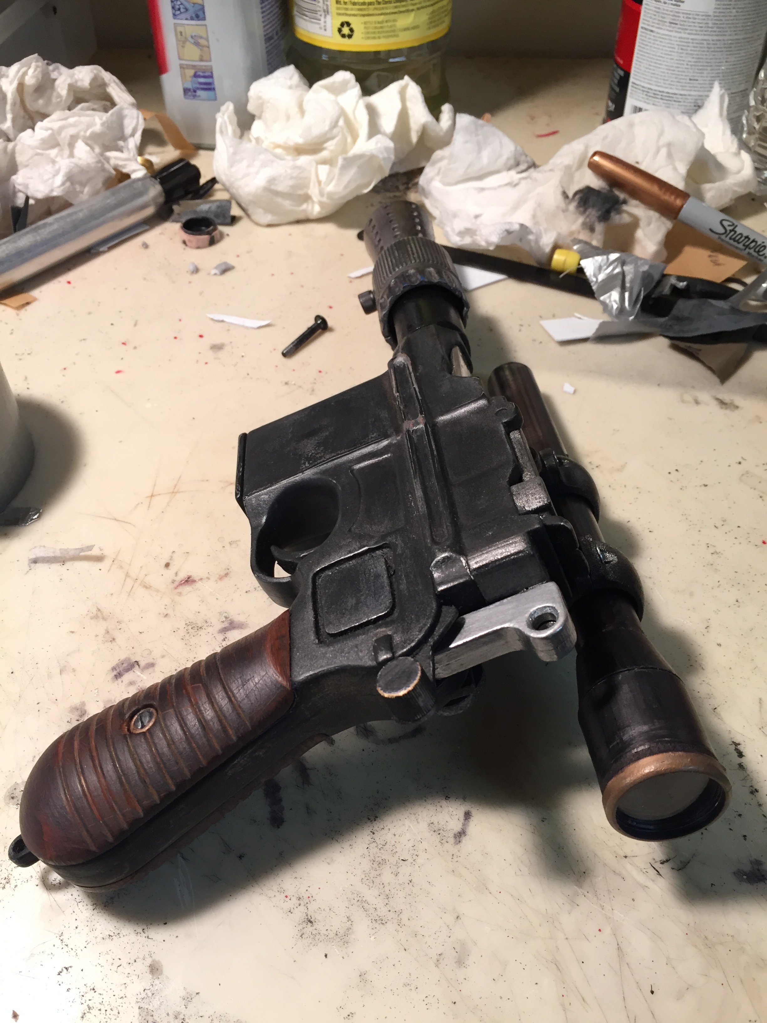

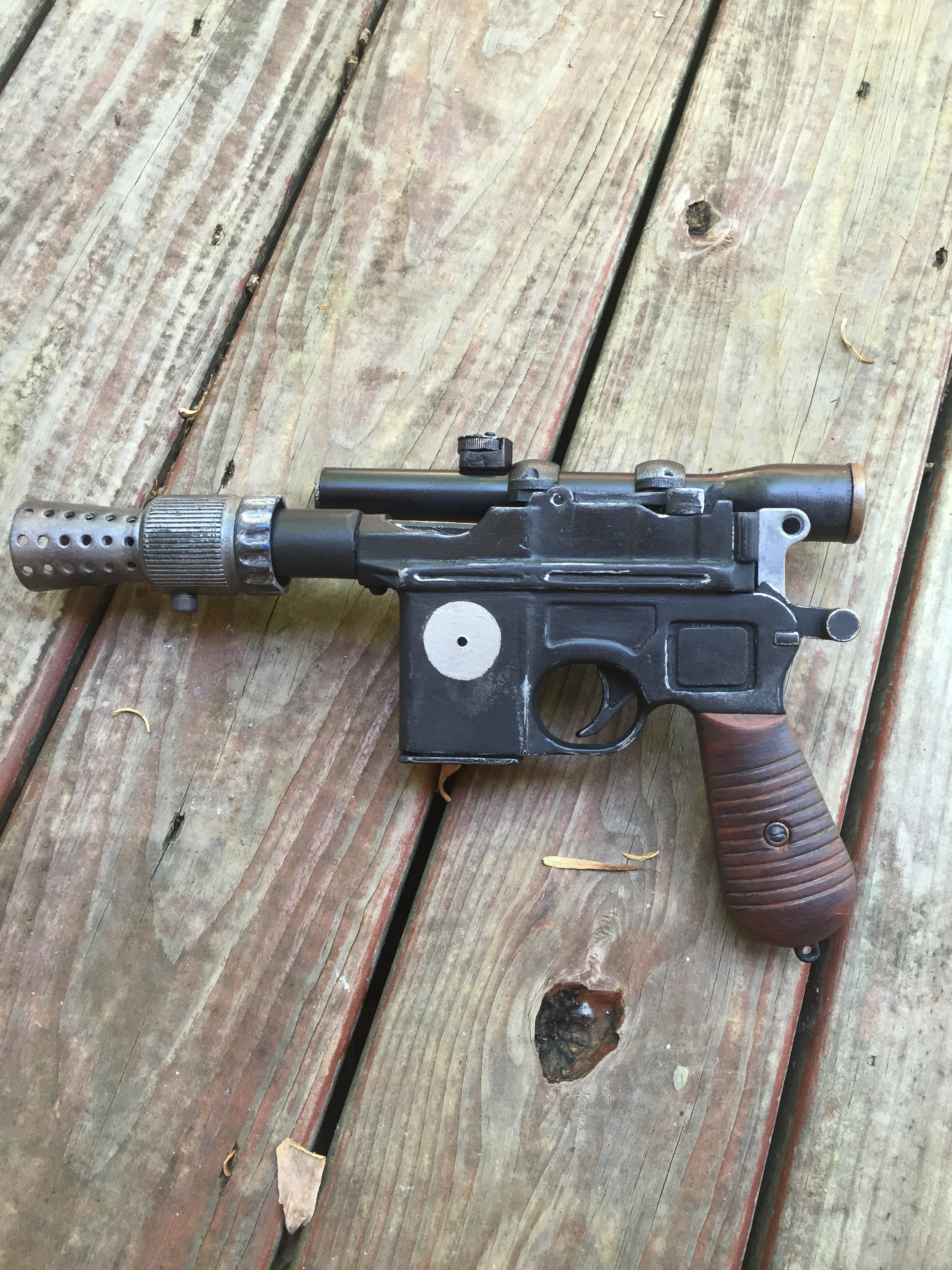

Lastly we have where the blaster is now with everything painted and attached.
It's still a work in progress but I have a couple question on proceeding, the first being what is the best method for a more accurate metal look, I tried a variety of different methods and am still not totally satisfied with the finish. Also, what is a good material for the grill on the front of the blaster?

Great idea on the toy flash hider, having never seen one of those in the flesh it's been too much of a risk to lay down the funds and buy something that's going to turn out too small. Looks fine from here, is it about full-size?
I'd rather have plastic than resin, and much like yourself, a metal one's just not going to happen anytime soon.

I can help with a size comparison between the doopys at the top
and the modified rubies at the bottom.
The flash hider on the doopys is 32mm on the round with 36mm on the rubies :)
I'd love to see what you come up with Wayne! I'll definitely keep updating this thread with progress as things continue. Also thanks Spacebob for two things, 1. for the images and measurements, and 2. for reminding me it's rubies not rupies.

As of right now it's pretty off, but the general shape is there I'm still trying to figure out a way to get the right dimensions and knurling. The original piping was removed for the scope and replaced with a the end of a plastic toy scope, then I used bondo to fill the seams.
The dial was done by using a bit of plastic lit heated with a cigarette lighter and formed into the right shape attached to a base sculpted from epoxy puddy. The dial itself is a dial from some airsoft M16 but it's horribly inaccurate so it will be changed eventually. After the base was made I milled out the area where the hex screw fits it (only because that's what size the hole that was already in the pipe was) and attached it.
Then after that was done it was repainting the blaster mount and scope (Again: still not satisfied with these paint jobs!) and adding the disk.
